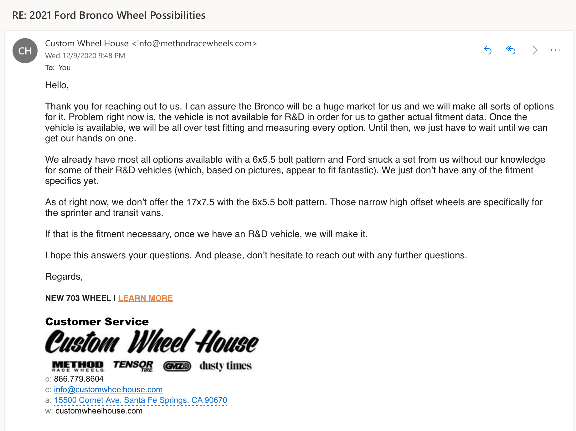

Received this response from Custom Wheel House (Method Race Wheels) in response
to an inquiry about future possibilities for wheels for the Outer Banks.

That's the kind of response i would hope to get instead of "they work since ford tried it" and leaving it at that. Looking forward to putting a set on my rig once they get some bronco specific fitment worked out.

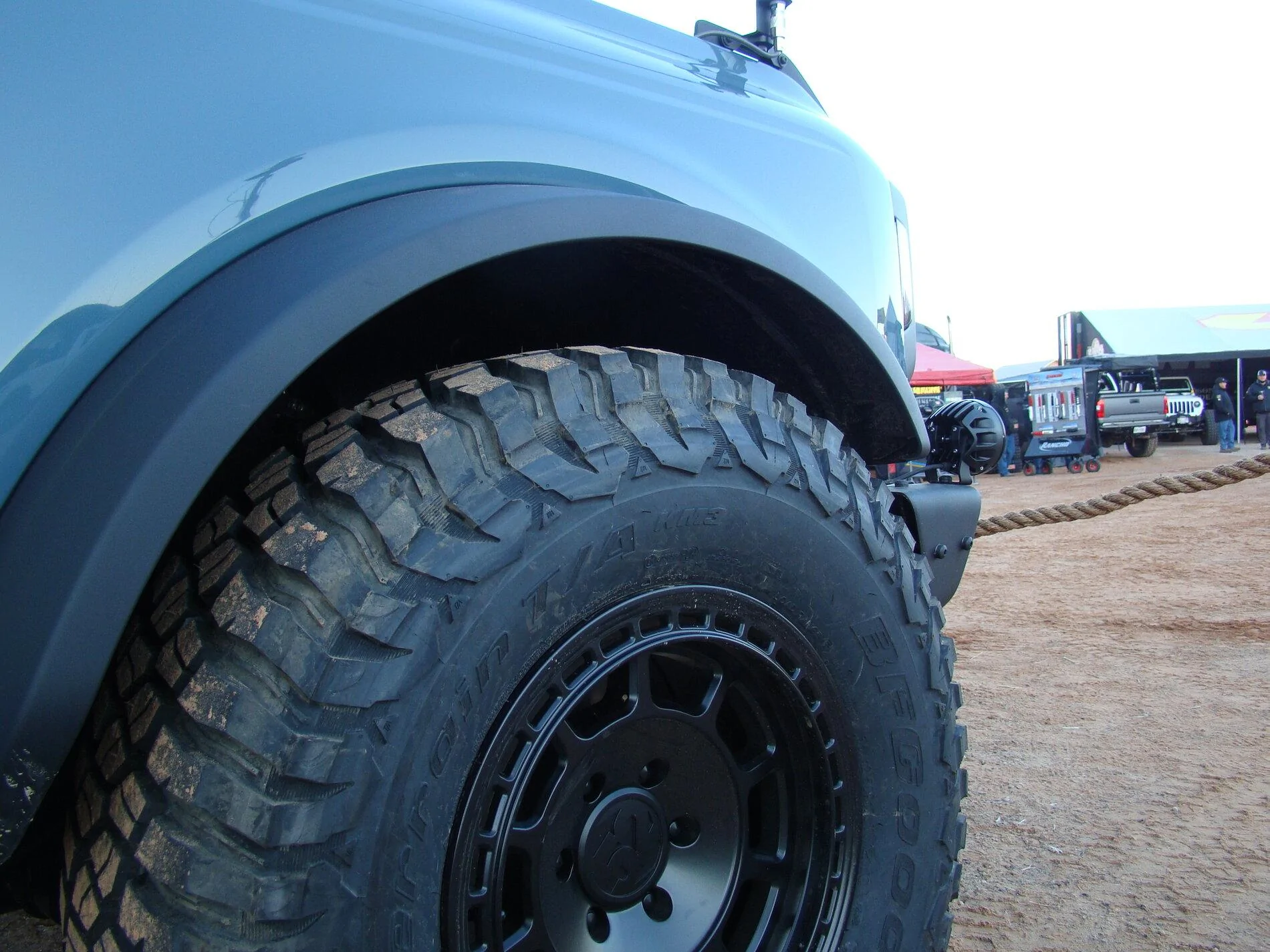

Ford has been driving this one all over and it seems fine.
They've been driving it on and off a trailer to display at shows.
While it is likely "fine" it may not be ideal and I certainly wouldn't use this specific Bronco as proof of that.

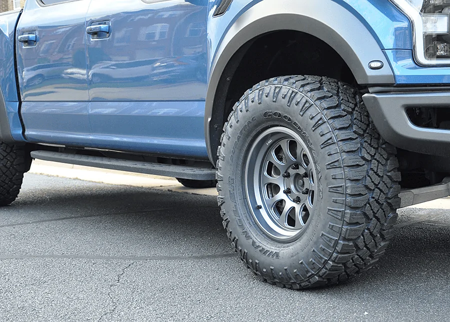

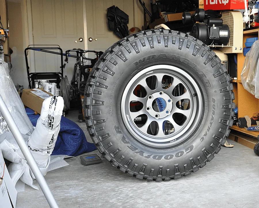

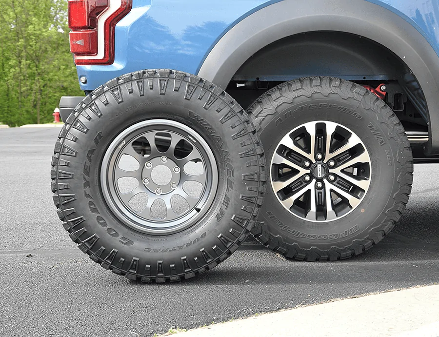

buy a forged wheel and it will be hub-centric.
Titan7s on my Raptor (17 x 8.5, -1 offset, 20.6 pounds and hub-centric). They will have an application for a Bronco as soon as they can get their hands on one.
