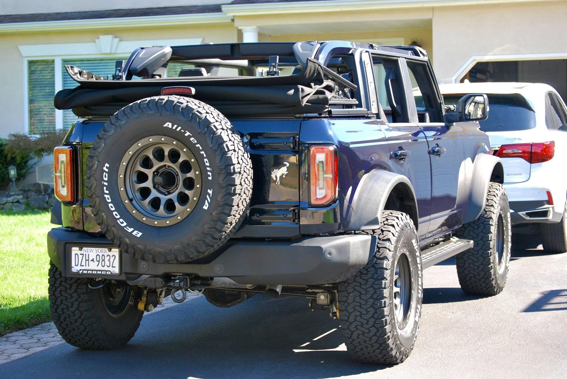

You could add 1" wheel spacers to the badlands wheels or replace with new wheels with offset similar to sasquatch. You might also want a Zone $60 level kit (raise front 1").
OBX SAS. 1" Zone Level. -10 Wheels.

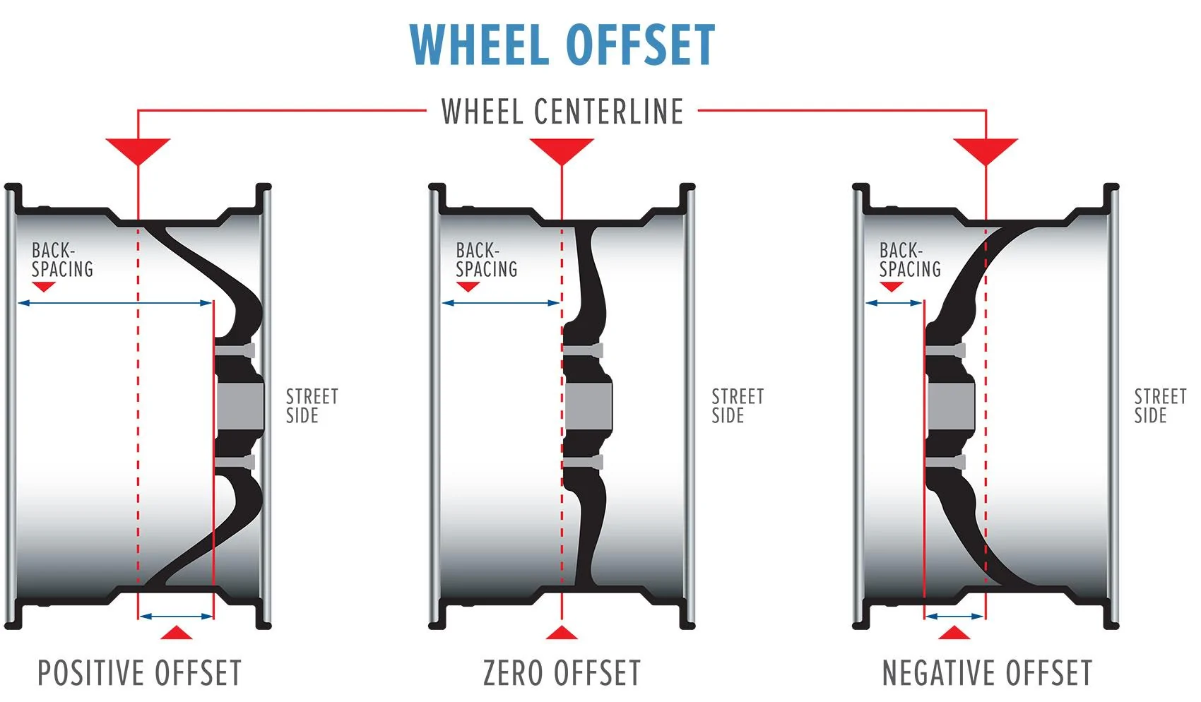

Surely you're not asking if your mechanic can just GIVE you half an inch of offset right? Offset has nothing to do with tires, and is measured from wheel width. 42mm offset (I'm assuming positive?) on what width wheel? I'd recommend doing research on your own and figuring out how all this works. Look up how backspace and offset are measured. 15 minutes of your time and you'll figure it out. Here's a pic to get you started.
