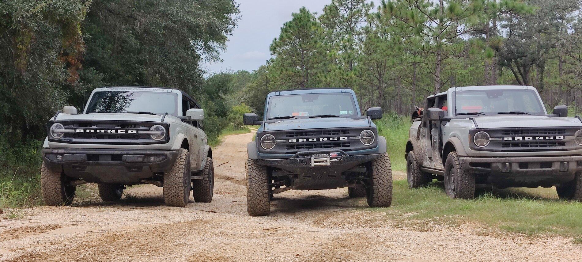

This may not help much but from left to right:
*OBX 4WP Level with +30 Offset 17x9
*Black Diamond Leveling kit and Sas flares with 0 Offset 17x9
*Black Diamond Stock 55 Offset 17x7.5
Ford Bronco Tire and wheel offset help please IMG_20210911_144845
Guessing stock has stock tire size. What about the other two??

Both of the leveled Broncos have 315/70r17. The one on the left has BFG KO2 and the middle one has Nitto Ridge Grapplers.
Ford Bronco Tire and wheel offset help please IMG_20210828_174454__01
What flares are on the OBX?

Here is another comparison picture.
Left: OBX 17x9 +30 315/70r17 4WP level with 4WP crash bars
Right:. Stock Black Diamond
Kinda nice to see that +35 with base flares has a reasonable amount of poke! I had been curious about using SAS takeoffs with painted OBX flares.
