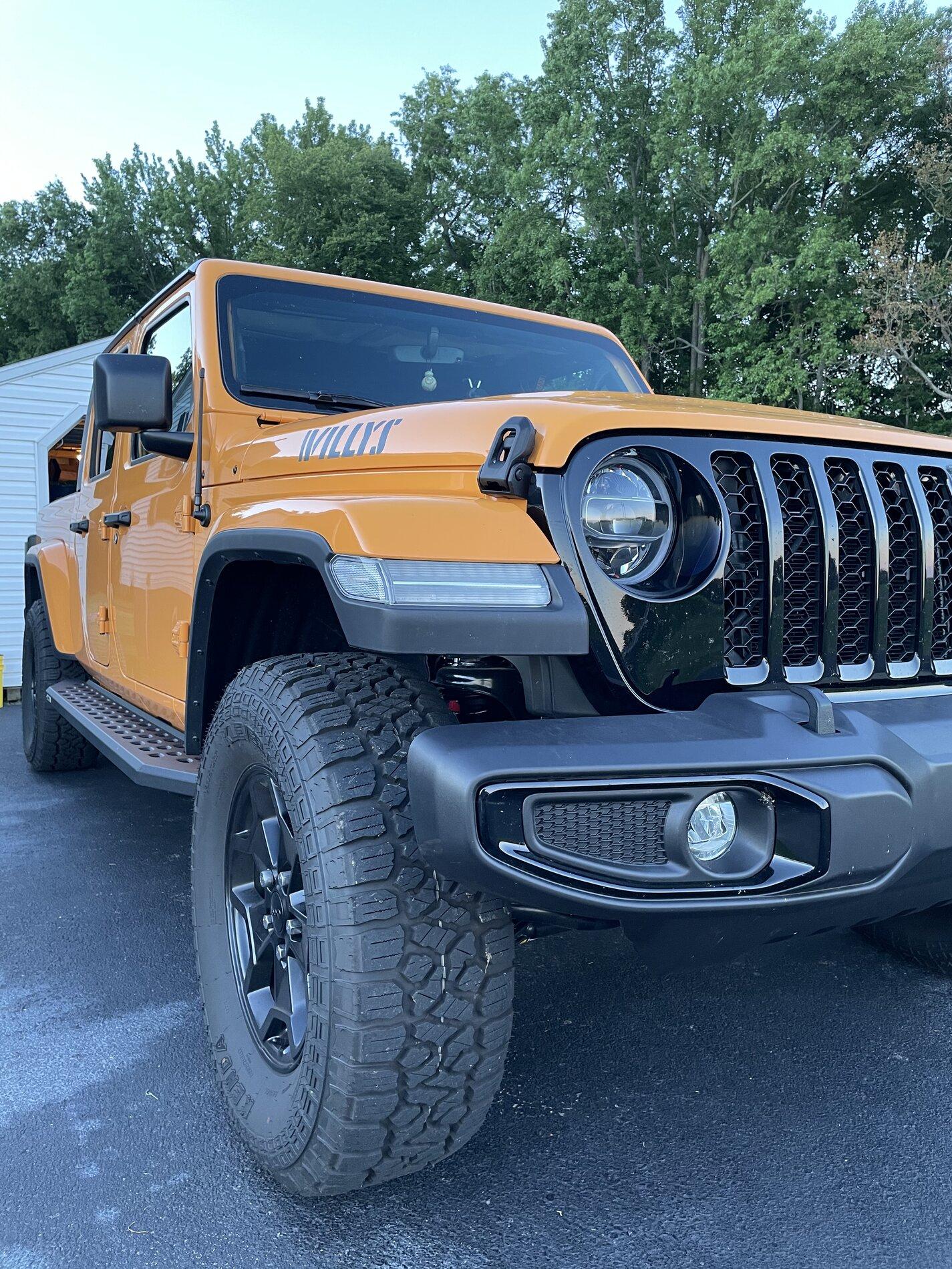

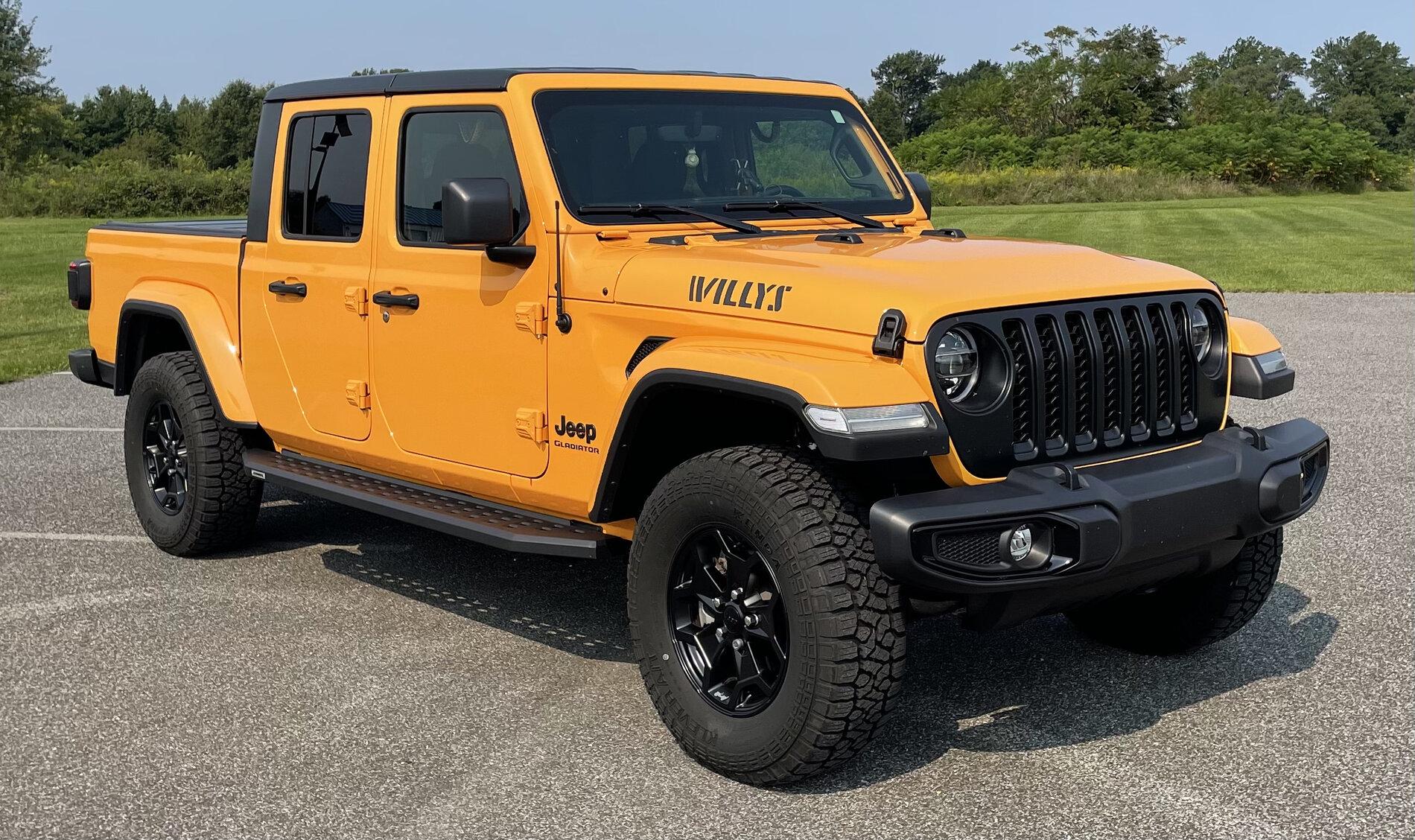

My wheels I got are a 17x8.5 with +18 offset. I had long discussions with my local tire and wheel shop (also one of my clients), we determined that the +18 is perfect to get my new wheels/tires to be pretty close on the inside to what the stock wheels/tires were. As soon as the stock tires wear out, I am going with a 35x11.50 all terrain. I do not like too much poke. He though that the 0 offset or a negative offset would stick out too far. I do not like tires that are super fat either.
I thought about going with 35x10.5 Kendas. But decided to stick with 33s. I like the look of the stock tires on the Badlands. Perfect width and height to make it a little more aggressive. Sasquatch is even cooler. But just ore than I need. And the cost goes up substantially on a 315/70-17.
I paid under $150 each for the Kenda Klever AT2s in 285/70-17 on my Gladiator. They are P rated. But I really don't need a super tough sidewall as my off-roading will be on the beach and light trails. Still have an aggressive look. And they weigh 48lbs each. Not bad for that size.
I was going to get the Gladiator as soon as my funds opened up this past January but then the Bronco was released. I have been a die hard Jeep guy my whole life, until July 2020. I love your Gladiator but I will never look at a Jeep the same again. I still like them, especially the Willys. They are built for light off-road but priced right. When I upgrade, I think I will go with the Maxxis. I have them on my F350 dually and they look sharp.
Which steps are on your Jeep? I know I will have to put something on my Bronco, but I definitely want something like those that do not hang down.
The side steps are Go Rhino RB20s. Love them. Very solid and they have a lip that covers the pinch weld. I'll be running the same thing on my Bronco.
