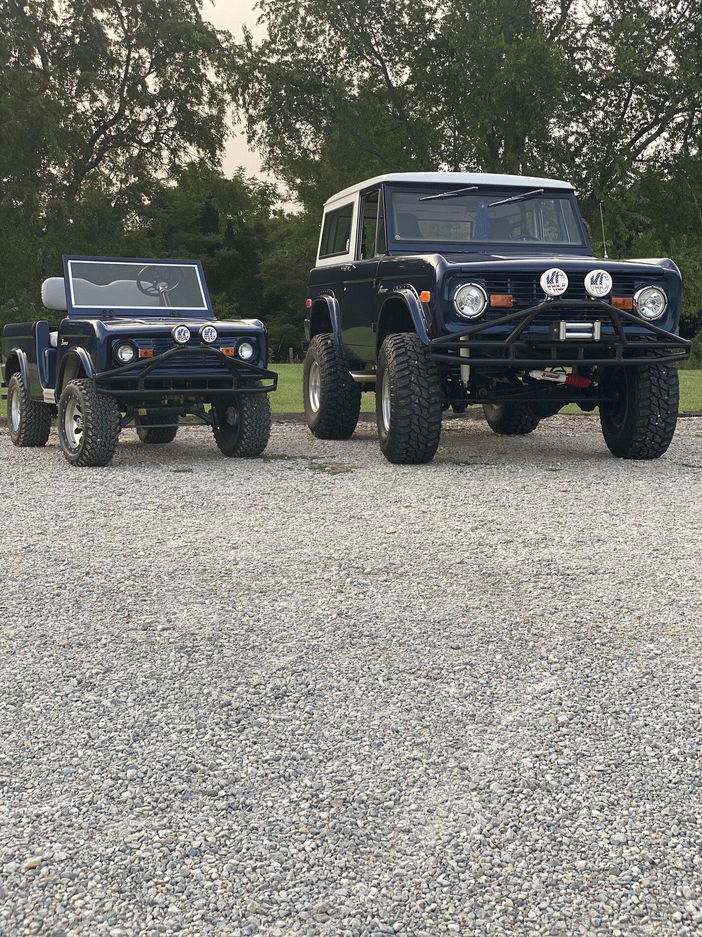

Yes I don’t plan on off-roading, I have 1975 bronco & matching golf kart that I take to car shows and just plan on using this as a grocery getter/daily nothing wild.

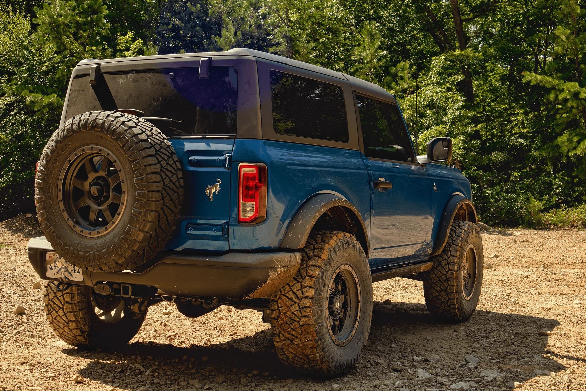

Ford Bronco Help choosing wheel offset 1632496290111
Damn! Those look GOOOOOD! Did you get an AMB to match?

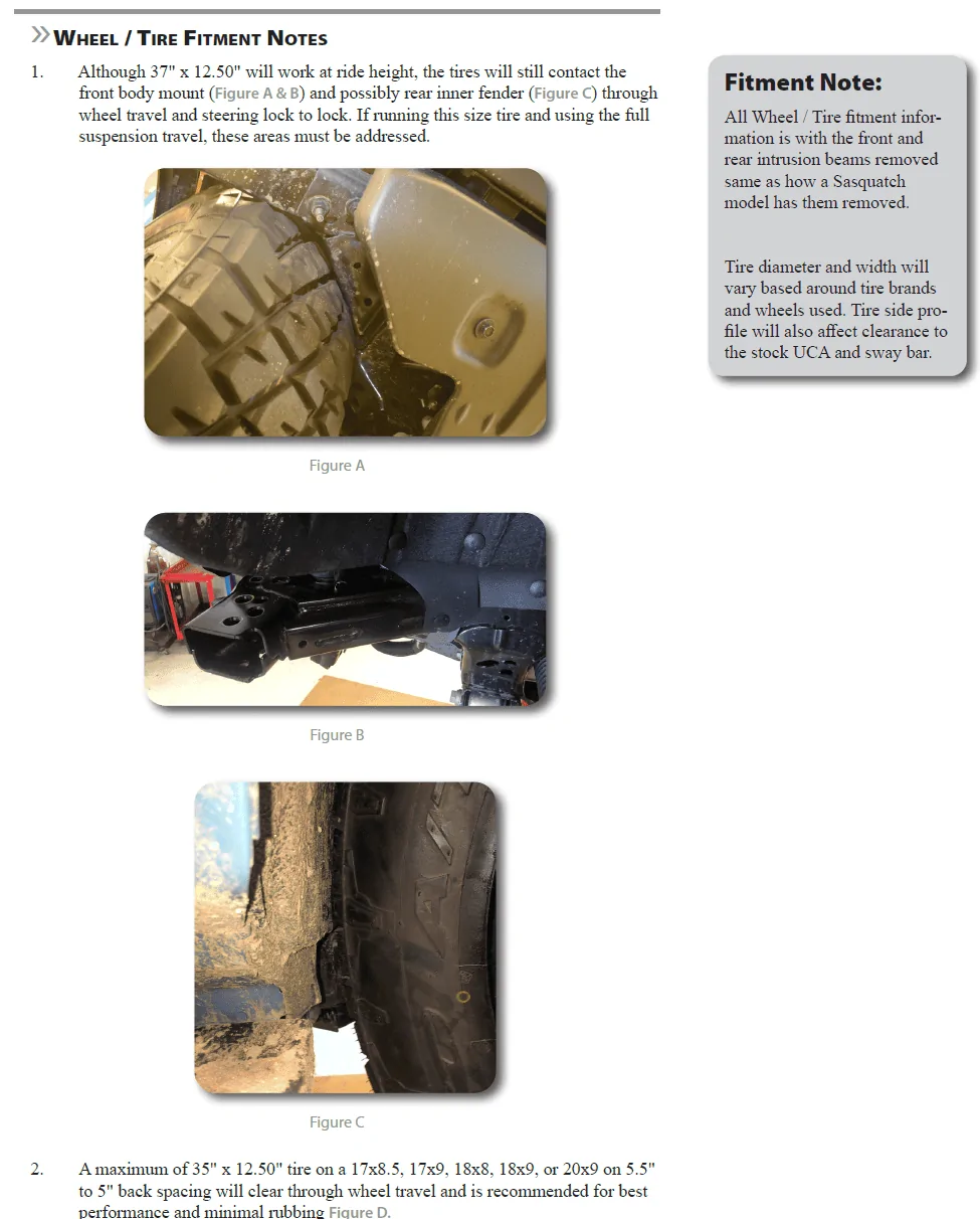

I have a Two door black diamond sitting at dirt mountain. I ordered the maxlider 4 inch lift kit and do not have the Sasquatch package. The maxlider package states “This kit will allow you to use up to 37x12.5" tires on a 9" wide wheel with up to -12 offset”
You'll need to take a look at the instructions that come with the kit for additional modifications needed for 37". The offset you choose may impact how much of the frame you'll need to trim. If only street or light trail use, this isn't an issue. Note that this isn't unique to the BDS/Zone kit - it applies to all 37" at suspension extremes. Note that the kit does not have any recommendations for 37" wheel offset.

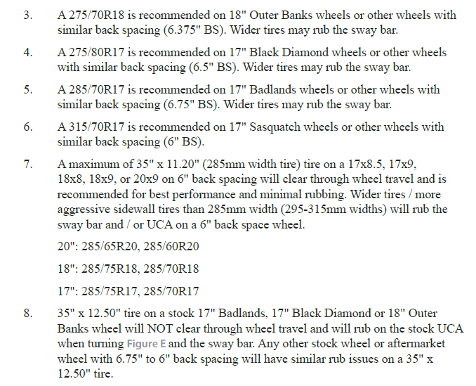

Ford Bronco Help choosing wheel offset 1632522129352
Do you know how to handle #8? say a stock Badlands wanting 35's with stock wheels, how could you do it, or would a wheel/offset allow it to be done with out an extra lift?
rtaylor
R
1,194
2,693
ID
19Raptor, 22Bronco
You could add 1" wheel spacers to the badlands wheels or replace with new wheels with offset similar to sasquatch. You might also want a Zone $60 level kit (raise front 1").

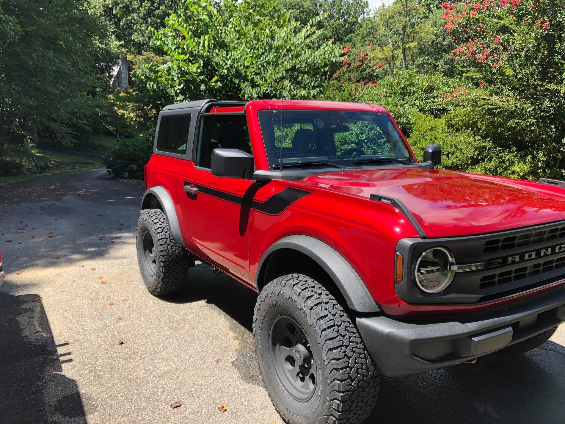

thanks, thats my main question, WILL small lift allow me to use +55 offset stock wheel, if not then i need new wheels WITH slightly different offset like +30 same as sasquatch, i hoped just small lift, however, a lift doesnt exactly do the same thing as offset on the wheels right? the 55 offset could still rub on the inside?

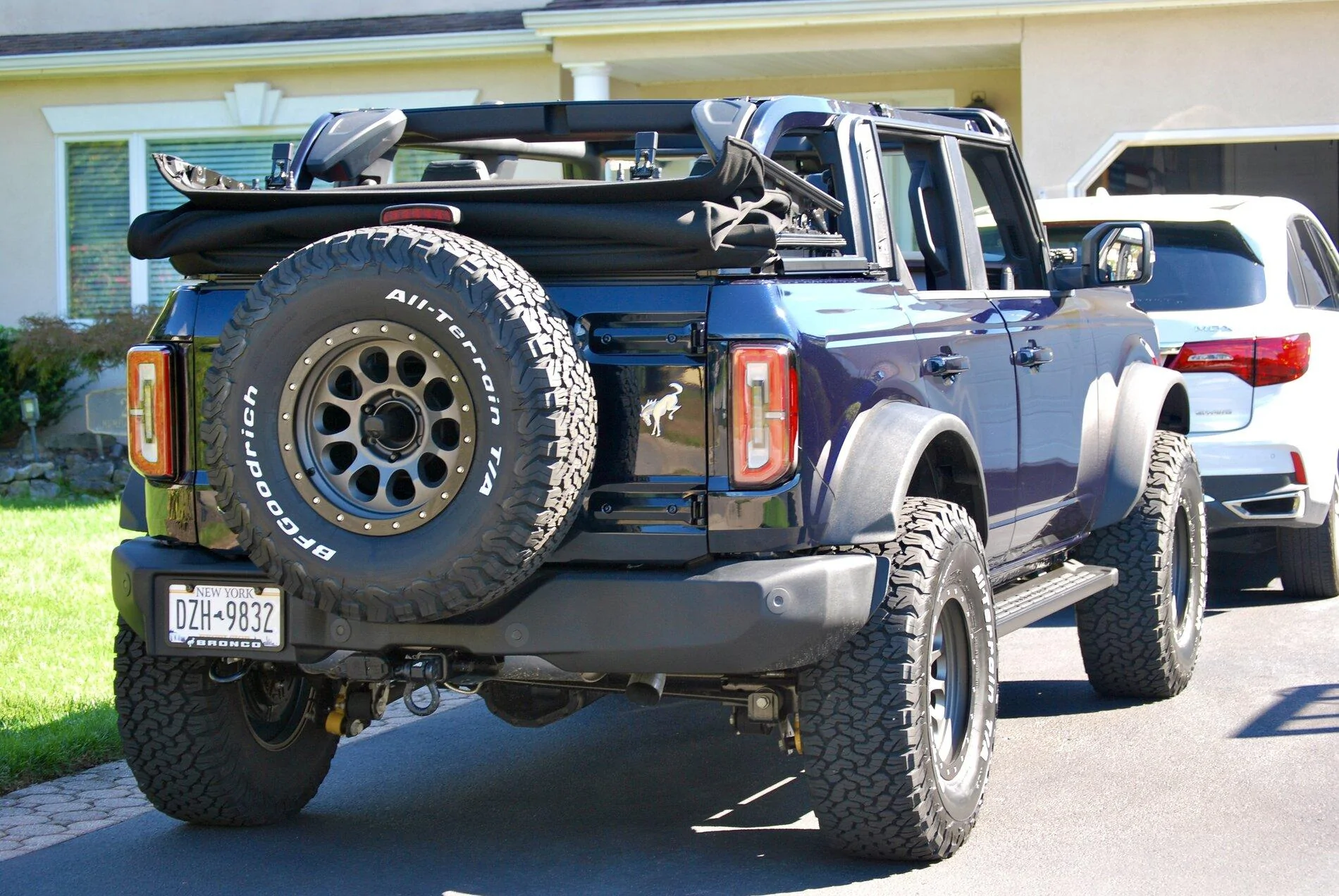

These are 35" K02's on SCS 17x8.5 -10 offset an OBX SAS. Also 1" Zone offRoad level kit.
