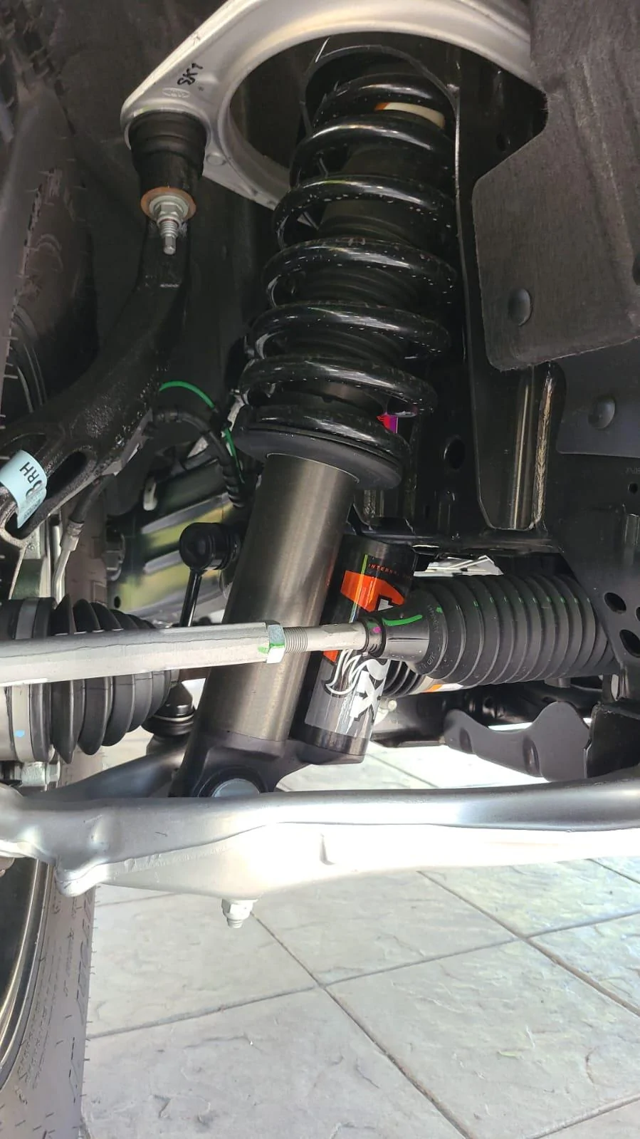

I guess if i have a wildtrack with Hoss 3.0, i can use this one? isnt the steering rack is the same ? or the rods change? anyone
you would need the standard bronco tie rod kit for that. The Bronco Raptor version are about 3" longer then the standard bronco version. we make both kits.
here is the link to the billet tie rod kit for the regular bronco. look the same in pictures but that link will get you the correct length tie rod.
https://www.foutzmotorsports.com/co...ories/products/2021-bronco-billet-tie-rod-kit
ok Perfect, yeah so the correct answer is they both share the steering rack, BUT differente Tie rod, make complete sense now.

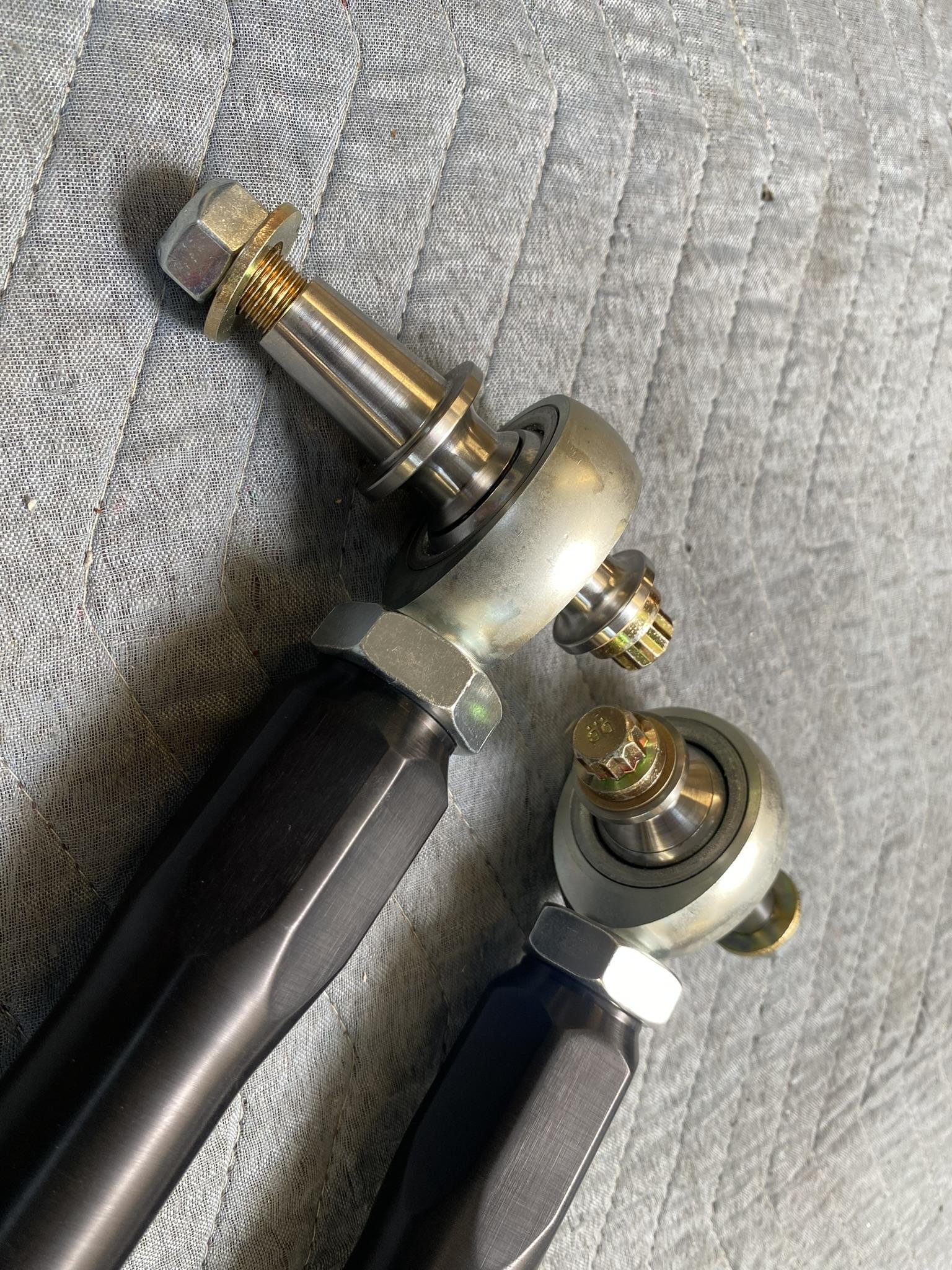

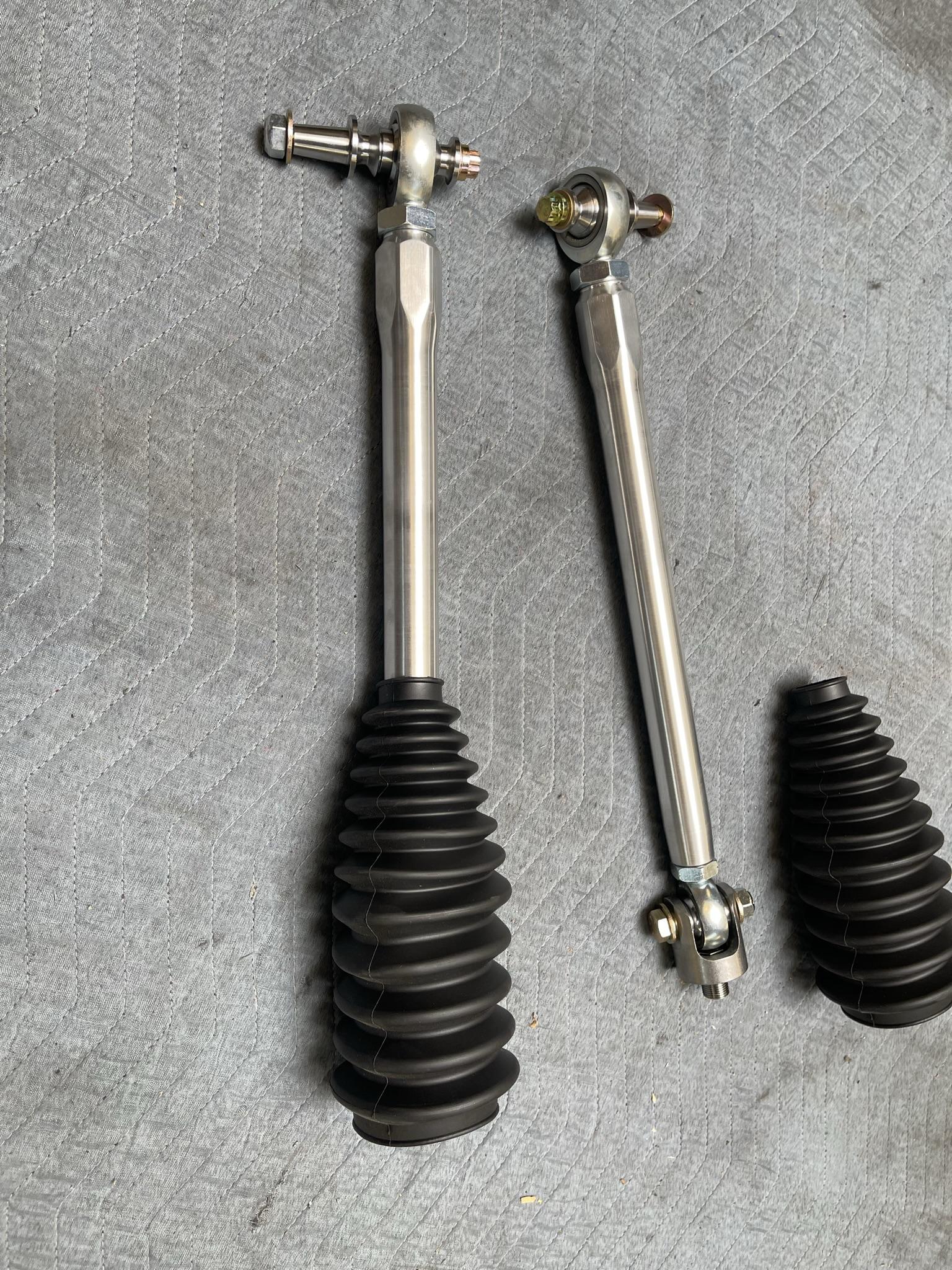

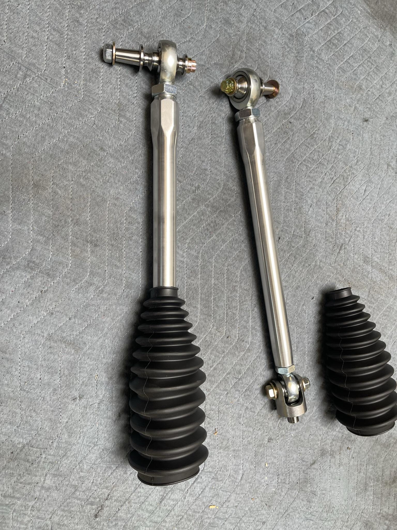

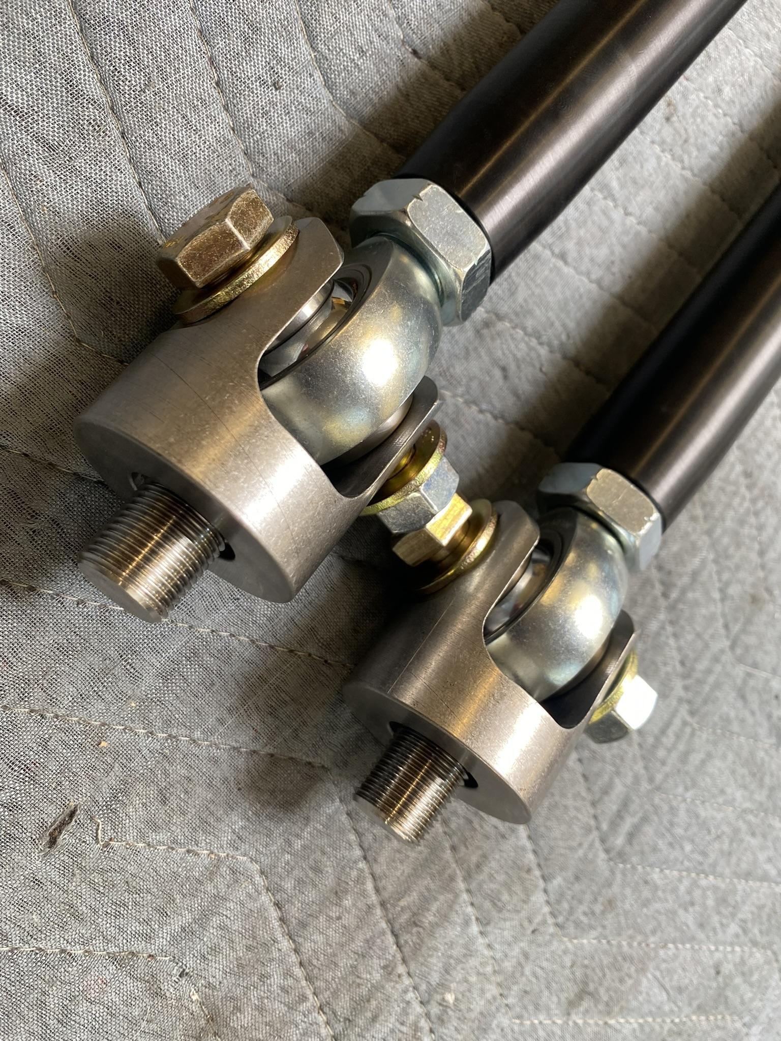

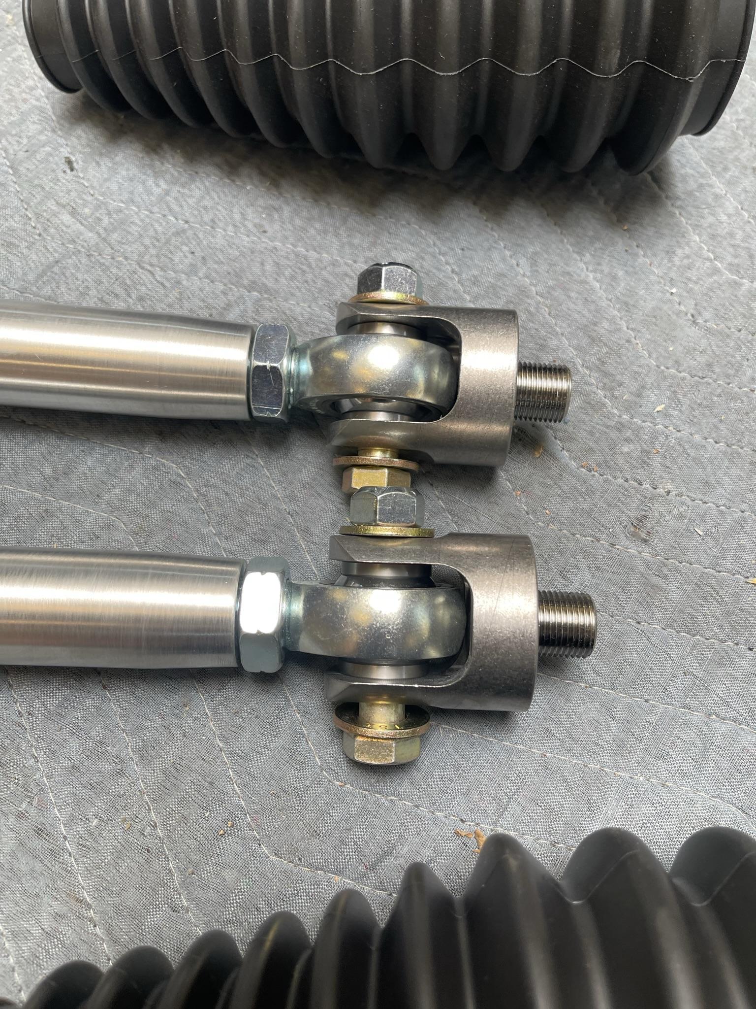

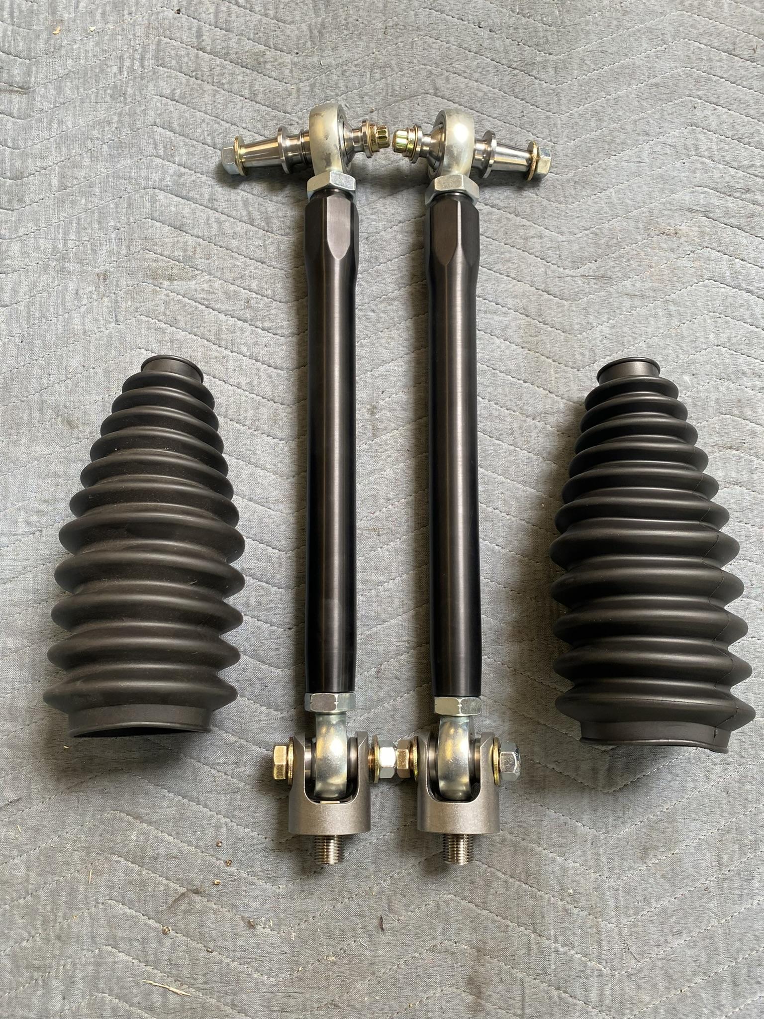

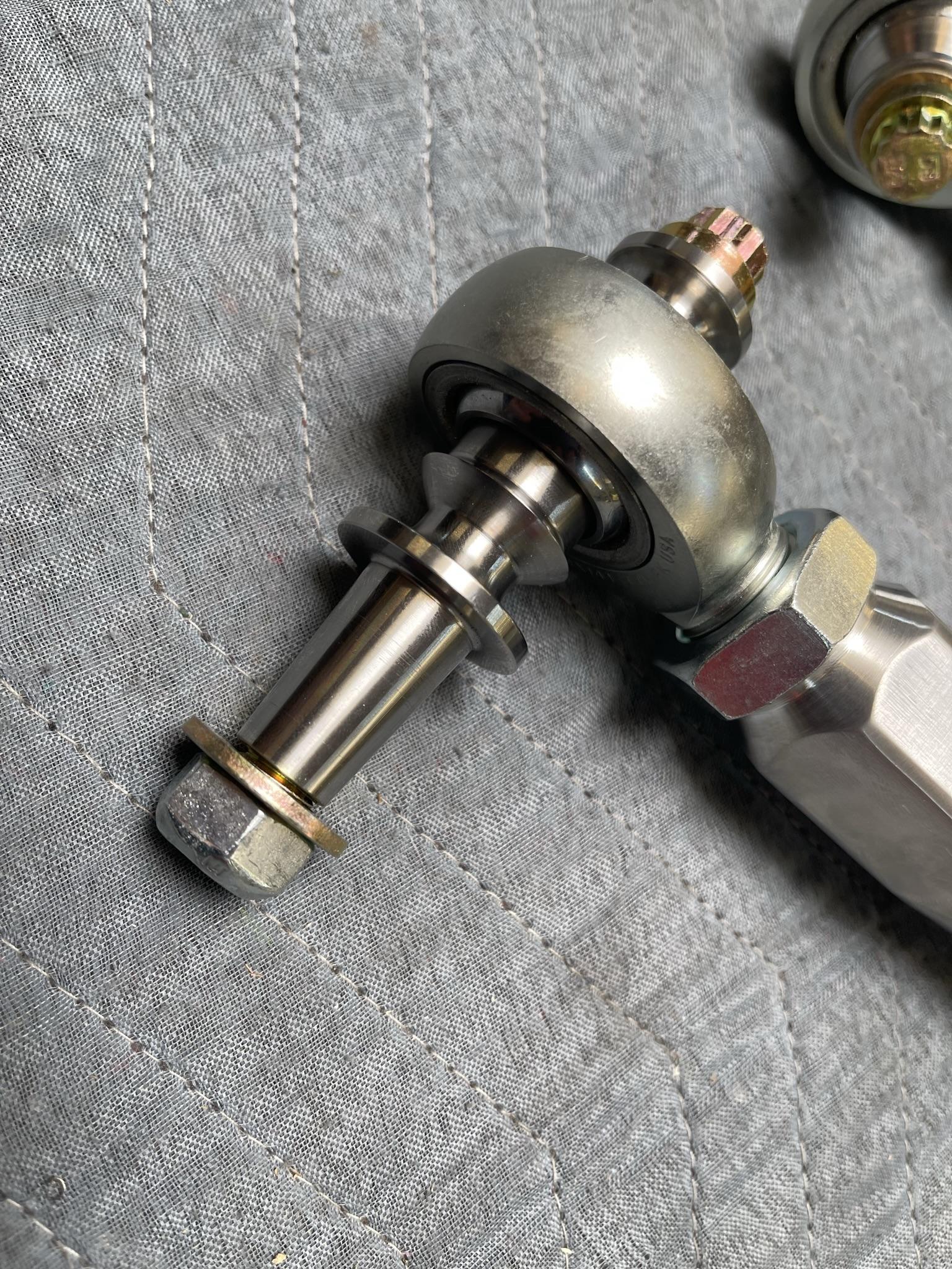

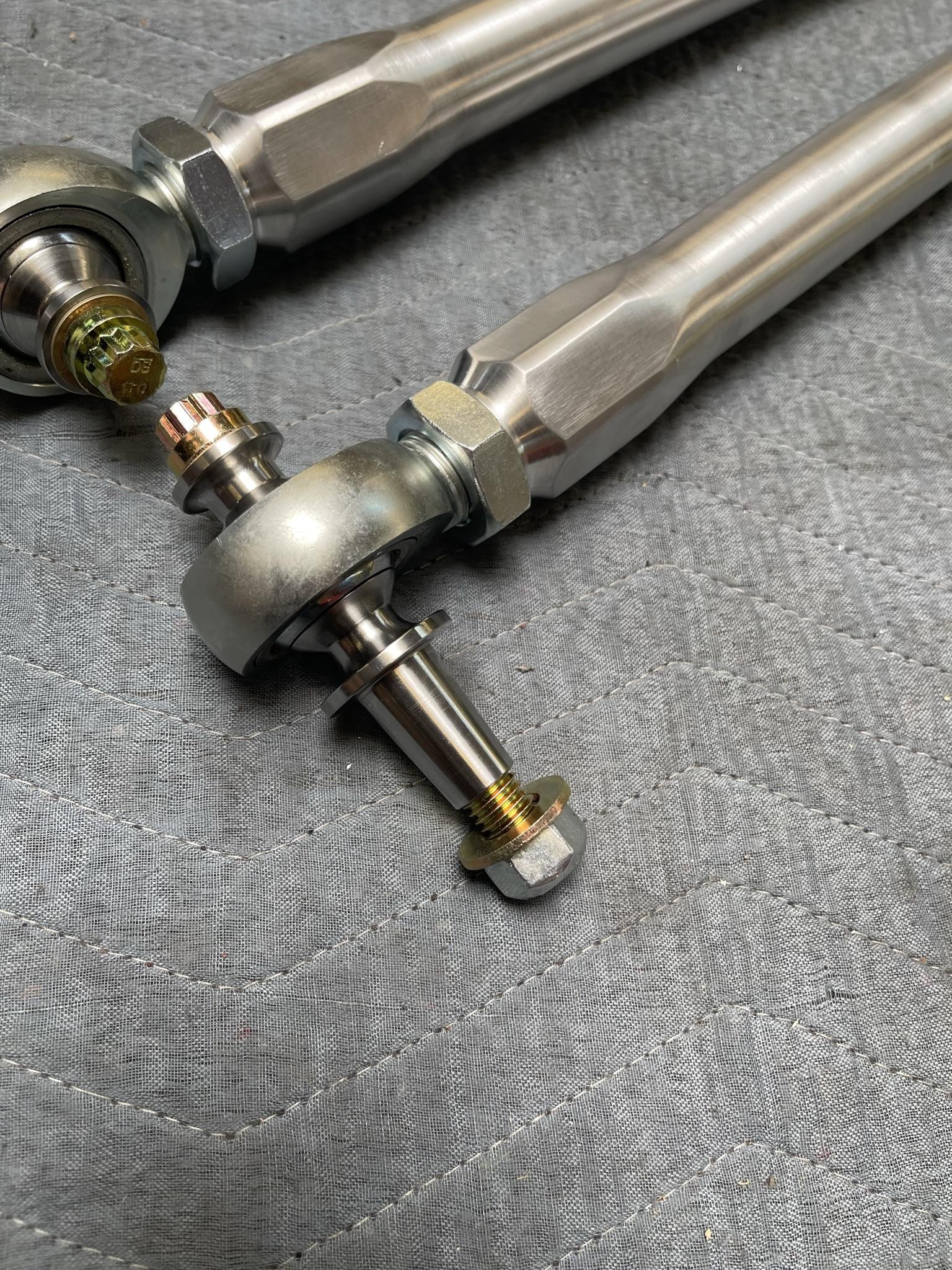

Our Bronco Raptor full billet tie rod kit is all done and ready to go. We have some in stock now in raw aluminum and some kits out getting anodized in a few colors. Fox Orange, Black, Blue if anyone wants those. We can do custom colors too if you want. Just let us know what you need.
https://www.foutzmotorsports.com/co...nco/products/bronco-raptor-billet-tie-rod-kit
Ford Bronco Bronco Raptor Billet Tie Rod Kit by Foutz Motorsports WhatsApp Image 2022-11-04 at 12.47.52 PM
ALUMINUM???? Even if this was heat treated 7000 series aluminum… it has the strength of mild steel….
Seriously…this is DOT approved….????
If so my hat is off to you… I not your going to kill someone!!!!
bad idea…
racing is one thing …. Those parts are swapped out continuously….but parts for a street car are something else….
You guys should know better!!!

With all due respect, we have run these billet tie rods on raptors for years with no problems. they are more durable then the stock ones. You are entitled to your opinion obviously.
Lake Tahoe Traveler
Jul 21, 2021
180
529
Sf Bay Area, CA
2022 Bronco 2dr BL SASQ, & 1975 Bronco Ranger
yea… over Twenty years working g in a DOE/ University of CA/LBNL Material Science Laboratory and a decade or so of Racing fabrication ….might give “my opinion” some credibility!!!!
IMO I respect you and your business!!!
I’ve just been involved in enough Failure Analysis law suits to realized what is at stake for you!!!!
You don’t deserve to lose everything you have work so hard to attain just because it is easier to machine aluminum.
I hope this makes sense.

I agree why would you use aluminum in this application, cheaper to produce, easier on the production machines?

the size of the parts have some relativity on these. The inside rod ends are 3/4" thread and the outer rod ends are 7/8" so the main body of the tie rod is much larger than the stock or similar parts. We have been using the billet aluminum tie rods on the heavy trucks for years with great success. Including our race trucks. I appreciate the concern and none of us ever want dumb legal problems for sure so thank you for explaining more.
This video is from a clip of testing in our Trophy Truck Spec truck with a similar tie rod.
