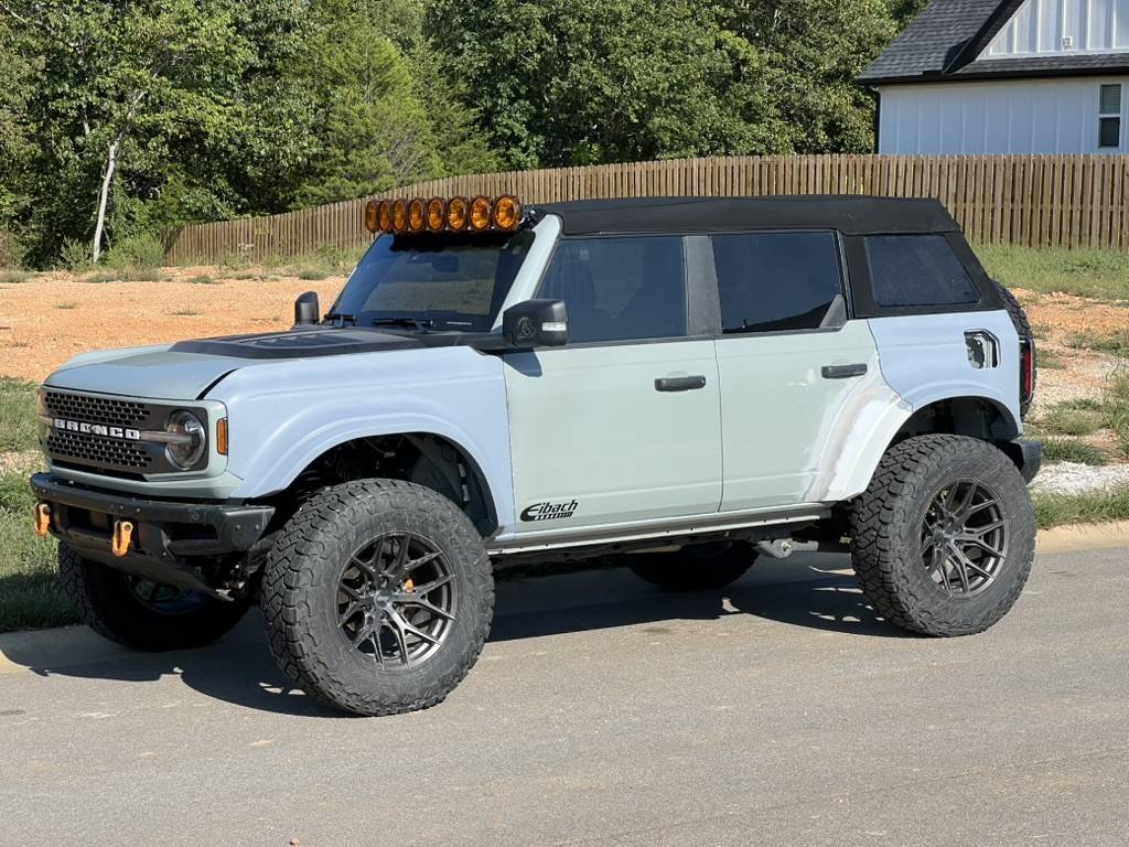

After a few trips I did a small build and went to Colorado with Toyo Tires to get content for a new tire, the RT Trail.
Ford Bronco Bronco Truck Build 1748927725460-iw
Ford Bronco Bronco Truck Build 1748926941721-3e

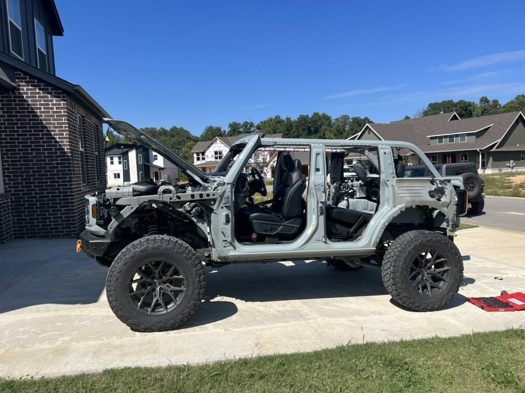

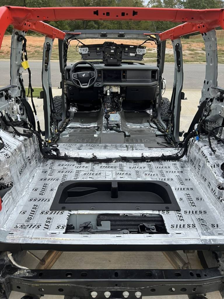

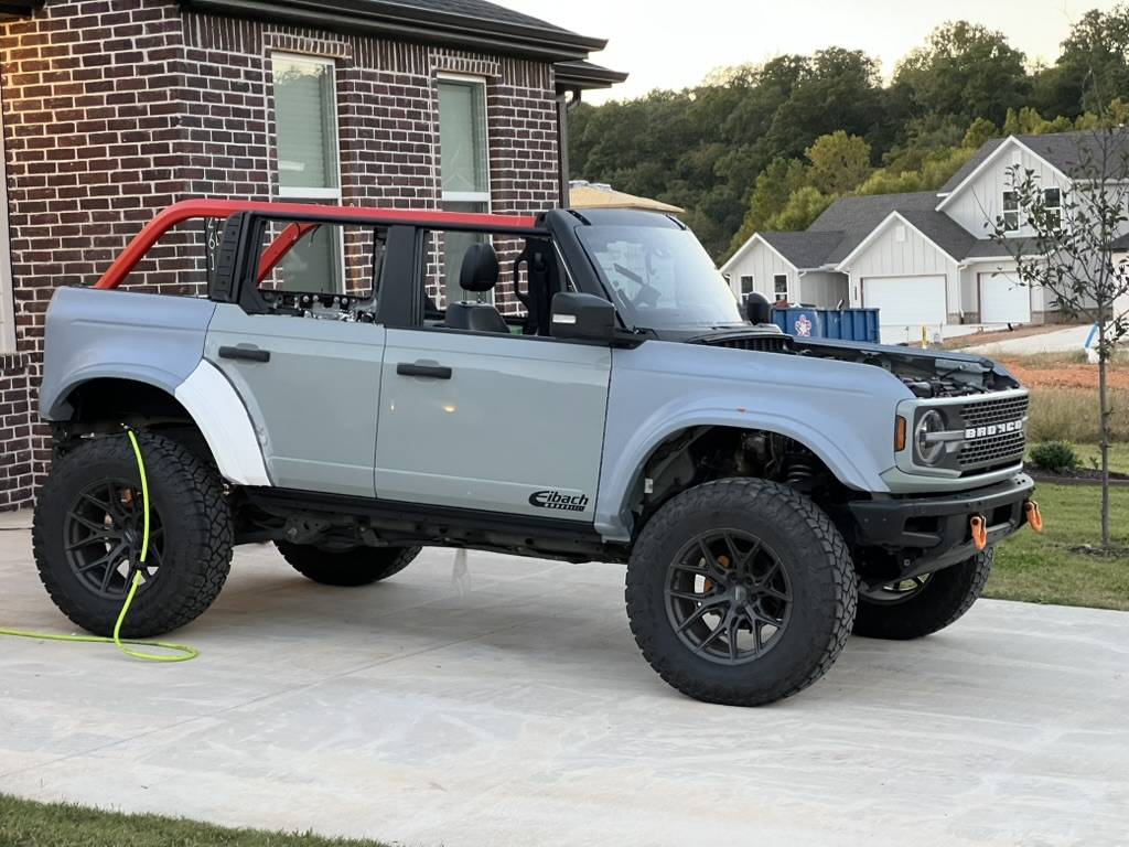

Next I progress to do full ADV Fiberglass, this was the start of my broncos deconstruction....
I wanted to blend the door panels and fiberglass....
Ford Bronco Bronco Truck Build 1748926872178-jf

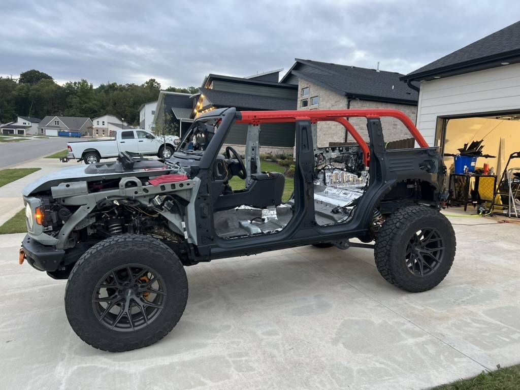

I figured, "Hey, I might swell do a few other things while I am making dust"
Ohhh boy,
Ford Bronco Bronco Truck Build 1748928903614-cc
Ford Bronco Bronco Truck Build 1748928946009-t
Ford Bronco Bronco Truck Build 1748928991068-cb
Ford Bronco Bronco Truck Build 1748929012899-i2
One step forward
Ford Bronco Bronco Truck Build 1748929076036-q8
Several steps back...

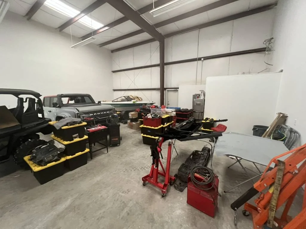

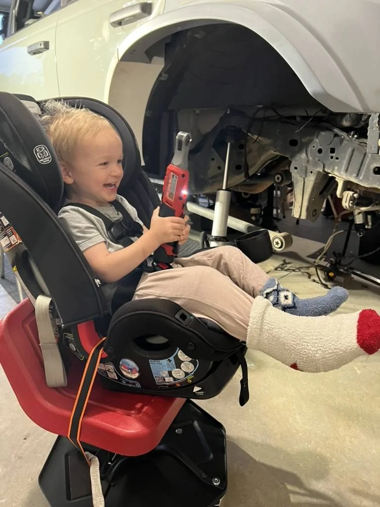

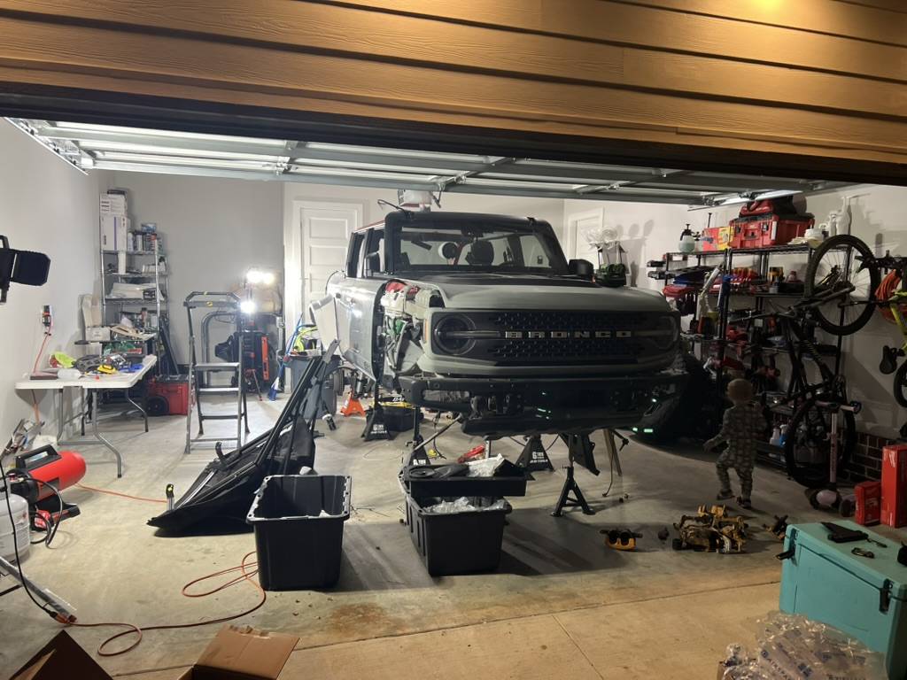

And I got a shop to work on my projects..
Ford Bronco Bronco Truck Build 1748930171727-d6

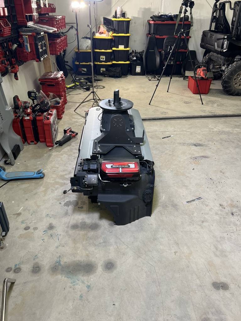

Well I got all this space. But so much time has past between what I originally wanted, and now...

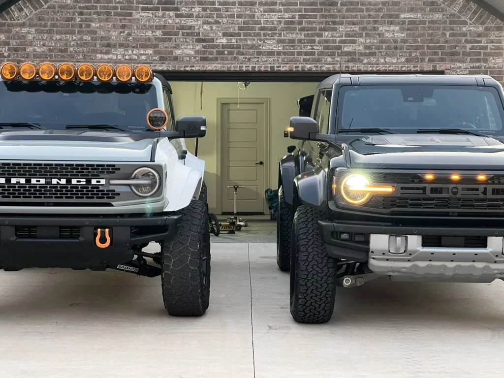

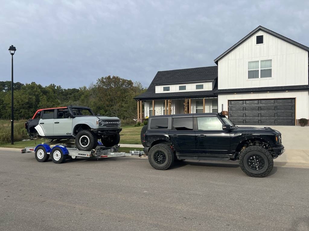

And who needs two broncos? I already have a Bronco Raptor... What I am really missing is a truck...

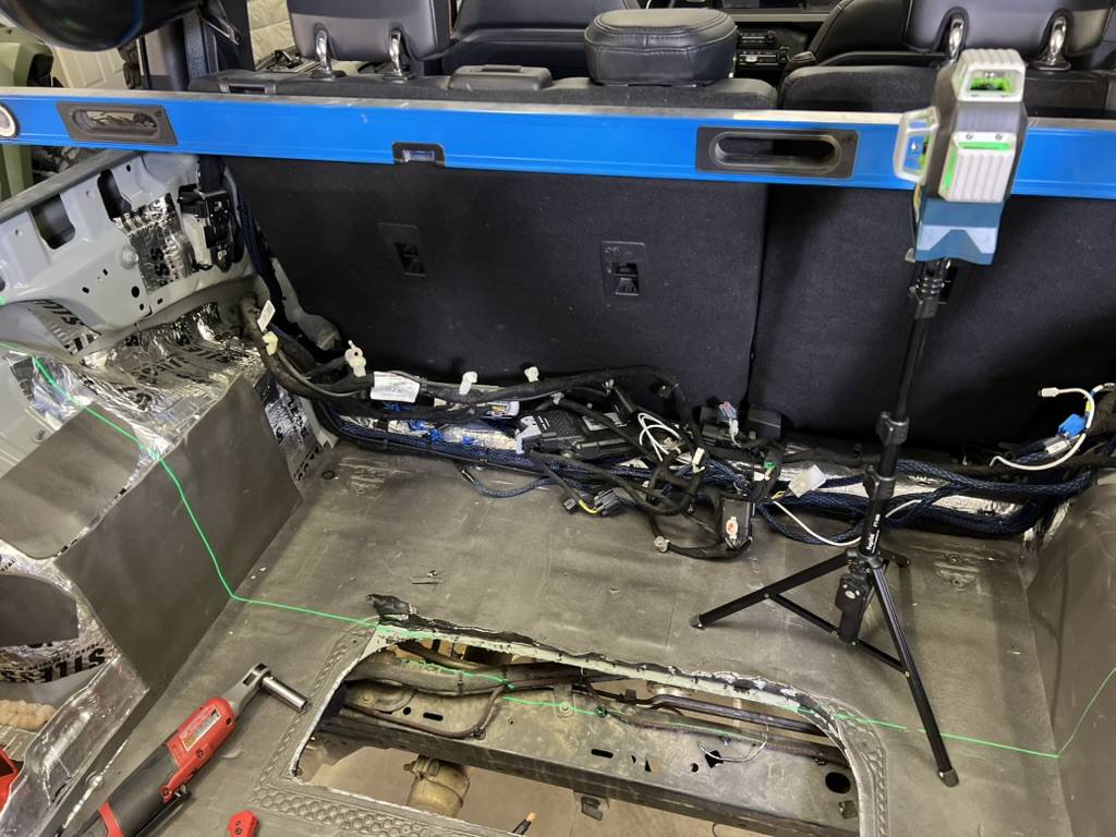

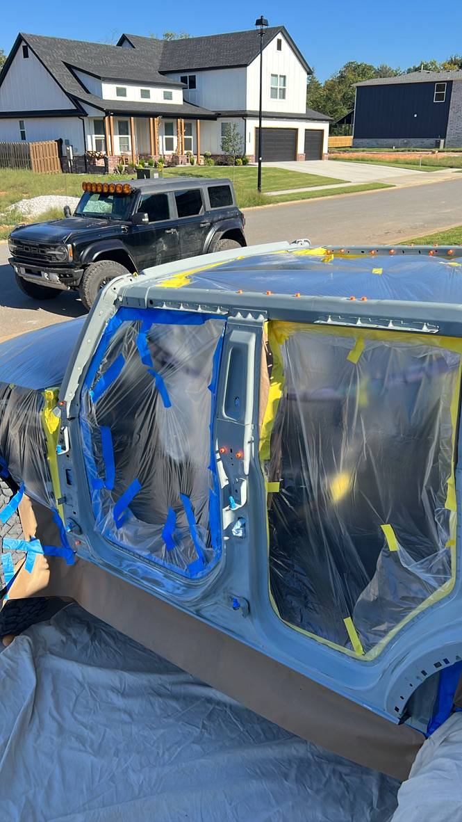

Line a few things up...
Ford Bronco Bronco Truck Build 1748930571000-r3
And Viola!
Ford Bronco Bronco Truck Build 1748930606143-sn
Ford Bronco Bronco Truck Build 1748930647140-n8

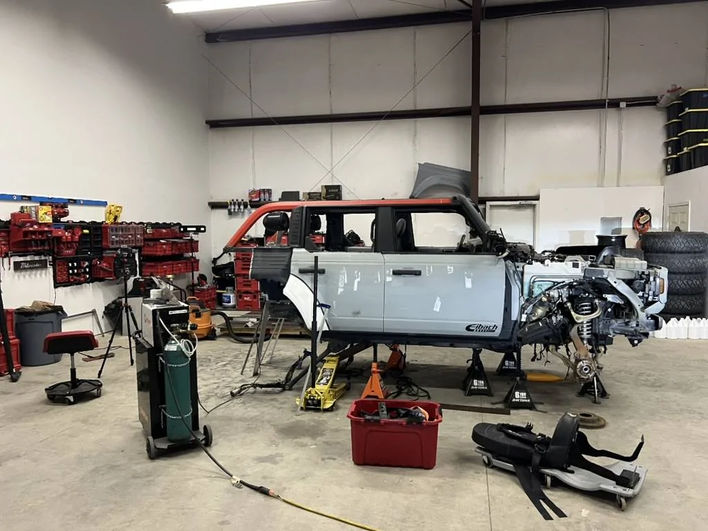

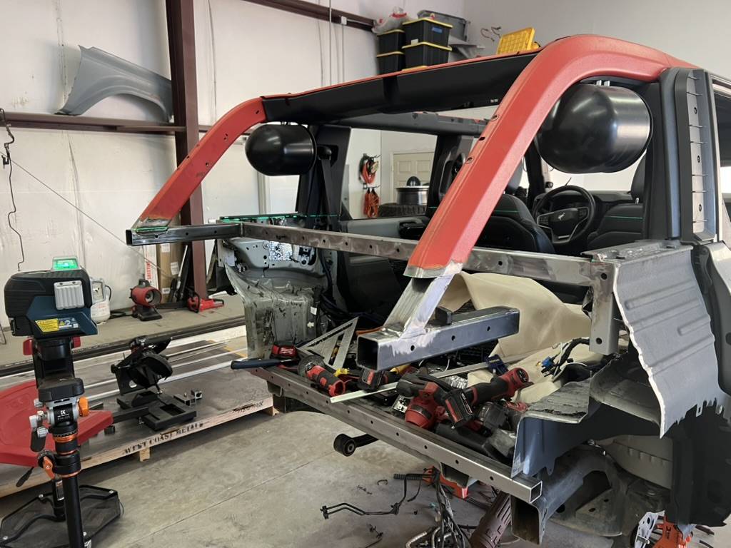

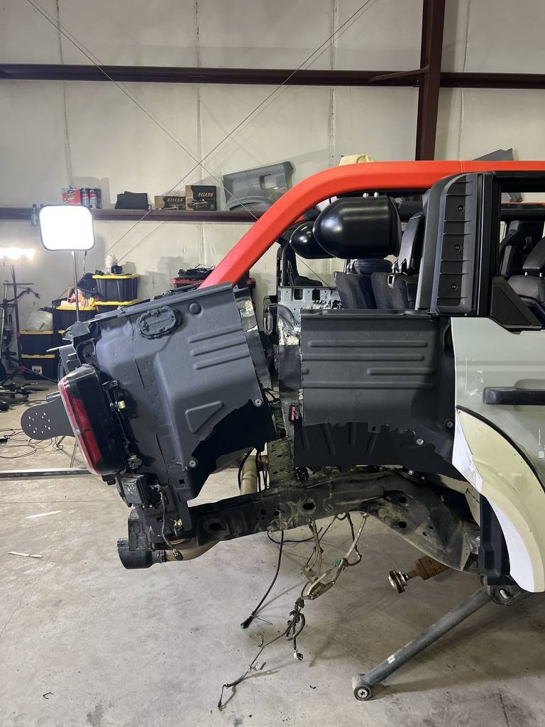

Shoot... Now what? no turning back!
Ford Bronco Bronco Truck Build 1748930701284-gx

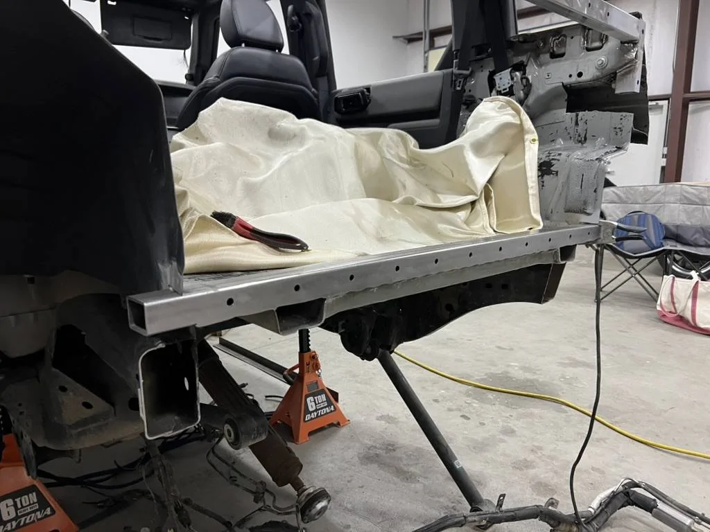

Measure twice, cut once, repeat..
Ford Bronco Bronco Truck Build 1748930774654-mu
Annnd cut some more...
Ford Bronco Bronco Truck Build 1748930814726-eu

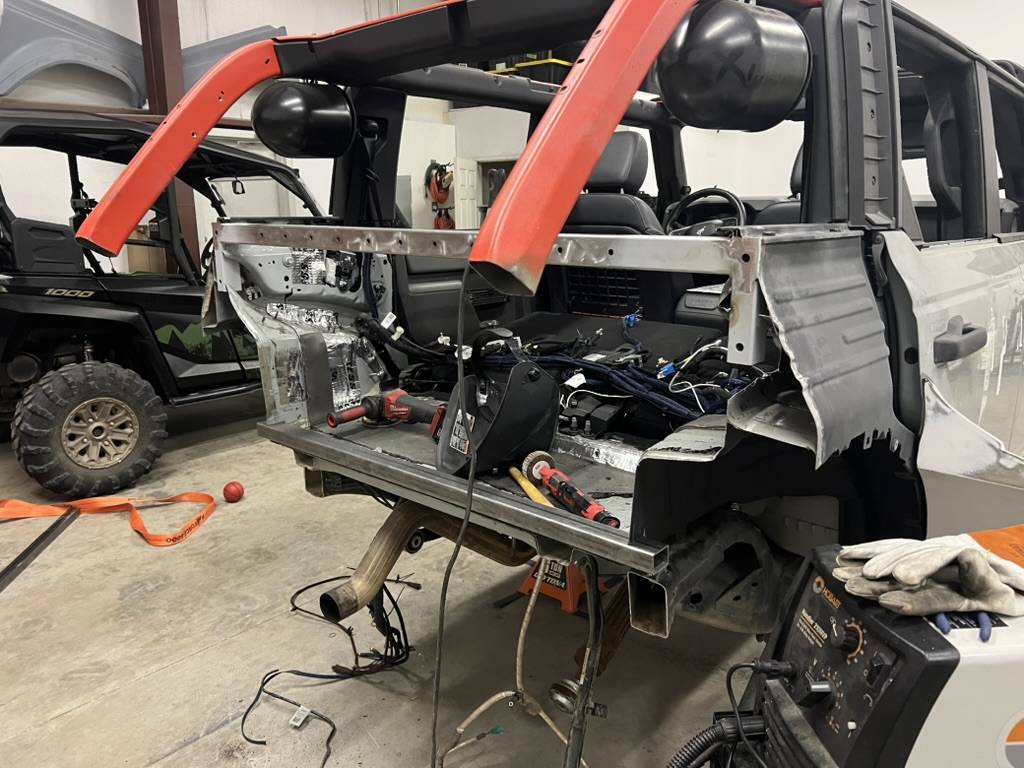

Start welding in...
Ford Bronco Bronco Truck Build 1748930870546-hh
and weld some more....

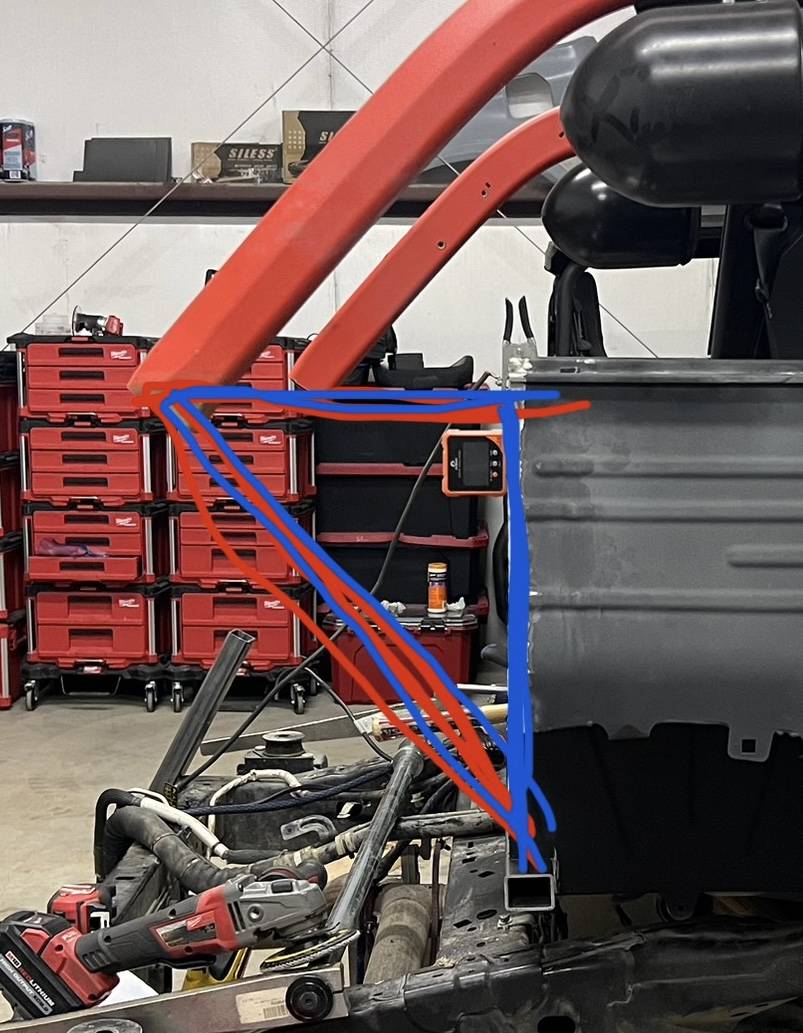

(The roll bar is boron steel, to keep it structural I sleeved it with 10" of steel inside because you will loose strength when welding to the heat treated boron.)

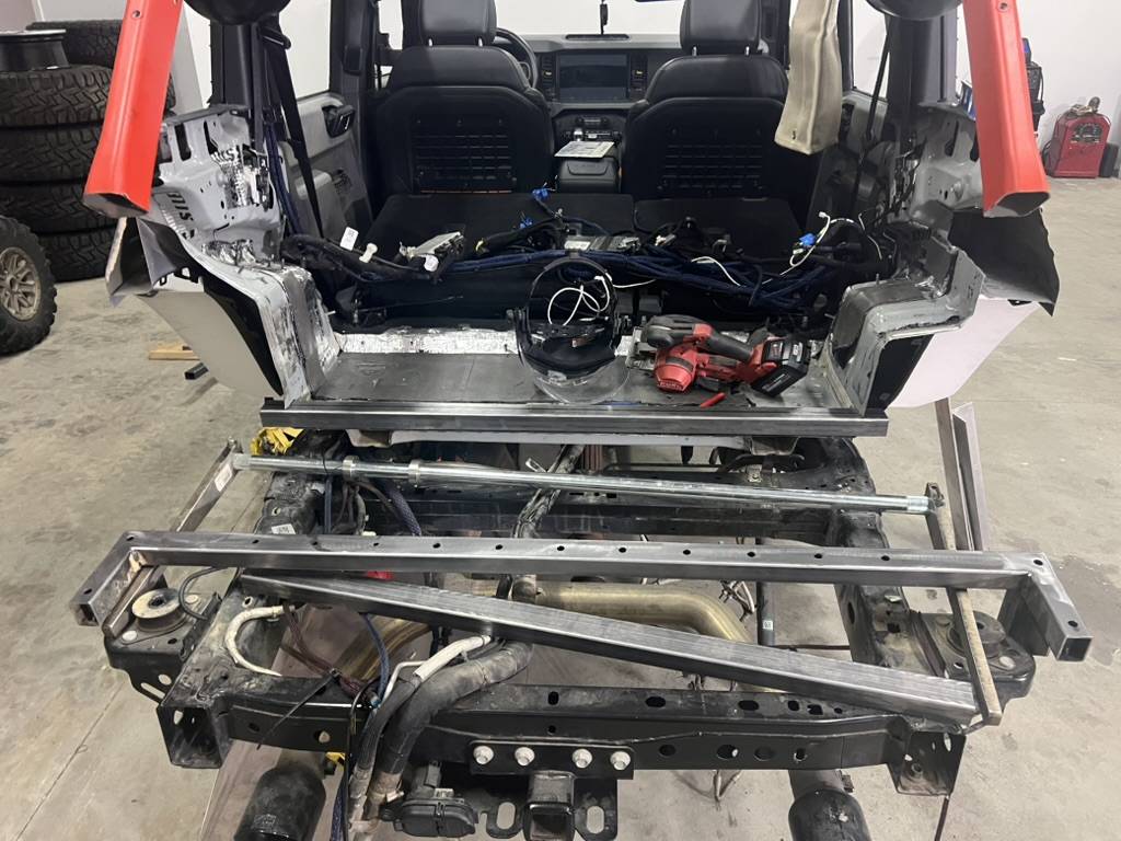

Ford Bronco Bronco Truck Build 1748930916011-18
The key is you MUST make really detailed plans..
Ford Bronco Bronco Truck Build 1748930990139-oy

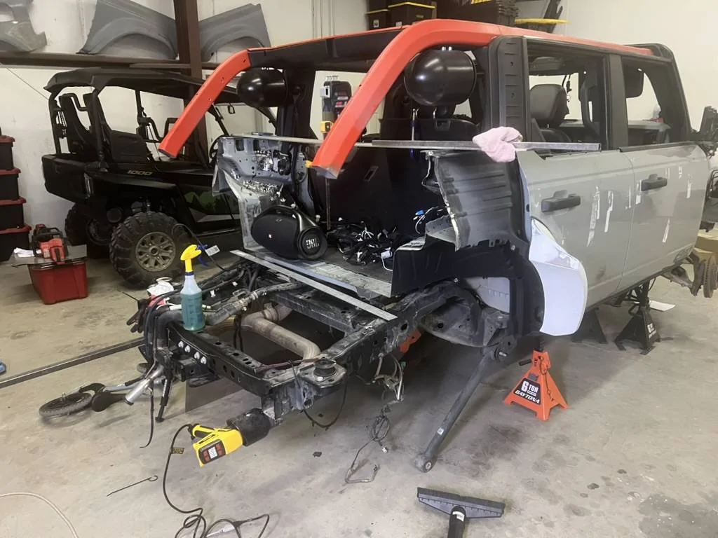

This is how she sits as of this weekend, we're finally building more than cutting!
Ford Bronco Bronco Truck Build 1748931078447-ot

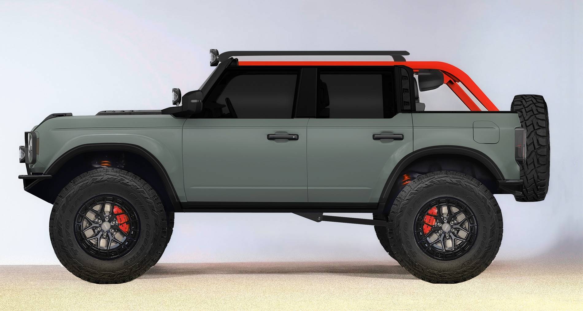

Now, here is the plan, or as much of it as I can share... The plan is to do the full reveal at SEMA..
The bed will overall "appear" to be 5', however I am keeping 1' "inside" the cabin to house the electronics, sound system, and dry storage.
Wheelbase is around 117", roughly the same as a 4dr f150 short bed.
40-42" tires without rubbing.
Front will sit around 4"-5' wider per side and moved forward 1.5" for cabin clearance.
Front buckets will be cut out and custom towers made to support the long travel coilovers.
Rear is getting long travel triangulated 4 link and a wide axle to match front.
Rear frame moved up 4" under the bed area to allow more travel.
Custom 40gallon fuel tank behind rear axle.
The bed itself will be aluminum construction to help save some weight ( with composite bedsides)
The bed is not separate from the cab structurally, it bolts to the structure you see in the photos.
The entire body (bedside, tailgate, fenders, door skins, hood) is my own design ( I can't share that yet) and will be 3d printed to make molds and ultimately a composite exterior.
Full belly skids
Custom bumpers
Engine mods
Sound system ( I already did it and then I cut it all out when I chopped the rear)
Lots of other details but that will all come with time...
