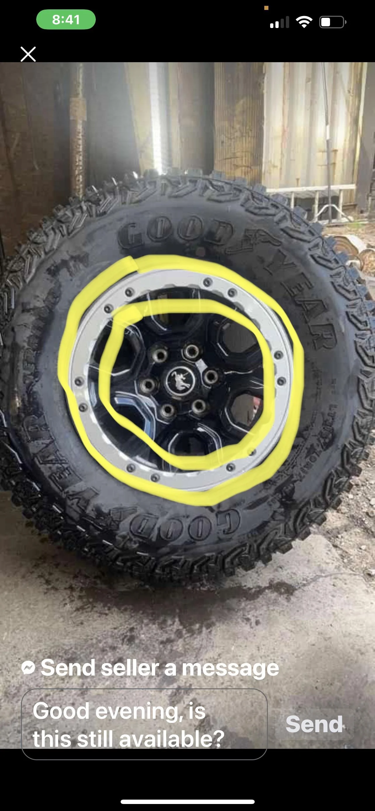

Hi. Can these be removed? If so, what's under them and how can I remove them? Thanks in advance!!

You can remove them, but then you will have a bunch of exposed bolt holes. 24 to be correct.

I'm getting them coated. Do you know what tool I would need to remove them? Sorry, not a tool person. Thanks.

Yes. Many of us have had them color matched. Personally sent mine to a painter and drove without them for a week.
I used my cordless impact drill. Some were tough. They have loctite on them.

If you're removing them yourself, I highly recommend spraying them with a penetrating fluid like Liquid Wrench, waiting a few minutes for the fluid to do its thing, and then slowly removing them by hand. I do not recommend an impact wrench.

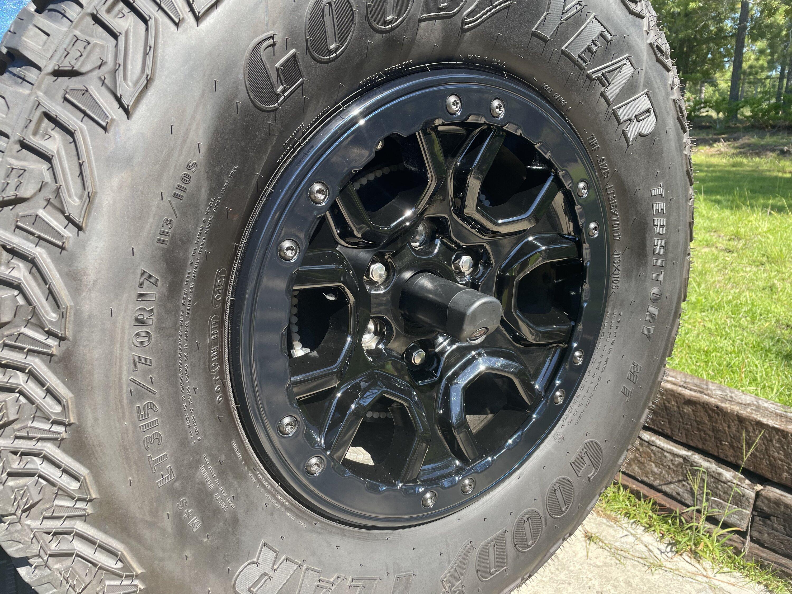

This is what it looks like when you remove them. Took this picture when I removed them to be powder coated black.
