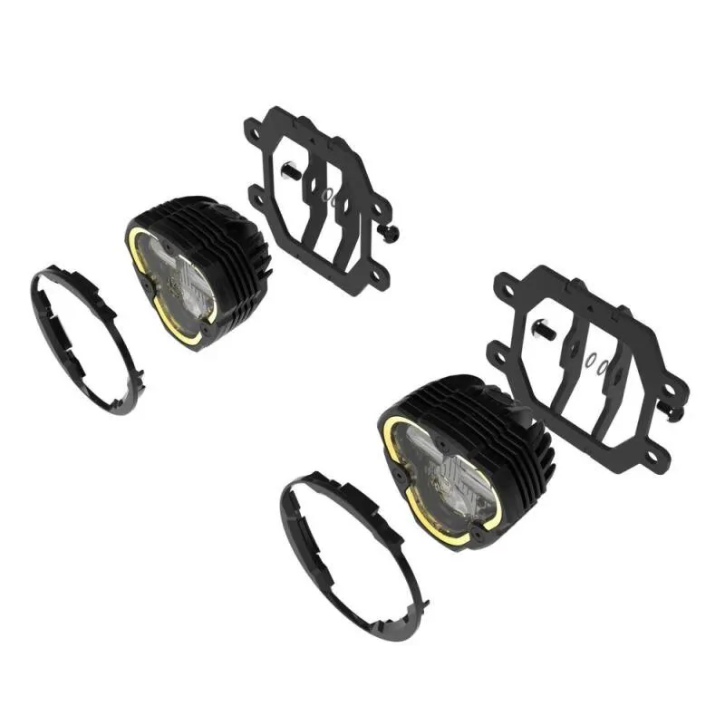

Jeep JK/JL/JT Plastic Bumpers
Ford Bronco Capable Bumper Foglight mount 1749565534976-xf

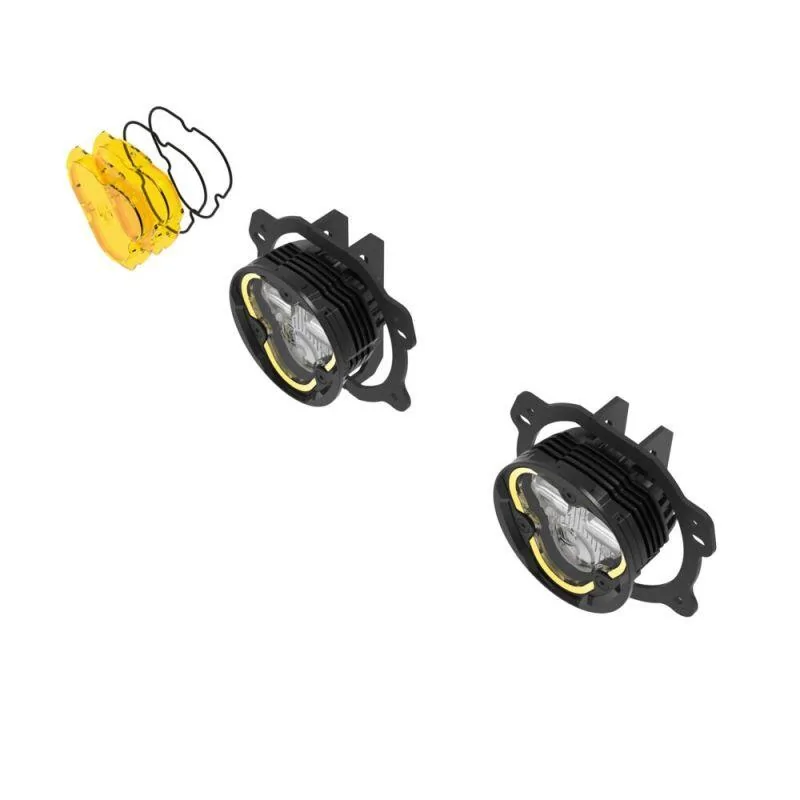

Subaru Crosstrek/Forester
Ford Bronco Capable Bumper Foglight mount 1749565623496-6
3rd Party Capable Bumper compatible fogs
Ford Bronco Capable Bumper Foglight mount 1749565701146-n

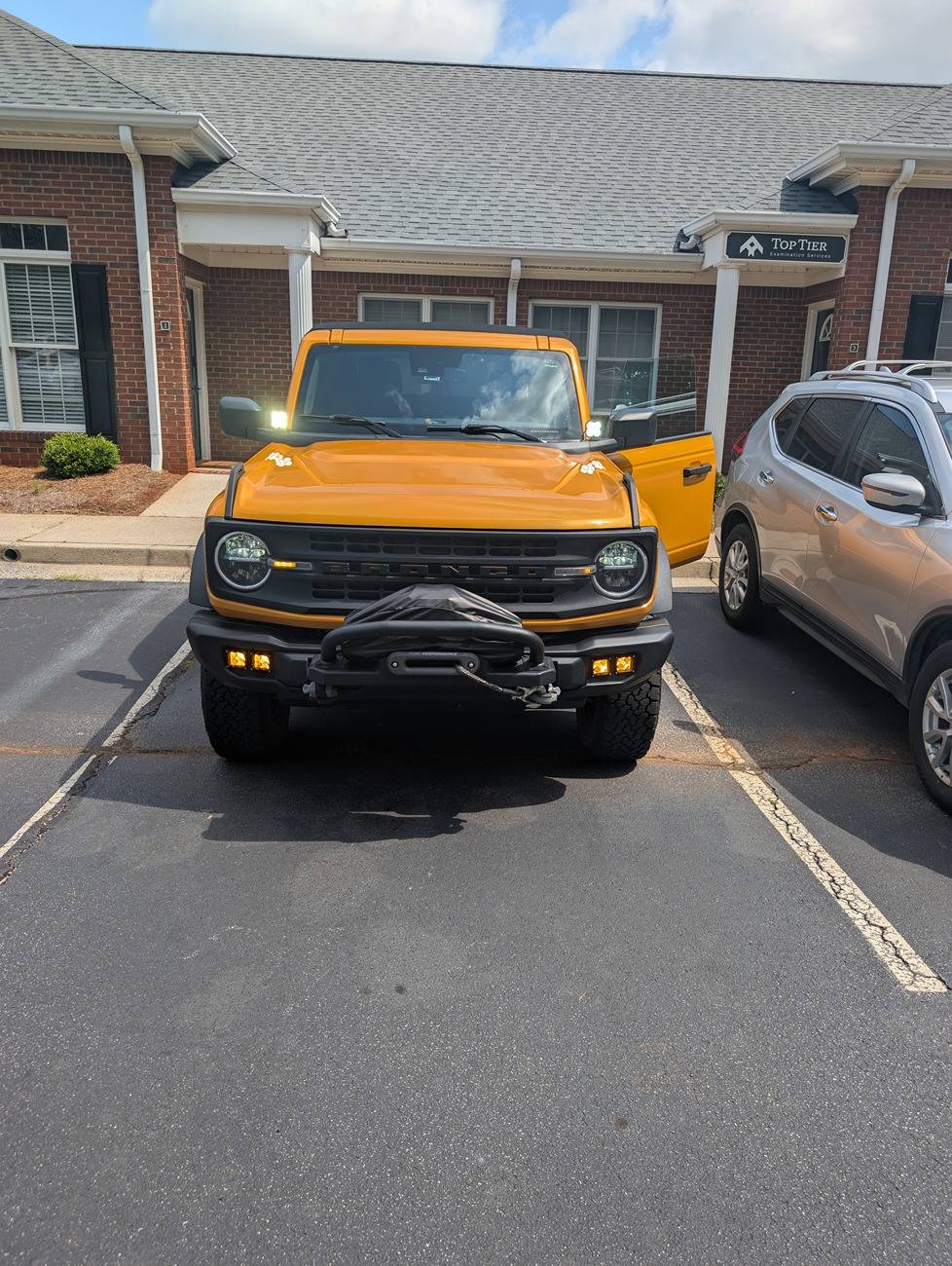

I just went with amber on the fogs if the ditches are white and save the headache and solve the color temp issue.
PS don't skimp on the fogs. I went off brand and am only content with them.

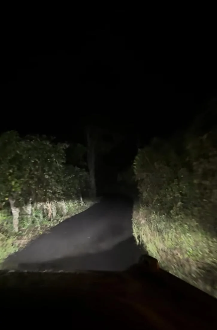

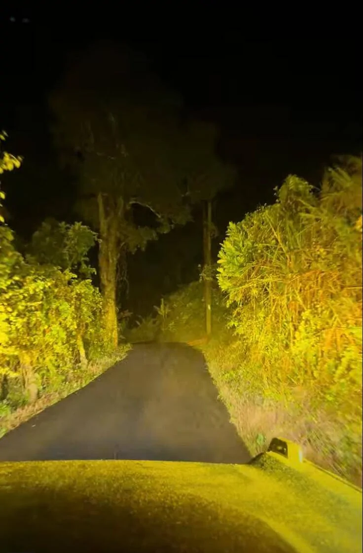

Not the best pictures but it shows how much extra lights The Flex era 3 adds
Ford Bronco Capable Bumper Foglight mount 1749570592779-8c
Ford Bronco Capable Bumper Foglight mount 1749570774258-hc

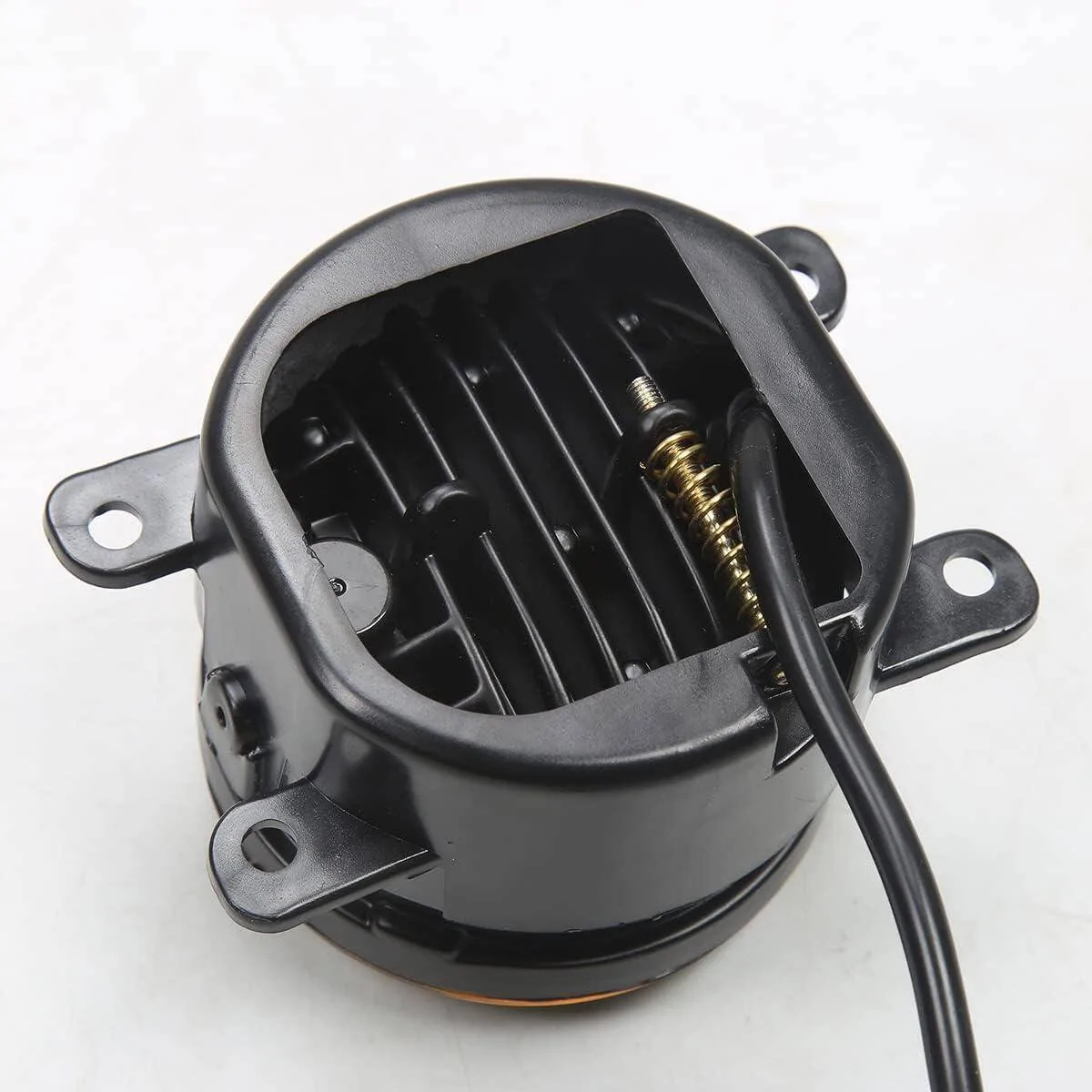

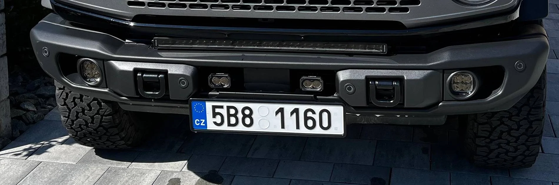

Hello, I bought this mount on Amazon. (https://www.amazon.com/gp/product/B0DRYP5XJN/ref=ox_sc_act_title_1?smid=A28LSN5QPAAAAL&th=1) I have different fog lights installed, but I think it's about the bracket spacing, which is the same for Ford, Subaru, Honda, and Nissan. So, I assume that if KC Lights offers a mount for Subaru, it should definitely fit the Bronco Capable Bumper. Have a great weekend across the big pond :)
You made mi Day sir!
This is exactly the piece of info I needed to Know. Thanks!

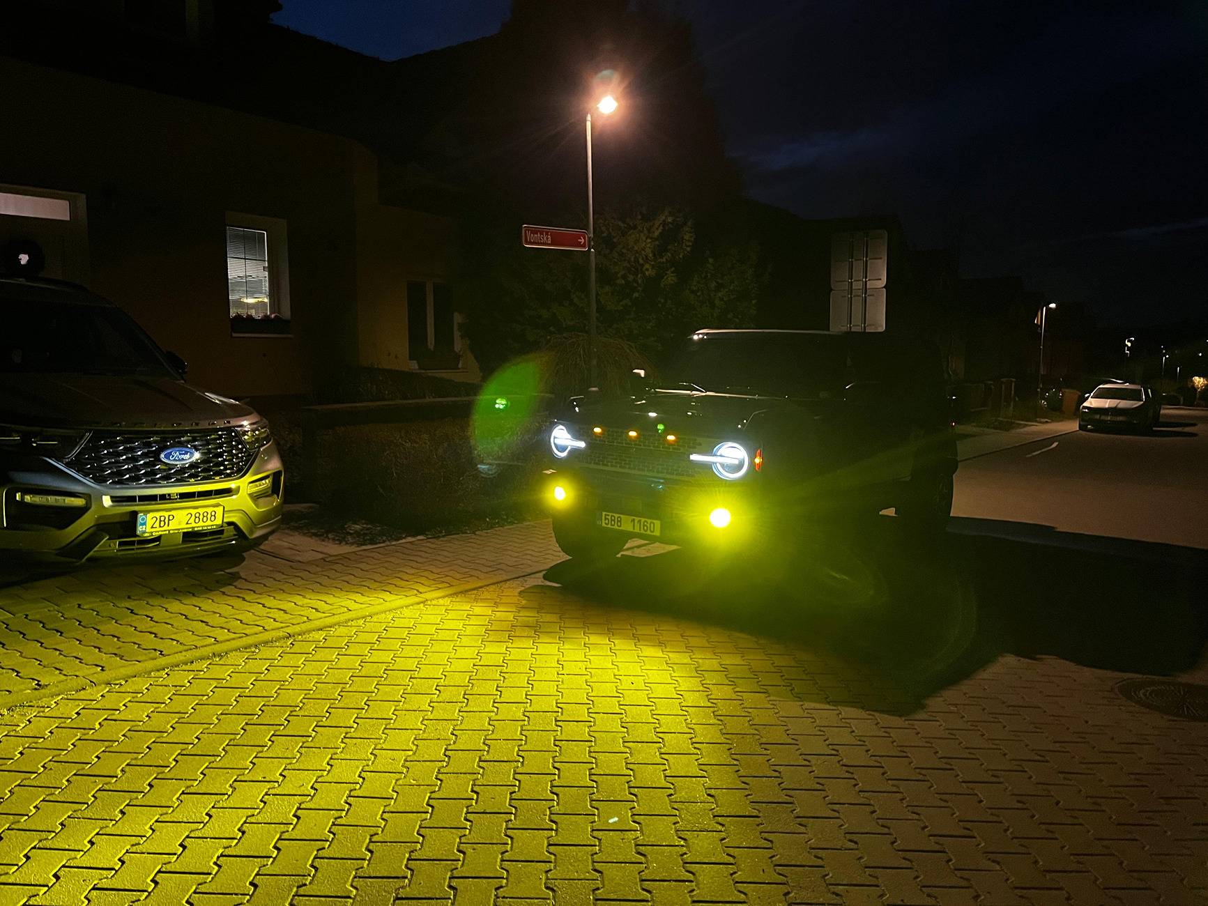

Hi everyone, In place of the original fog lights, I used the following lights: (https://www.amazon.com/dp/B0DPSG1STY?ref=ppx_yo2ov_dt_b_fed_asin_title&th=1) I'm using them as daytime running lights and high beams, wired through a relay and set to activate automatically with the OEM high beams. (Note: it's necessary to disable the “fog lights on with high beams” function via ForScan — here's the video I followed for wiring; it works reliably.) I mounted the fog lights in the center of the bumper. The lights I used ( https://www.amazon.com/dp/B0DDXJ226Q?ref=ppx_yo2ov_dt_b_fed_asin_title&th=1) are not large, which ensures enough space for air to flow through. As fog lights, I'm satisfied — the build quality is excellent in my opinion. I have the fog lights connected to the internal AUX.
