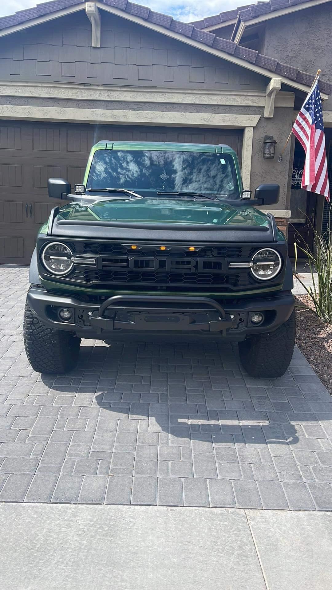

Can confirm the v1 Mabett/ IAG mount fits on capable bumper. Need to trim plastics for final fitment.

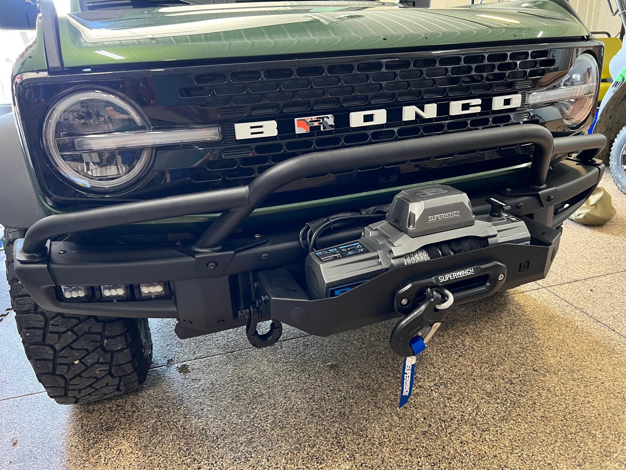

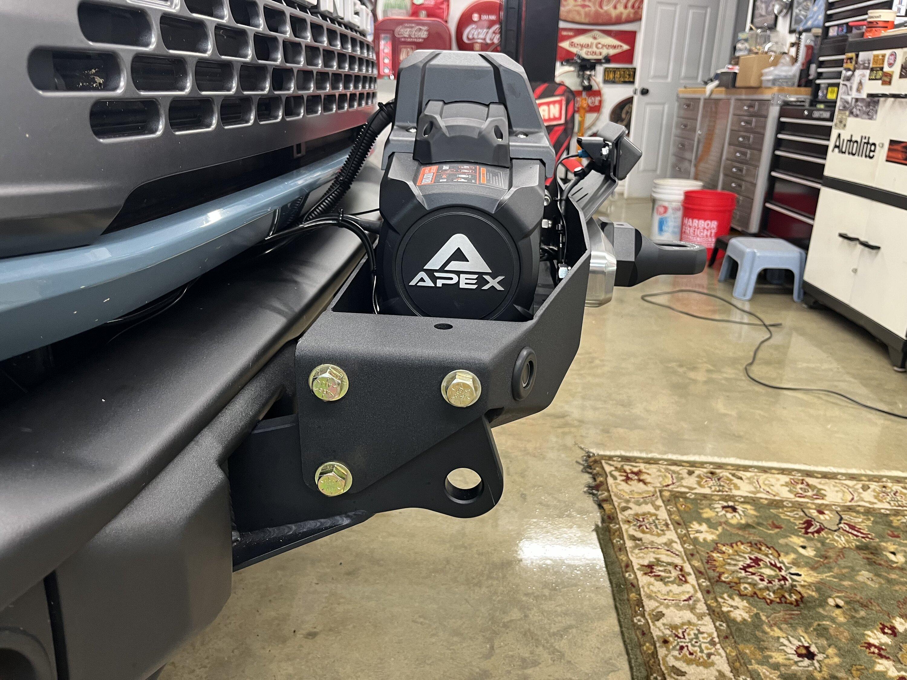

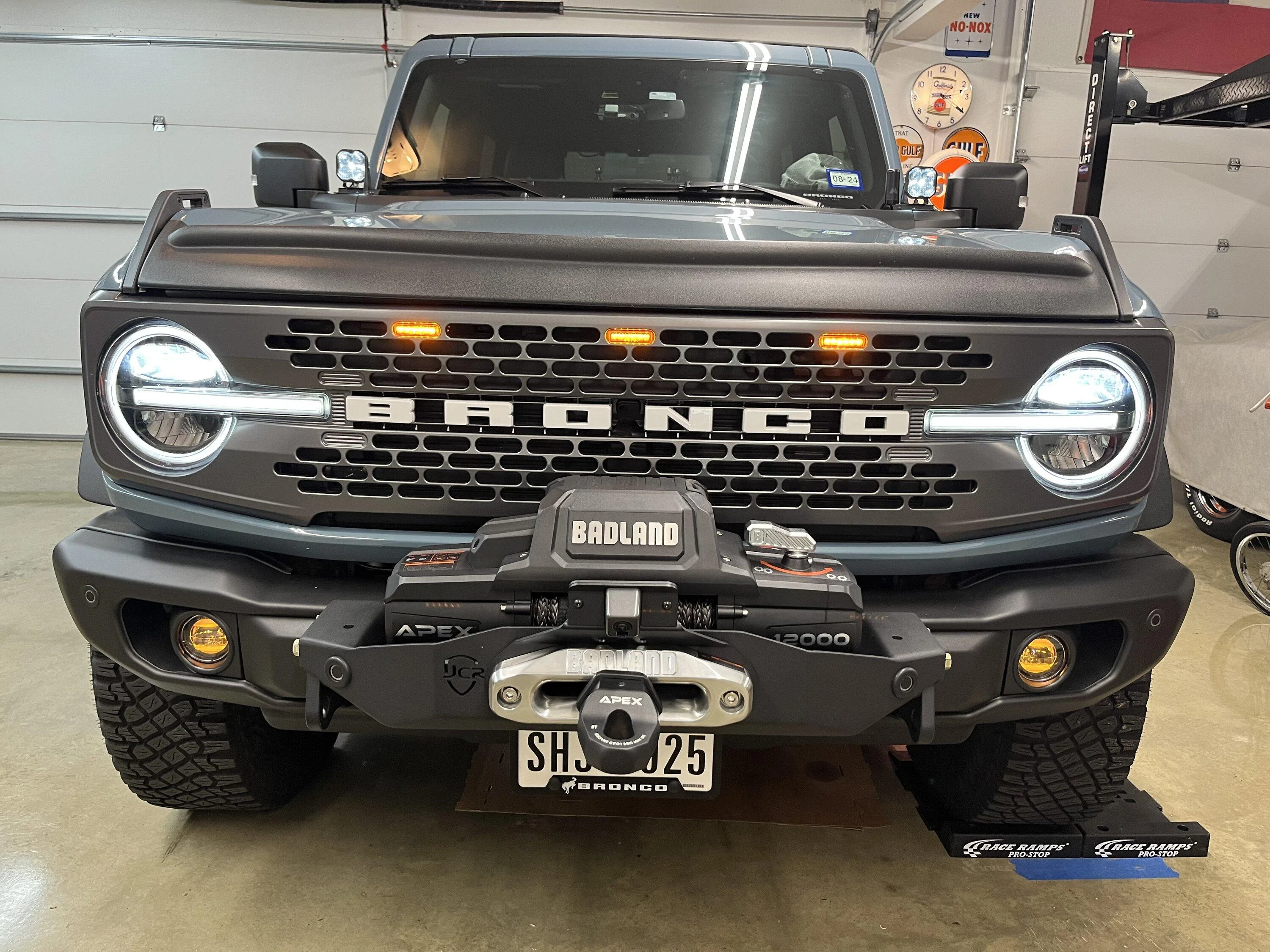

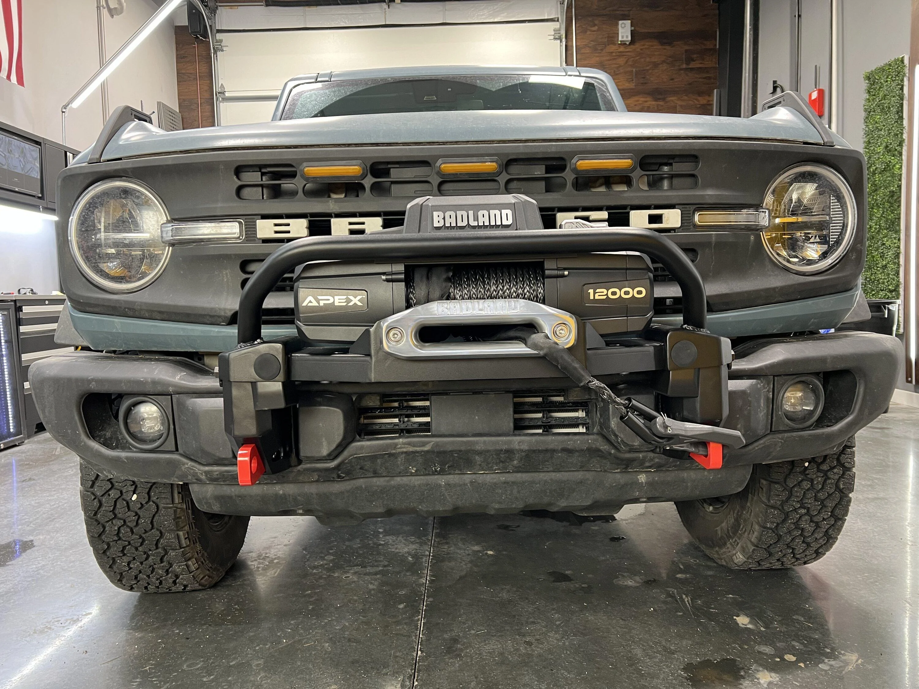

I just installed my Badland winch on my ‘22 Badlands. Used the JCR winch mount on my capable bumper and installed the JCR camera relocation bracket. Easy install and just had to extend the parking sensor wiring and trim the sensor covers a little.
Ford Bronco Capable Bumper Winch Options IMG_2321
Ford Bronco Capable Bumper Winch Options IMG_2322

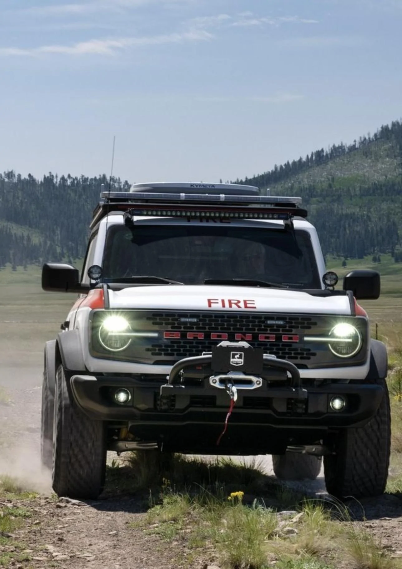

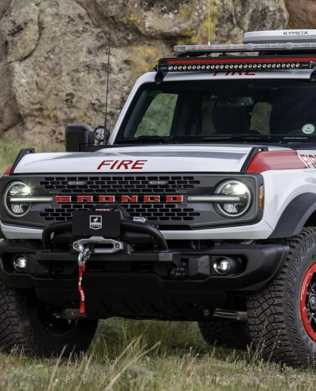

Ford just posted about the Bronco they are donating and it's rocking a capable bumper winch mount. Does anyone know if it's an aftermarket option or a future Ford accessory option?
I just went to the comment section on instagram for this and someone asked if it would be an available option with the capable bumper. Ford responded and said it was the factory mount and winch so a $2,600 purchase from ford performance. https://performanceparts.ford.com/part/M-1821-B
