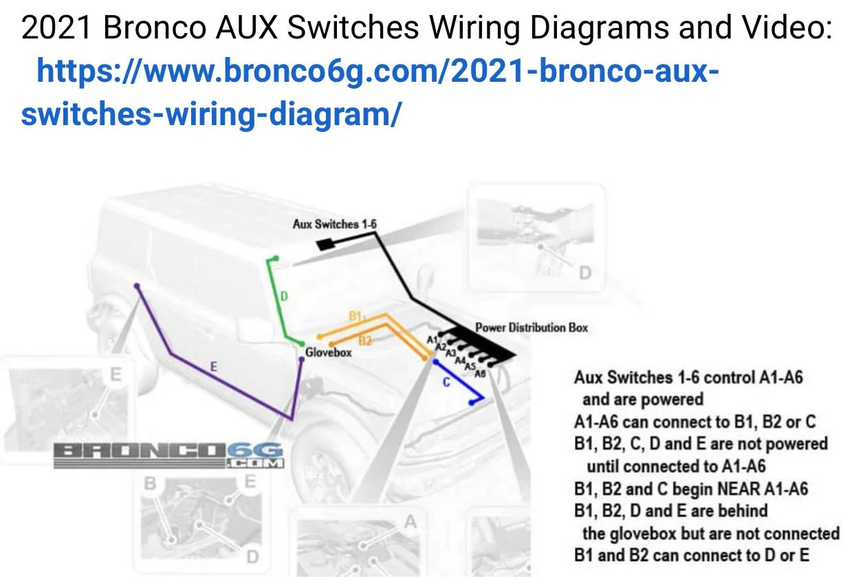

If you have the aux switches, there are pre terminated wires at the front bumper, top (right , I think) of the windshield, and at the rear quarter panel (again, right hand side).
here is a diagram.
here is a diagram.

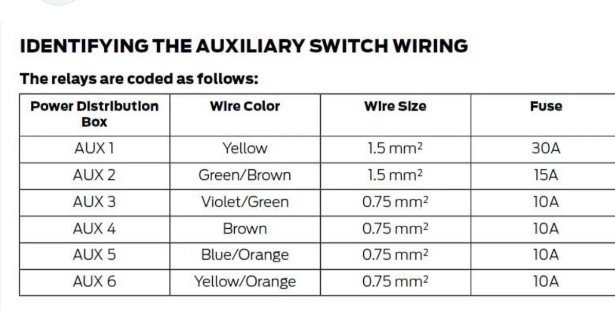

You do not need to use the pre terminated wires. You can come straight off of the harness near the firewall, and tie in each function to different switches. I have multiple lights on my bumper. Only one set uses the pre terminated end at the bumper. All others were run to the firewall termination points. And all run straight from the Aux switches.
here is a chart to show you which switch runs which wire.

I understand what a chase rack is and where it’s placed. I was Just giving you my example of wire usage. You do not need to use the factory provided rear wire at all. You can connect directly to each Aux Switch from the wiring harness on the driver side fire wall. Ford provided extra wire in pre terminated places around the rig to help make things easier, but you do not need to use any of it. I highly recommend that you research and get an understanding of what steps are required to actually make your Aux Switches functional. I think then you will understand what I’m attempting to share with you. If you were to only connect to the rear wire that ford provided, your aux switch would not work, as there is zero power actually connected at those termination points. You must also make a connection at the firewall to make anything work via the Aux Switches.
