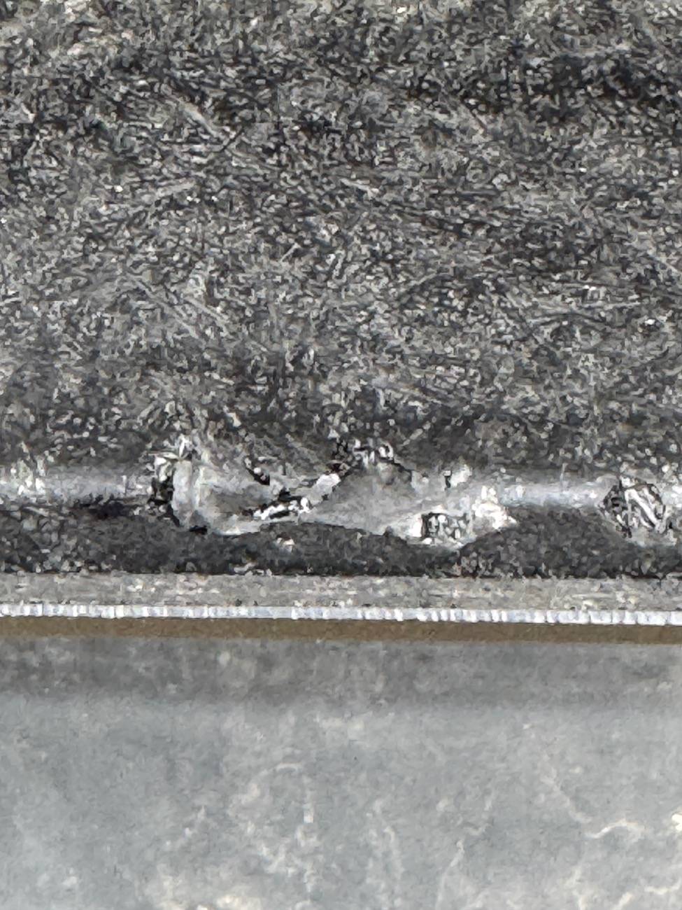

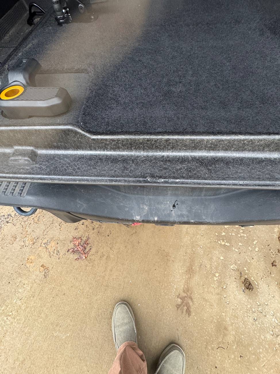

Well I am pretty sure I found my problem today. I finally had enough time to chase the wind noise and the clunk. I took the two front panels off to apply Sil glyde to the seals all around the top and doors. Wind noise is gone. The clung was still there. I looked at the drivers side panel and found it delaminating along the center edge. I had to go into town today and noticed the Dealer service department was open. I pulled in and showed the service writer the problem. Now I wait for Ford to approve the new panel.
