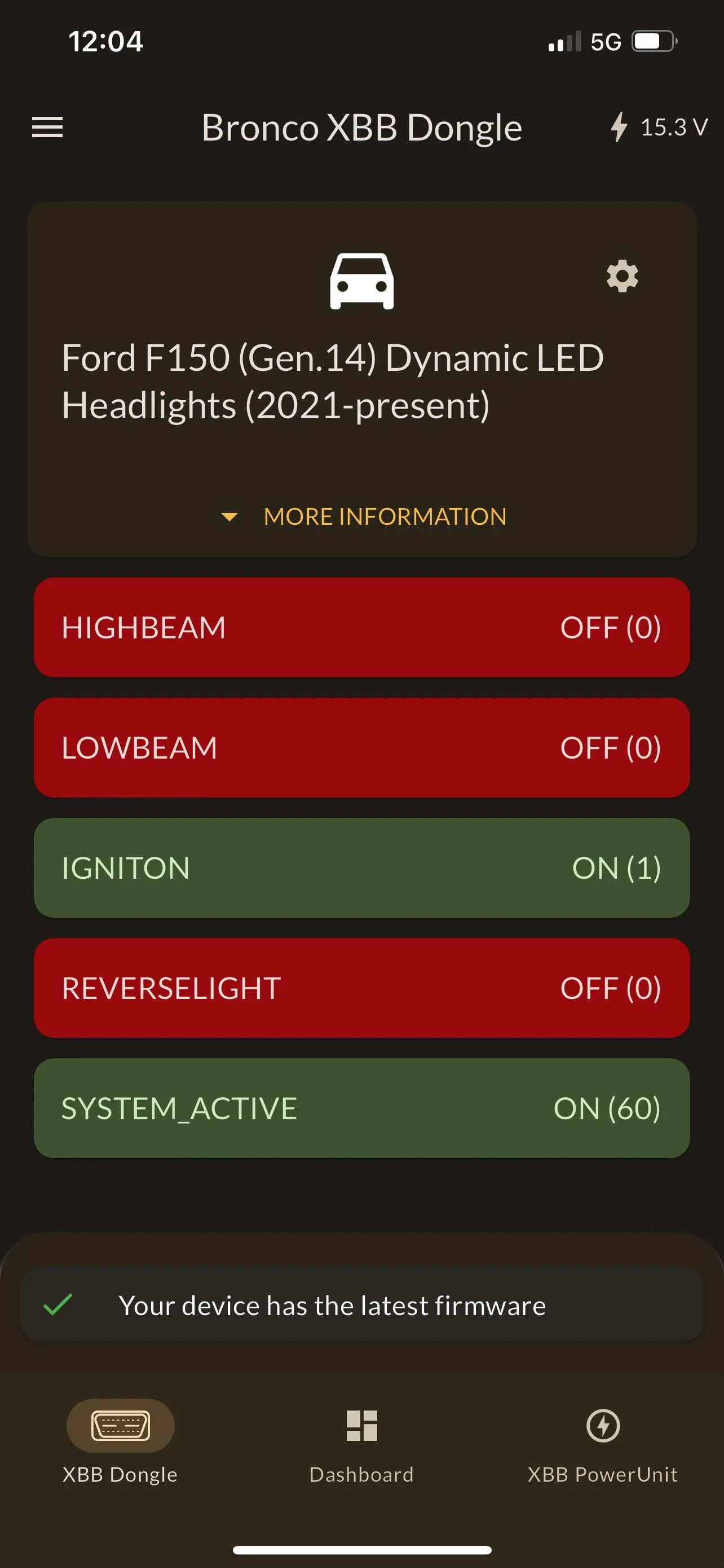

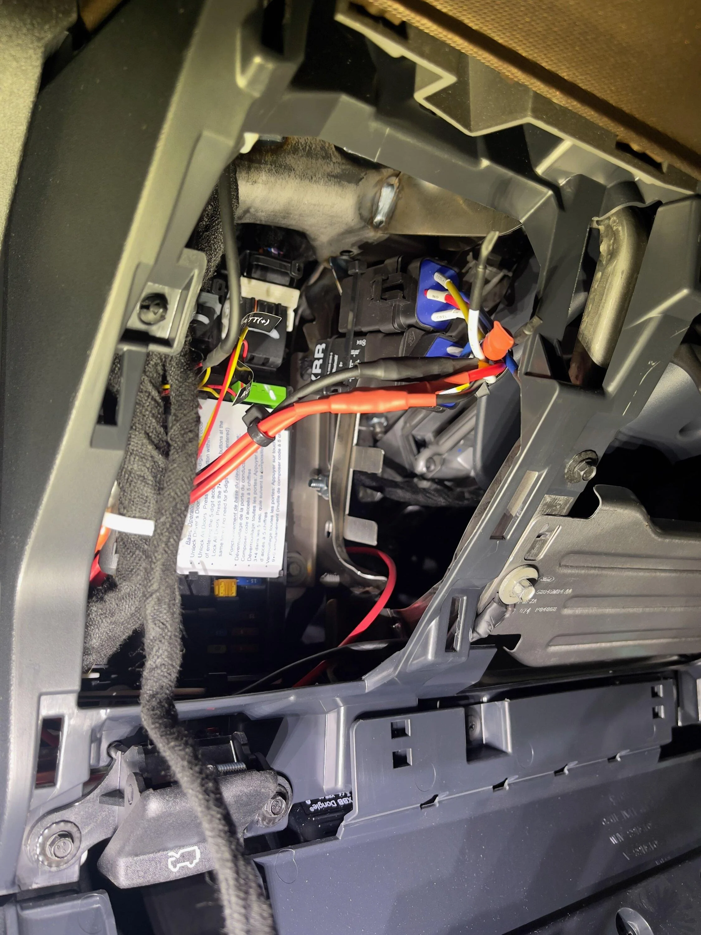

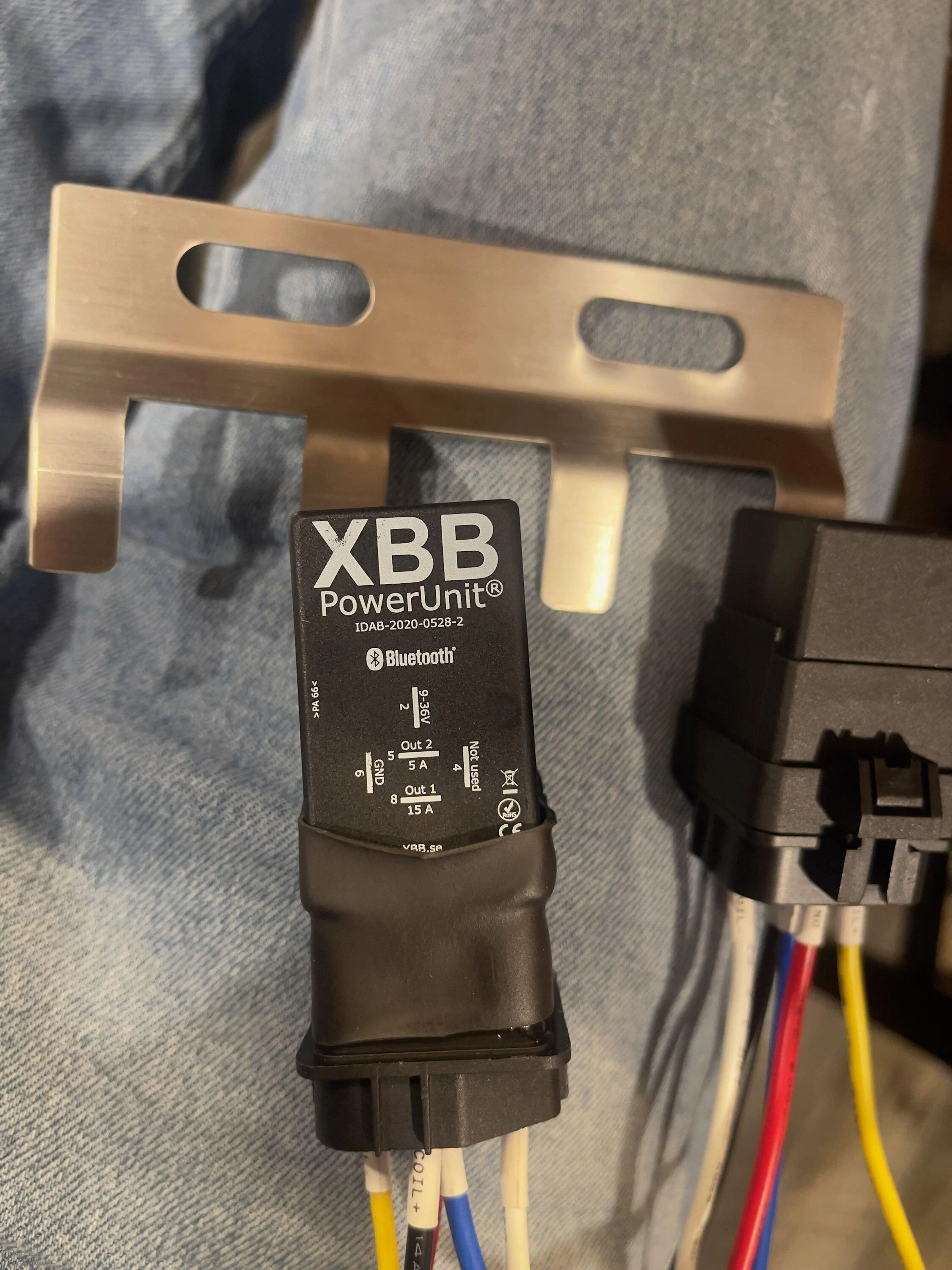

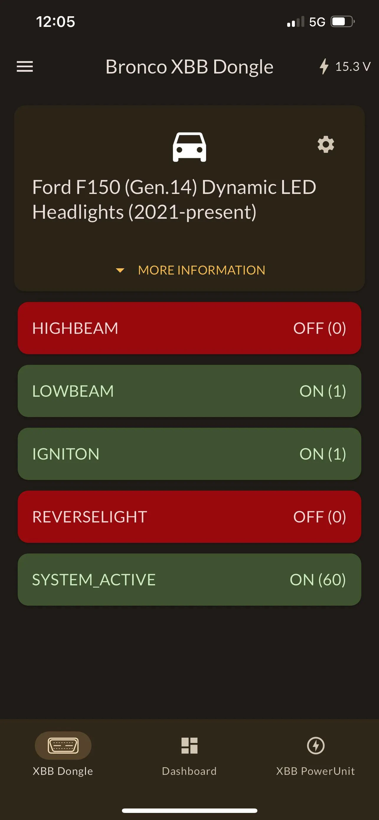

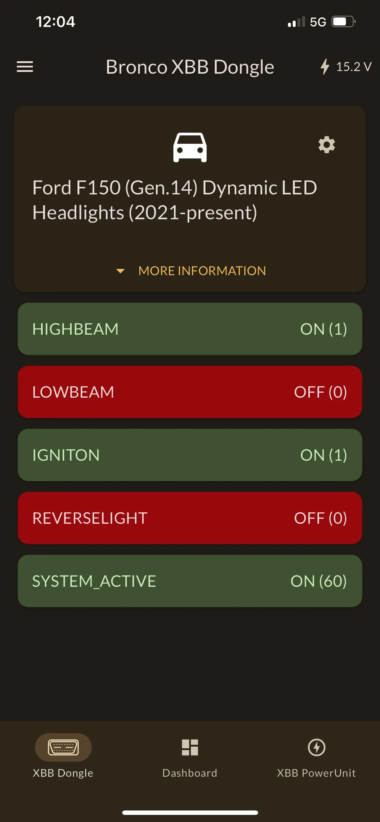

So update here, wiring is temporarily completed. Need to do some finessing to get it nice and pretty, but it's fully functioning.
The XBB PowerUnit isn't waterproof, so I wanted to try and keep it in the cabin. I purchased a relay holder, off Amazon, and bolted it under the dash close to the interior fuse box. the XBB relay has 2 outputs, 15 Amp and/or 5Amp. My load is currently max 10Amp so the single output is sufficient for my needs, but I figured I would prep for additional lighting/loads so I added a second relay and powered it off Output 2 (5Amp). I used the firewall pass through to send a wire into the engine bay. I wanted the aux lighting to be controlled through either the high beam switch or separately through the Aux switches. So I purchased a diode, and fed it from both sources.
Once powered I was able to connect the XBB Controller to the Powerunit, and its very simple, you can enable what triggers the power unit relay and if you want to trigger output 1 or output 2 separately. In my case I disabled output 2 as I don't need it yet. Thanks to @PEGB for the insight on the ford manual.
I got a email from the manufacturer, re. Powering the Unit: you don't need +15/ignition for the PowerUnit, just hook it up to +30/constant power, it will turn of in sleep mode after a while and will only draw approx. 2.7 mA when in sleep mode, the advantage is that it will go from sleep and awake in no-time and still have the connection to the Dongle, which will draw approx. 3.5 mA in sleep mode - which is when SYSTEM_ACTIVE signal is off and you don't have the phone connected to it.
I still wired on ignition only, the really still seems to basically instantly connect to the controller. And it works pretty much immediately when I enable the high beams the aux lights come on.

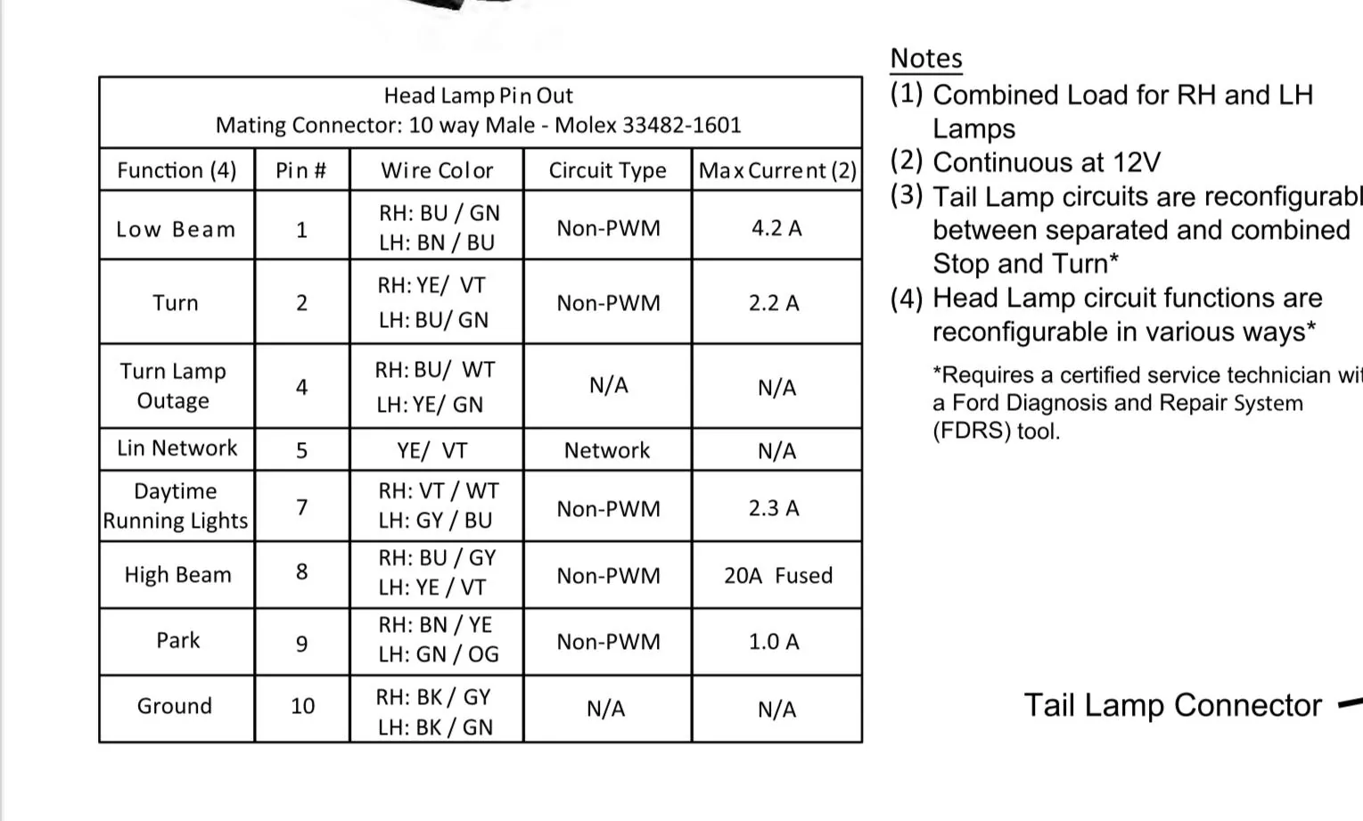

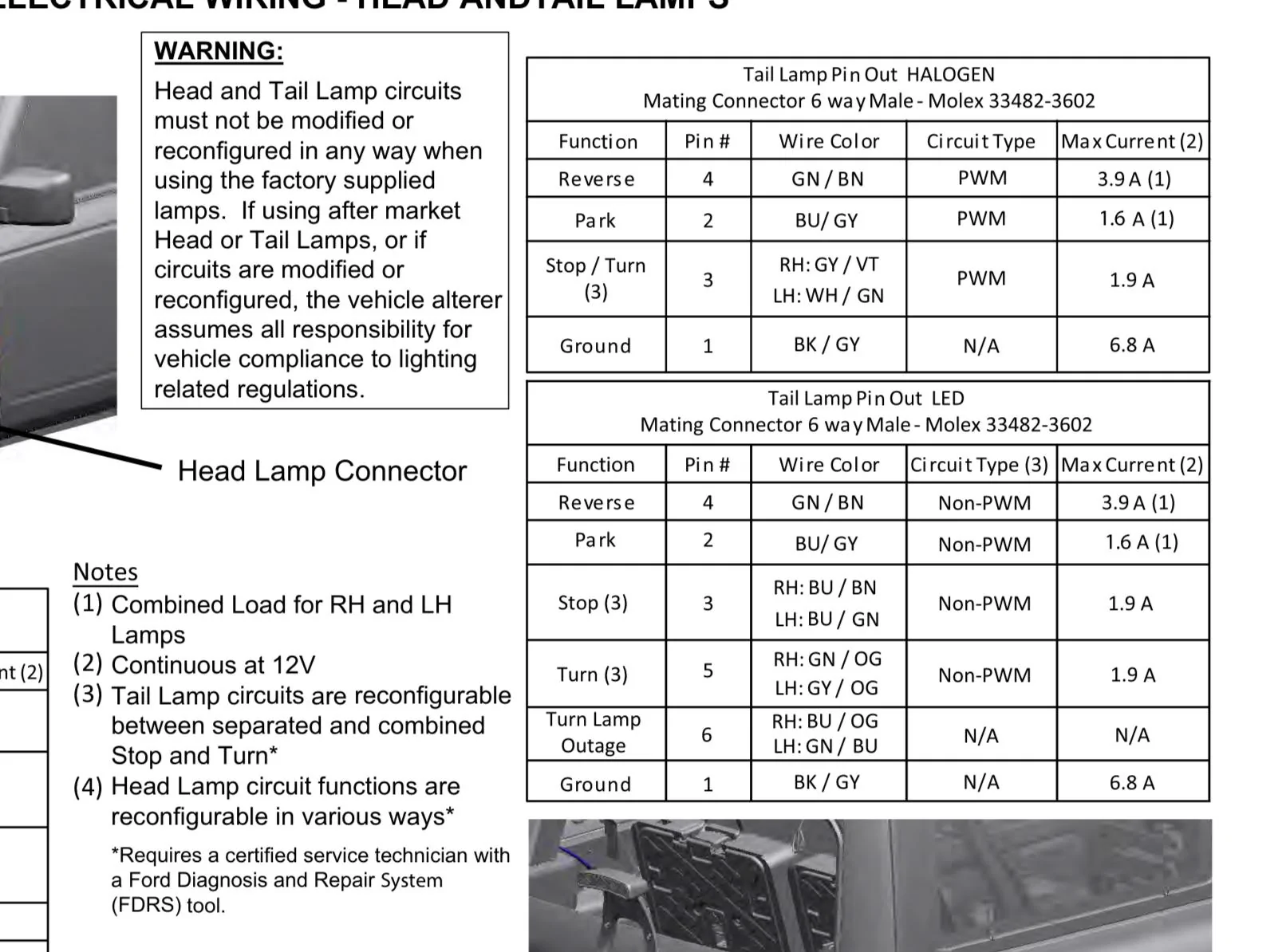

My thoughts and questions
on page 24 of that manual. Listed by someone above…
it shows tail lights and head lights….
on the rear tail lights I got a dongle tap from sticker fab to isolate the reverse lights and to allow me to use some floods on my rear bumper to operate a relay to turn those floods on an off. The dongle taps into those reverse lights.
the dongle allows me to turn on those floods with either me putting vehicle in reverse or using an aux switch. I also use another aux switch so that they won’t come on when I go into reverse as well. I have the led Rear tail lights.
i also have tapped into the turn and parking signal lights with a dongle connection and it runs additional turn, brake and parking lights I have on the rear as well.
so now we move to the HEADLIGHt circuit up front….
i purchased Both the trail guide replacement with the built in DRL/Turn leds, as well as the fog light turn signals that go where fog lights go on the modular bumper that have the drl and sequential turn signal in them.i have NOT installed eithee. I bought them for the dongles.
the dongles for both are exactly the same and connect to the same connector.
the dongle taps into the headlight dongle and lets me use those wires to run additional DRL’s and turn signals…
the amber lights you see on the front of my bronco will blink, the white DRL’s stay on all the time.
all of those I have connected to. A mechanical relay except for the turn signals and I connected those to a solid state super fast relay.
i have not tryed it yet… but I don’t understand why we can’t tap into the low or high beam light line to operate other lights with a relay.
as noted with pin 1 (low) and pin 8 (High) Since pin 2 (turn) and pin 7 (drl) are currently being tapped?
I checked these with a meter. And they are getting constant 12v signal when on and no signal when off?

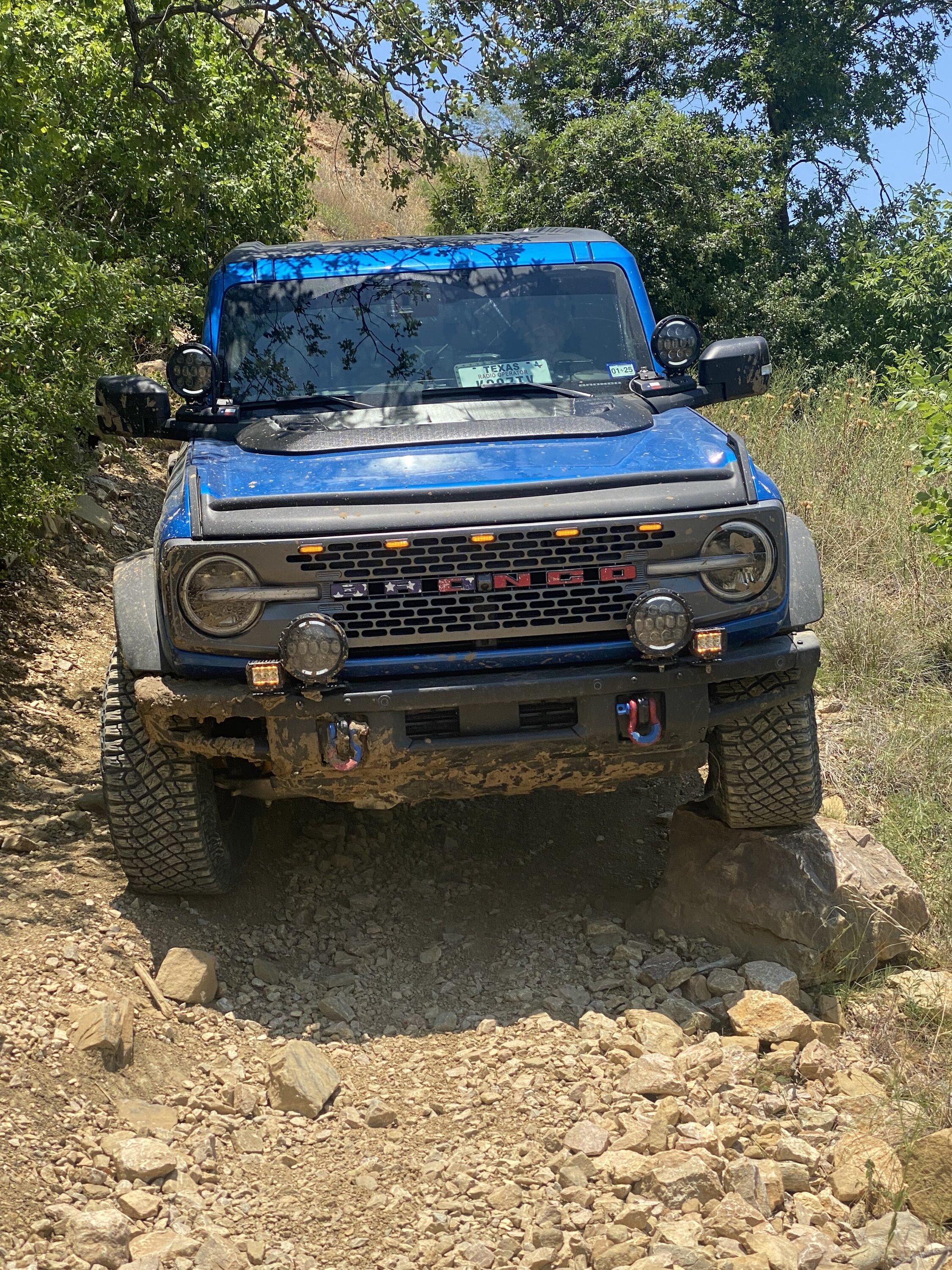

Those big round lights you see on my bumper and A piller have low and high beam function and currently are using 3 aux switch’s. aux 1 turns high beams on both, aux. 2 low beam bumper. Aux 3 low beam pillar.
what I want Is when I turn aux 1 on, for the high beams to turn on the high beam bumper/piller lights only when my hig beams are on AND the aux 1 switch is on.
Thoughts?
