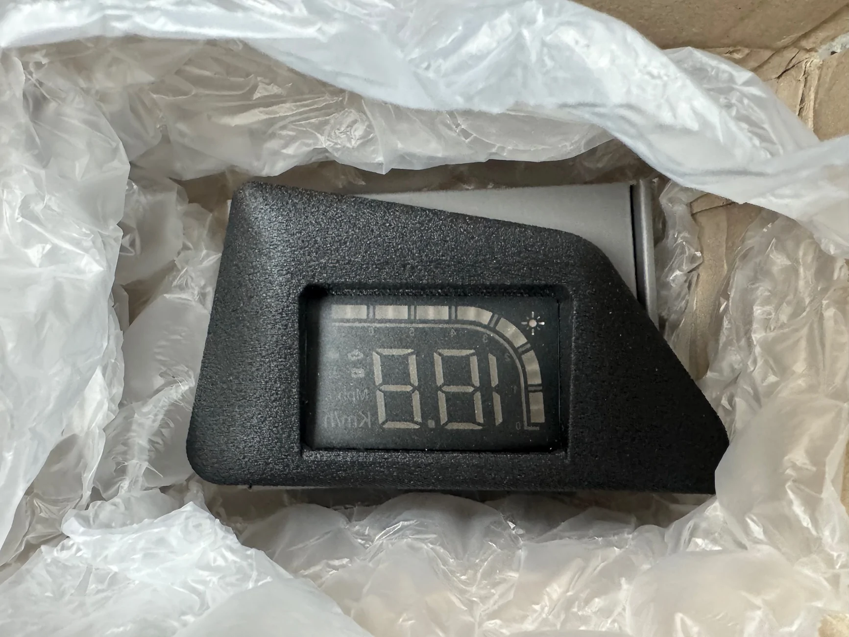

I was looking for an oem look HUD for Bronco and came across this on YouTube:
Ford Bronco Custom HUD from Korea IMG_1836
It’s the same HUD you can find on Amazon or Ali/Temu, but this version includes a Bronco-specific mounting bracket.
Ford Bronco Custom HUD from Korea IMG_1820

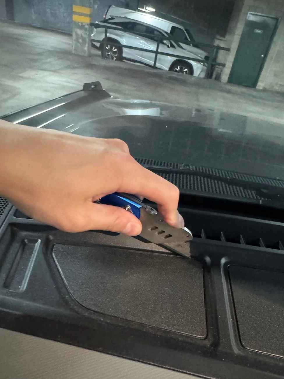

Overall, the installation was pretty straightforward. The only challenging part was trimming the plastic panel on top of the dash. In the video, they use an ultrasonic cutter, but I was able to do it with a regular utility knife in about 10 minutes.
(detailed instructions are in the video)

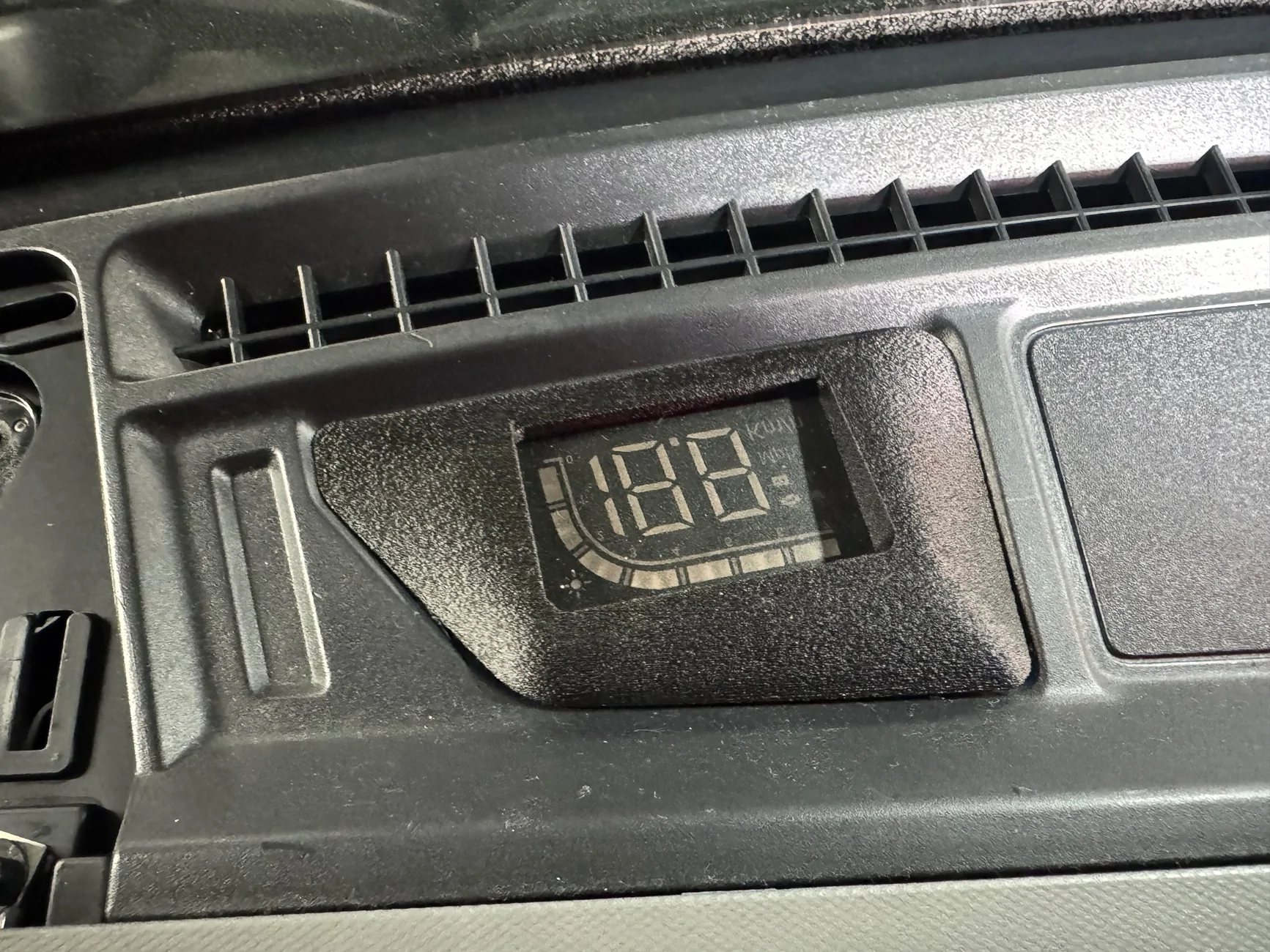

Ford Bronco Custom HUD from Korea IMG_1844
The HUD connects through the OBD-II port and works well. It sits a little higher than I’d prefer, and I wish the speed display was slightly smaller, but neither issue is a deal breaker.

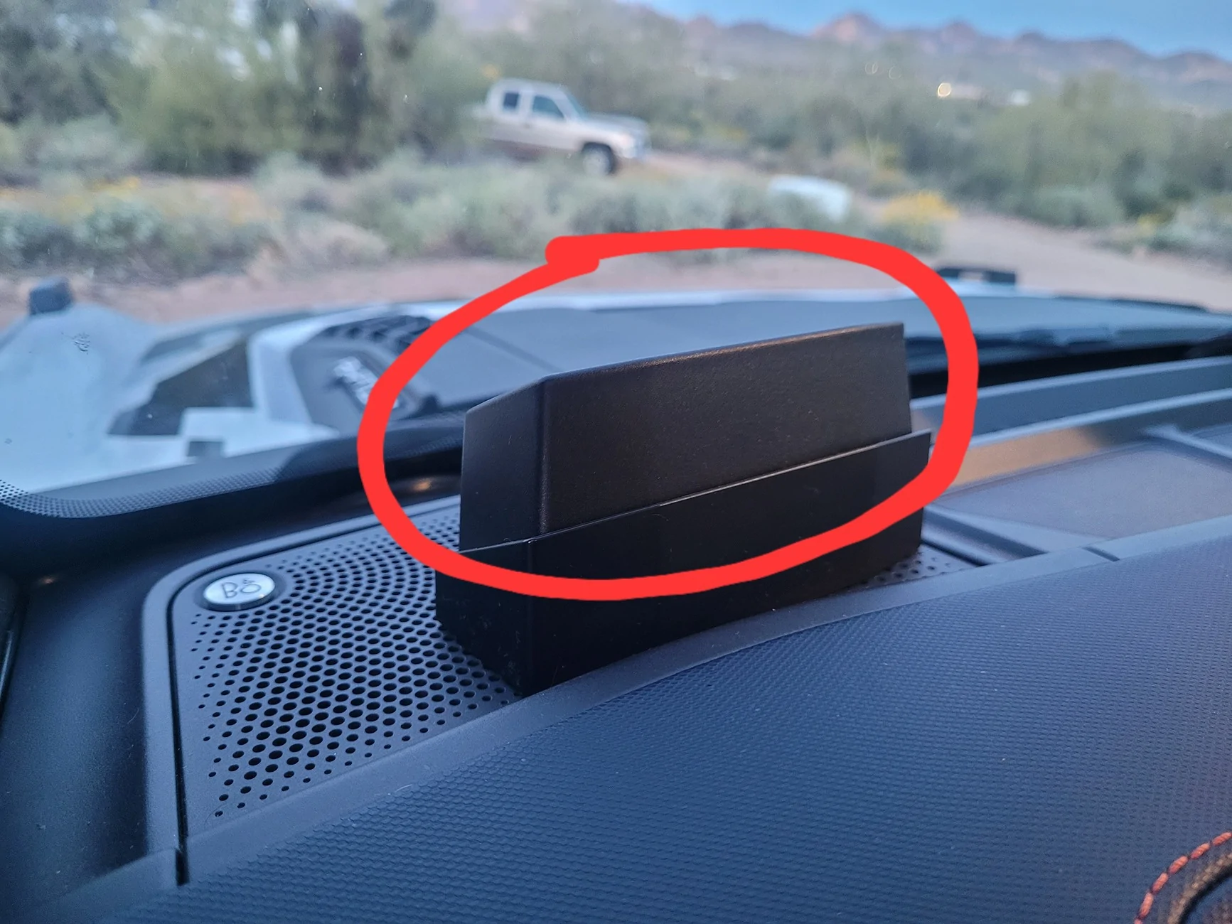

I'm good with keeping my HUD above ground and not too eager to slice into dashboard making permanent damage.
Which solution is this and do you have a picture from the drivers seat in the light to show how much it sticks up off the dashboard?
