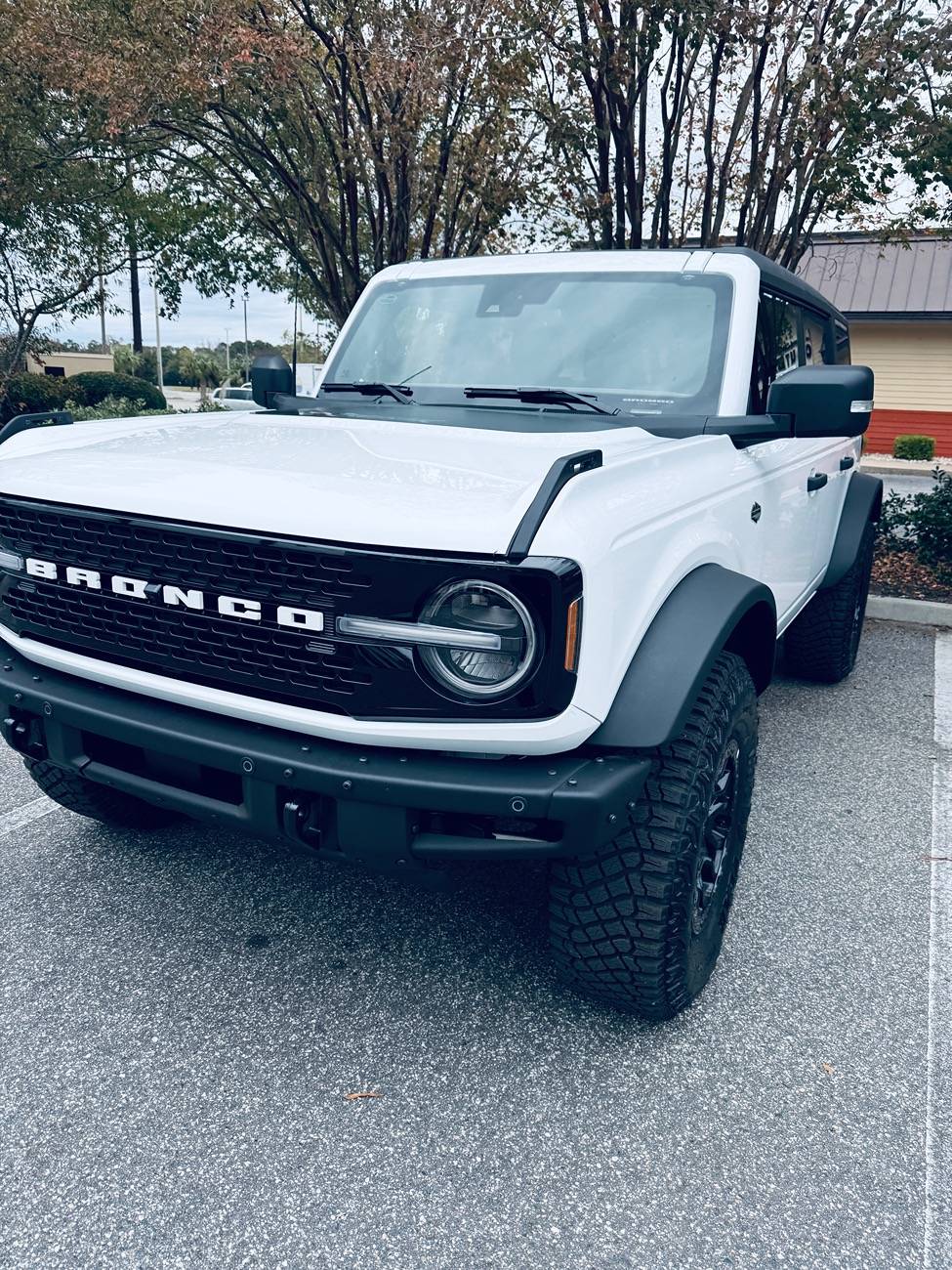

I am a bit confused on the different bumpers that are available from Ford.
Can any one tell me what bumper I have and a description of the different ones that come on the Bronco.
Thanks in advance.

You have the upgrade - the Modular Bumper. The base is the Compatible Capable Bumper. But you're good with that one.

That's the modular steel bumper. The rear bumper's top plate is plastic, otherwise it's steel. This is generally considered the best bumper for off roading unless you want fog lights (I think?).
The capable bumper is more square looking in general and works fairly well. Has more plastic.
There's also a plastic bumper I understand, but haven't really paid attention to that.

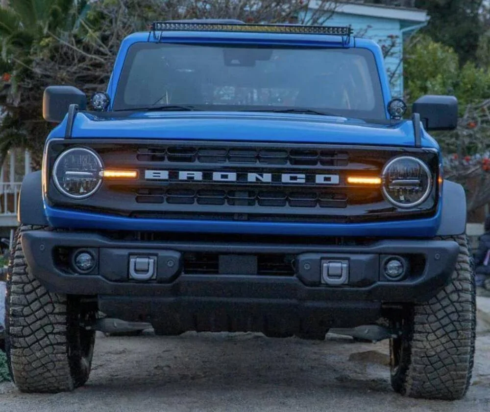

Capable (Steel) Bumper:
Has the square~ish D-rings. I haven't seen a version without fog lights,

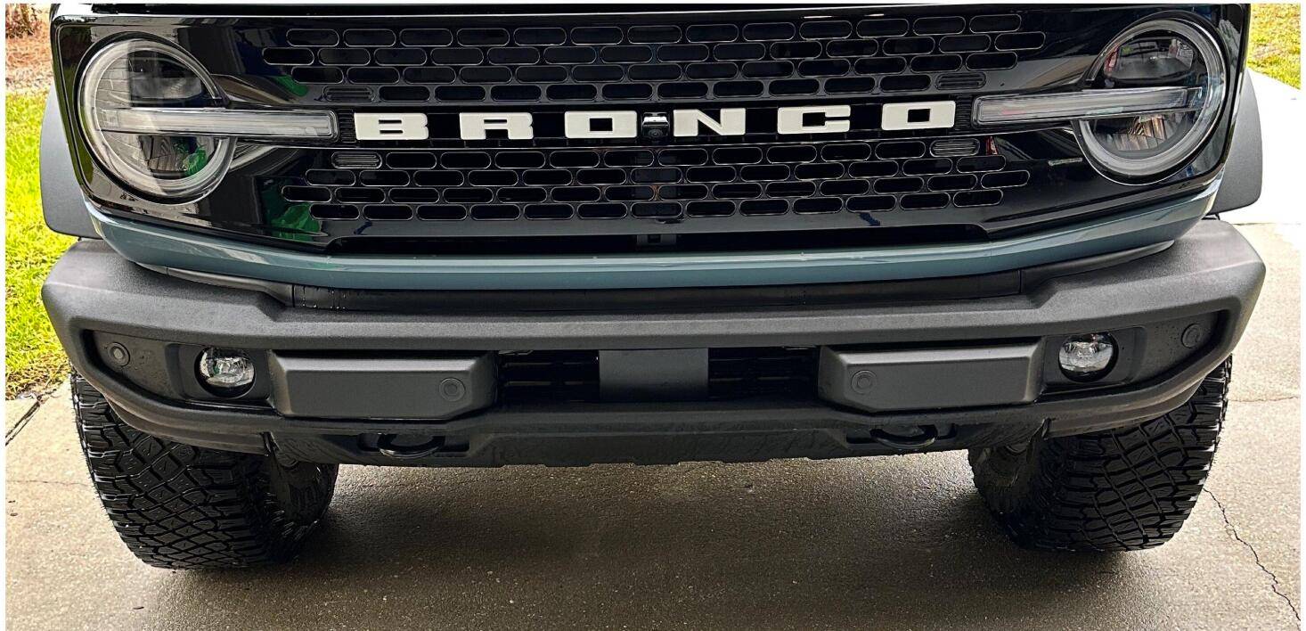

Modular (Steel) Bumper
Has vertical steel recovery points and bolts/mounting points all over. Fog lights often go in the side pockets.

Are there addons that you can add to the modular bumper from Ford and 3rd parties?

Many, many addons for the modular bumper. Most every addon, in fact, will assume you have the modular bumper.
Winches, lights, hitches, carriers, bars, antennas, ... a lot of stuff.

Sure. For instance, some folks sell a replacement pocket on the corner if you want to install (more?) lights. If you want a winch, Ford is selling the mounting plate and winch on the Everglades at a fire sale price. You just have to look around.

Yup - almost the same, just puts the square D-rings in there over the frame caps. And it's steel, not plastic, which is the big difference I guess.
I actually like the look of the capable the best, just don't like that it's difficult to do much with it aftermarket.
