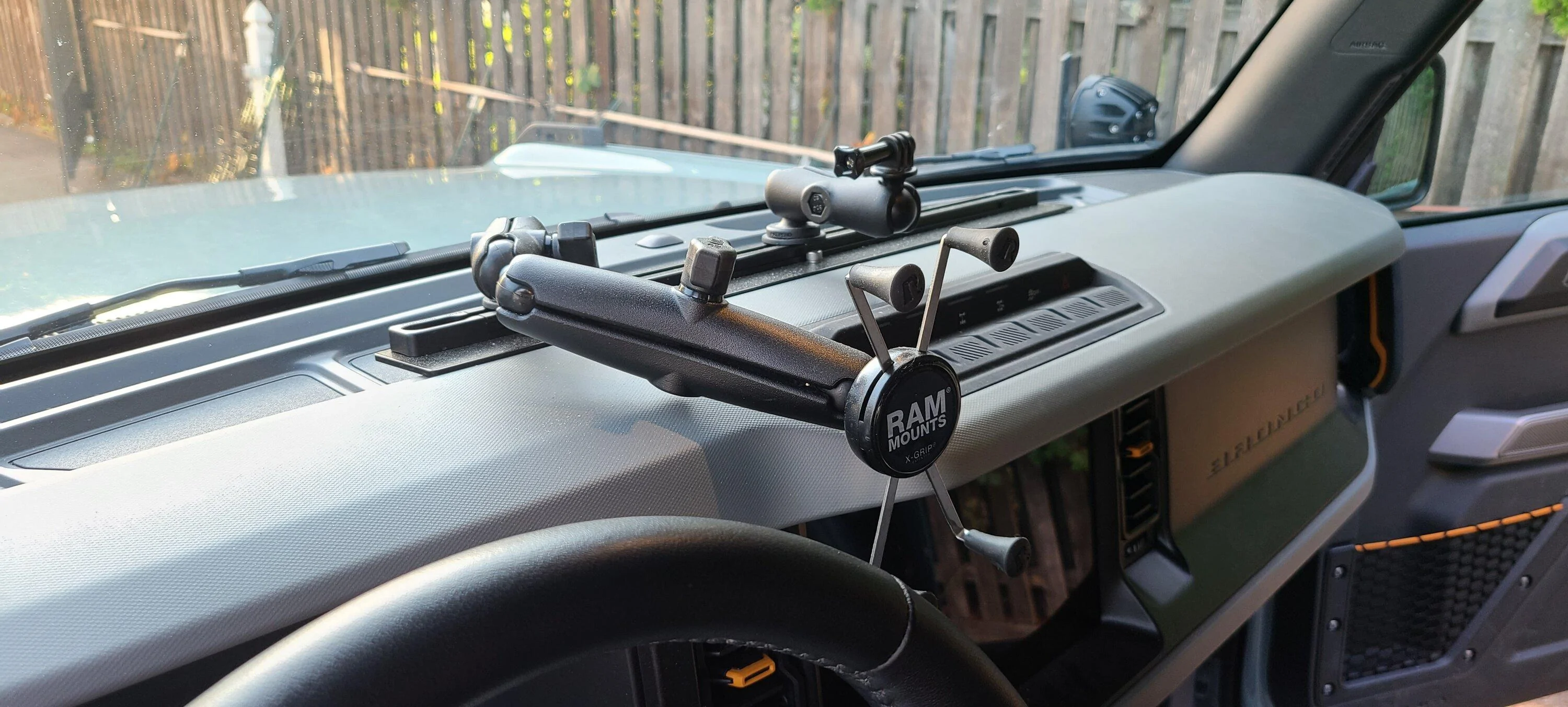

Built my own BYOD rail. Total cost under $200.00.
The base is 1/8" x 2" x 20.5" aluminum and I used conical rubber bumpers to support the front.
Everything else is from Ram Mount.
Here is the material list
Amazon
Conical bumpers used the largest ones https://www.amazon.com/gp/product/B075KZBR2Y/ref=ppx_yo_dt_b_asin_title_o00_s03?ie=UTF8&psc=1
Ram Mount
RAM 1" Double Ball Adapter RAM-B-230U 1 qty.
RAM Long Length Double Socket Arm for B Size 1" Balls - RAM-B-201U-C 1 qty.
RAM Double Socket Arm for B Size 1" Balls - RAM-B-201U 1 qty.
RAM Action Camera Universal Ball Adapter - RAP-B-202U-GOP1 1 qty.
RAM® X-Grip® Large Phone/Phablet Cradle - RAM-HOL-UN10BU 1 qty.
RAM Short Double Socket Arm for B Size 1" Balls - RAM-B-201U-A 1 qty.
RAM 1" Track Ball™ with T-Bolt Attachment - RAP-B-354U-TRA1 2 qty.
17" Modular Aluminum BLACK Tough-Track™ - RAM-TRACK-EXA-17BU 1 qty.
