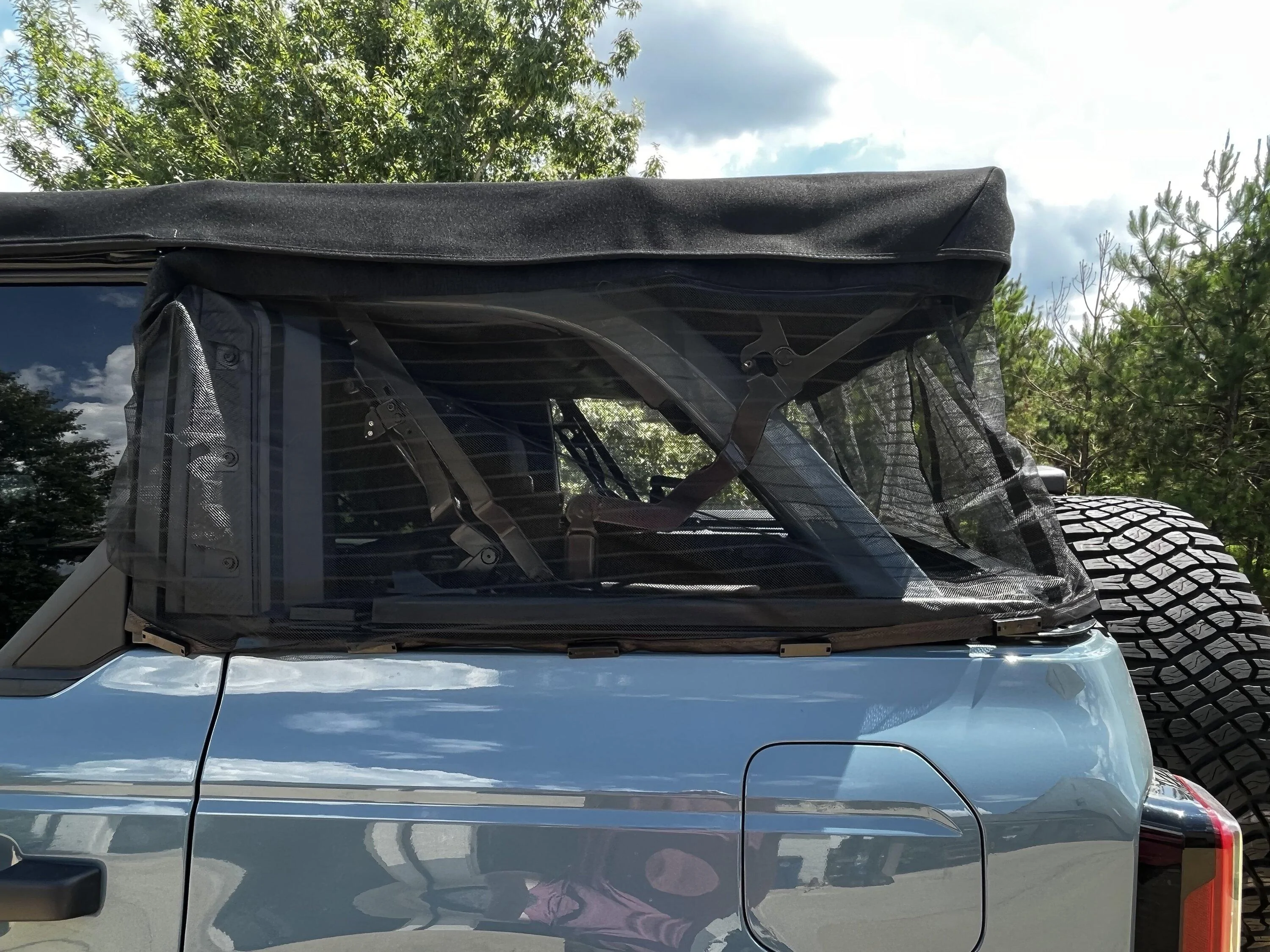

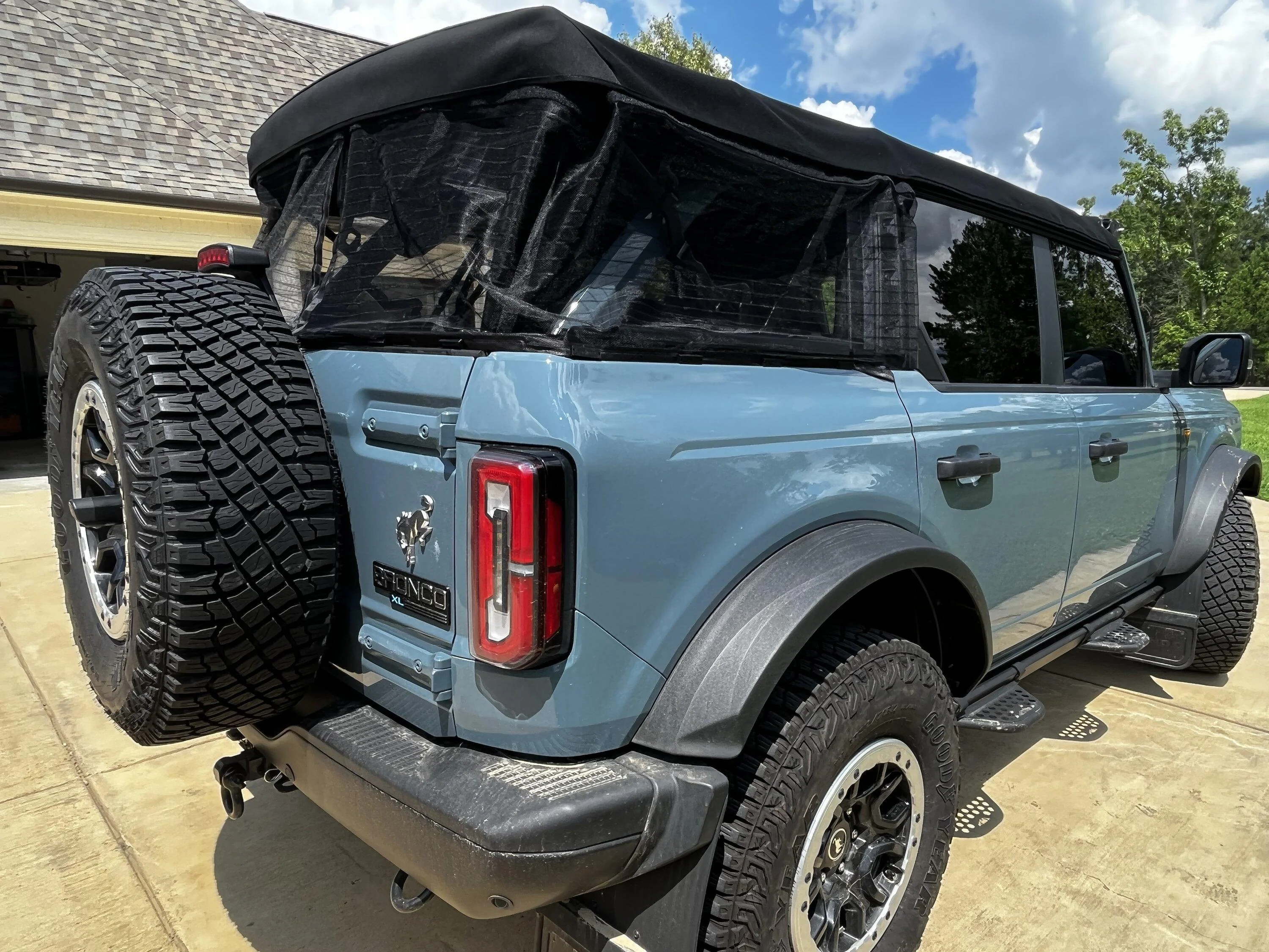

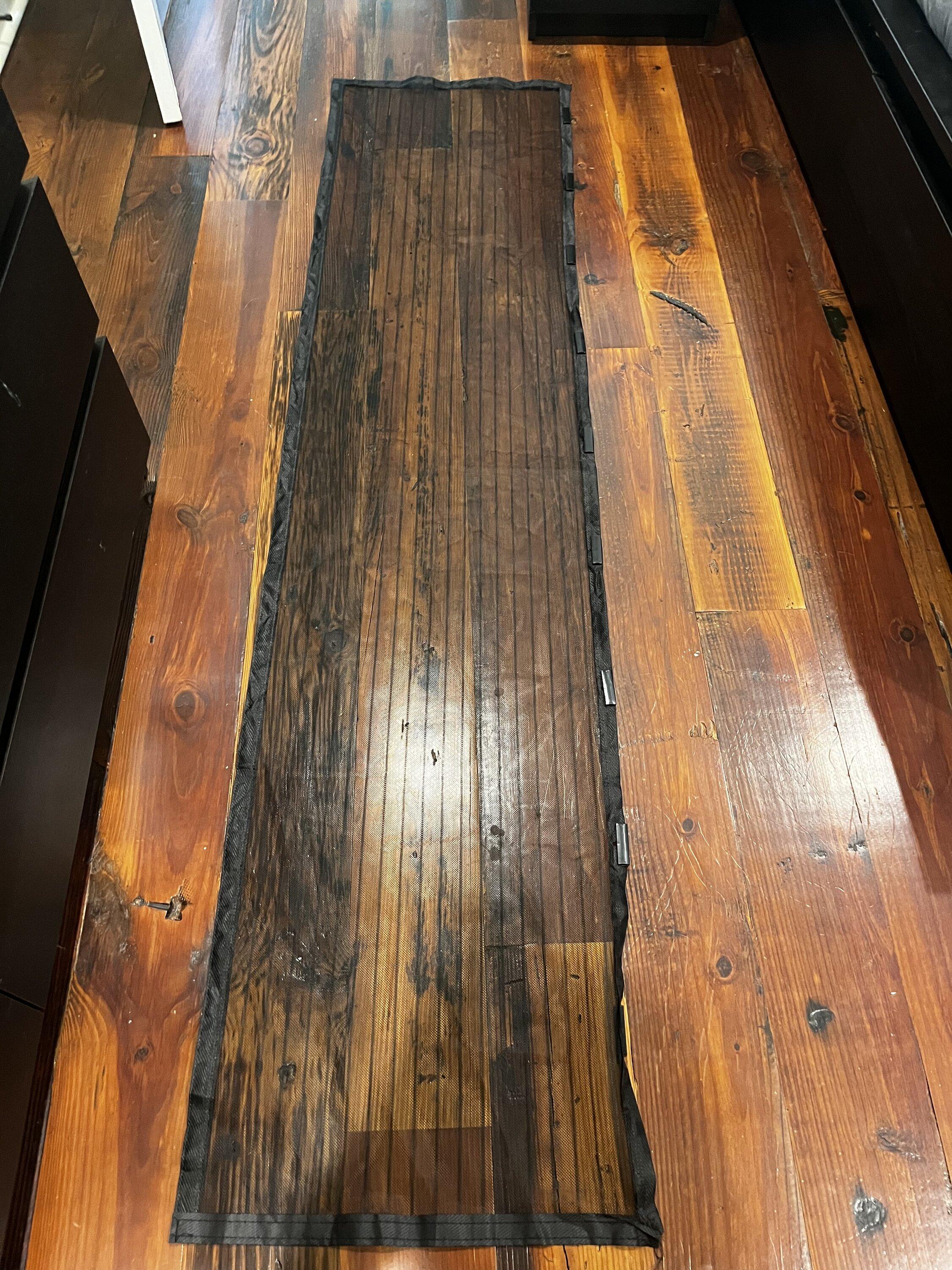

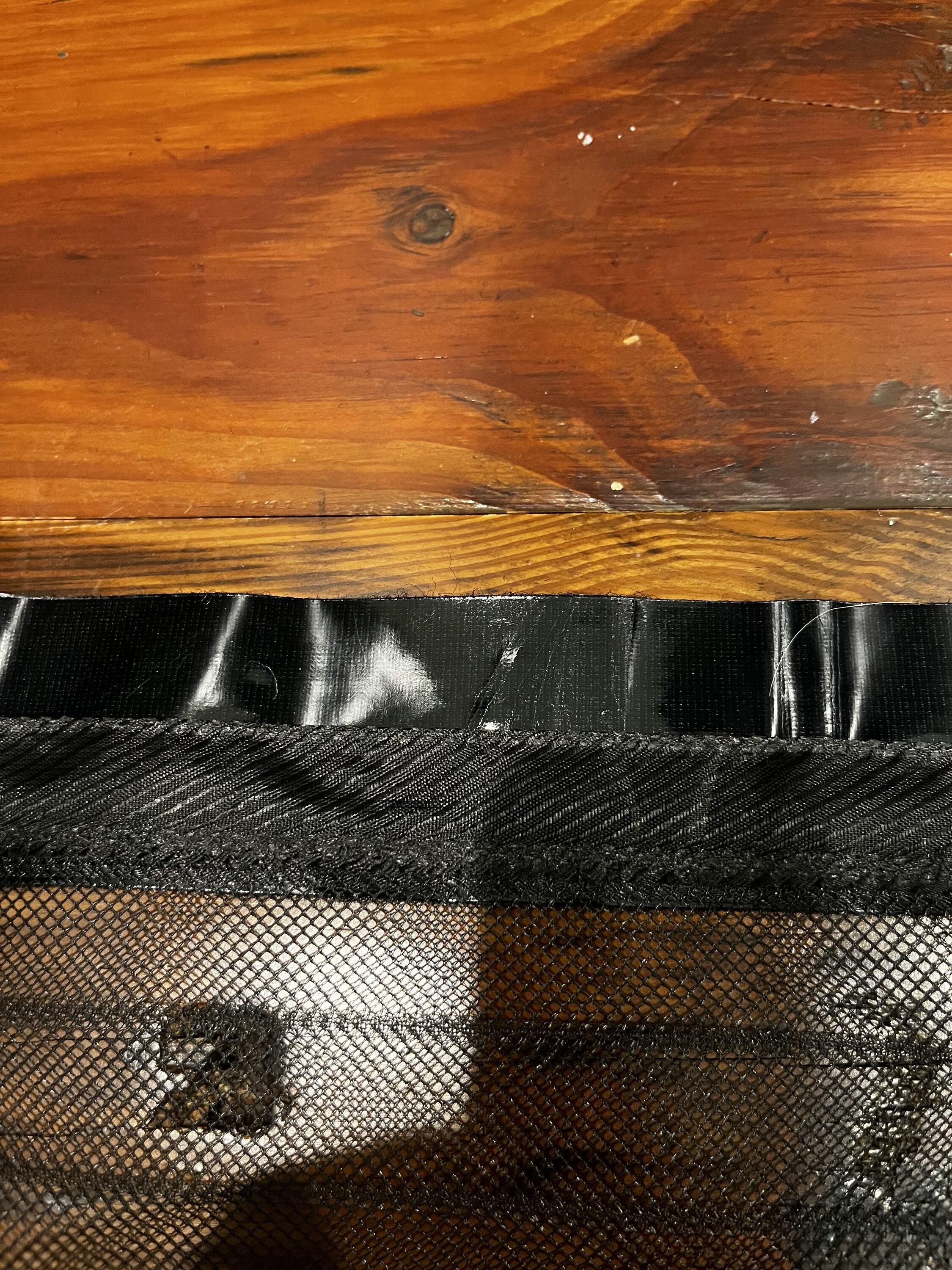

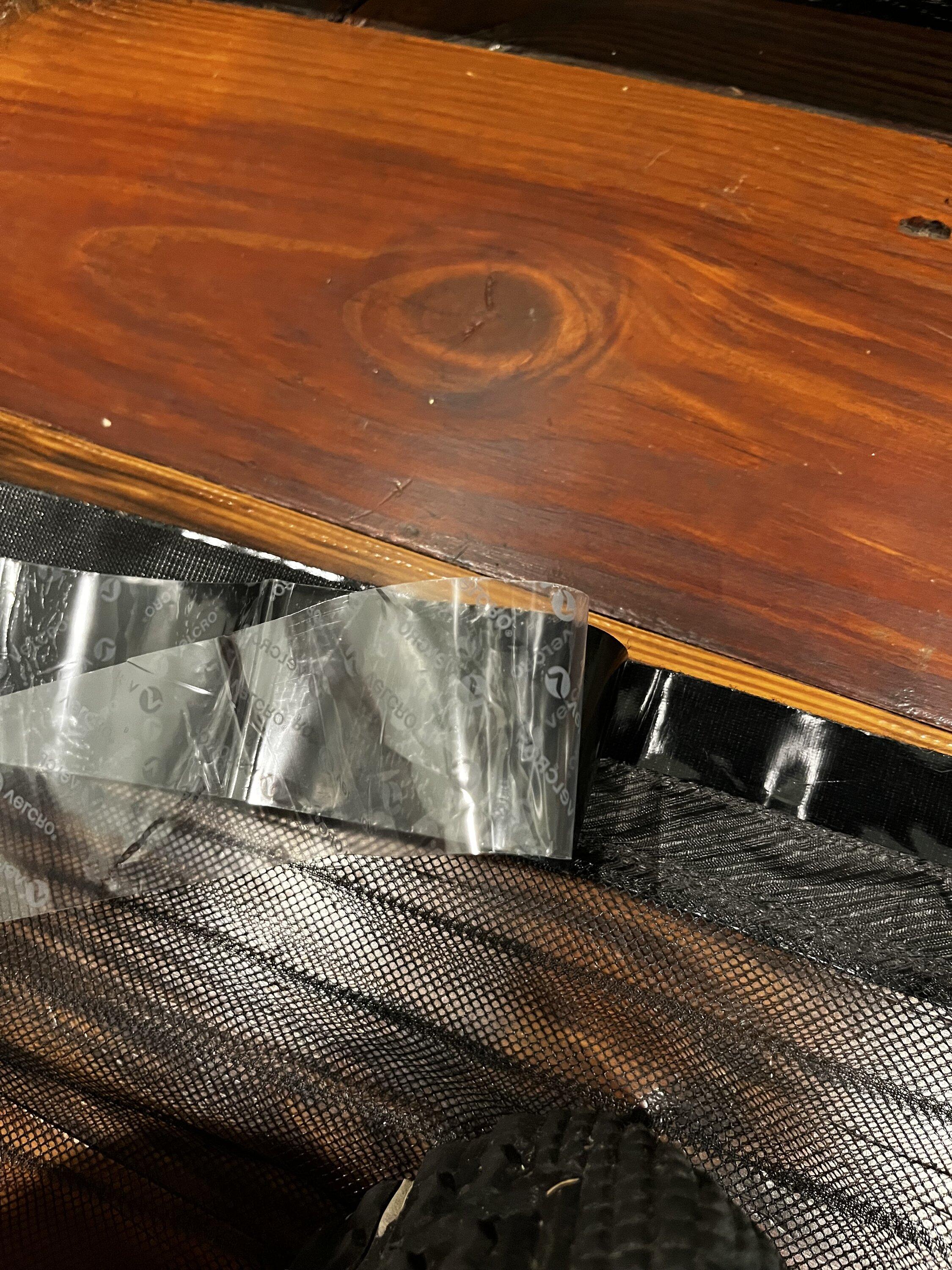

It stays pretty hot and humid in my area, so if I'm going to be comfortable at all overnight in the back of the Bronco there needs to be air flow. I bought some of these mosquito net doors in the as-seen-on-TV section at my local Walton family-owned small business superstore, and 15 ft of 2" wide industrial strength velcro in the craft section. The netting comes in 2 panels, and I sandwiched the long side of each between the adhesive sides of the velcro strips. With the bronco soft top in the Safari configuration, the netting can be hung using the soft side of the velcro. There are small magnets enclosed in plastic attached to the netting which act as weights to pull the netting down, and although they're pretty weak, they help hold the netting against the body of the truck. I just tucked the extra net inside the rear doors, but with some extra time and patience I'm sure someone could trim these to really have a more finished look.
