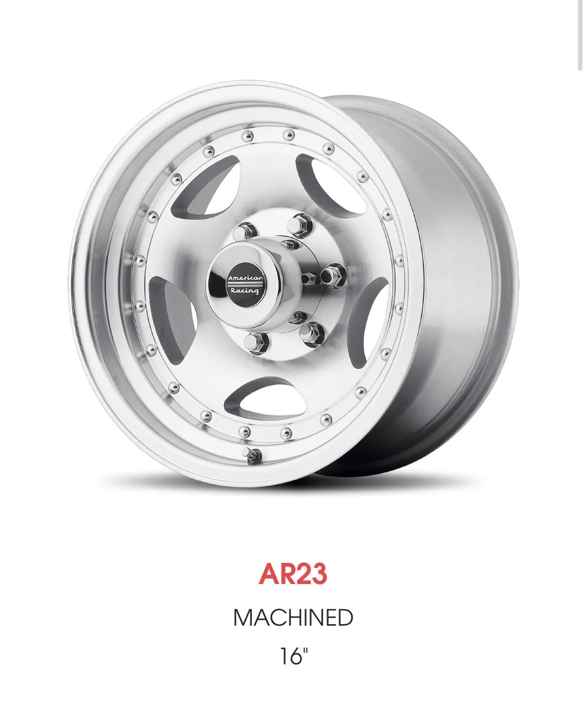

How about these. They would give a similar retro vibe.

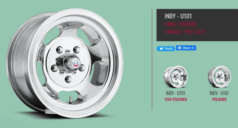

I've been researching this recently and the only option currently is to have these drilled for the Bronco bolt pattern:
https://www.summitracing.com/parts/usm-10117900037d
Those are nice but unfortunately don't have enough positive offset to keep the tires from poking out too much.
Ford Bronco Do these wheels exist for the Bronco? 1641828700167
They do have some 15x8's with zero offset, everything else is negative offset. We need 30-50 mm of positive offset to keep the tires within the wheel flares.

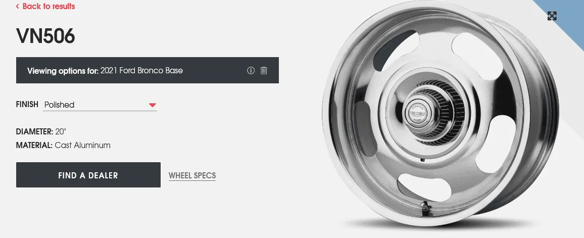

A couple more with zero offset:
Ford Bronco Do these wheels exist for the Bronco? 1641829528857
I like these except they are 20". Once again, zero offset.

Those VN506 look to much like the Chevy Rally wheel.
There should be better options with a 2 piece wheel like Garemlin mentioned.

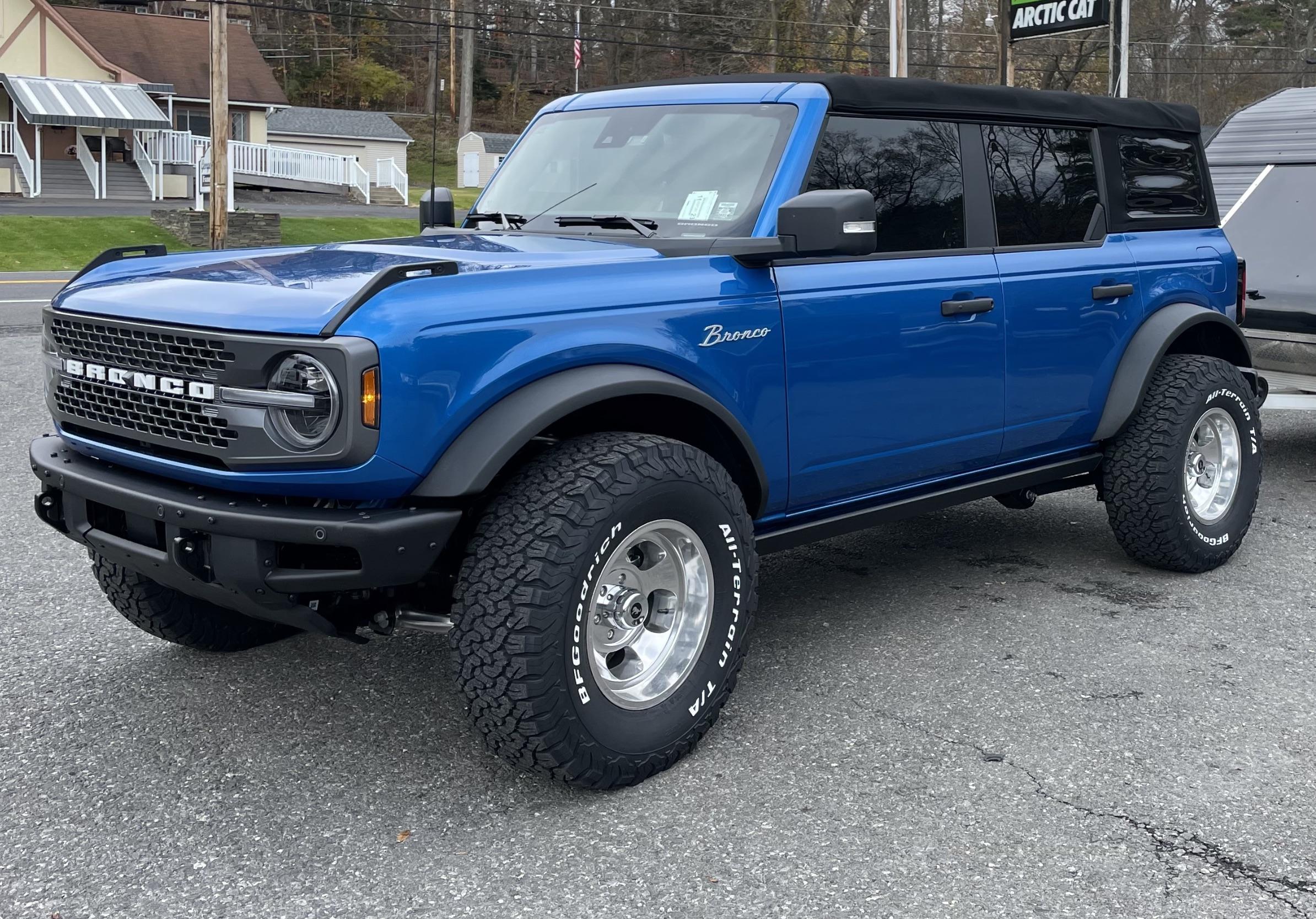

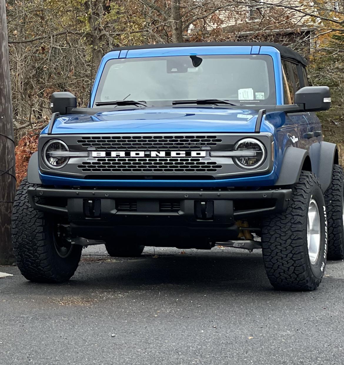

Member here has them on his ride, I can't decide really. My wheels stick out that much on my Raptor. For whatever reason the Bronco looks lowered with this setup.
You are correct, the offset of the blank wheel will stick out of the fender flares considerably more than stock. According to their customer support however, they don't do custom bolt patterns on their other wheels; only the blank part number in my earlier post.

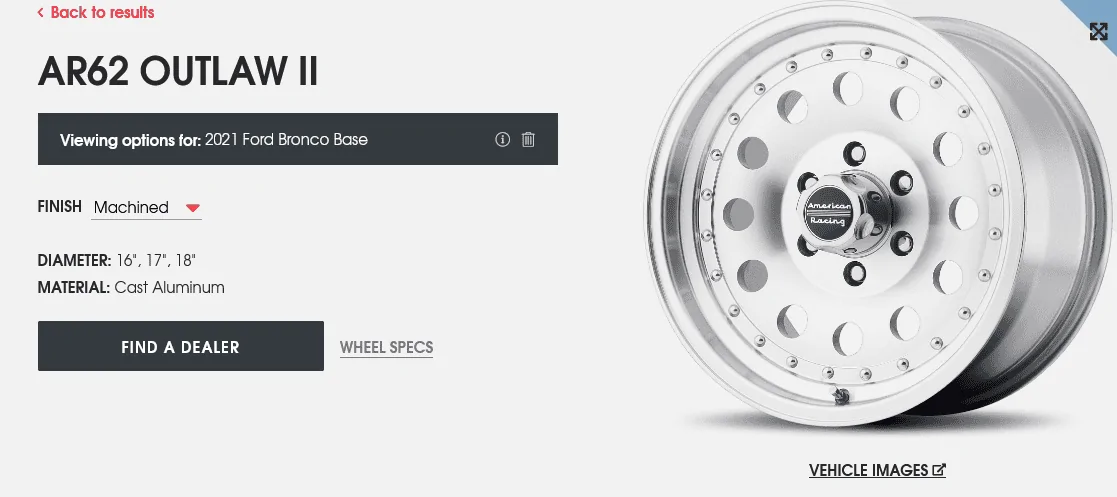

I'll be running the Outlaw 2 in black with the 18mm offset.
