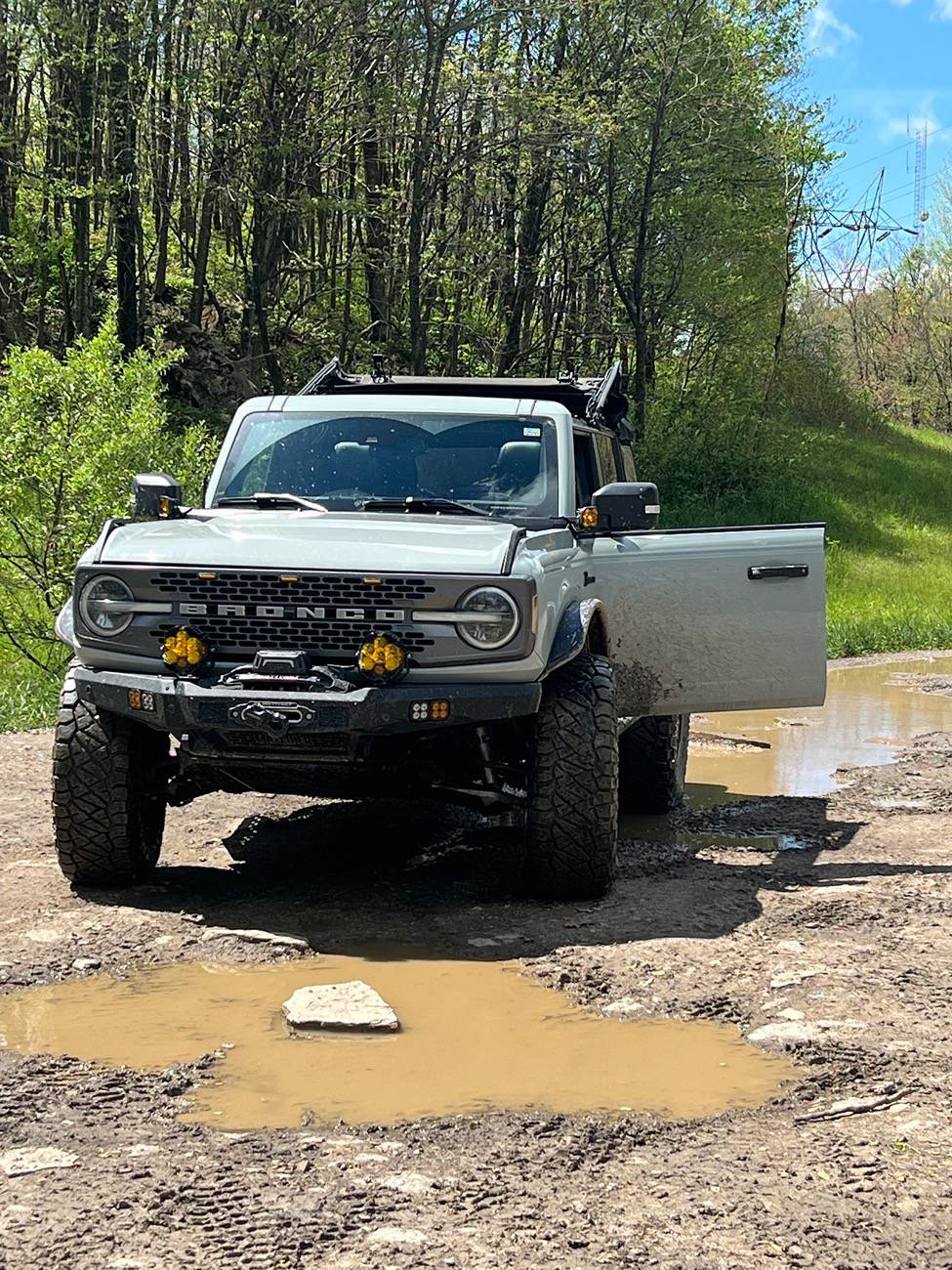

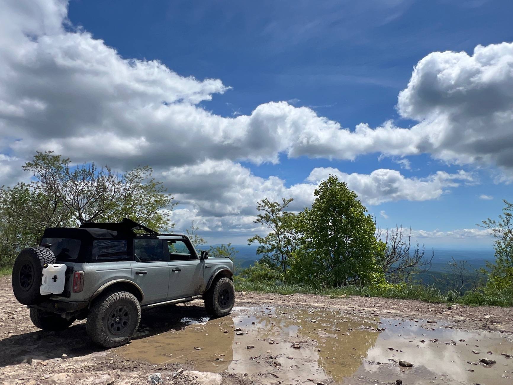

I went Bilstein 6100s, Icon UCAs and 37s. Ride improved and seems softer. Really happy with it so far.
Taking it to the trail for the first time next week since the change and will report back.
Huge improvement on the trail with the Bilstein 6100s. Clearance, ride quality and rebound was a major improvement. Highly recommend. View attachment 724368
