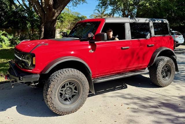

I went with the full Dobinsons IMS as it was the only adjustable coilover kit available at the time with heavier springs front and rear. I also swapped out the upper control arms, lower trailing arms, and trackbar with relocation kit. Been happy with the ride despite the stiffest available springs. I doubt anybody has run all three systems for a direct comparison. That being said, all three kits are worthy of consideration now that Eibach and Bilstein also offer HD springs.
Running 35" tires...

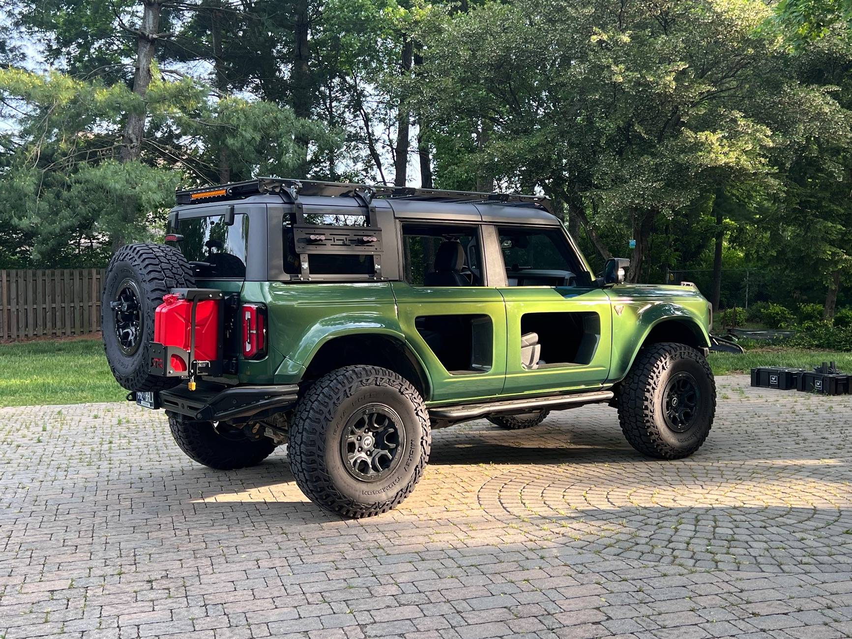

Big fan of my Eibach coilover kit. I used their standard (non-HD) springs and stock control arms. Ride is very nice.
Near minimum ride height in the rear, front brought up to match over stock Badlands wheels and 33" tires.

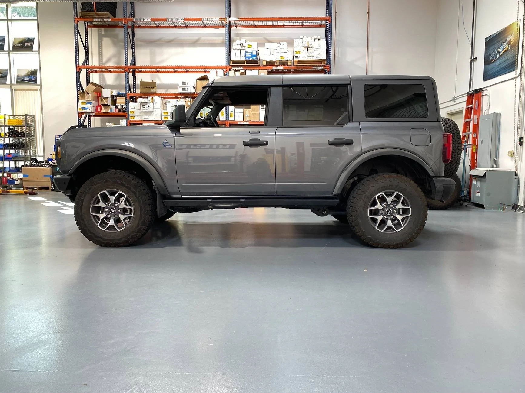

Bilstein 6112s on a 23 BD non SAS. Minimal to no rake. 2 inc lift, stock UCAs. 33" tires so some will think the Wells are empty but I actually like them that way

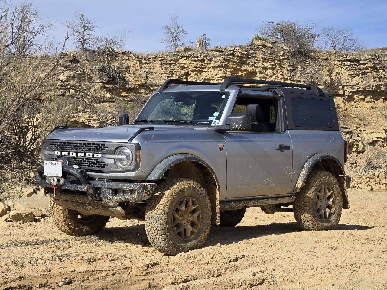

Here is my badlands sasquatch now on Dobinsons MRR all around, OEM wheels w 1.25” bora spacers and stickly mickley 37s. I had some rub on up travel w OEM fenders/flares, and at full steering lock in reverse w DV8 fender liners (front of inner fender, outer edge).
