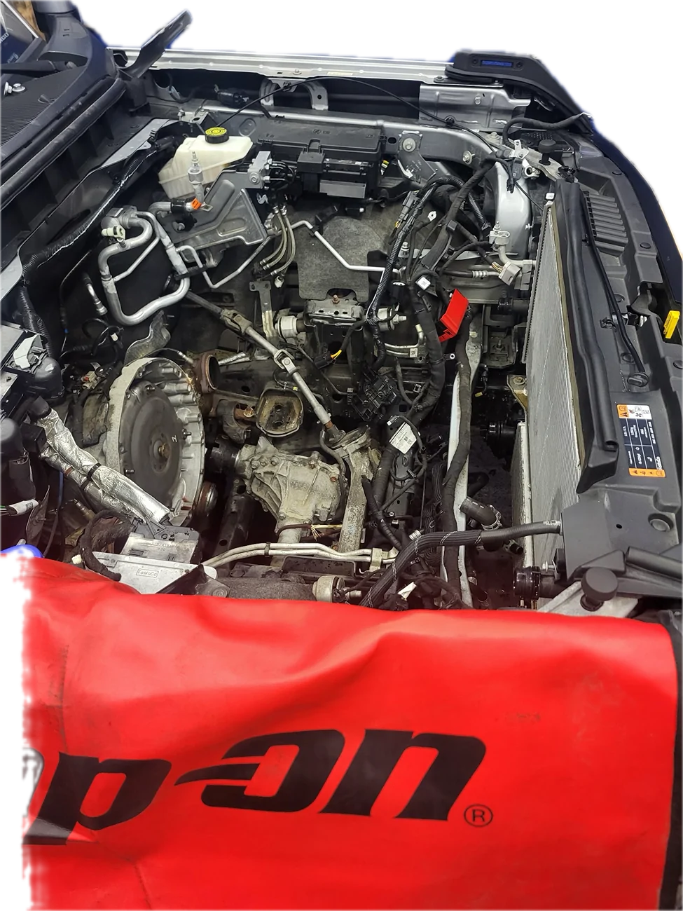

yeah looks like they didnt take the front end off but i wouldnt put it past them not plugging something back in as i must have plugged back in 4-6 connections that were not fully seated and one hose that looked to be an evap hose that wasnt even connected. Again thank you very much for the help. Im armed with information and can now plead my case much better than i would have been able to. Im very glad i tagged you on that post lol!
You’re very welcome.
Based on that picture alone, and considering the codes didn’t start until a few weeks after you already got it back, I’m going to guess that this was an unrelated issue to what they did and just poor luck that you had another problem. But either way, at least you have a direction to go now.
