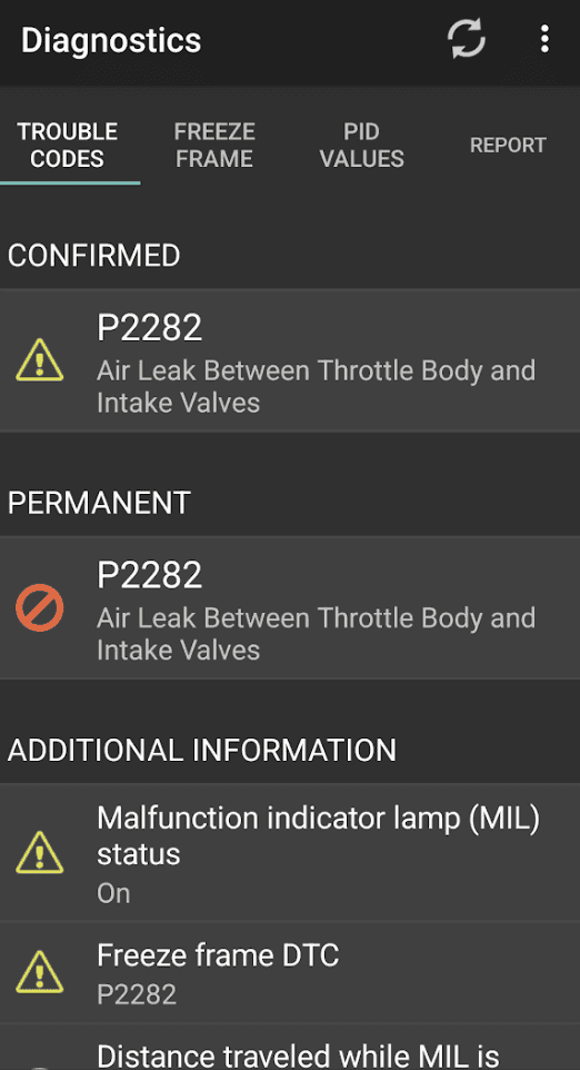

So I just had this error come on in my Bronco, full stock other than a K&N filter.
I'll take a look at my own connections tomorrow when it's light out, but at least I'm not the only one to ever get it.
My code reader app said it was a permanent code so I didn't even bother trying to clear it yet.

Interesting. I wouldn’t clear it. I wish I hadn’t. But, it never came back. I just had my catalytic converter replaced yesterday. I don’t know if it’s related 1.5 years later.
I made sure the 4 bolts were torqued and the hose clamps as well and it never came back. I was convinced that perhaps one of the catch can fittings on the engine side weren’t fully seated. But, that would cause more issues at this point now that it’s been 18 months.
Let us know if you find anything out.

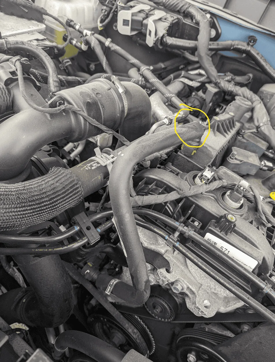

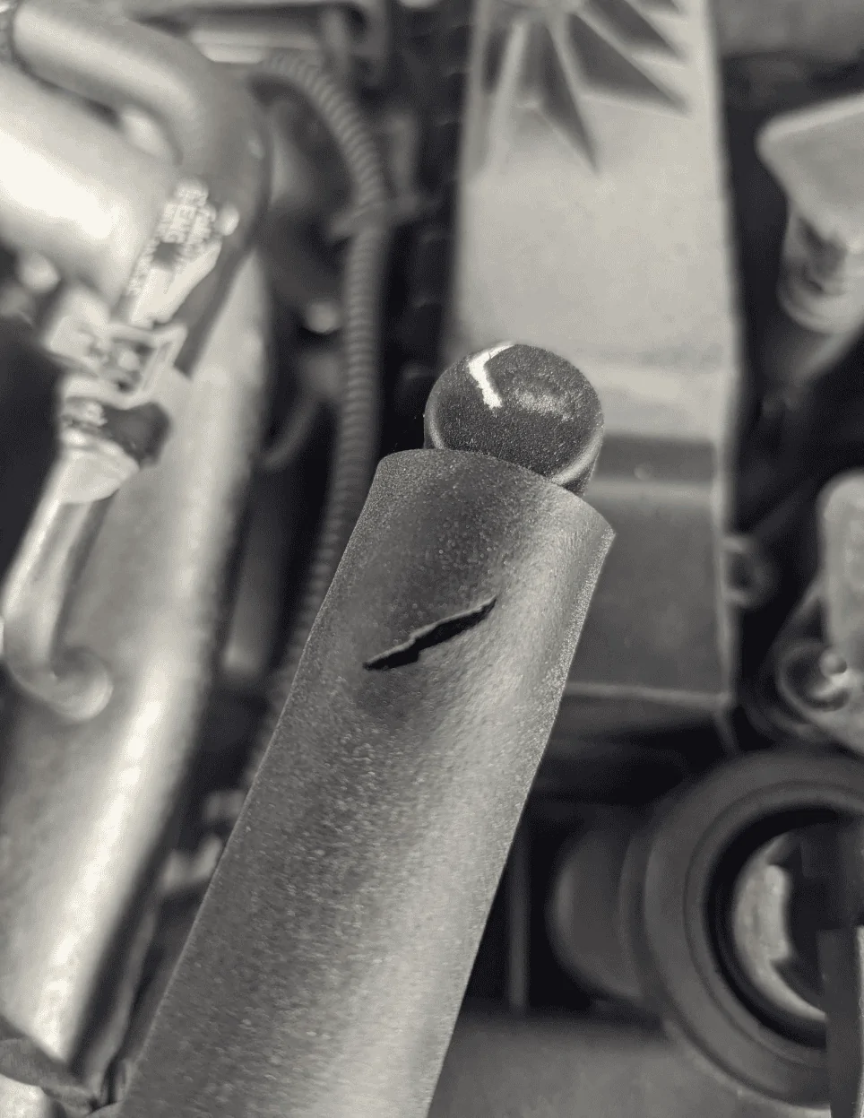

Well I'm no mechanic but I did find a cut in one of the hoses
Ford Bronco Service Engine Soon Warning - Code P2282 1704645910386
I guess I'll just take it to the dealer and find out for sure.

Can you pull back that rubber sheath at all? Which line is that? Hard to tell from pic.

Ah. Yep. That’s the hose you remove to install the Ford Performance Oil/Air Separator. I doubt that’s tied to your code. Throttle body is on the driver side of the motor next to the battery.
