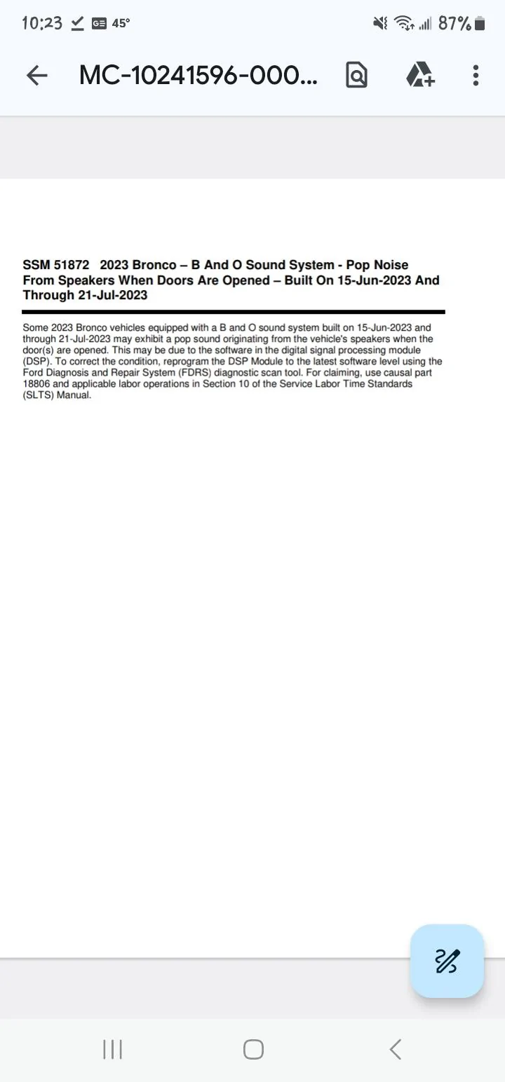

To those of you who have had this such issue ... did u ever have the notorious speaker pop when opening a door ... I have heard some say when they had the tsb/ service bulletin about it . That's when they started to get the intermittent issue this post was originally about
Curious about your speaker pop…..? Have you added an aftermarket stereo amplifier? After I installed my Kicker Key amp I had what sounds like the same issue…..it was the radio detect button for me. I had to depress it in and it stopped. Just spitballing here…..??
I have not! Good to know there's a TSB though - does the pop happen when you're opening the door after shutting it off or before you start it up?
