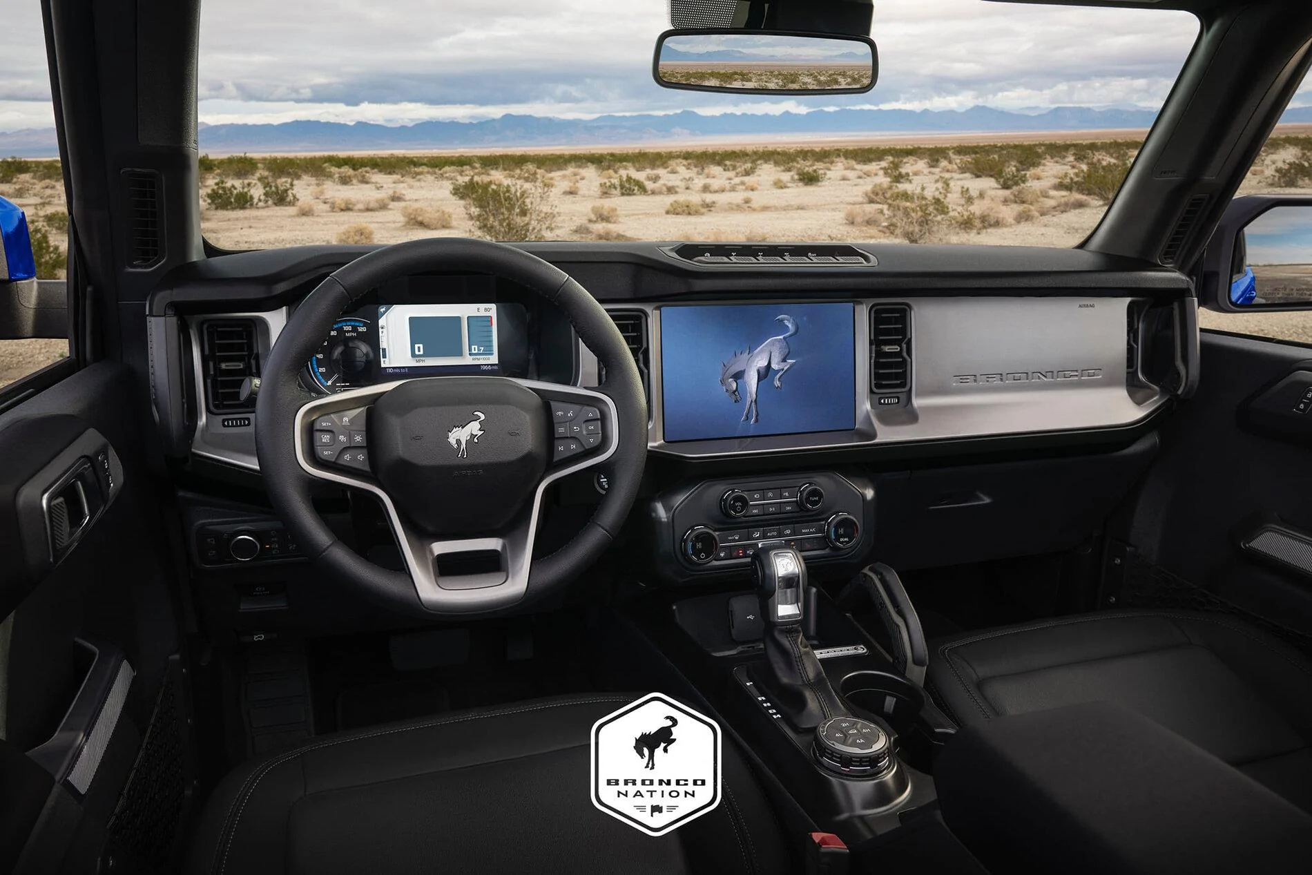

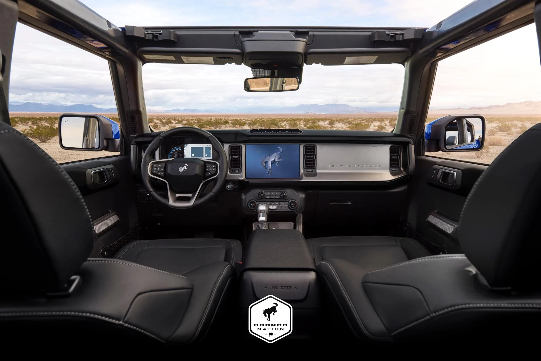

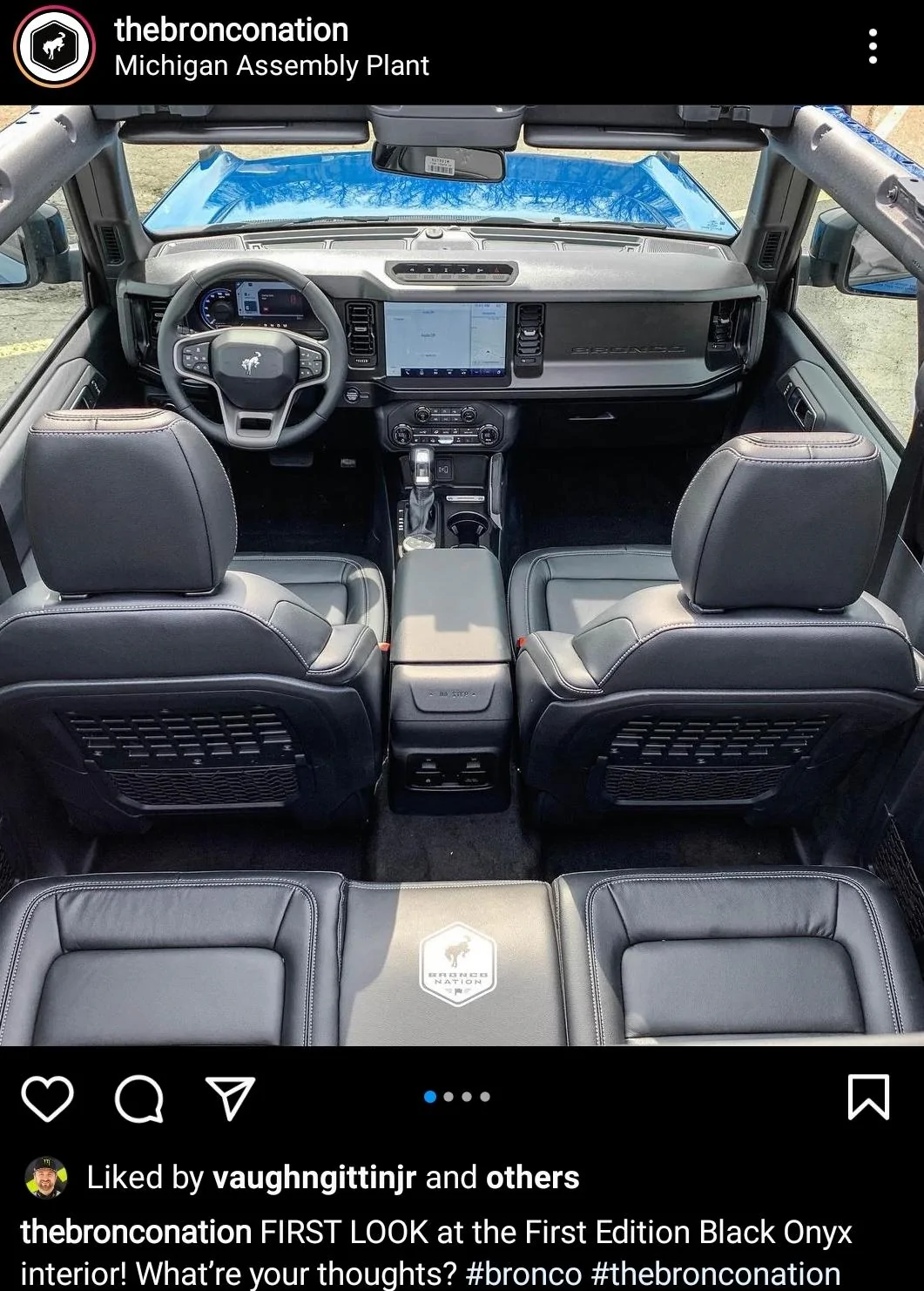

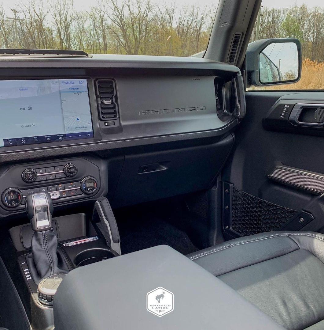

Welp, Ford fucked up the black interior as well. The silver dash face they originally showed which looked so good is now gone and replaced with crappy plastic they apparently forgot to paint.

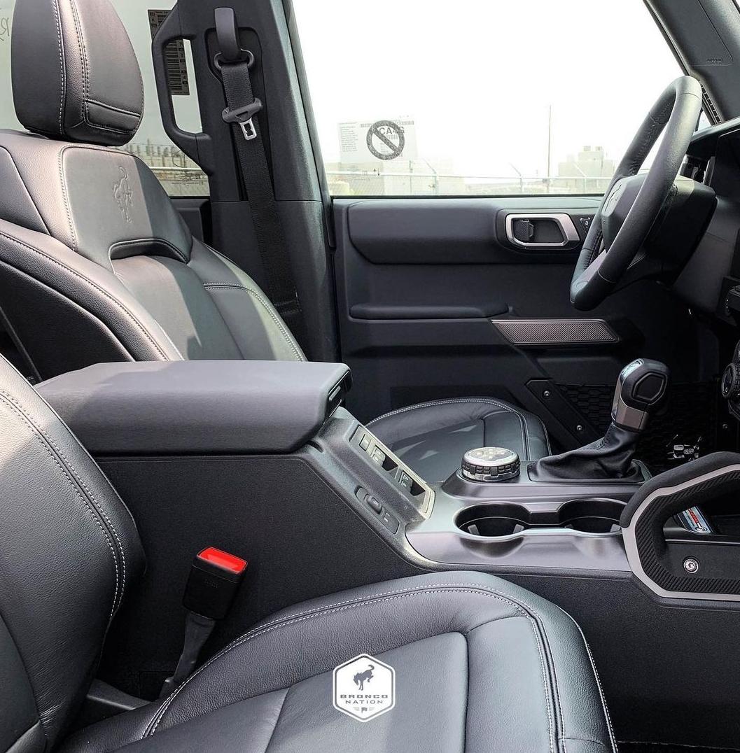

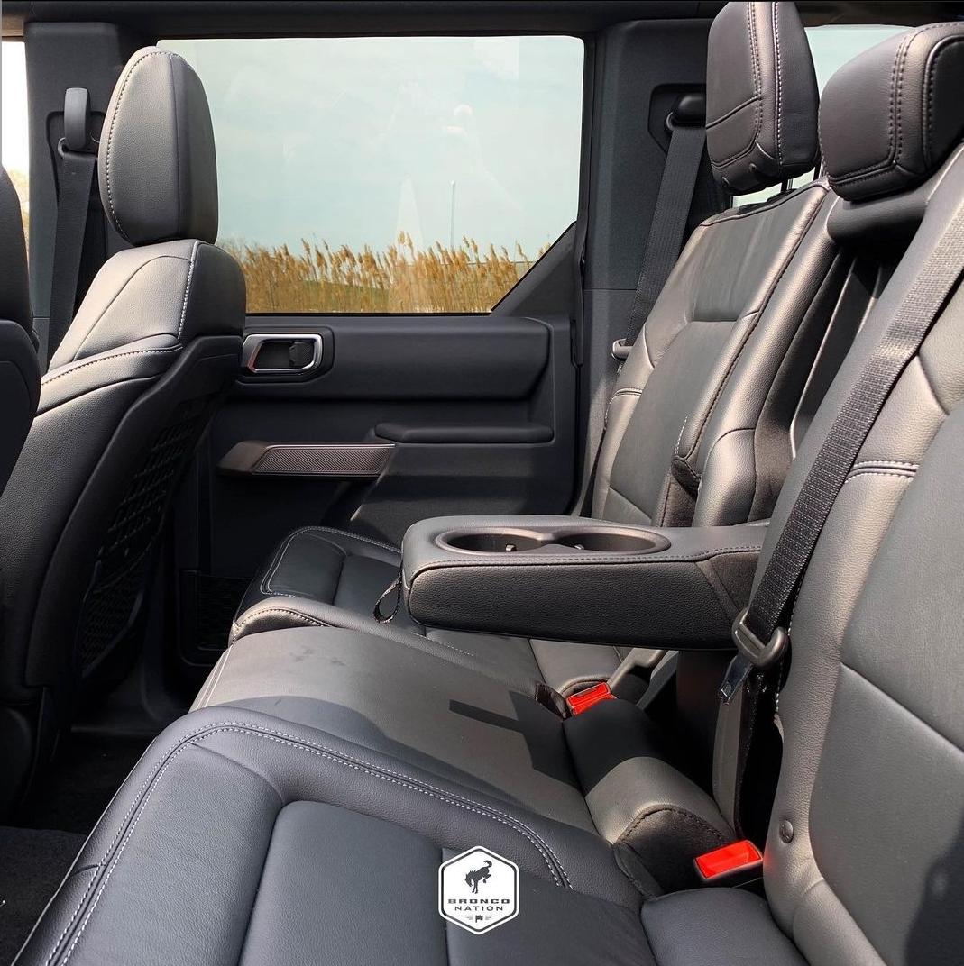

So grey interior...not a black interior. Disappointing. I’m hoping it looks darker in real life.
Nah that's just light reflecting on the black leather. It's black, it'll look fine. It's the change to the dash face I'm pissed about.
Ford Bronco First Edition Bronco Thread 2021 Bronco First Edition Black Leather 3
It sucks but at least you can change that out.

Looks great to me. But I didn’t expect it to look exactly like the renderings, none of the others do.
That's what I'm hoping for. Who knows how easy it comes apart though. May be easier to wrap with a satin or brushed silver. Guess we'll see. It definitely needs addressed.

I like the new dash. I'm sure that the leather interior is darker then the picture makes it look.
