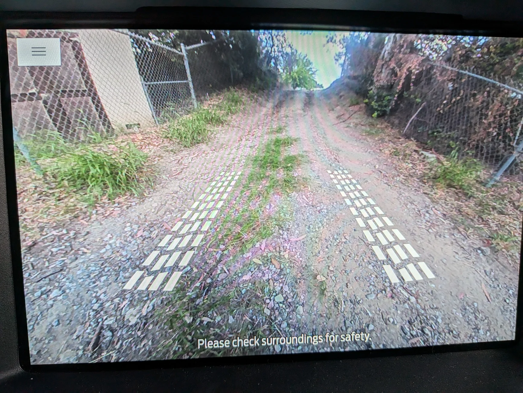

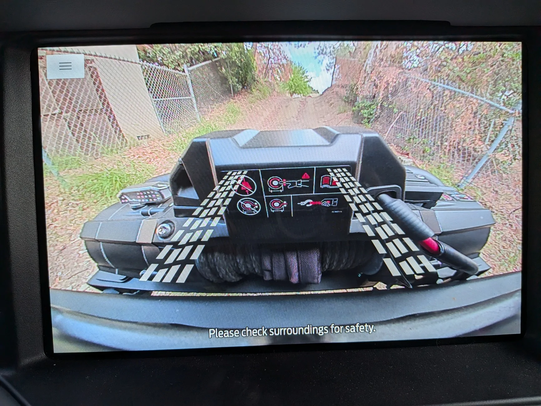

Before and after photos of the camera view in Baja mode with the winch installed.
Before M2M install:
Ford Bronco Ford Performance Winch Camera Relocation Bracket / Kit PXL_20260527_205441299
After M2M install:
Ford Bronco Ford Performance Winch Camera Relocation Bracket / Kit PXL_20260528_012607289
