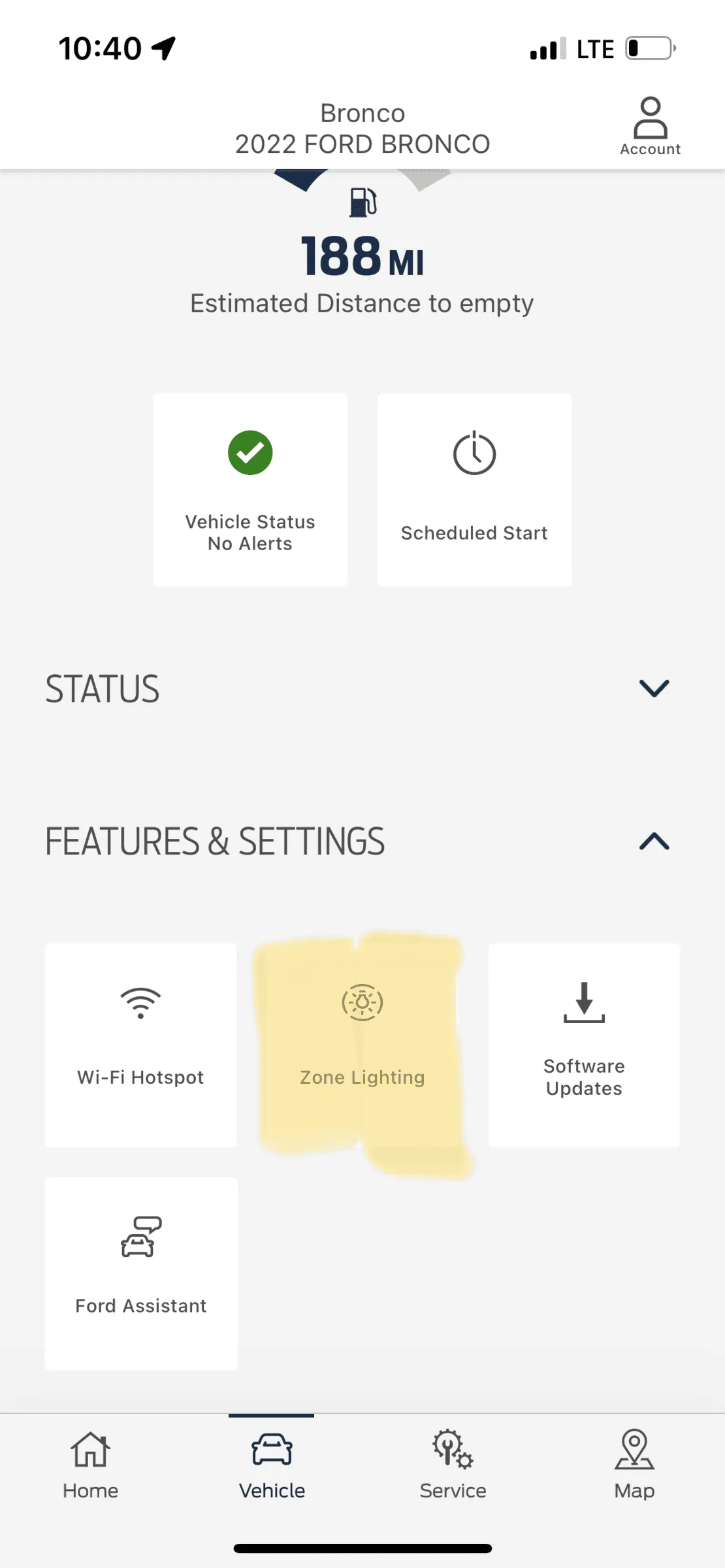

Anyone else feel like they're missing features in FordPass? My Bronco has the Lux Pkg and I don't have access to zone Lighting in the app, plus Alexa says the 2022 Bronco isn't supported for the Alexa skill to turn on the vehicle (my gf's EcoSport has this so I'm confused). Remote start works, but I needed to troubleshoot with technical help to get it to work and at some point they said my vehicle didn't have a modem even though it does. I wonder if there's some provisioning data missing that's causing these issues?

No update, and I Uninstalled and reinstalled the app last week for good measure.
Did you go under Features and Settings in the app?

I would call Ford Customer Support and see if they can help.

Have you tried unsyncing your Bronco from the app and resyncing it?

Yeah, Customer support had me do that when my remote start didn’t work.
I might check the battery terminals tomorrow, a YouTuber had issues with his Bronco and he noticed some of the connectors were loose and it fixed some of those issues

Well I didn’t want to but I master reset my vehicle and it seems to have fixed my issue! If anyone has the same issue try a master reset
Edit* The fix worked for the missing Zone Lighting, the Alexa skill still doesn't work
