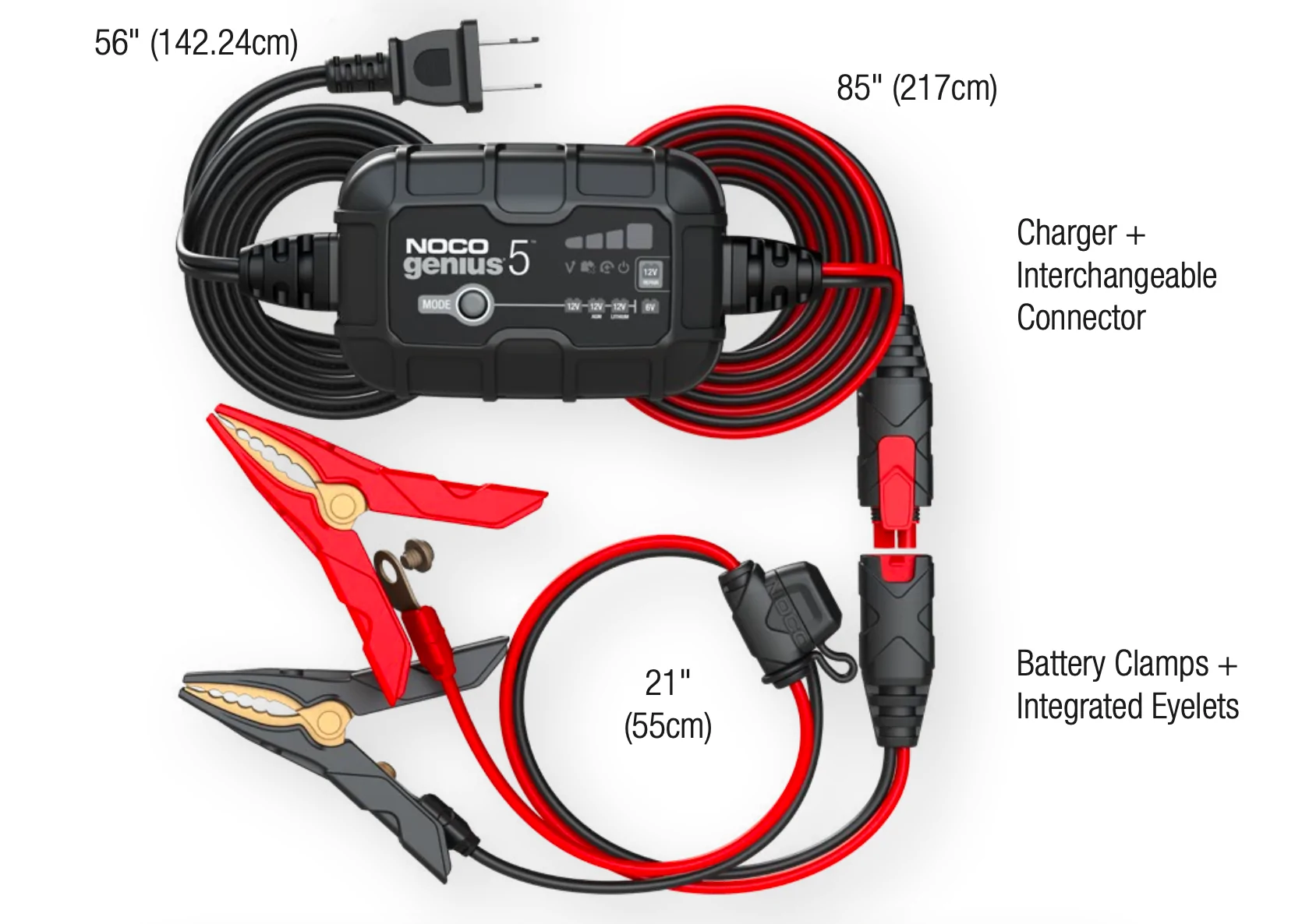

Ford Bronco why? Remote Features Disabling 1000006944
Your battery will appreciate it. Just be sure to use AGM mode.
