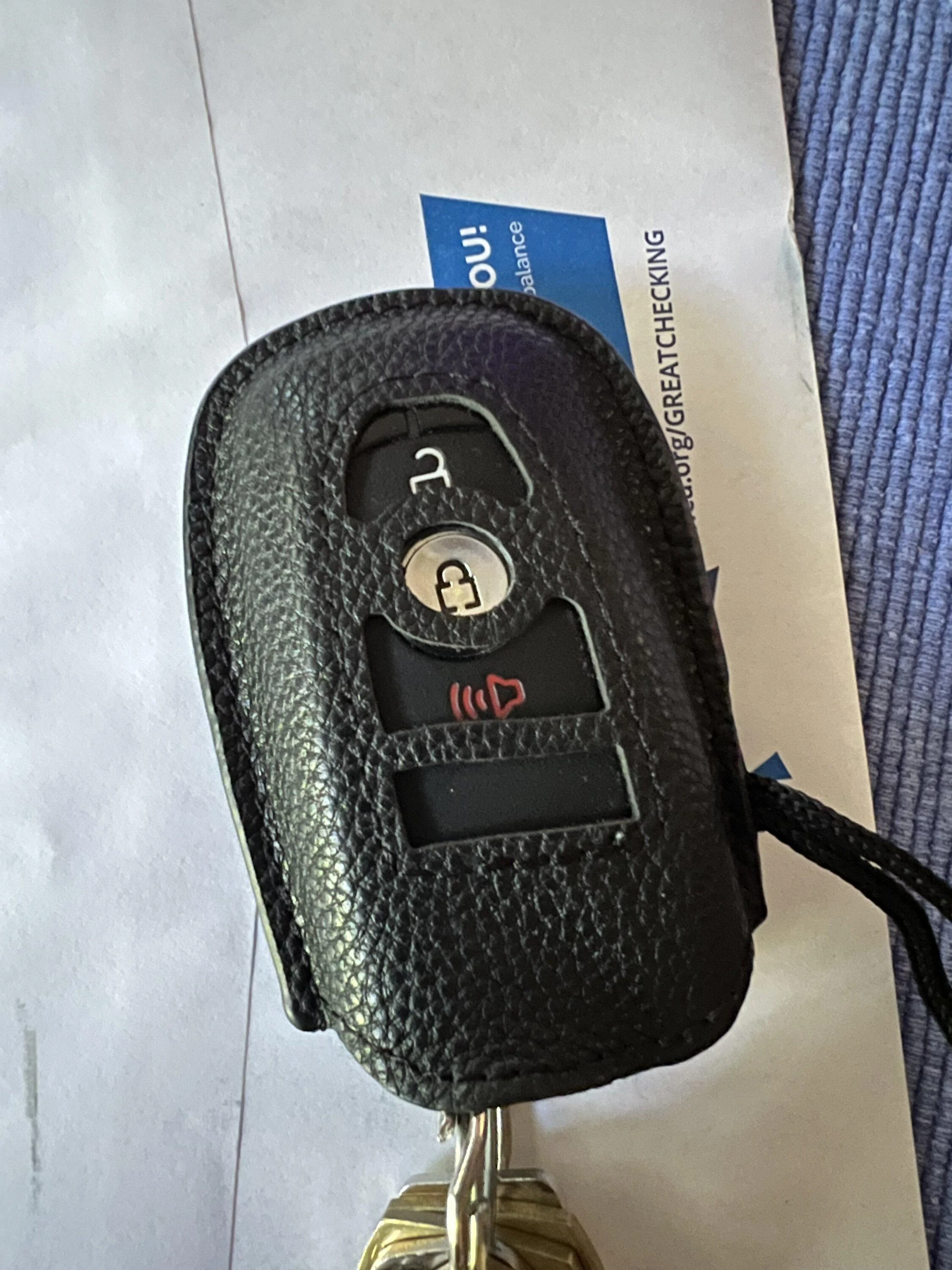

Ford Bronco Disabling the Remote Alarm Button on your remote Key IMG_3711
are you using the dealer supplied key cover?
it was part of the SWAG i received at pickup
