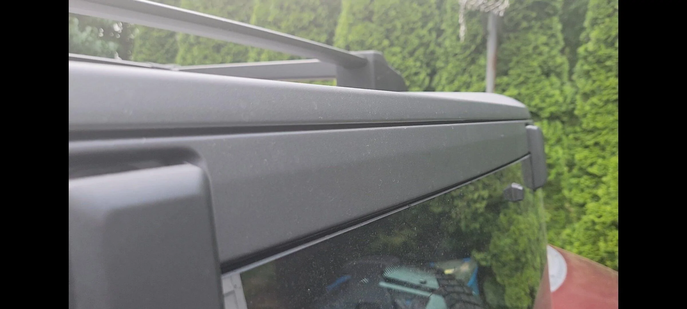

I picked up my bronco Saturday. I just noticed today when I open the rear window the hard top itself moves where the hinges mount. Wasn't sure if other people have had this issue? The hard top over all doesn't seem very solid, so I didn't know if it is normal.

Yes the issue is the fiberglass bends when I open and close the glass.

Can you get a short video of the movement you're seeing? Or a pic of the location where its bending?

The fiberglass part the window hinges bolt to moves when you open and close the window. The passenger side hinge is also loose where it bolts to the hard top, but it's a seprate issue.
