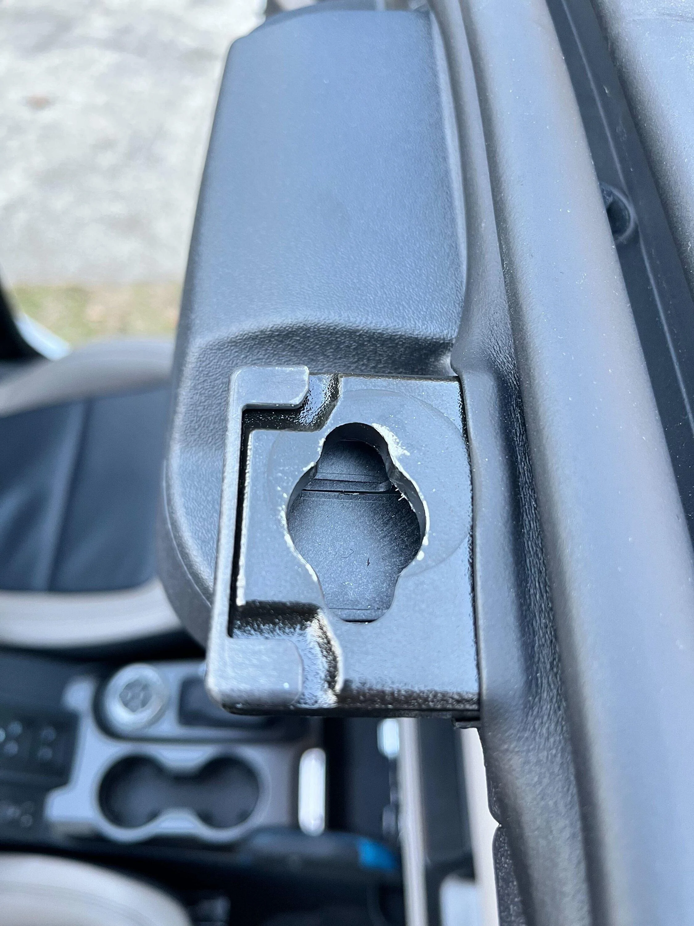

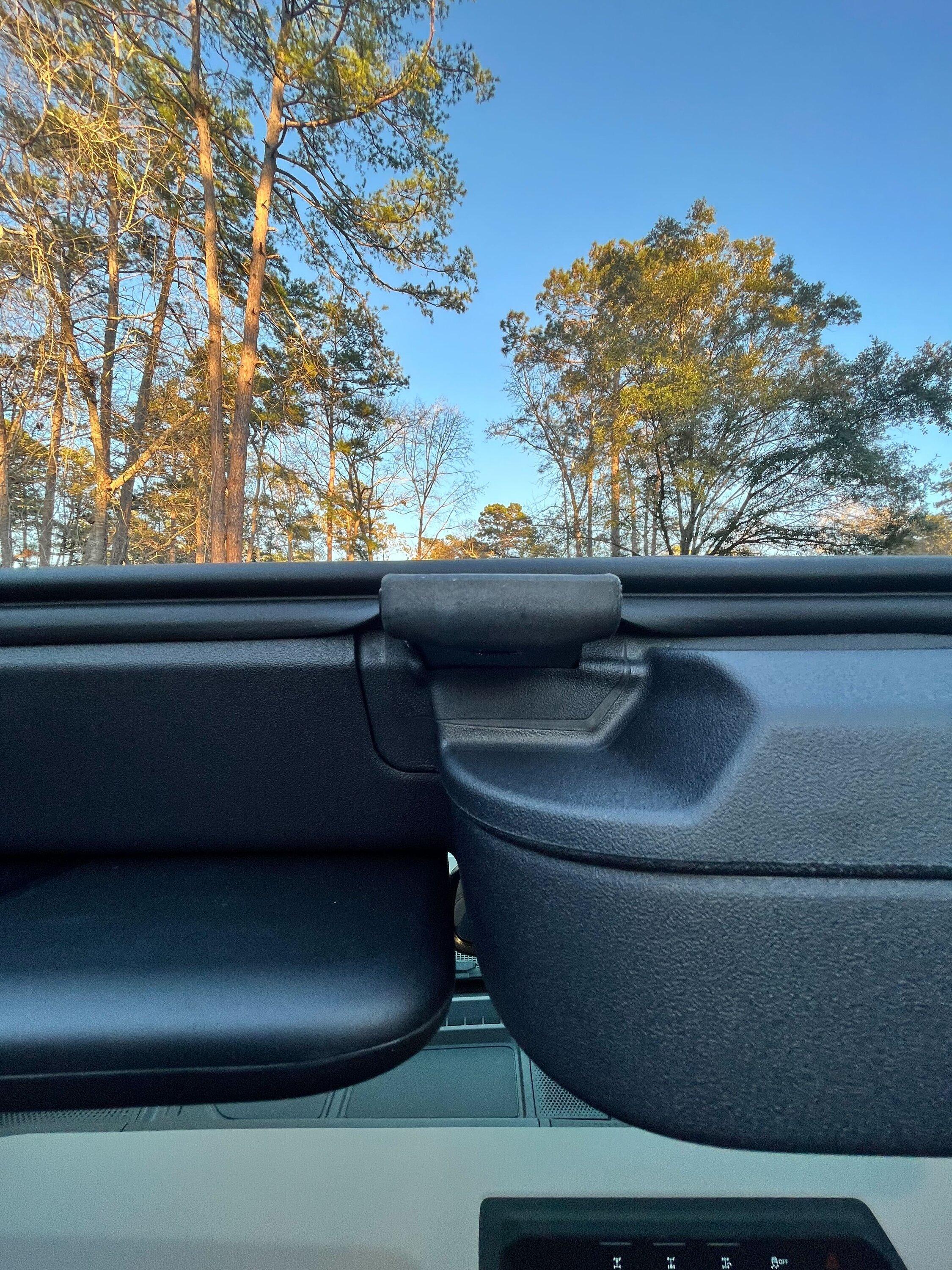

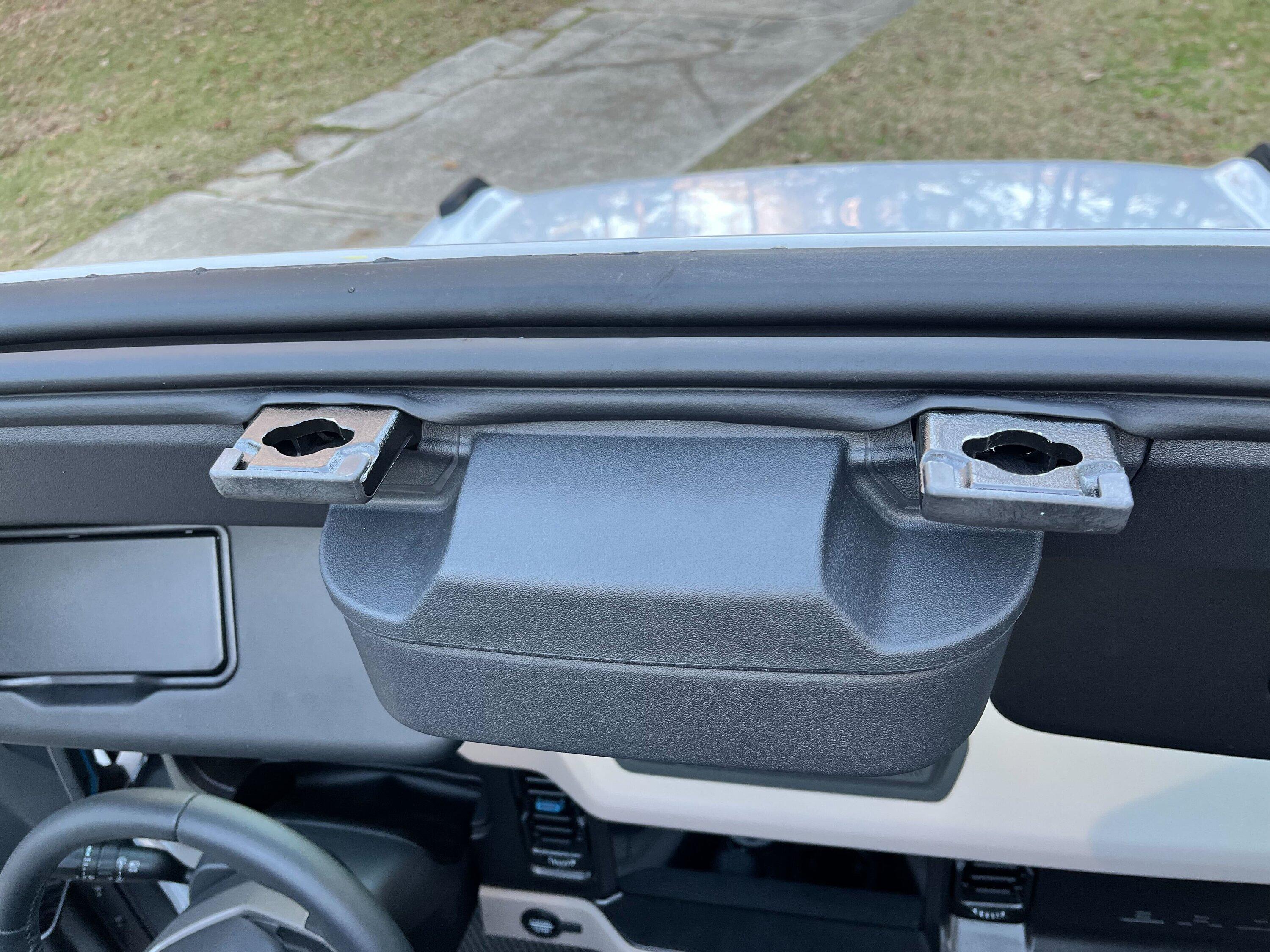

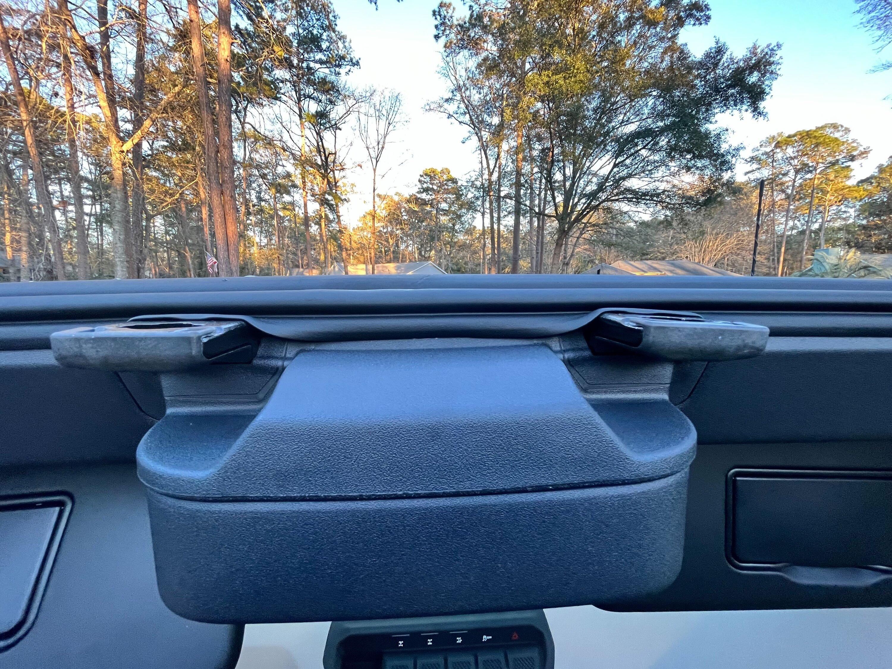

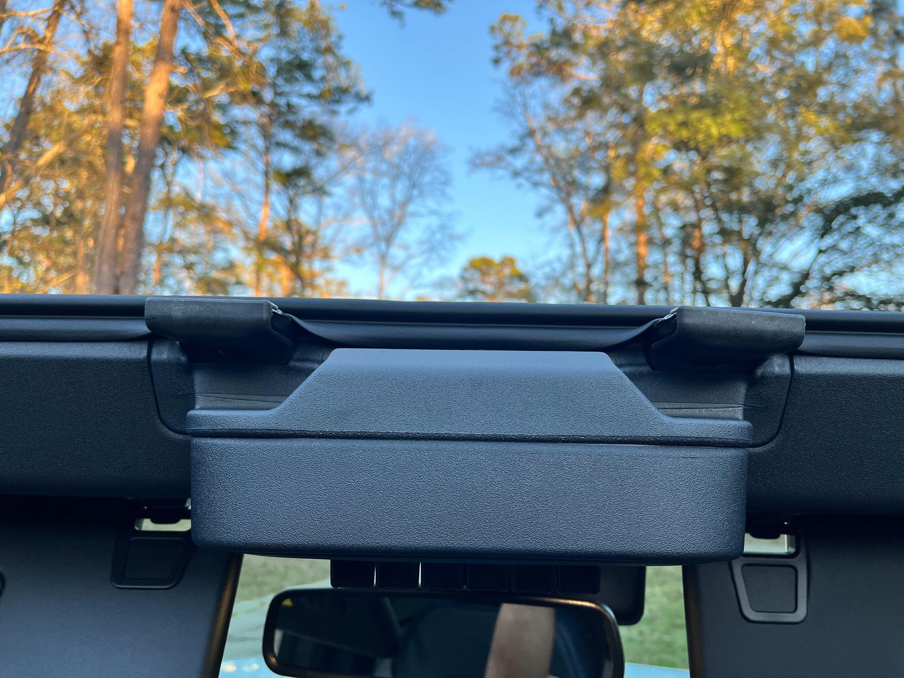

Any one having this Hard top issues ? It looks like the right side mount is bent and the Bronco is only a month old :mad:. We have only taken the front row tops off twice

I think I see what you are talking about? Does it seem like it's sealing up and snug when you are putting the fasteners down? Any leaks that you are noticing? Any change in noise or wind?
If so, hat in hand and head to the shop for the warranty battle. Or, if you know a good fabricator who might be able to tweak that for you. But then you are opening up a whole new can of worms.

No noise just yet but it's hard to take it off and put back on

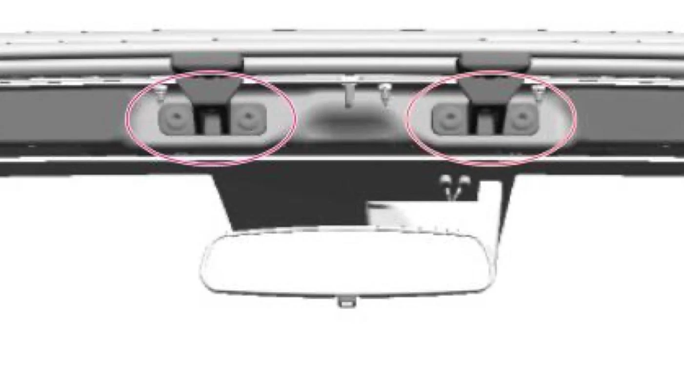

Those strikers can be adjusted, there's a TSB to adjust those due to uneven roof panels/wind noise/etc. TSB22-2288

This seems to be a common complaint with recent builds. Like previously said, those can be adjusted and their was a TSB about adjusting them. Hard to tell in you pic, but if it is truly bent, might need replacement over adjustment.
