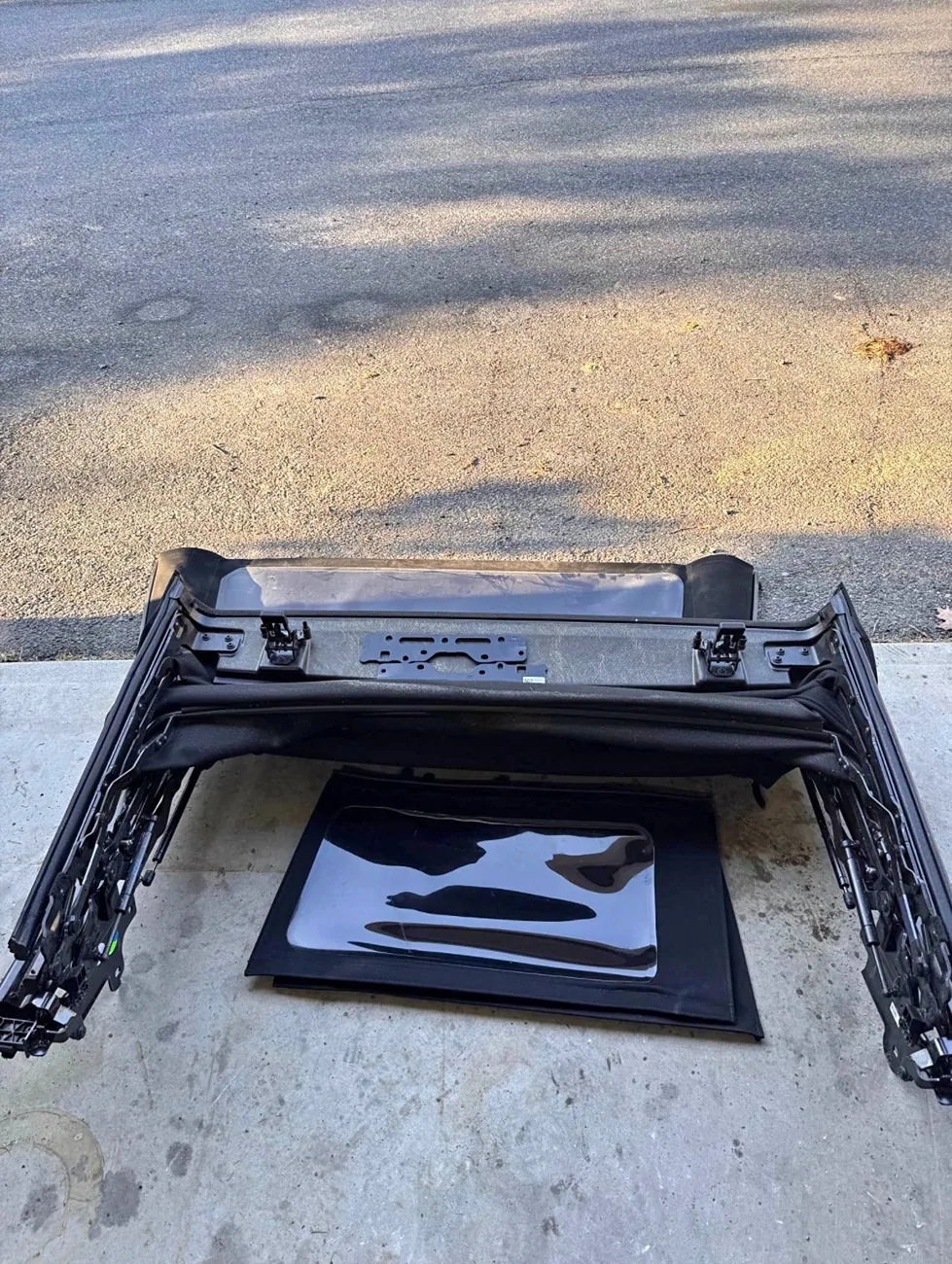

I have a 2026 Big Bend that came new with a hard top installed and want to put a soft top on it. I found a good quality one on facebook marketplace but want to confirm with someone who knows more than me that I will have all the needed parts to do the install. I have some pictures the seller sent me he had a 2021 Bronco not sure which series. Any help would be very much appreciated.

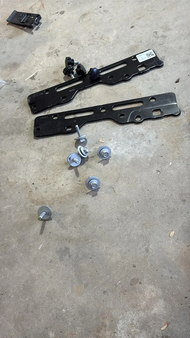

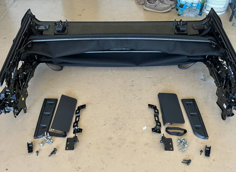

If everything is pictured, it looks like you might be missing some necessary parts.
I did the same, and found the parts list in this post tremendously helpful:
https://www.bronco6g.com/forum/threads/soft-top-prep-parts-kit.113570/
This pic shows all the parts (minus the back and side windows.)
I can't remember who posted it, but it also was helpful. (belated thanks!)
Seller should have all those parts, but you may need to negotiate them as part of the sale.
Good luck. It's totally worth it!
This Pix looks complete for the 2 door top. The plastic bits are needed!
