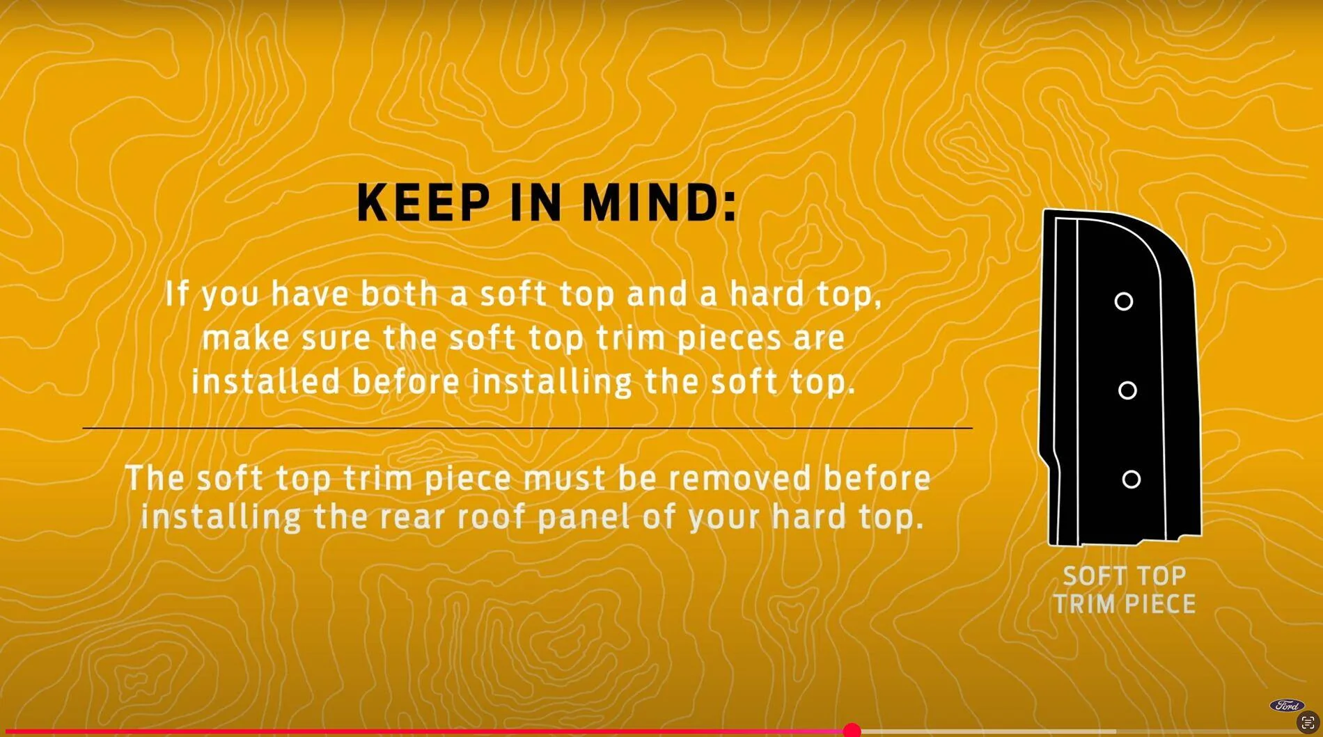

For question two - yes! I do this switch too. You just remove the 6 cargo bolts for the soft top and put the hard top on. All of the other hardware stays in place!
Epic - so you don't have to change out the exterior side panel plastic at the C pillar? I am just double checking as I have seen mixed reports there, including this screen in an official Ford video
Ford Bronco Hard Top <--> Soft Top Screenshot 2025-05-17 at 10.08.39 PM
GreenVibesOnly
Jake
Nov 30, 2023
Seattle WA
4-Door Bronco Badlands w/ Sasquatch + Lux
Nope, they can stay.
