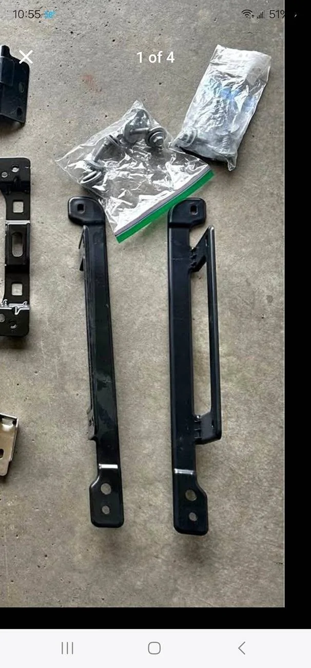

Are these the same as you ordered?
I’m gonna be honest here. Those don’t look like what I’ve ordered but I’ve only ever seen them laying flat or actually assembled on the vehicle. So they very well could be.
