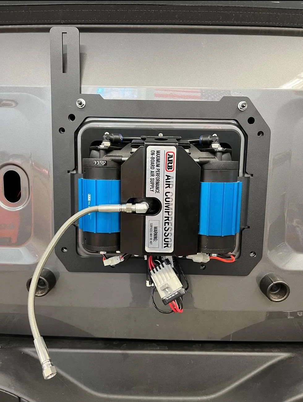

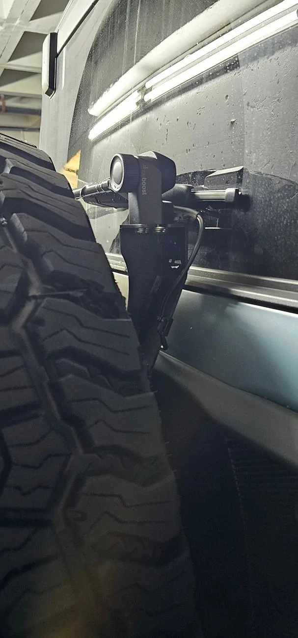

Hmm yeah I see what you mean. I thought the Tire Carrier Compressor Mount had the extended bracket for either side. Looks to be drivers side only.
I guess the only solution for someone like me is to make another custom bracket for your custom bracket. We’re slowly reaching bracket inception.
Ford Bronco Help! Need ideas for WeBoost antenna mount **SOLVED** IMG_8286
Ford Bronco Help! Need ideas for WeBoost antenna mount **SOLVED** IMG_8288
Side note but I checked your other threads and didn’t see anything about your Tailgate Compressor install. It seems like you have the exact setup that I would like to use. There’s a great YouTube video on the install, but it completely glosses over routing the wiring. It only really details fixing the bracket and compressor to the tailgate. Any interest in summarizing your project?

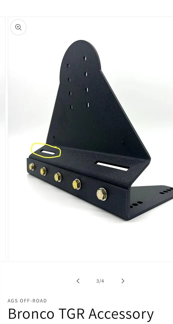

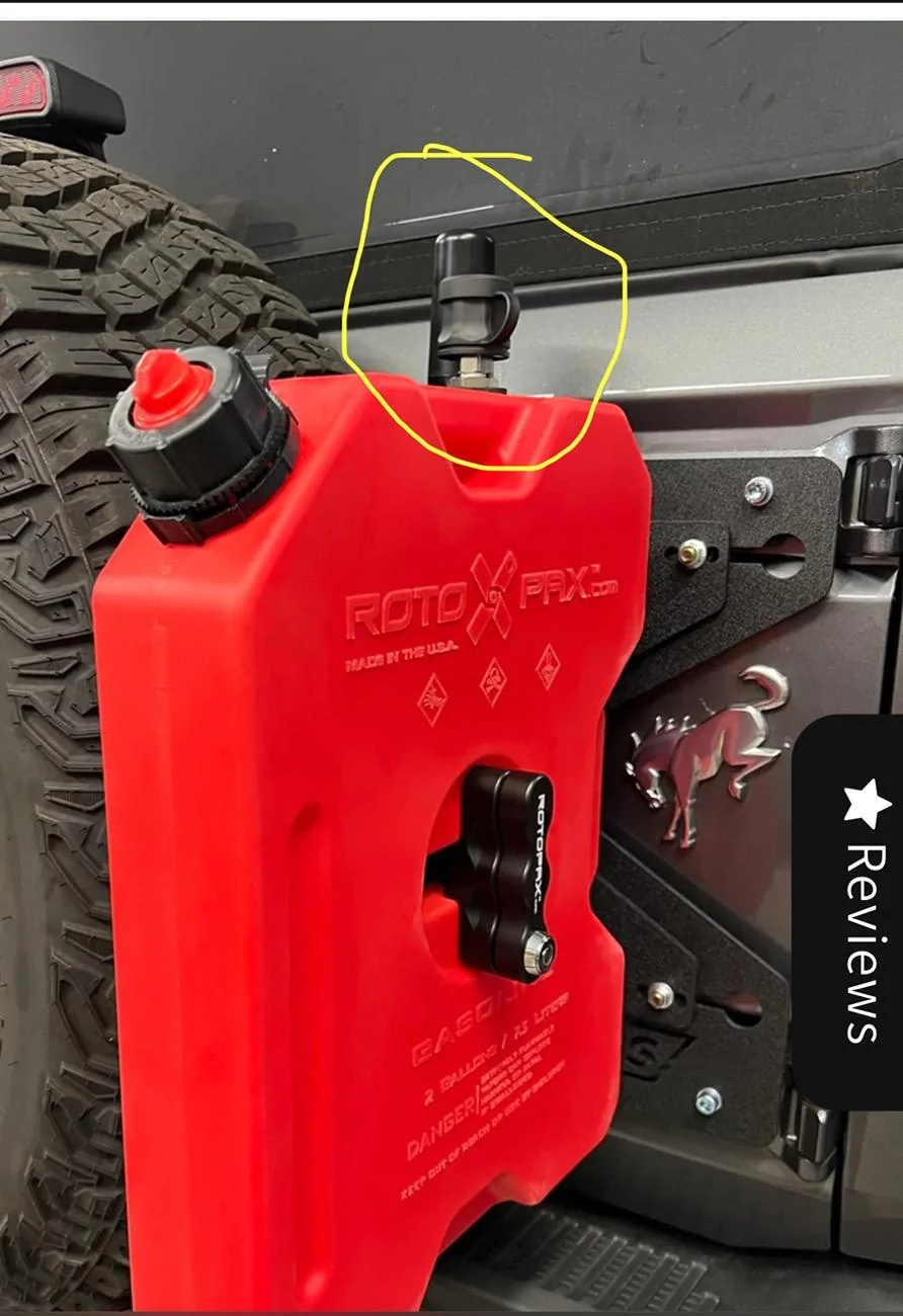

Also, keep in mind that we are talking about slightly different products. Your pictures are of the AGS compressor mount (They also sell this mount in two different kits now. One kit has the chuck mount for between the spokes of your wheel, the other kit now includes the antenna/chuck mount.) I have the AGS tailgate reinforcement that has the compressor mount built into it. The tailgate reinforcement has a mounting point on the passenger side as well and AGS has a couple of options there. I bought the passenger side Rotopax bracket (TGR Accessory Bracket), and that bracket has slots for the antenna/chuck mount or something like my mount to be mounted on the passenger side.

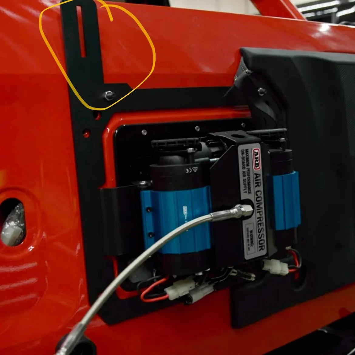

So as far as I understood from your photos, the custom bracket you had machined attaches to the AGS antenna/Chuck location. Circled in image attached:
Ford Bronco Help! Need ideas for WeBoost antenna mount **SOLVED** IMG_8291
The Weboost then folds down towards the passenger side.
My original plan was to do the opposite: mount the custom bracket to the passenger side and have the Weboost fold down to the driver side. But it looks like I’m limited to the design of the AGS bracket, as the antenna/Chuck extension is built into the design and is drivers side only.

Yes, to mount the WeBoost on the passenger side using my mount you would need to do the tailgate reinforcement with the accessory mount and then you could mount the WeBoost on the passenger side and fold it down toward the drivers side.

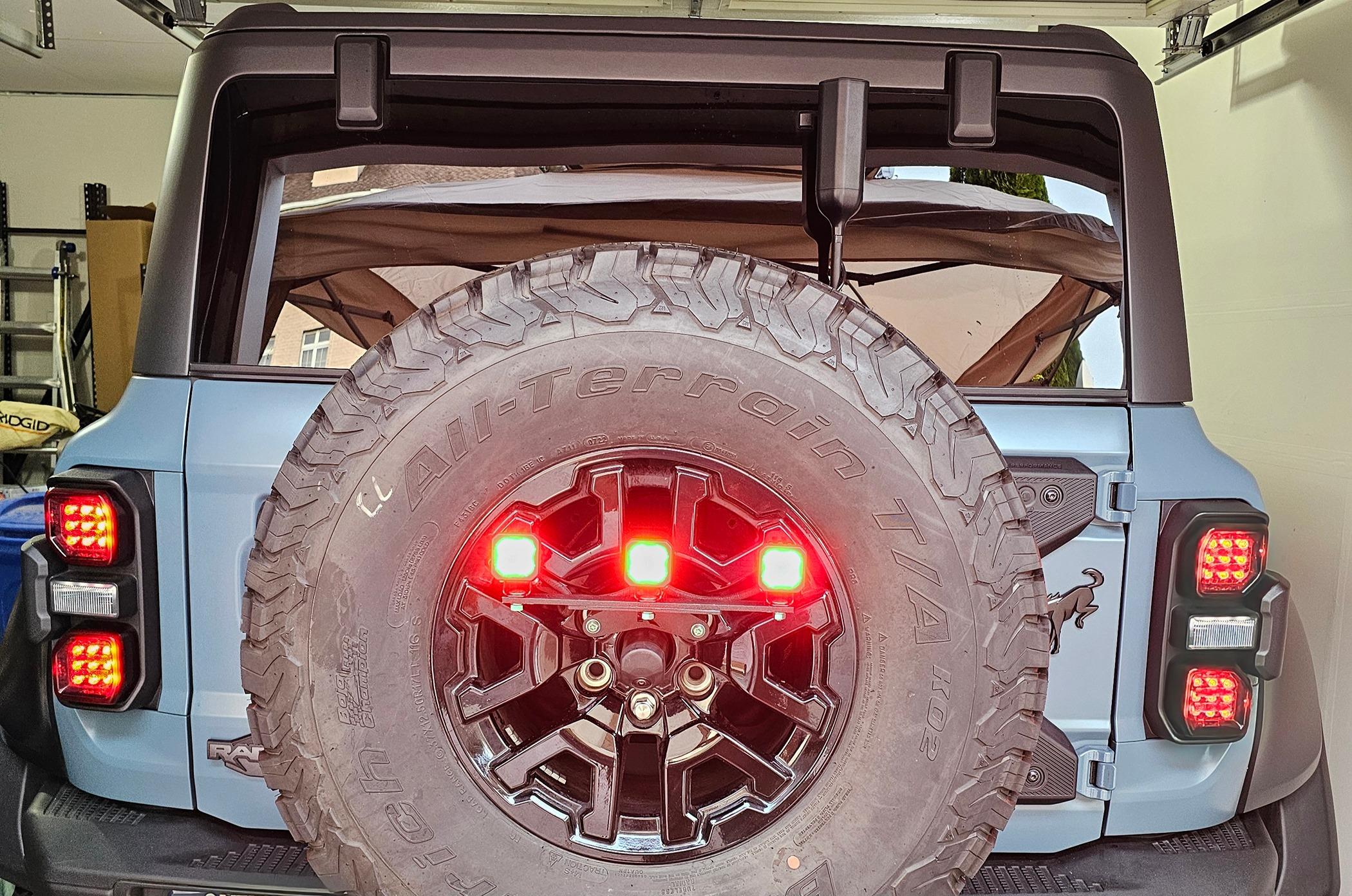

I did the swarfworks antenna mount and drilled it with 3 holes to fit the weboost. Works great for me !

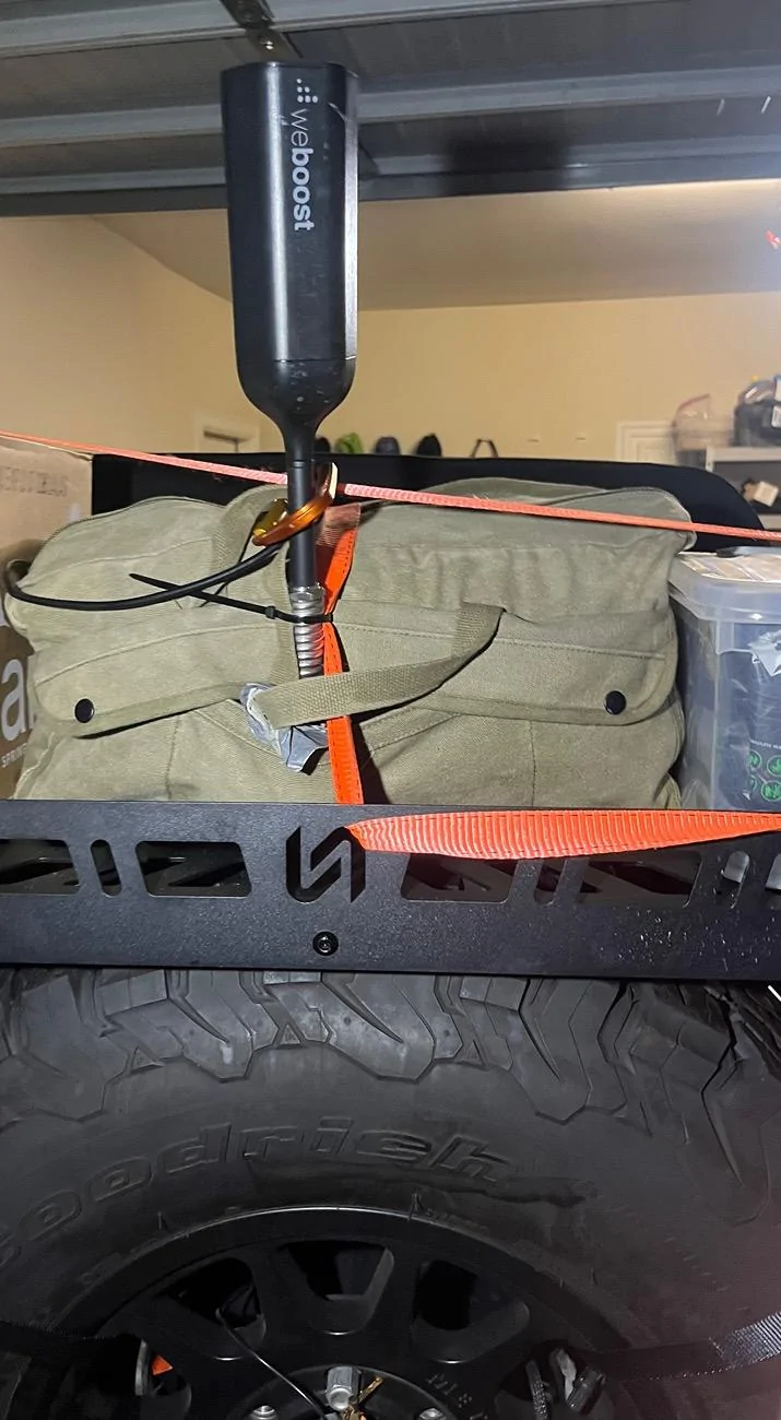

Headed to CO (Crested, Pearl Pass, etc) tomorrow with this last minute setup. Tried not to overthink it. Will fix it right some time on the road - plenty of mounting holes on the JCR swing outs and this Turner basket, but a lot of other gear mounted already) .
