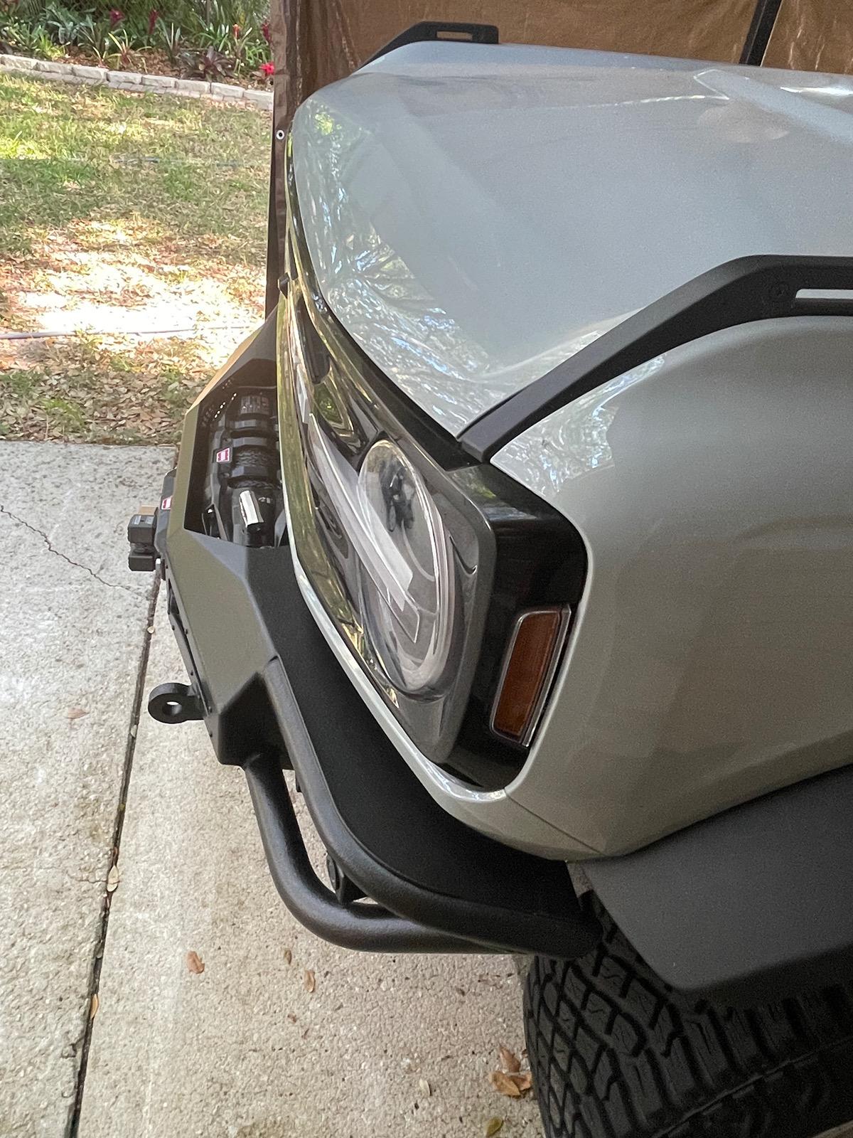

I will get another pic with tape measure but took this earlier.
Appreciate the picture. The ends look near the same as my capable. Obviously it gets a little thicker in the middle where the winch is located but that’s to be expected.
I have the Overland style so plates on the ends instead of tubes but think the profile is the same. Helps provide some warm fuzzies. Thank you.

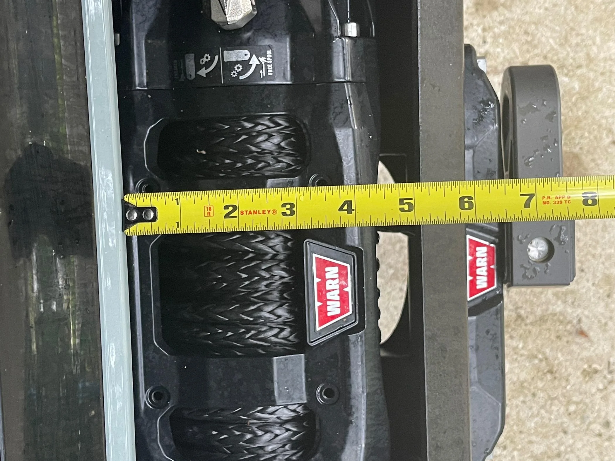

Would love to see a side profile pic along with measurement showing how far it sticks out.
Looks to be 6.5” from lower grill/valance to front of fairlead and 7 5/8” to front of Factor 55 hook as viewed from above.

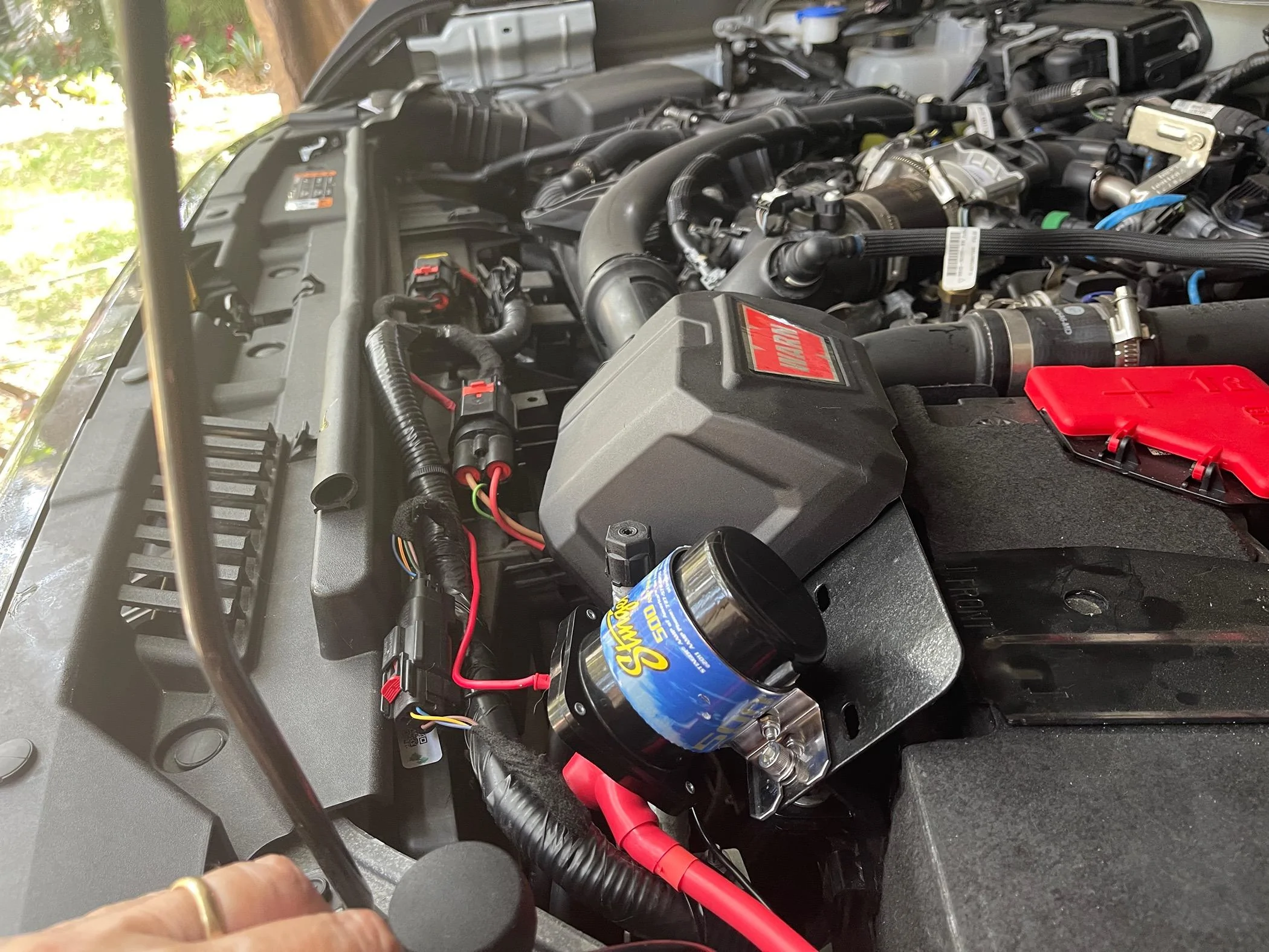

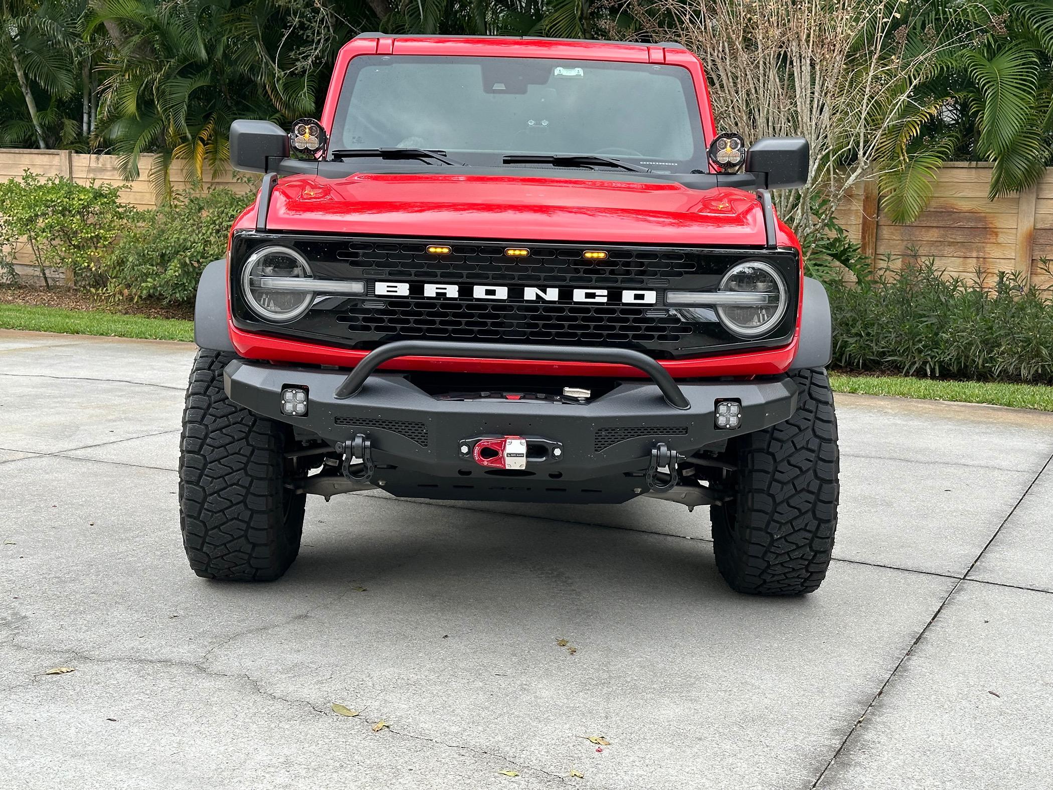

I went with the Warn Evo 12s for my BAMF Overland bumper. Not sure if this has come up already… Make sure you can relocate the winch solenoid. It’s a tight fit and removal is almost required. Additional benefit of relocating is it will improve the airflow to the intercooler.​
Perfect, thank you so much! Really helps put my mind at ease. That’s not bad at all.
Nice rig! 😎
I did go ahead and order BAMF’s relocation kit. It includes the bracket that gets installed by the battery and also extra heavy gauge wire. Was going to skip but Jerry encouraged it.
A few folks have advised the same. Glad I got it. Plus the 25% off applied to ALL items in the cart so saved a few cents there too.
I got the same option from BAMF but i had to mount control box with cables down and i had to drill new holes (and installed Rivnuts)for my isolator relay to move it lower too. My hood had an insulation panel so clearance was less. I used the Aux 4 switch for winch relay connected to the unused lead just in front of relay spliced to aux 4 lead near hood hinge (Where they both exit unterminated)

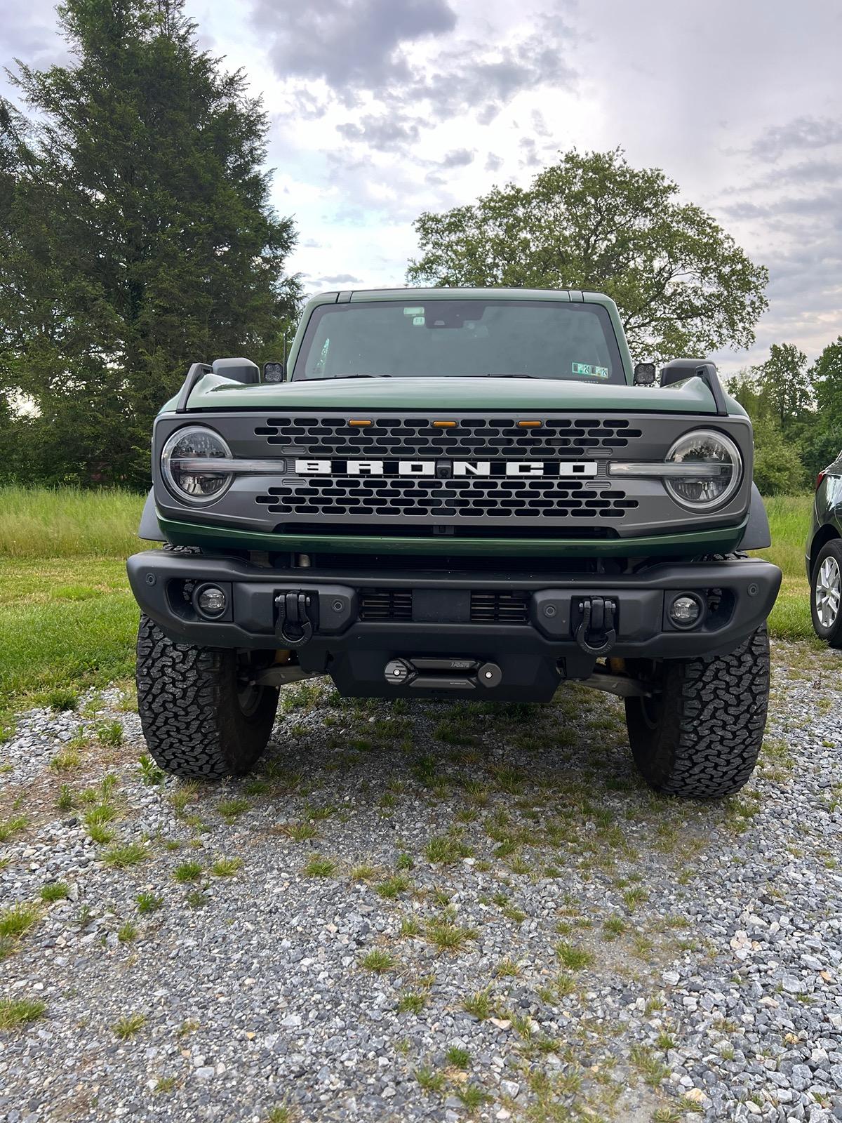

I went with the the RC 12k and hidden winch mount. I added a wireless remote control and put the power through a relay controlled by an upfitter switch. Also use the freedom winch fairlead. Very happy with the set up as it’s clean and out of the way but there if I need it.
