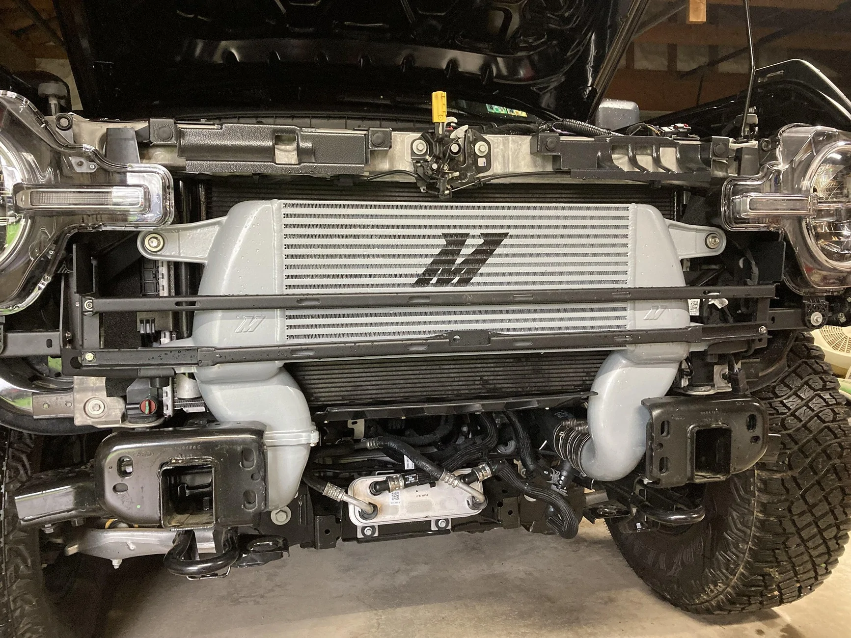

I know this has been touched on in many other threads, but wanted to start a direct thread on it. CV Fab was supposedly going to come out with one for the Bronco Raptor however, none of us have been able to get a confirmation from them. Looking back to when I had my full front end off. I'm not even sure if a high amount is possible. I had asked designed by Moran if he would build something like he did with the raptor R kit he sells, but unfortunately he won't. it doesn't seem like there is a lot of interest by manufacturers in actually making one for the Bronco Raptor.
Ford Bronco High Mount Intercooler IMG_7830

Hey @Tye - Wanted to jump in here and share a bit of exciting news. I can confirm that we're actively working on developing a standard and high-mount intercooler for the Bronco Raptor. We're still very early in the process so I can't speak to any timeframes just yet, but I wanted to let you know this is coming!
- Josh

I did CP-E as well, I like the internal divided runner which helps with throttle response/turbo lag. I'm not sure I'd do a high mount due to reduced cooling to the radiator. Ideally, both the intercooler and radiator have their own unimpeded air source for max efficiency. They're all using the same size core too so it's really just down to what. you want to pay and the small differences between them. I would have gone Wagner but they never responded to any of my questions.
If I were looking at it, I'd redesign the front bash plate with a slightly larger opening and fashion a sealing duct from it to the IC while making sure air is evacuated out the back.

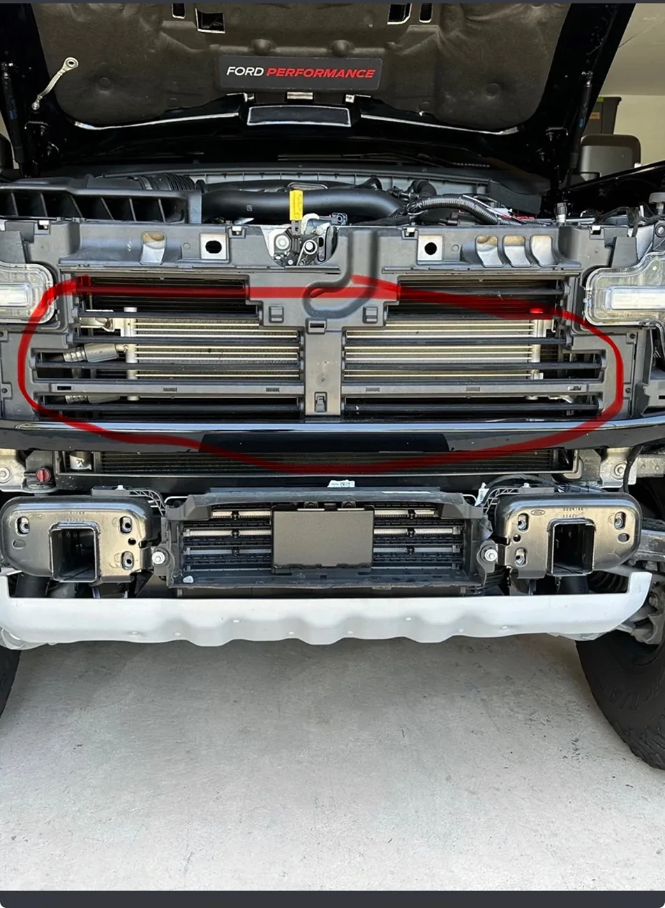

i dont believe non raptor broncos have this to deal with
Ford Bronco High Mount Intercooler IMG_0307
My old badlands 2.7l had active shutters and my friends badlands 2.3 had them also
Ducati1098
9,997
23,246
Midwest
@Tye is referring to the large transmission cooler in the way, not the shutters.
