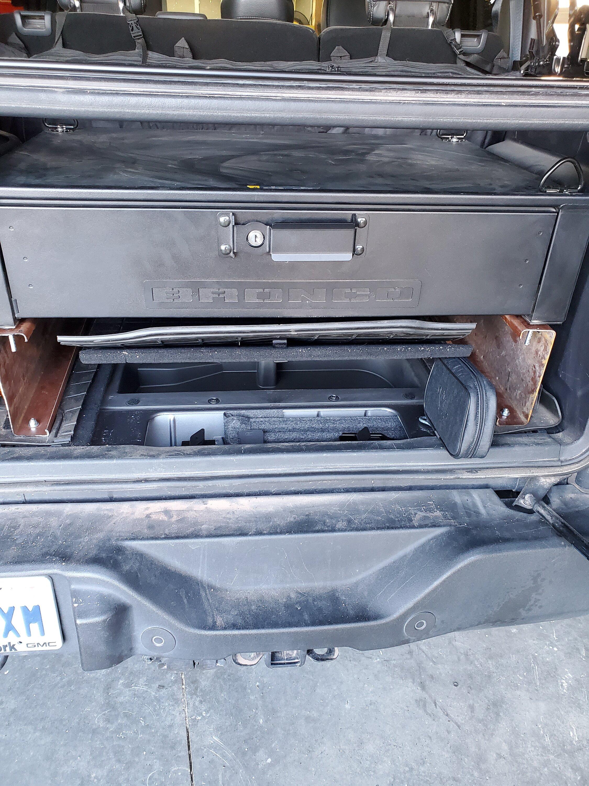

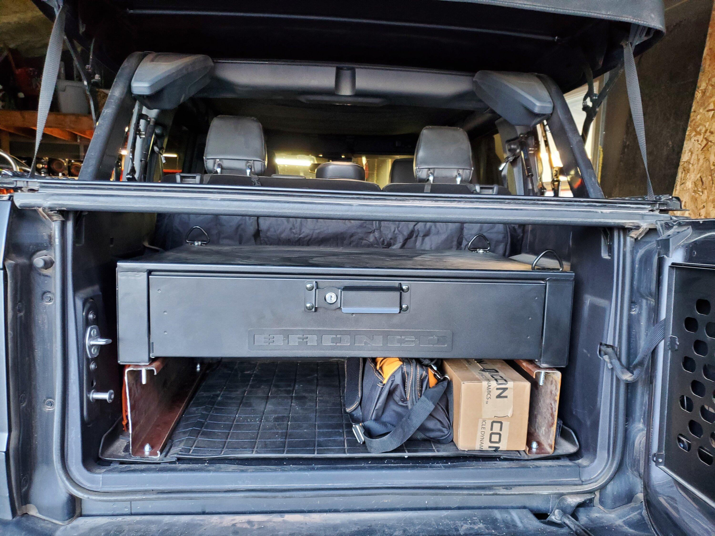

I wanted to raise my Tuffy storage drawer but the kit they sell only raises it 3" and it over $200 so I decided to go to the local MetalMart and see what I could find that might work. I found an 8 foot piece of 8" c perlin and decided to give it a try. I cut and drilled it and used grommets between the drawer and perlin so it wouldn't be metal on metal at the bolts. I also used pins to attach the drawer instead of bolts so it's easy to change up (i'll probably switch to bolts once I get it how I want it and paint it but this makes it easier to modify in the meantime). The height is just right to fit my tool bag and spare tie rods underneath with plenty of room for other stuff and it only cost $60 for everything.
