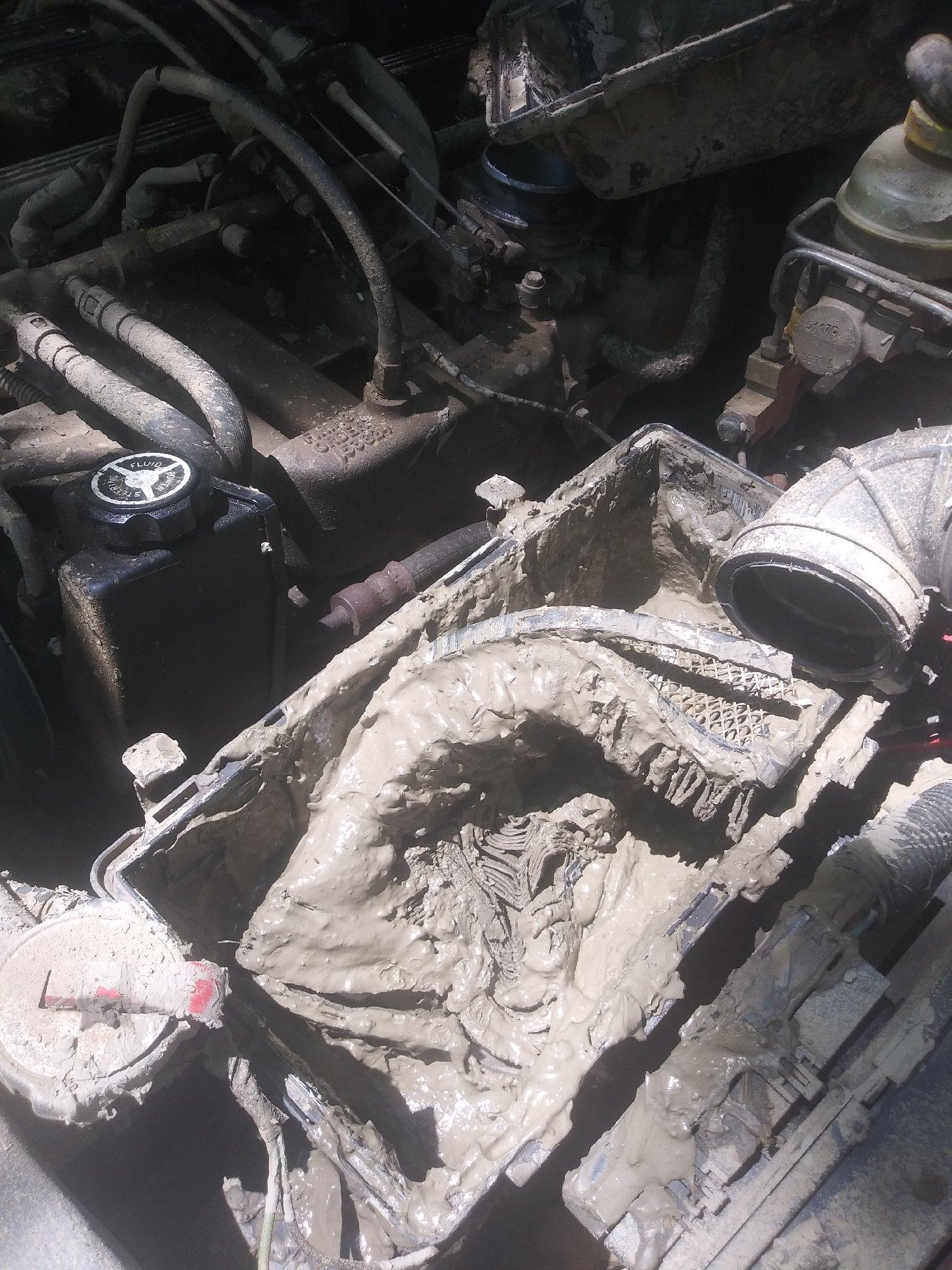

I have some experience w/hydrolock, and basically the way it works is this...as soon as the engine draws enough water to hit the spark plugs it shuts off instantly...at that point the engine is likely undamaged. The damage happens when the driver attempts to restart it. The starter motor on most engines has enough torque to bend a connecting rod, or crush a rod bearing when it forces the piston into a hydrolocked cylinder. If this had happened, you woulda had to pull the spark plugs to get it running again. I have also seen enough water in the oil pan to "wash out" the bearings, but changing it shoulda saved it. It sounds like the second scenario is what you describe. Here's a pick of an old 4.0L filter that got hydrolocked on a trail. We DID get this engine running again, and the driver never touched the key after it stalled. Drove it several more years after this incident!

NOW THAT'S HYDROLOCKED!

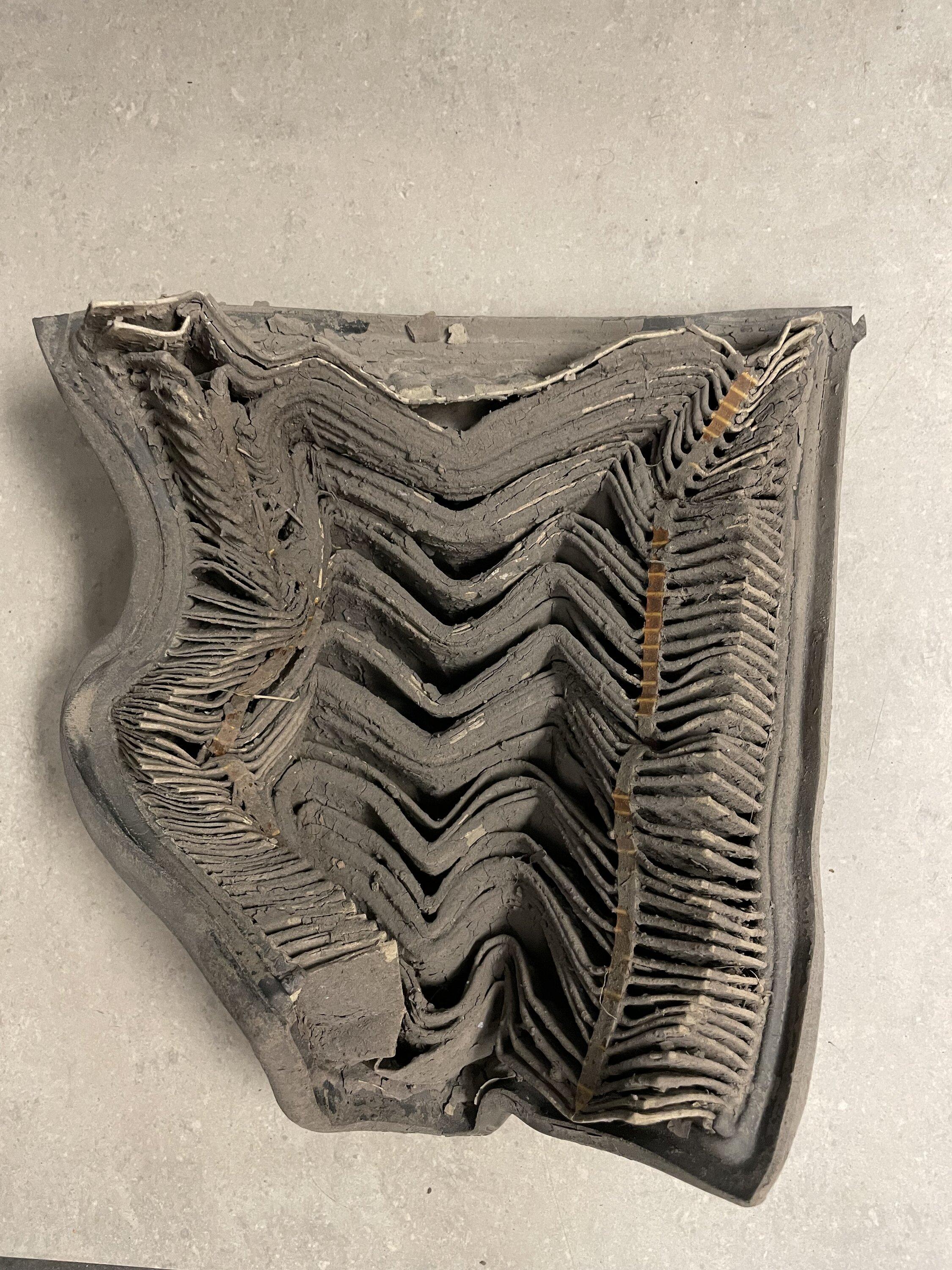

Yep, I’ve seen a couple of engines suck up stuff they shouldn’t too. Anyway, how over full was the crankcase? A little or a lot?

I believe you...looking at the picture you posted NFW that thing was hydrolocked, unless a charge pipe was loose or busted etc, which then why didn't the dealership send you a pic of that? You never mentioned which engine 2.3 or 2.7?
I've got a few pictures. Not sure what a charge pipe looks like. I'll look into it. 2.3

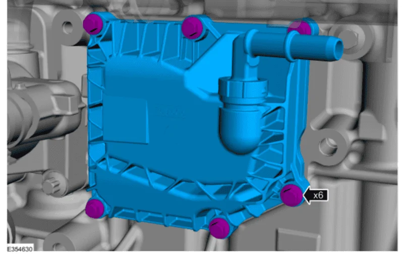

The oil separator/pcv is on the dr side of the block on a 2.3...kinda low really. That would be my prime suspect I guess.
