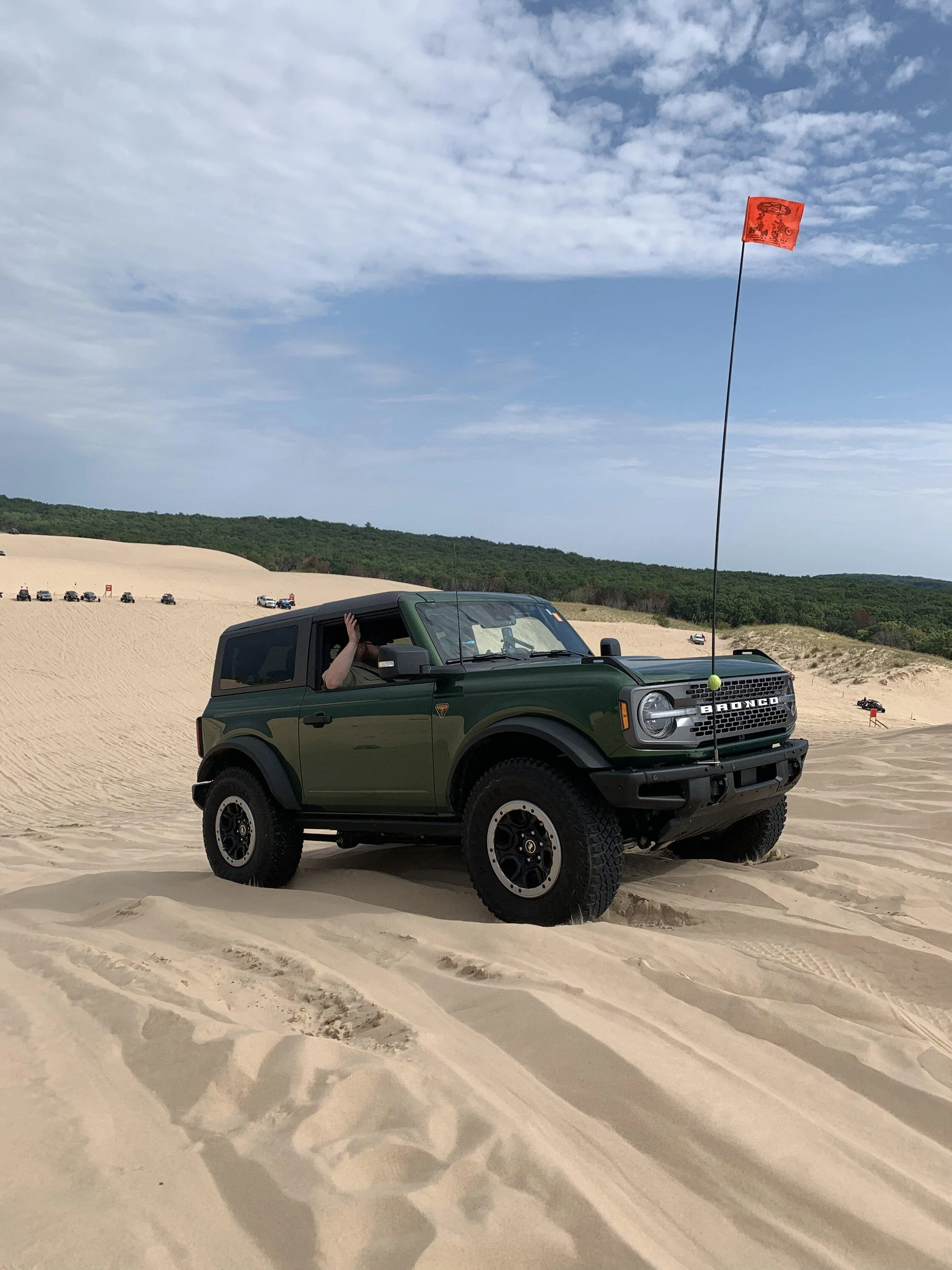

Took Vega out to Silver Lake Sand Dunes in Michigan as a warm up for a week long trip at the end of the month. She did amazing and the Pre-runners there really got me drooling. My goal for Vega is dunes, trail riding and maybe at some point rock crawling. She's also my summer daily driver.

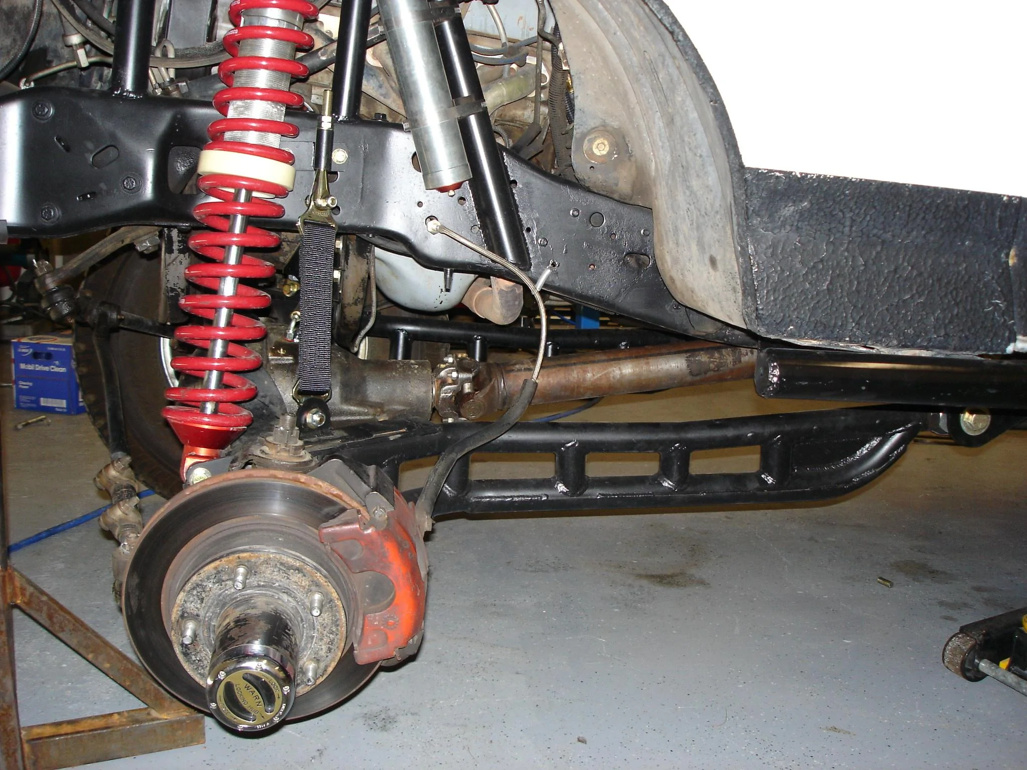

I agree that the Sasquatch package can do most of what is specified. If you want to upgrade start looking at replacement coilover kits. I don’t think it’s necessary to go wider than stock to get decent performance. My 87 Bronco was stock width with 16” of travel and worked great with the suspension I built from scratch.

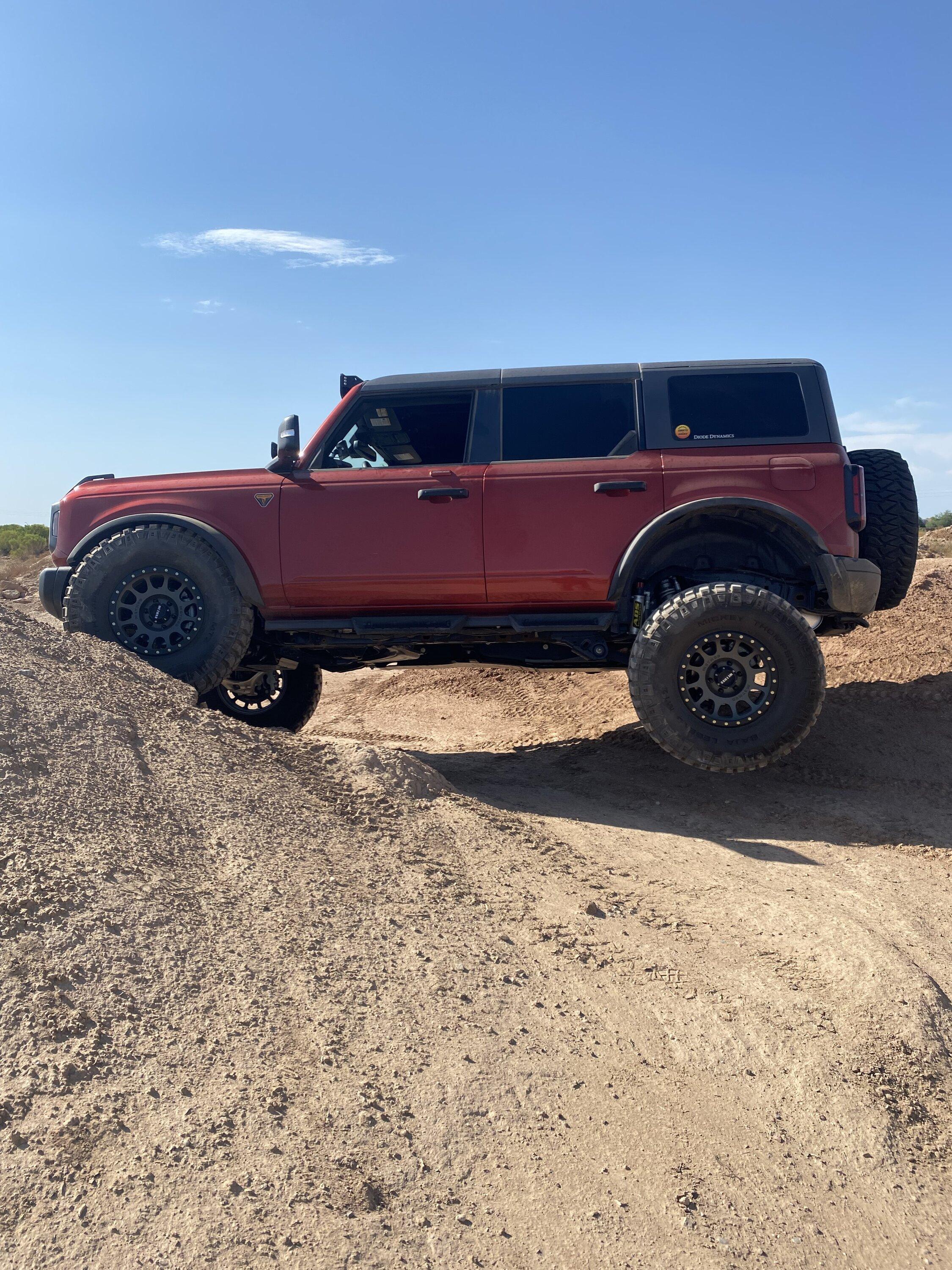

Shifts And Grins Fab
Base Sponsor (Level 1)
Ryan
Feb 8, 2023
259
474
Gilbert AZ
shiftsandgrinsfabrication.com
2023 Badlands, 2022 Bronco Wildtrak Sas

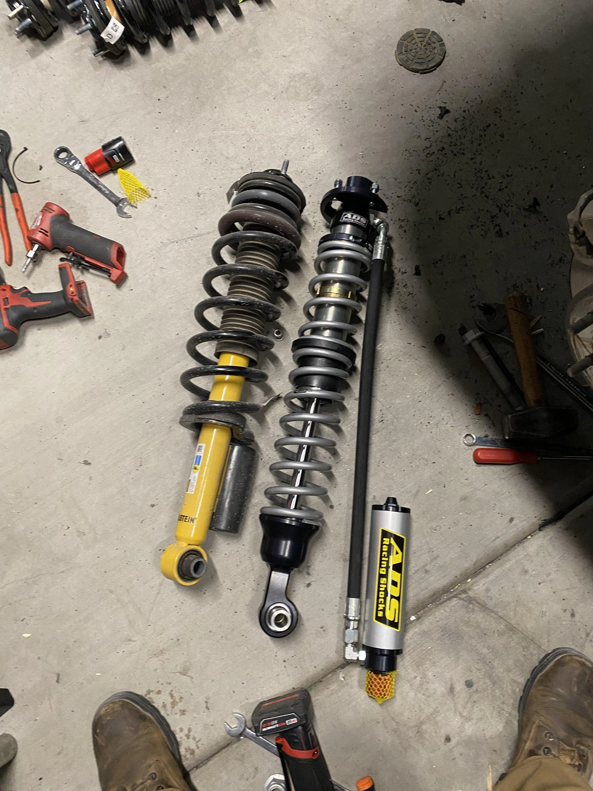

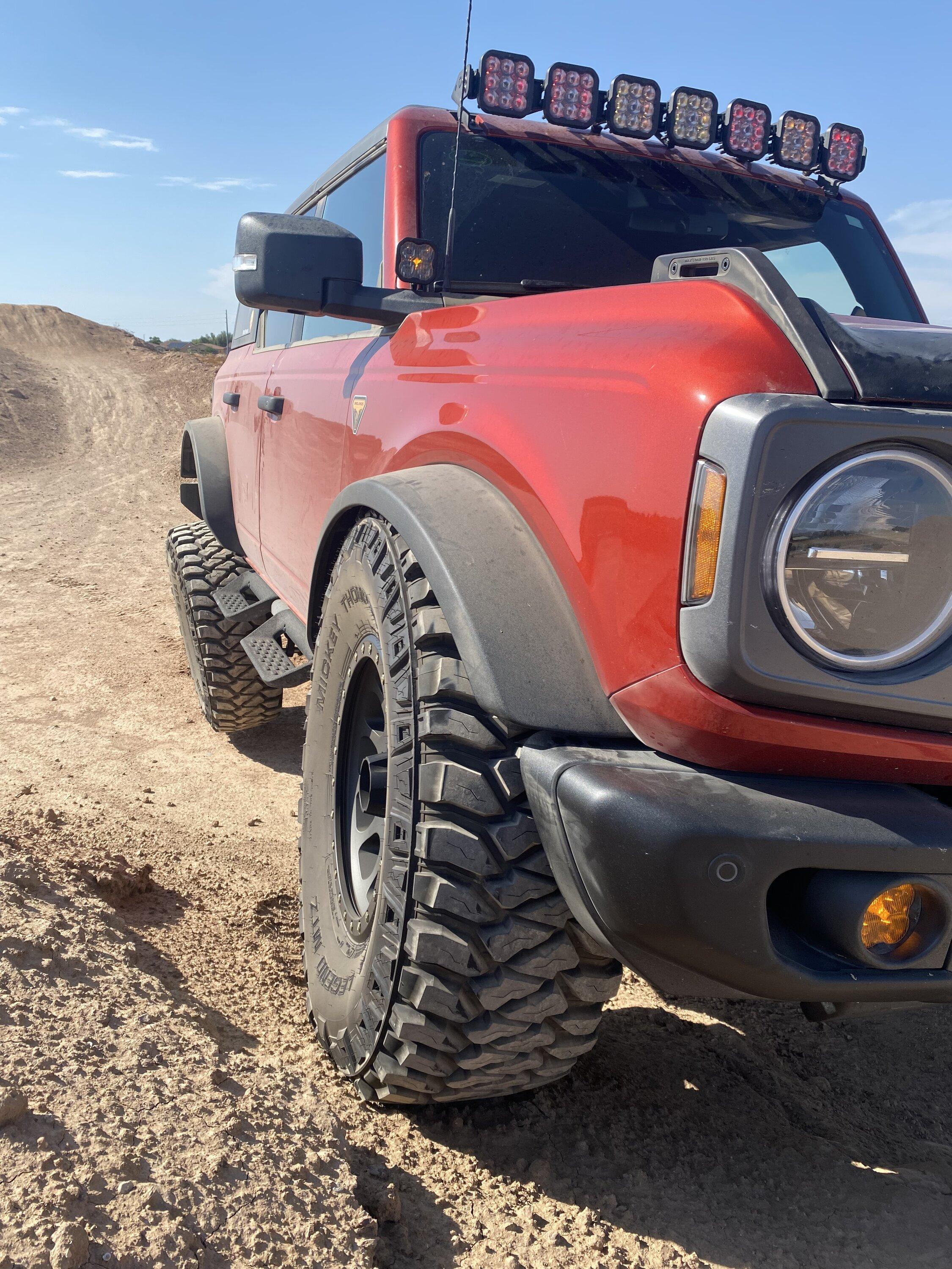

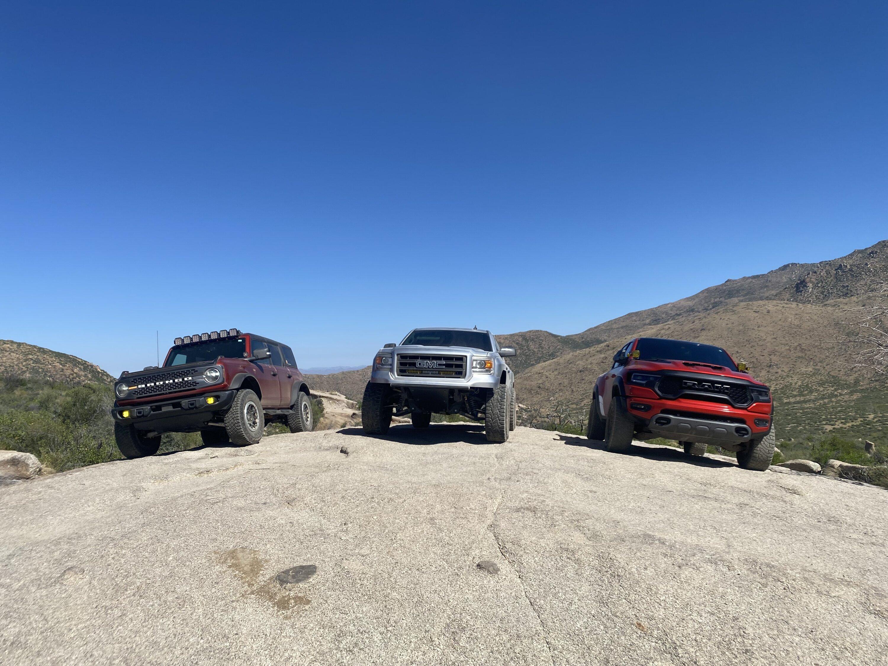

We'd love to help you out. We run and sell ADS (Arizona Desert Shocks). They are awesome and the best out of the box factory replacement kit I have seen. They run dual rate rear springs, have separate part numbers for 2 and four door and we consult with you to see if we need to make any changes prior to shipping your kit. We run with a TRX and built GMC prerunner and always amaze them with the performance of the Bronco with the ADS kit on it. As mentioned before, it is not long travel or a prerunner but does increase travel and performance on and off road. We've had several customers remove their Fox Hoss 3.0 and replace them with ADS and have received great feedback. Some of those customers are on here and may chime in.
Ford Bronco How do you decide on what Suspension? IMG_5034 (1)
Ford Bronco How do you decide on what Suspension? IMG_5562 (1)
Ford Bronco How do you decide on what Suspension? IMG_5575 (1)
Ford Bronco How do you decide on what Suspension? IMG_5298
