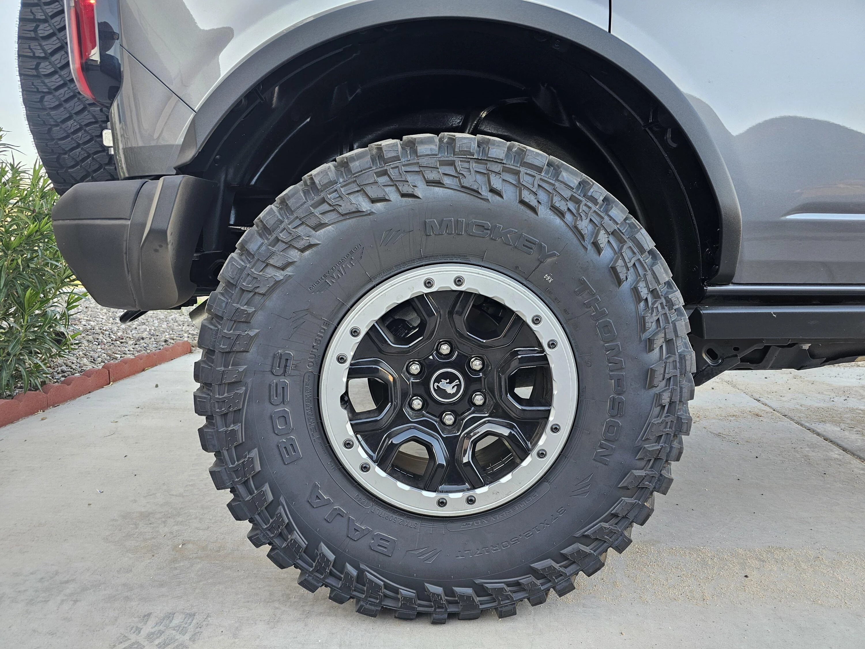

Bronco Badlands w/ sasquatch pkg - Carbonized Grey
On my 2023 badlands w/Squatch my setup is:
Fabtech 3" Coil over lift with resi
37" Mickey Thompson Bajas
OEM Bronco wheels
The tires clear everything except the upper control arm at full hard turn. I believe the OEM wheels are a "zero" offset, how much + offset do I need to looking for?

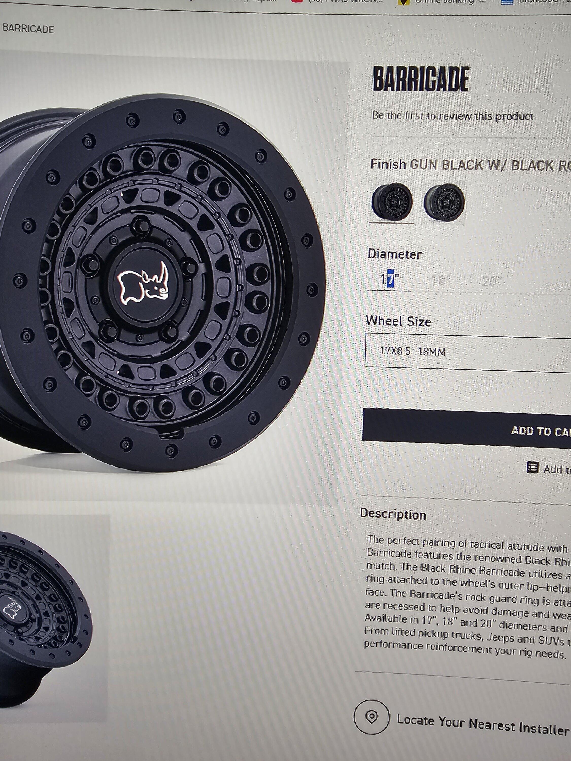

I was considering some Black Rhino wheels with a -18mm offset...would this work?
Ford Bronco I need some offset - how much? 20230802_204346
Not ideal for offroad (almost 2" of poke with additional fender clearance issues when turning). Fox/BDS/Zone recommends +6 to +12 with their lift/UCA (same as 0.75" spacer with the OEM +30 wheels). +0 wheels work well with frame/fender modification(JKS kit).

What Iam seeing with an offset calculator is I would gain 6mm from the strut and 18 mm in pike.
That's less than 1 inch of "poke" which would be fine if that's correct.
-18 8.5" is 48mm difference from OEM. IFS angles are a smaller factor.
JKS kit recommends 4.5-5.5" backspace for 37x12.50, which is -6 to +19 for 8.5" wheel. I would stay in that range if you want to be able to turn lock-to-lock with wheel tucked (+6 to +12 8.5" if not using JKS).

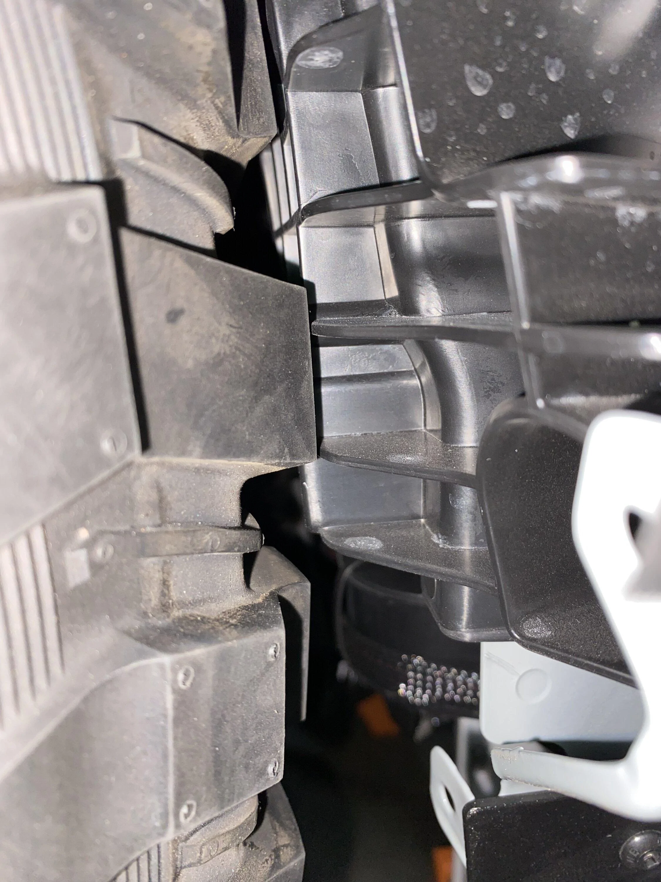

This is with +0 8.5" wheel and 37's (no clearance). Wheel tucked and turned (fender liner removed). The JKS kit eliminates this inner fender plastic part to improve clearance enough for +0 wheels. -18 will be worse (no easy fix).

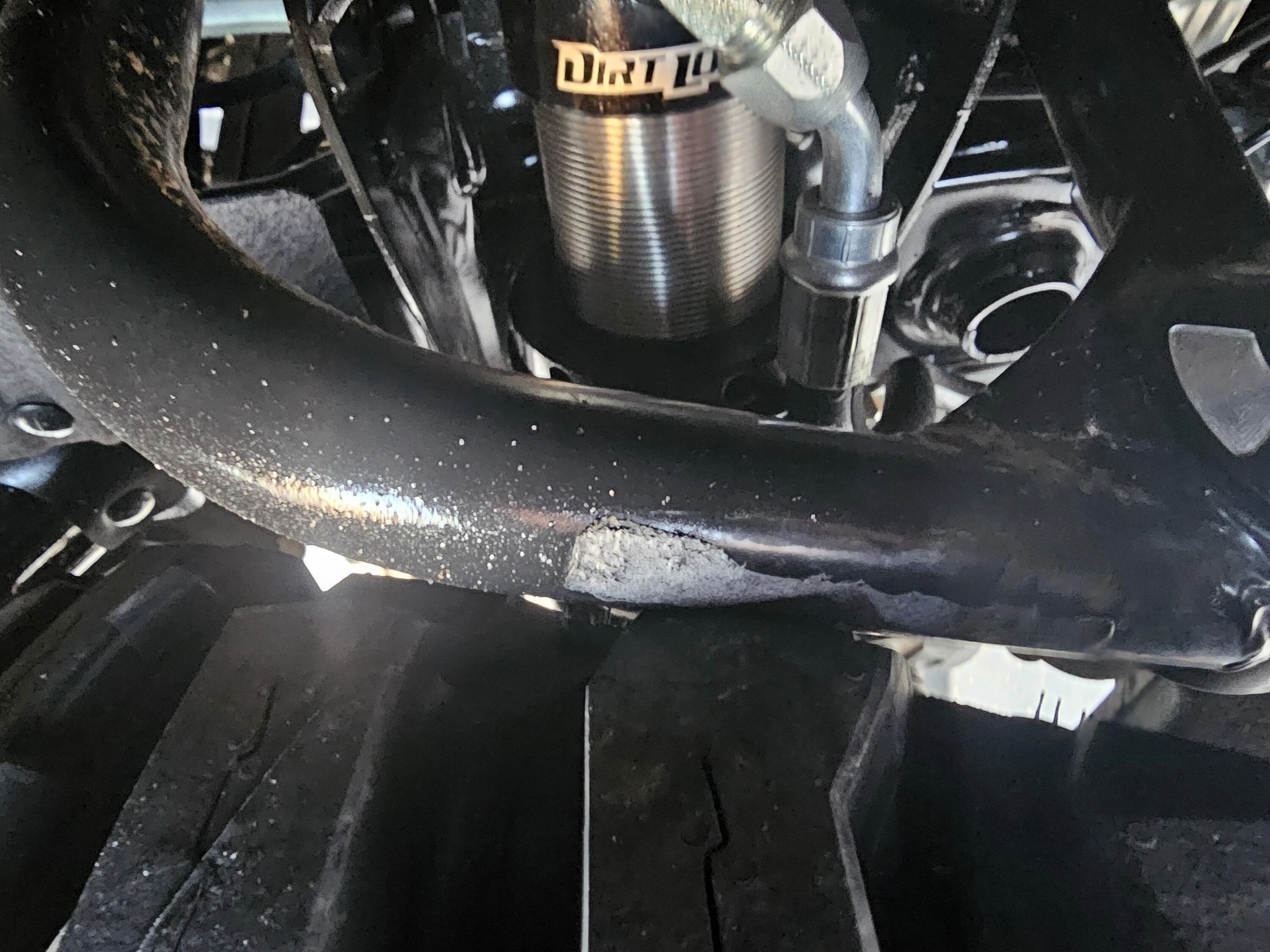

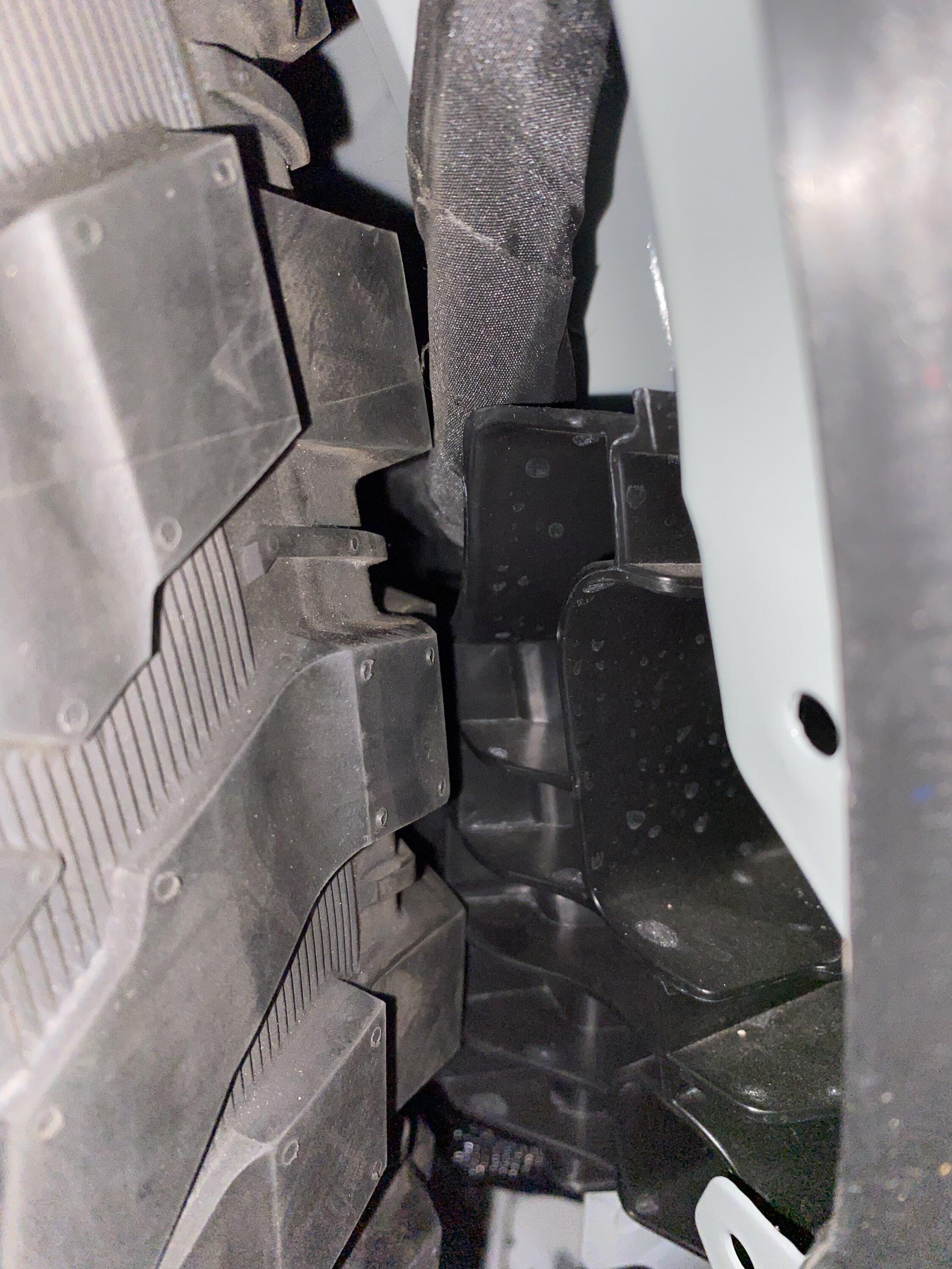

I onlybrub in one spot turn to turn. Iam clearing the crash bar and fender liners on the front. The top edge of the tire rubs the upper control arm on full turn. The rear tires will have to be flexed and stuffed to see what's rubbing.
Front,.... that rub mark is actually the adhesive from the FabTech sticker.

The rear....
Ford Bronco I need some offset - how much? 20230803_063832
