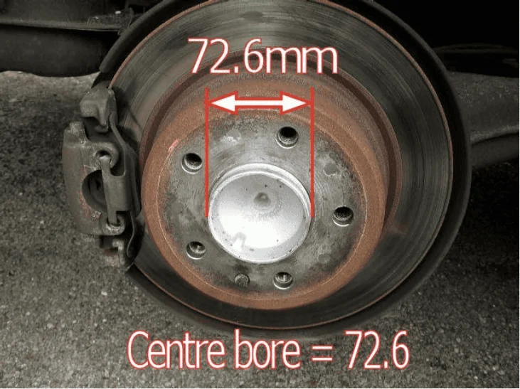

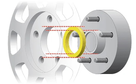

It is the center bore of the wheel to match the hub mounting flange on the vehicle. It helps get the wheel perfectly centered on the hub. The lug nuts then take over the centering responsibilities as you tighten them.
As I recall, the Bronco and Ranger are 93.1mm.
You can use wheels that are bored larger than your hub by using spacers, but you CANNOT use wheels that are bored smaller than your hub without modifying/machining them out.

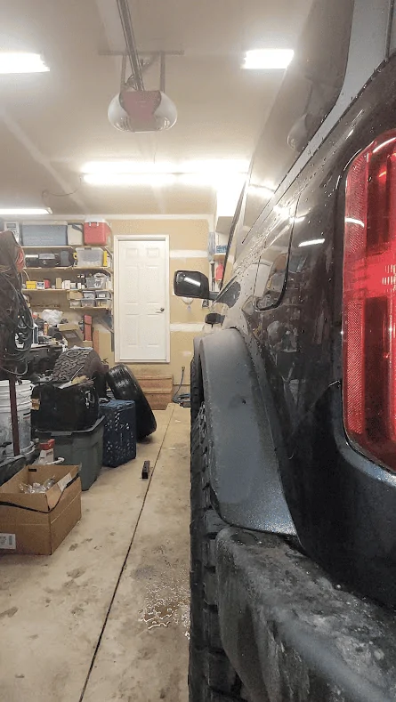

Here's a pic of the flange.

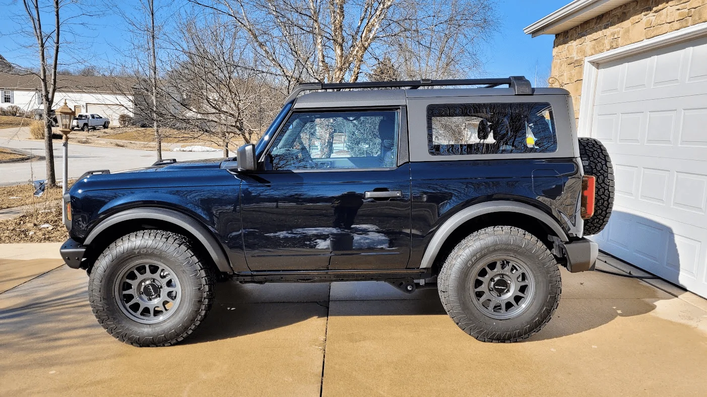

Method 703
17 x 8.5 +35mm
hub bore 106.25mm
Toyo 35 x 11.5 - 17
base Base, no lift
Ford Bronco Wheel offset - new at this really need some guidance 1678849706262
Ford Bronco Wheel offset - new at this really need some guidance 1678849742785
Ford Bronco Wheel offset - new at this really need some guidance 1678849870264
Ford Bronco Wheel offset - new at this really need some guidance 1678849837318

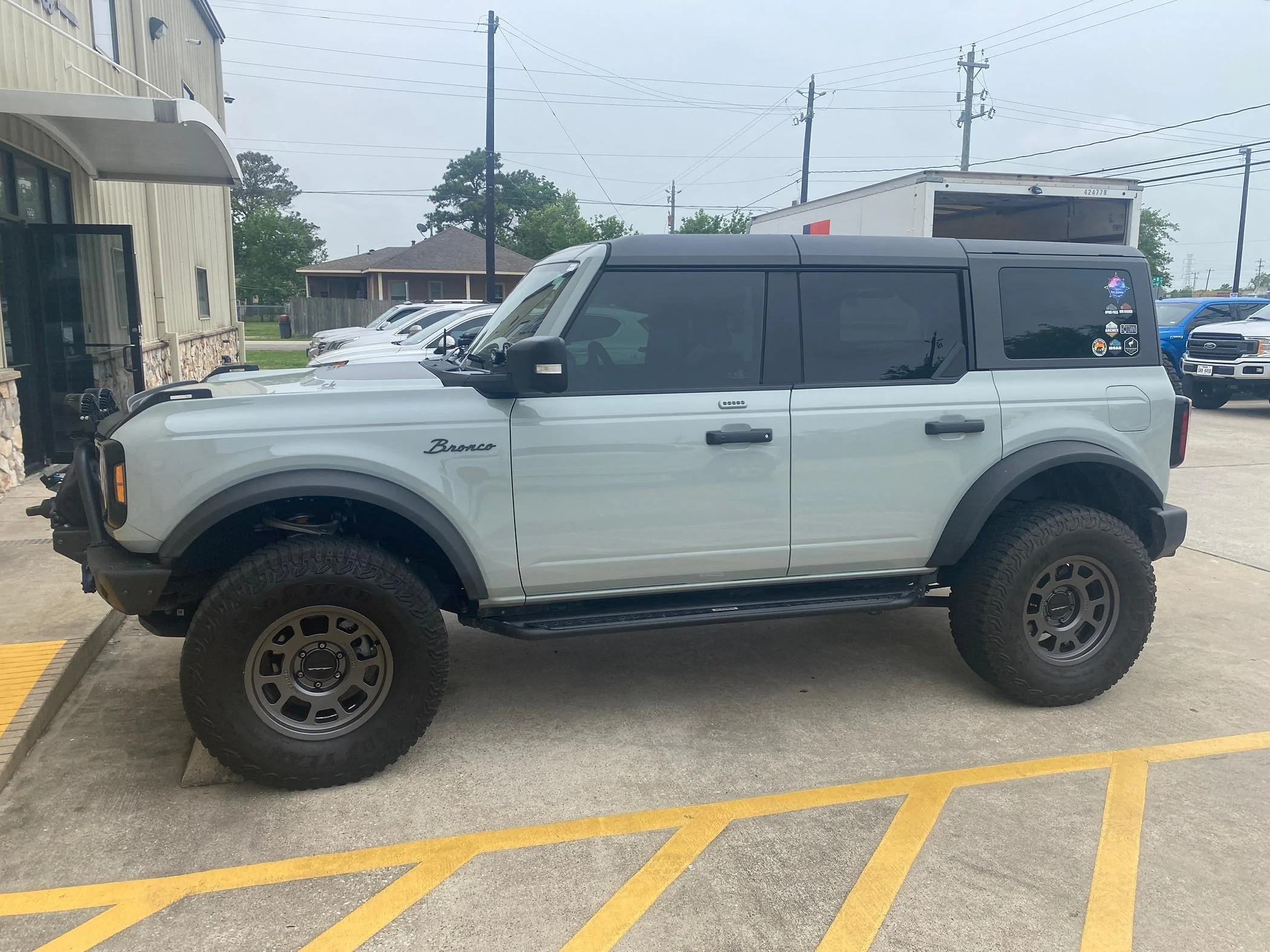

Looks great! I went with Method 705's in Titanium with 0 offset on the original tires after installing the Eibach Pro Truck 2.0 Coilovers. I'm only up about 1.5" from standard Sasquatch but it gave me the height, the ride, and look I was after! The 0 offset creates a poke out from the Wildtrak fender flares of only about 1/2".

Nice , great stance. Give those tires some room to flex.
I'd like to do the Ford Performance Bilstein's for about a 2" hike. I'm looking a bit stuffed on the standard suspension.
