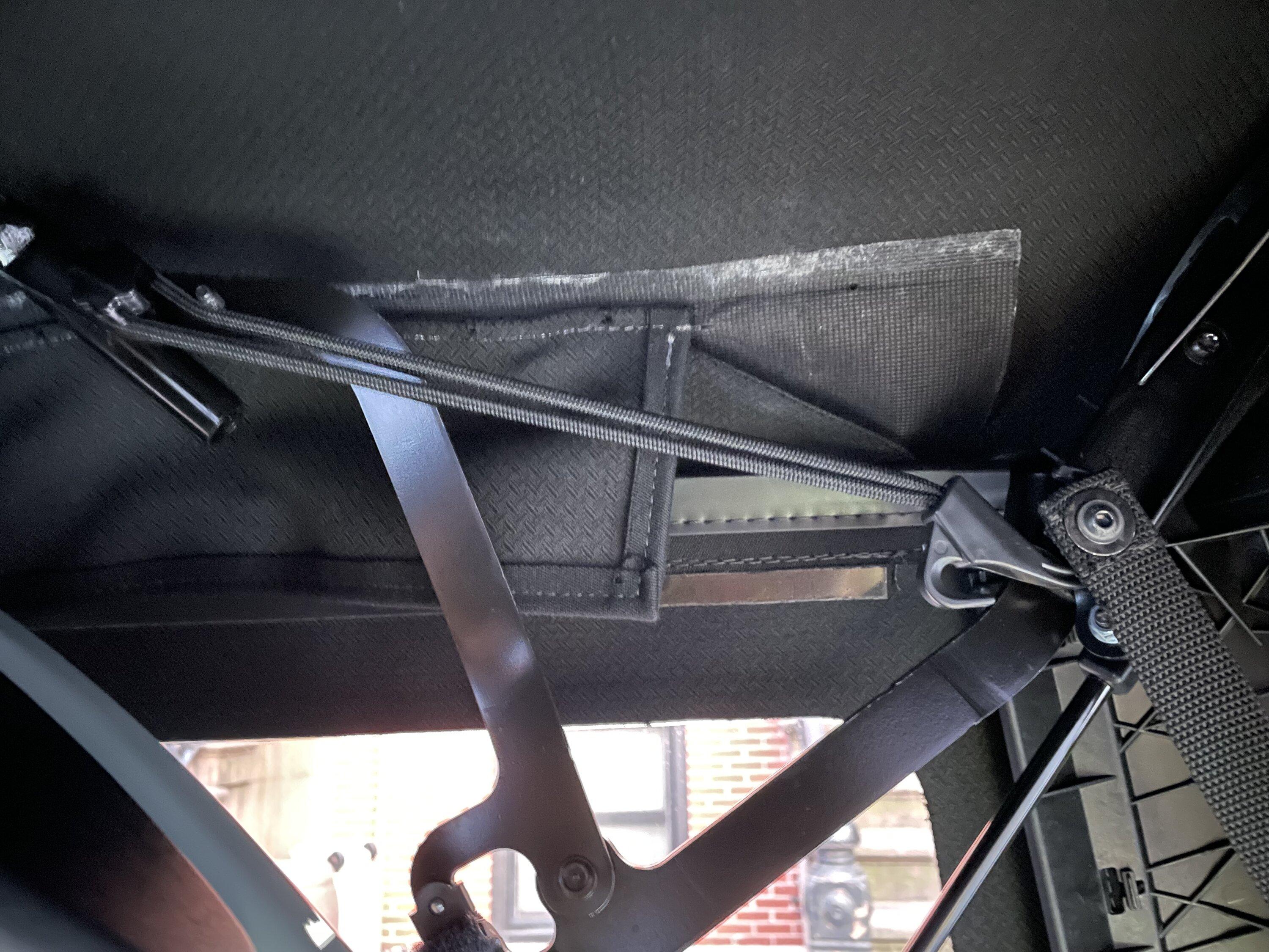

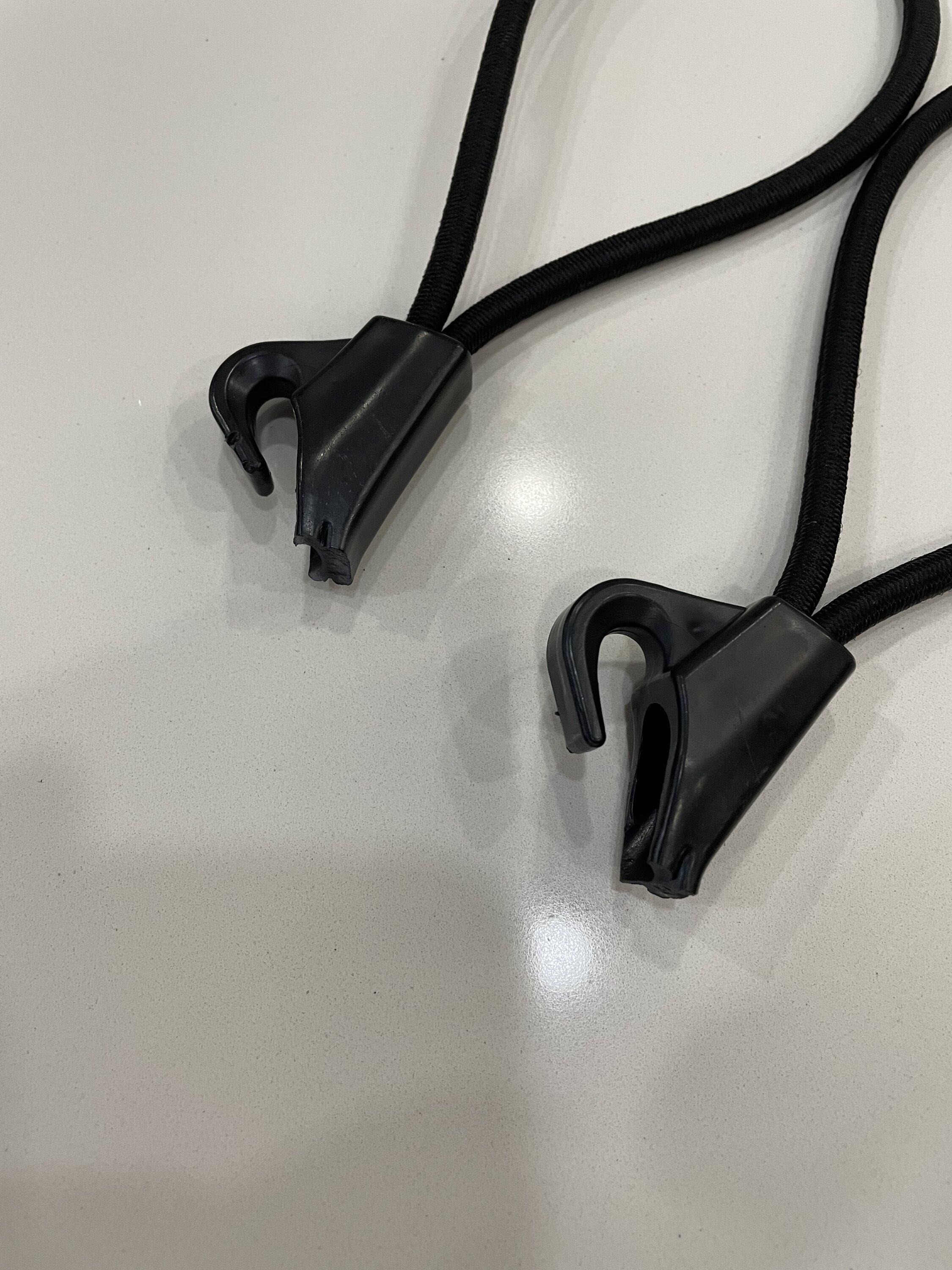

Regarding the EZ Lift Soft Top Assist (order # 71327)....
Both of the bungee tensioners broke apart (see photo) with the first use. I believe these were installed properly. Not sure why both failed.
I have received the replacement (thank you) but want to confirm they are in correctly. Can you let me know please.....
Thanks so much
Thanks so much
They look roughly correctly installed but move the bungie cord above the exposed stud near the plastic knob.
