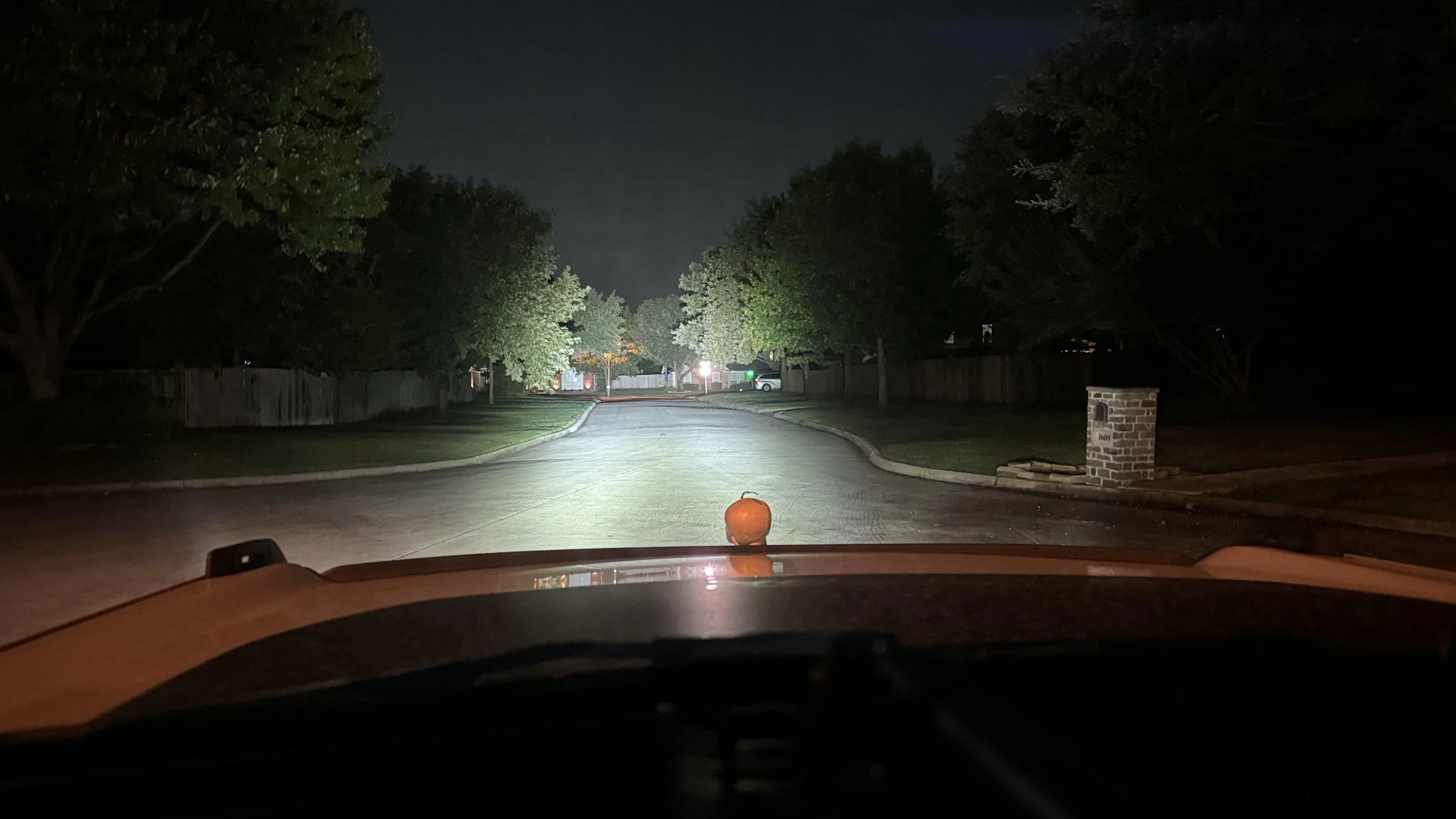

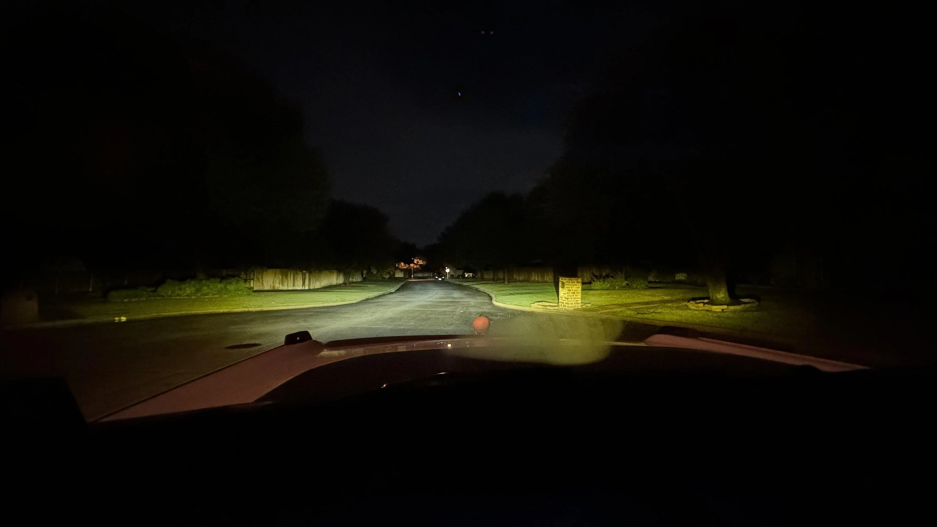

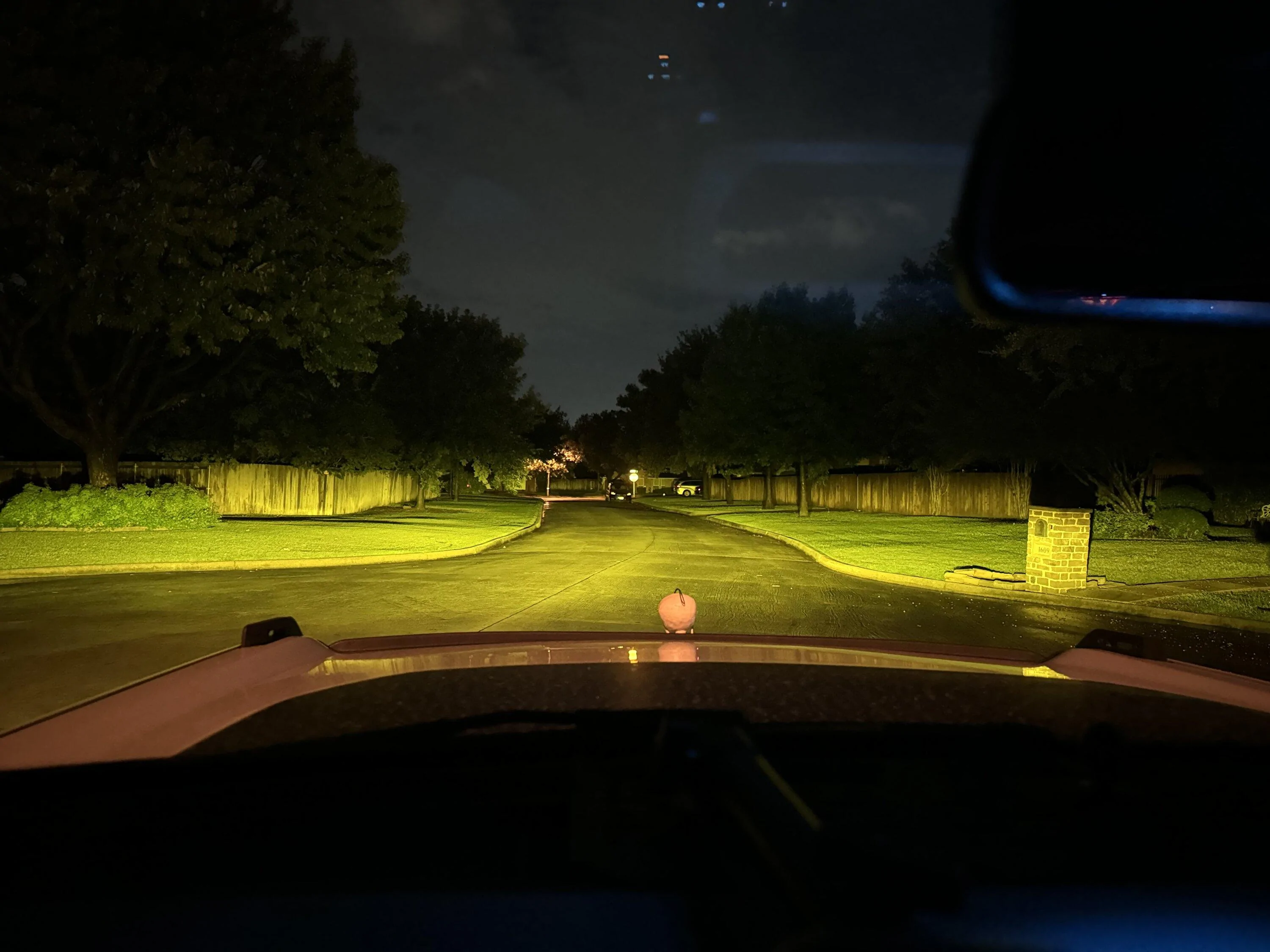

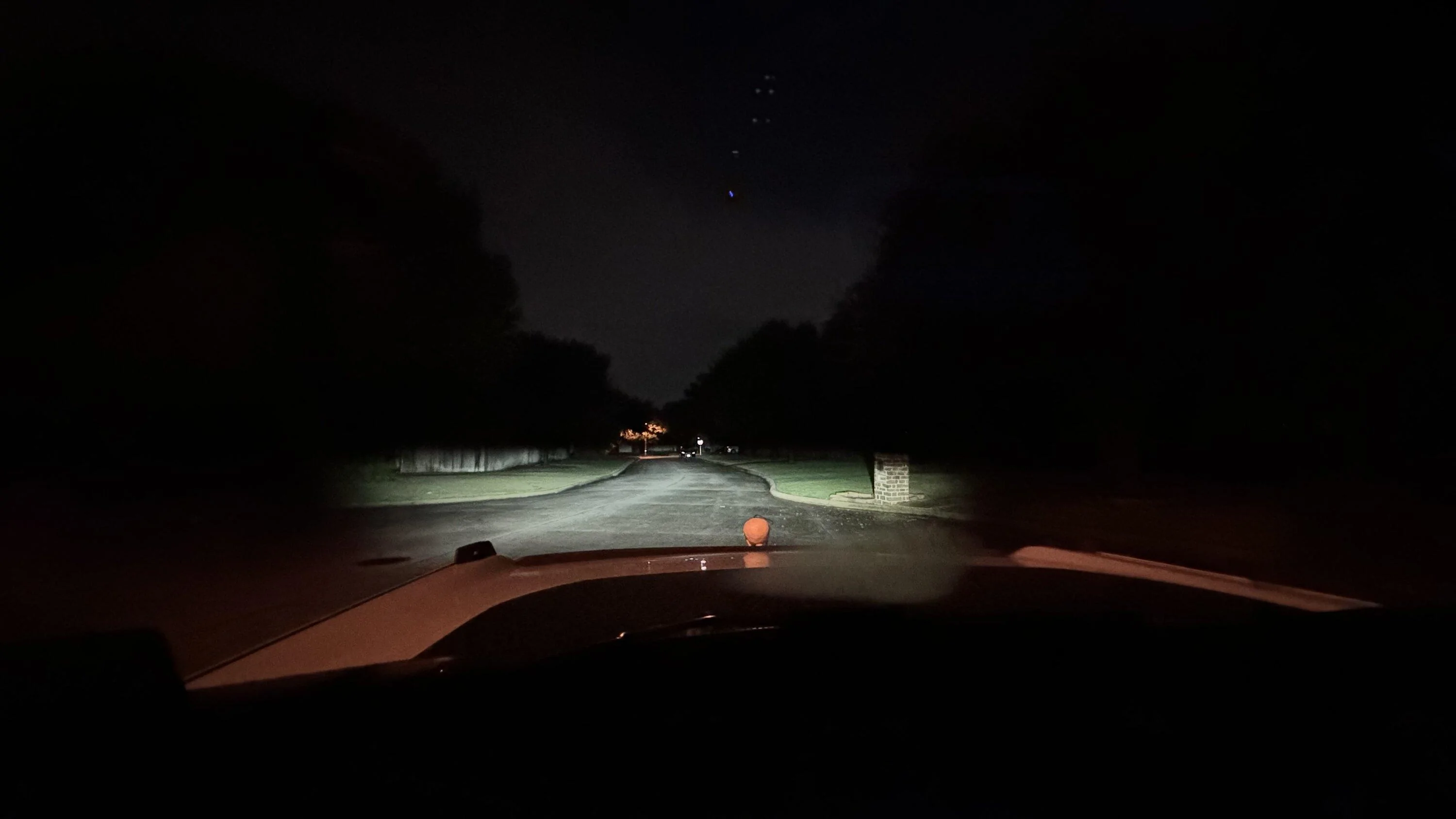

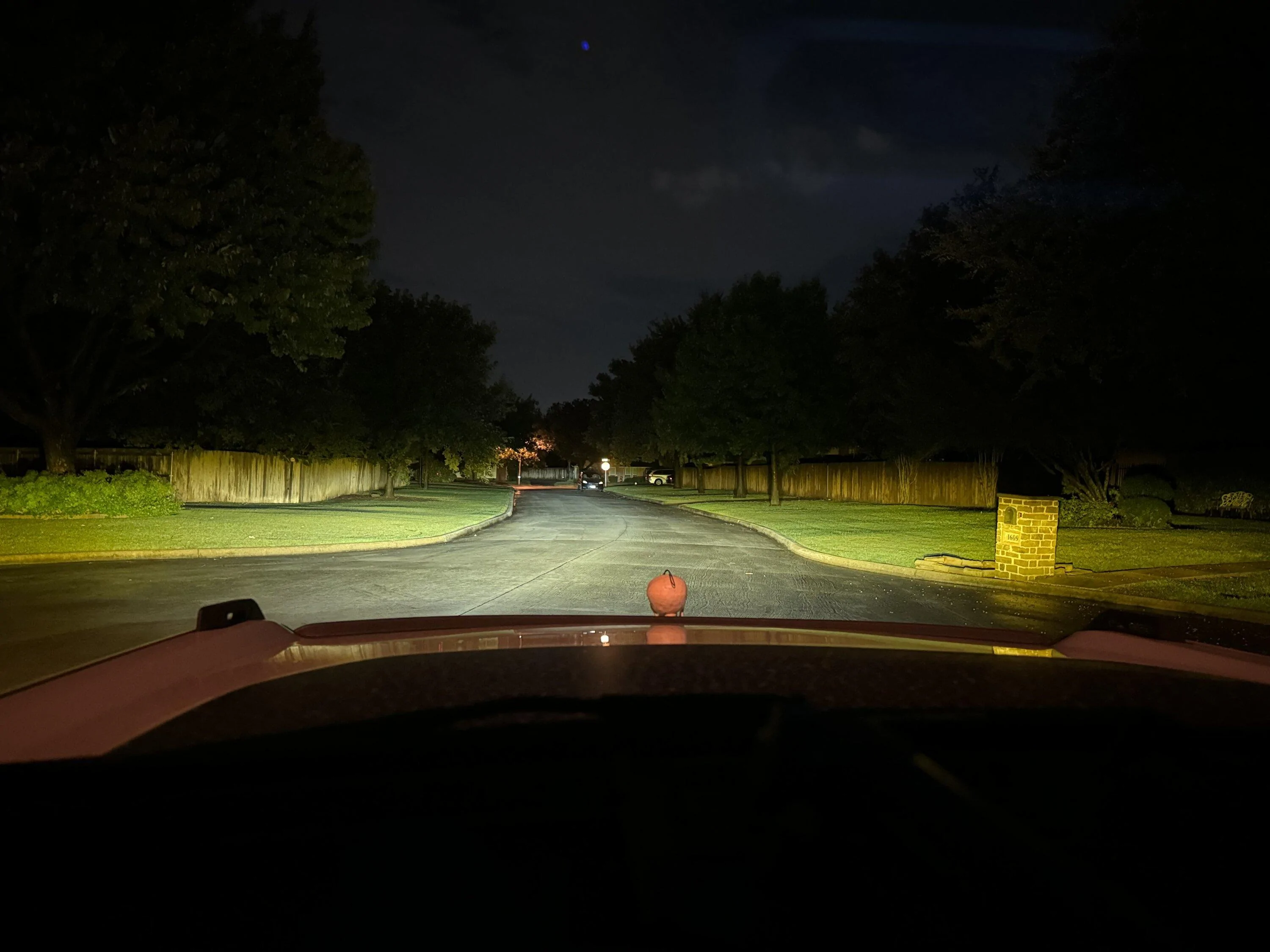

You don’t happen to have a shot of low beams only vs lows and one pair of fogs do you?

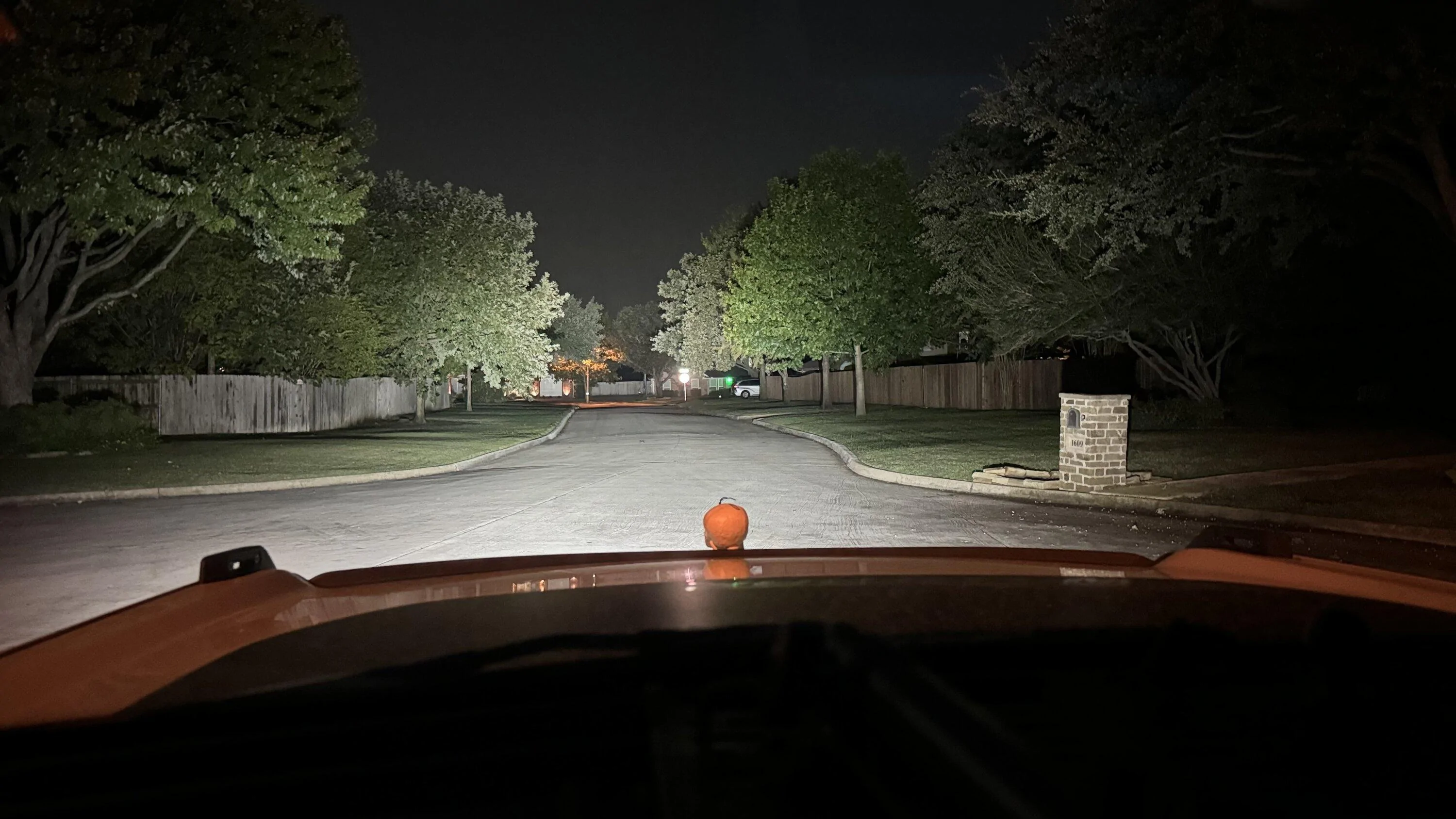

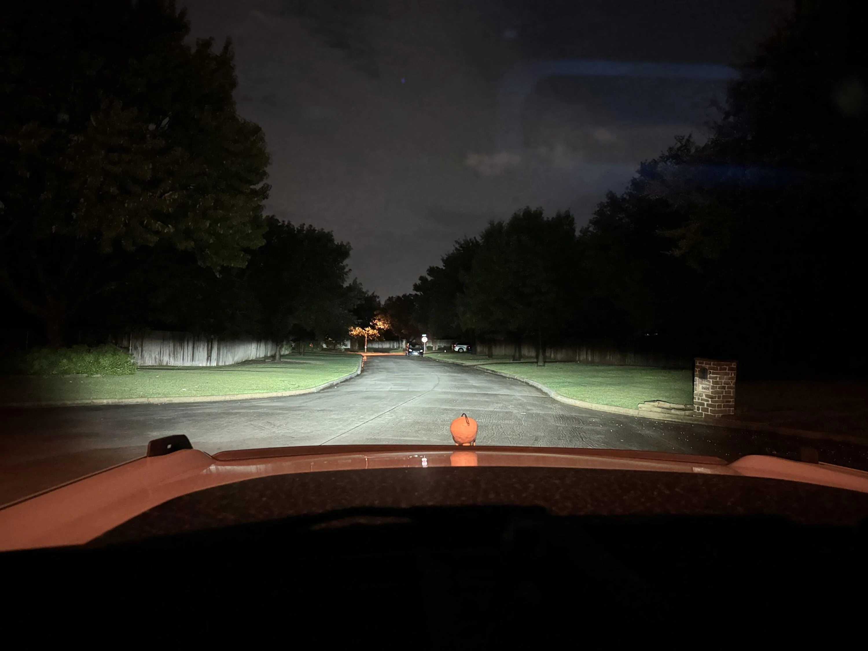

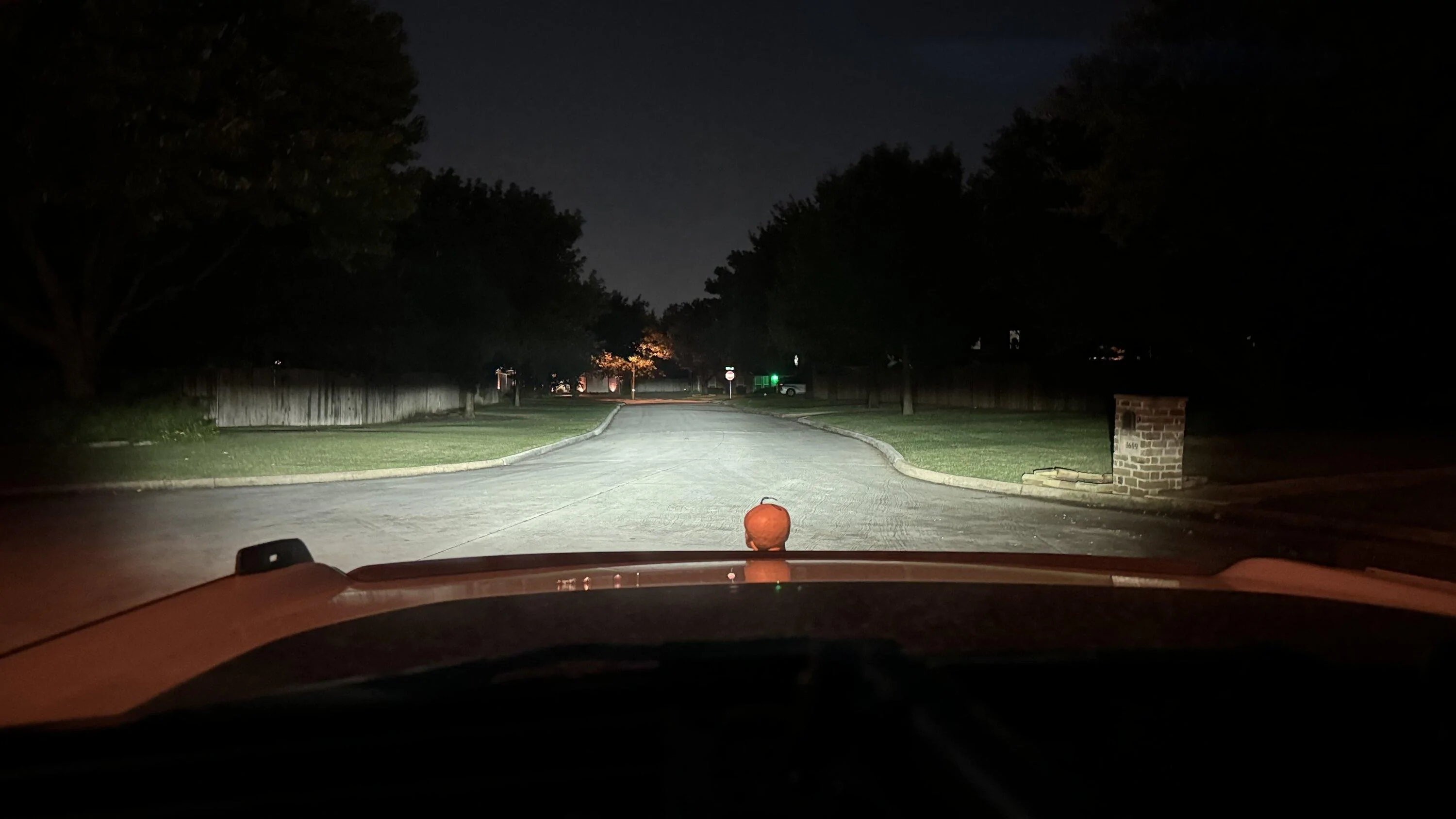

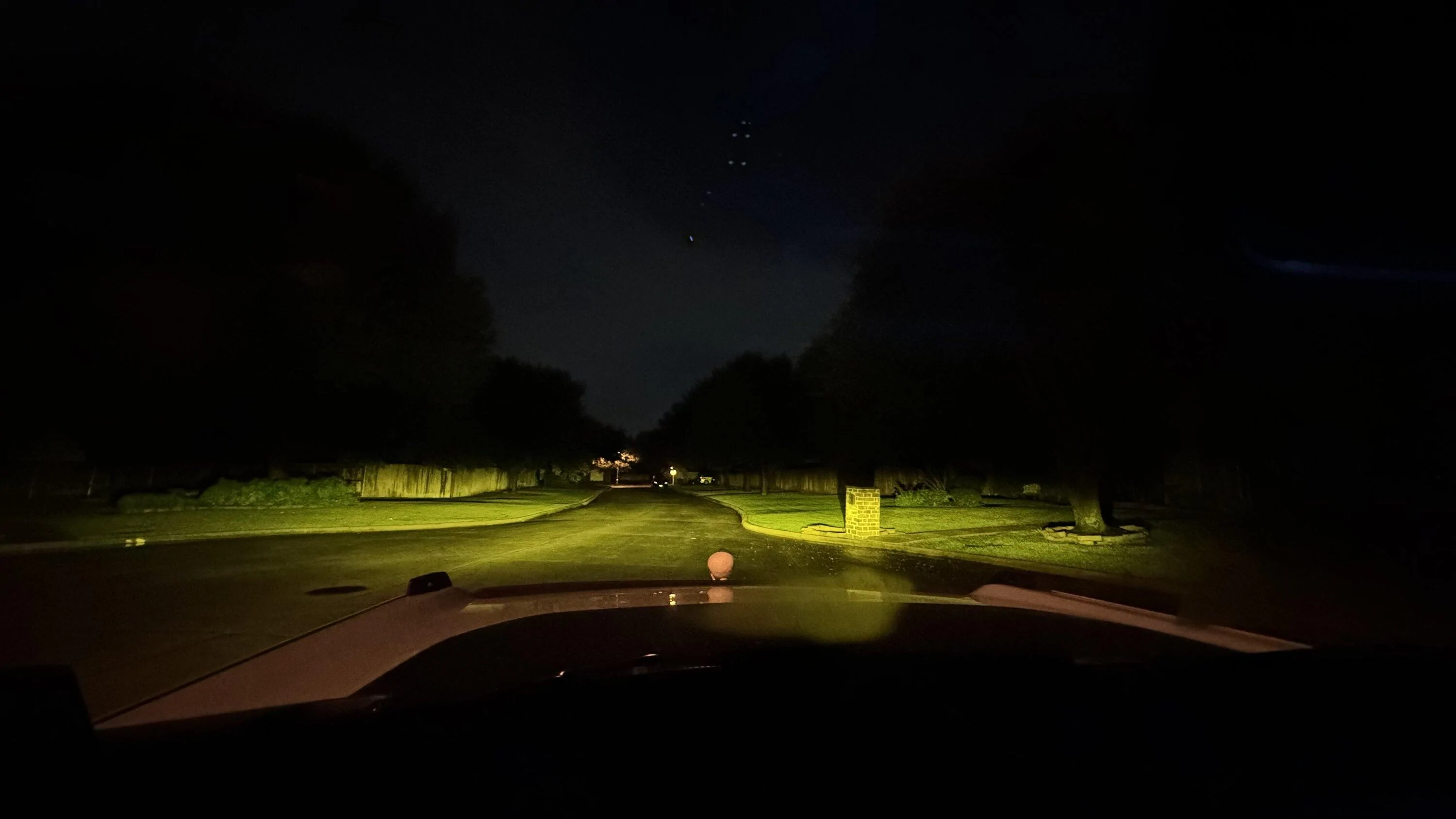

Got a new iPhone 15 Pro, didn’t realize night mode was making the lights seem brighter in the pic than normal. Took some pics with night mode disabled in 4:3 and 16:9. They also seemed brighter in the pic in 4:3. 16:9 looked more true to life. Don’t mind my skelly head at the hood line. 💀
4:3
Max fog only:
Ford Bronco Improving low beams with fogs? IMG_7306
Low beam only
Ford Bronco Improving low beams with fogs? IMG_7307
Both:
Ford Bronco Improving low beams with fogs? IMG_7308
16:9
Max Fog only
Ford Bronco Improving low beams with fogs? IMG_7309
Low beam only
Ford Bronco Improving low beams with fogs? IMG_7310
Both
Ford Bronco Improving low beams with fogs? IMG_7311

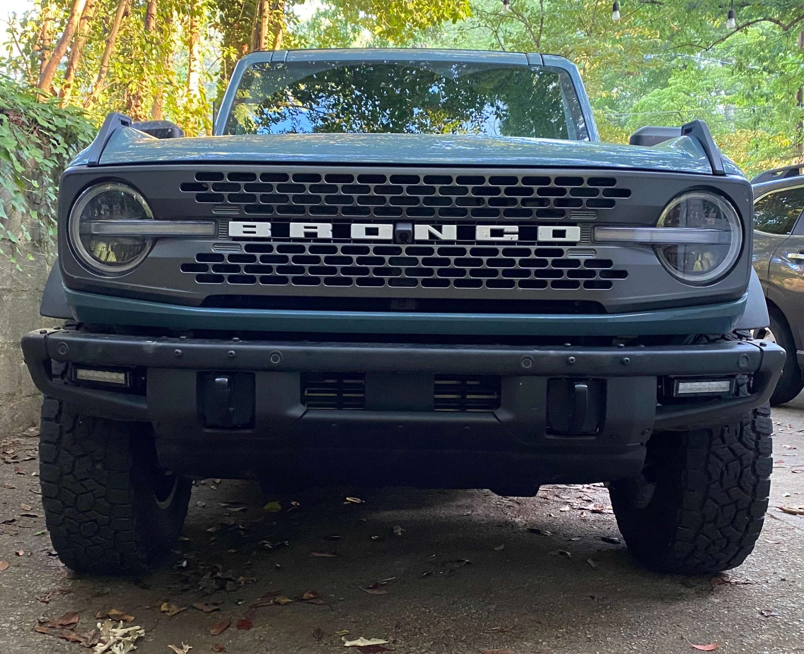

I run SS6 SAE fogs in a mod bumper. They are slightly aimed out to fix the terrible lack of spillover. I love them and have them aimed properly for on road use.
Ford Bronco Improving low beams with fogs? IMG_9014_Original

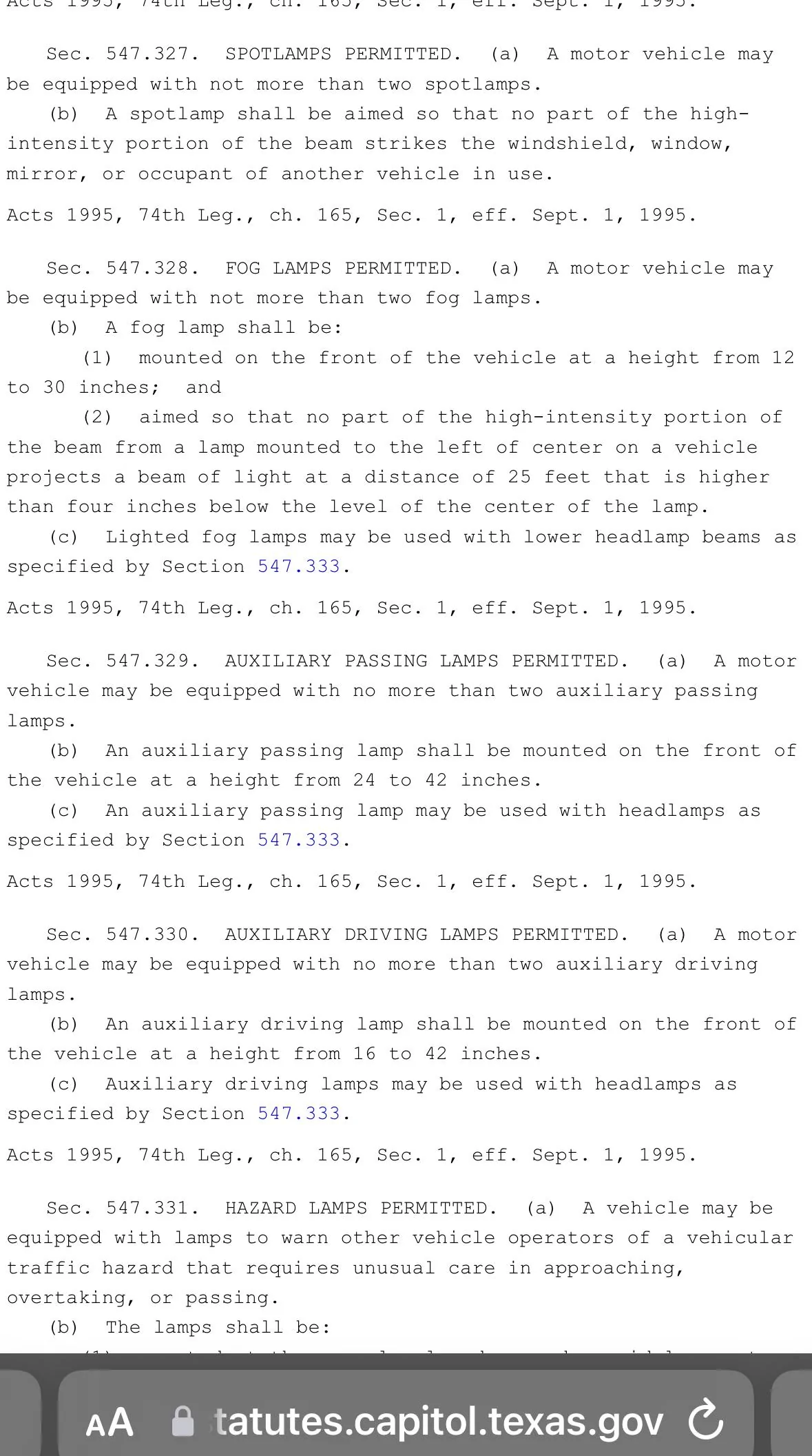

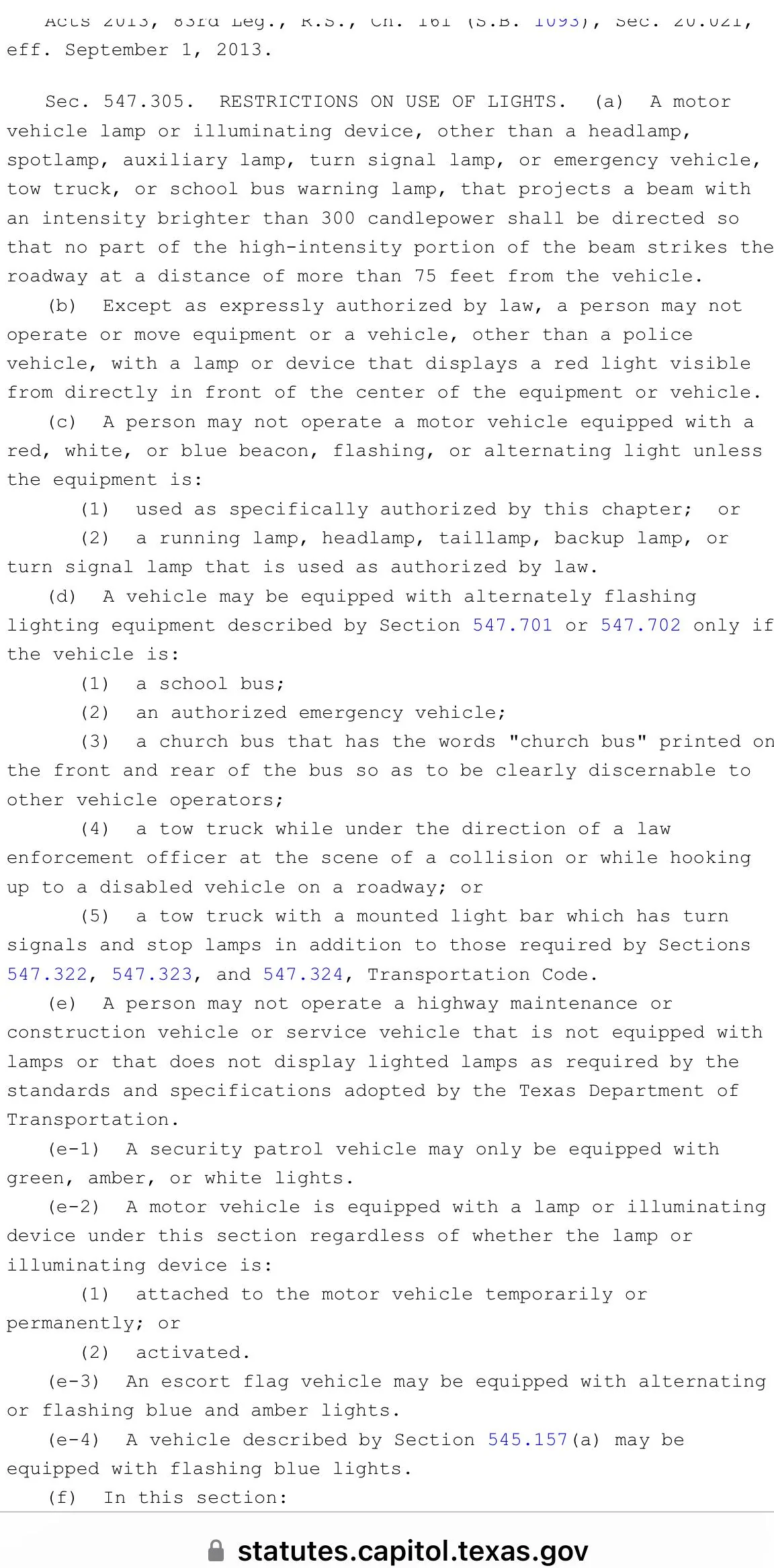

At least in Texas, not quite how it works. They’re not illegal if over 3k lumens, they must just be properly aimed and that’s if over 300 candlepower (3,771
Lumens). Candlepower x12.57 = Lumens. This is also how the Max fog and driving are SAE compliant given the precise cutoff/pattern.
https://statutes.capitol.texas.gov/Docs/TN/htm/TN.547.htm
Every state has a slight variation of what is legal/allowable brightness & color for head lamps, fog lights, etc.. Some more conservative than others. Before adding any lights I would double check with the state your vehicle is registered in.
Thanks for sharing!
We always love to see Bronco owners branding out from our pods and utilizing our SAE-compliant SS6 LED light bars :cool:
Ford Bronco {thread} {filename}
Many users aren't aware that our Stage Series Light Bars utilize our TIR optics just like our pods!
Did you pick up this kit from @4x4TruckLEDs.com or custom mounted?
4:3
Max fog only:
Low beam only
Both:
16:9
Max Fog only
Low beam only
Both
16:9 does look more true to life. Did you take any more photos of your other lights in 16:9?

Yes, I used @4x4TruckLEDs.com very simple kit.
I am shocked at how few people use this option for what seems like a much more common used case.
