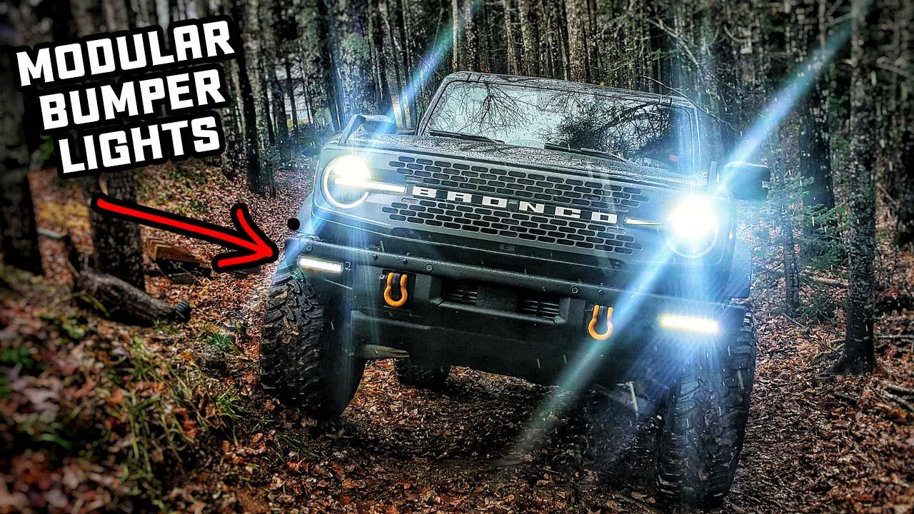

Just posted a video on my 8" Roughcountry light bar install. With a little modifying to the brackets they look great in the modular bumper! Makes for an inexpensive alternative to what's out there now.
Let me know if you like the look!

Only issue is they're not pointing straight ahead... they're angled to the sides. So if you use a SAE or spot pattern, you're not getting light directly in front of you, and you'll have a large "dead zone" front and center.
Would be better utilized with floods, just for area lighting for slow speed off road.

I’d do this immediately if they were SAE fog pattern. :(
So question for everyone..... do you often use your fog lights... as fog lights?

Very nice! I'll need to reference your post when I make custom brackets. Mine point out too much.
Use the bolt on the bottom of the radiator as a mounting point for the inboard bracket for a better focus of light to the center.
Nice! I'll check that out for sure when I mod the brackets! Thanks!
