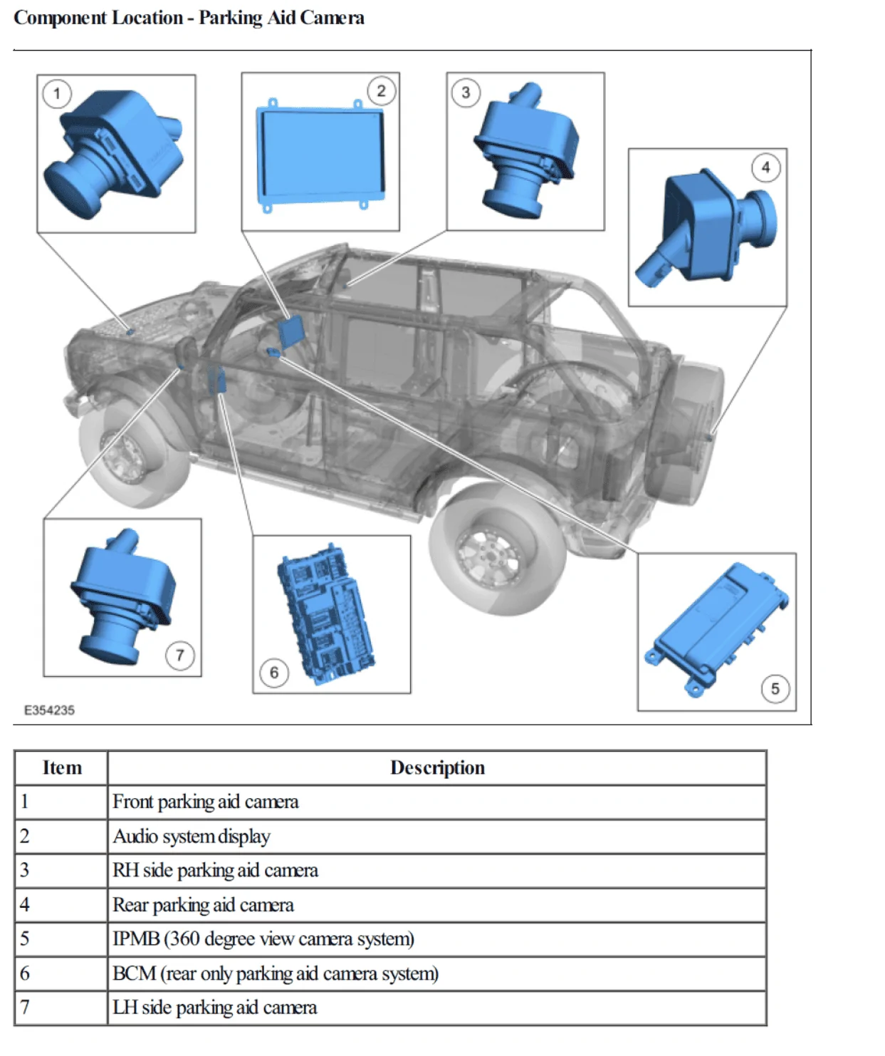

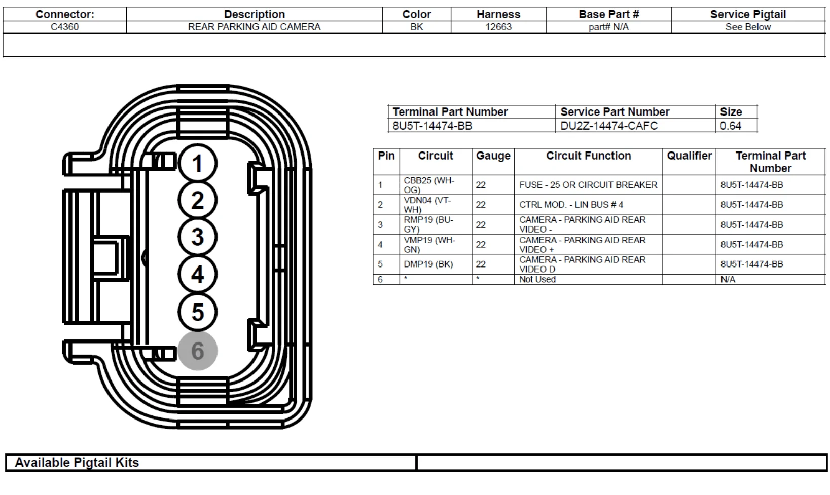

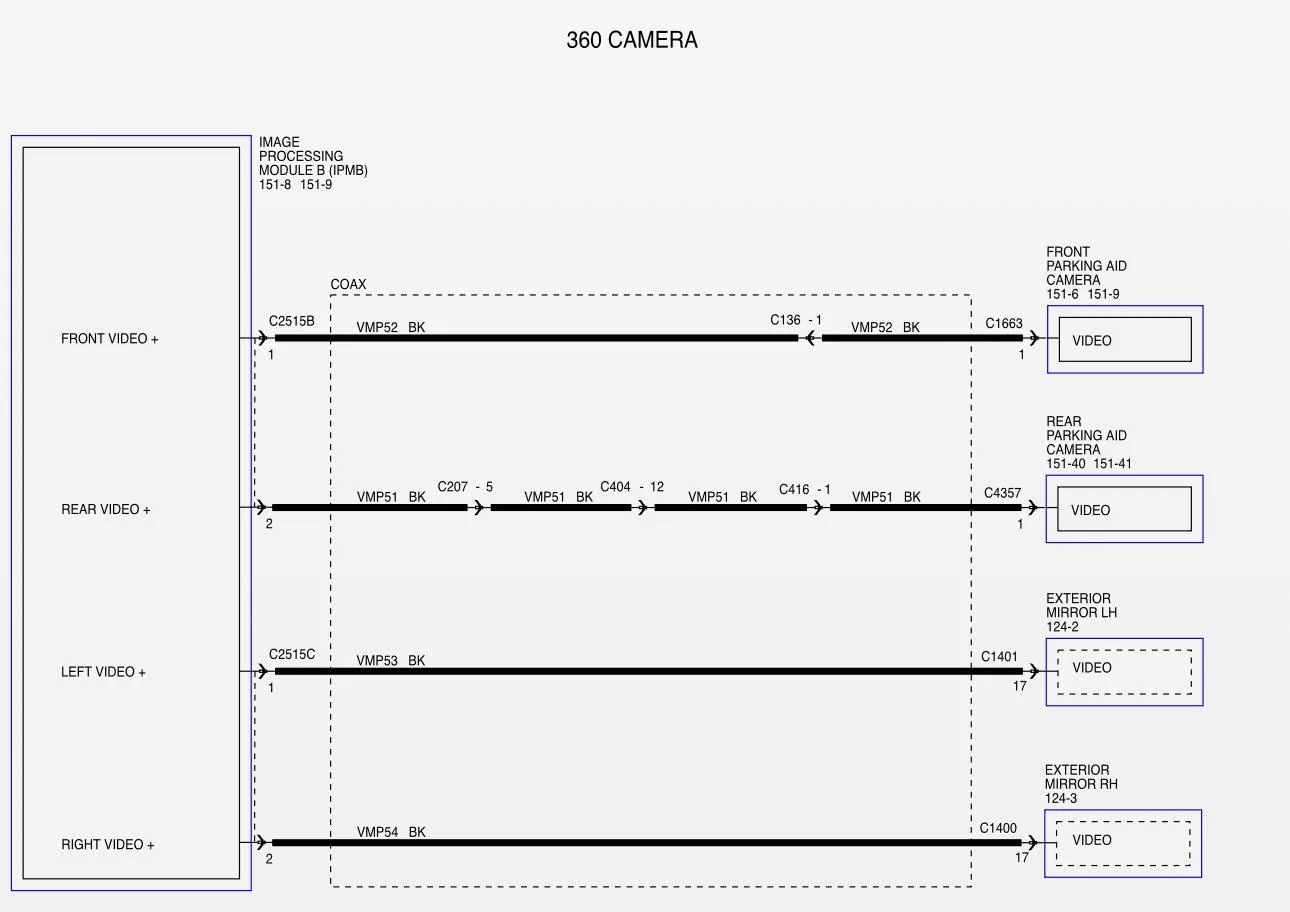

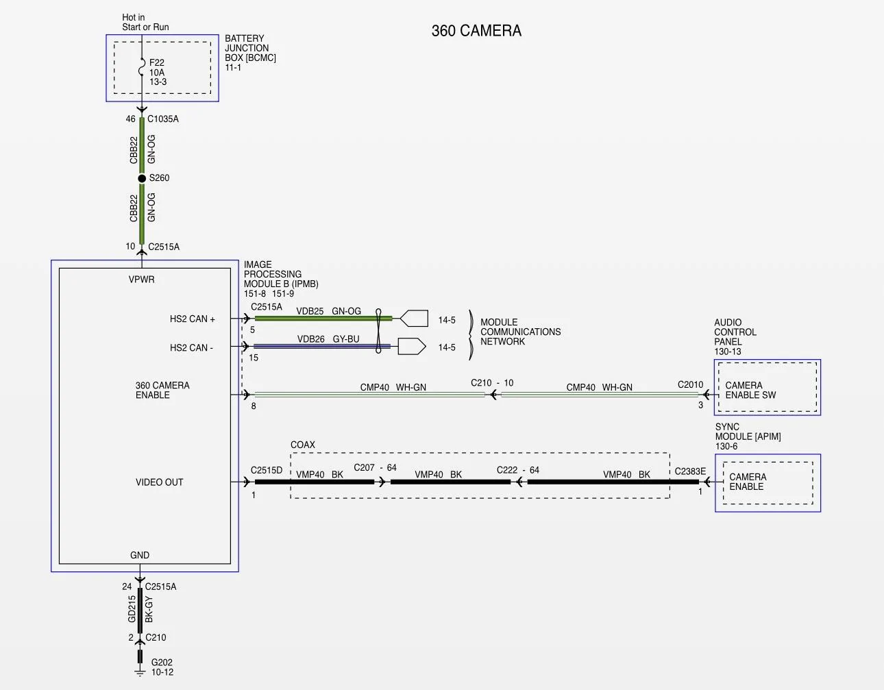

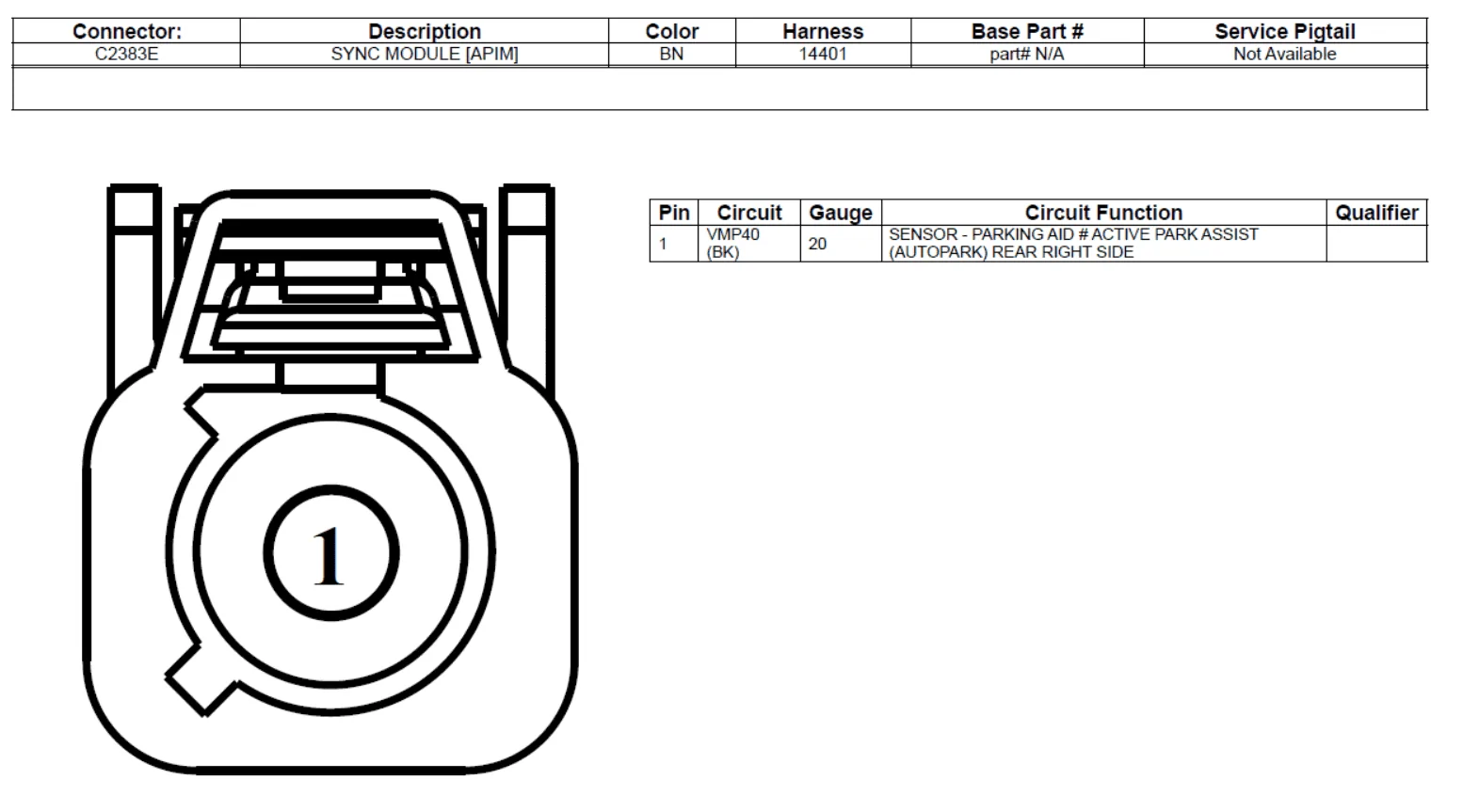

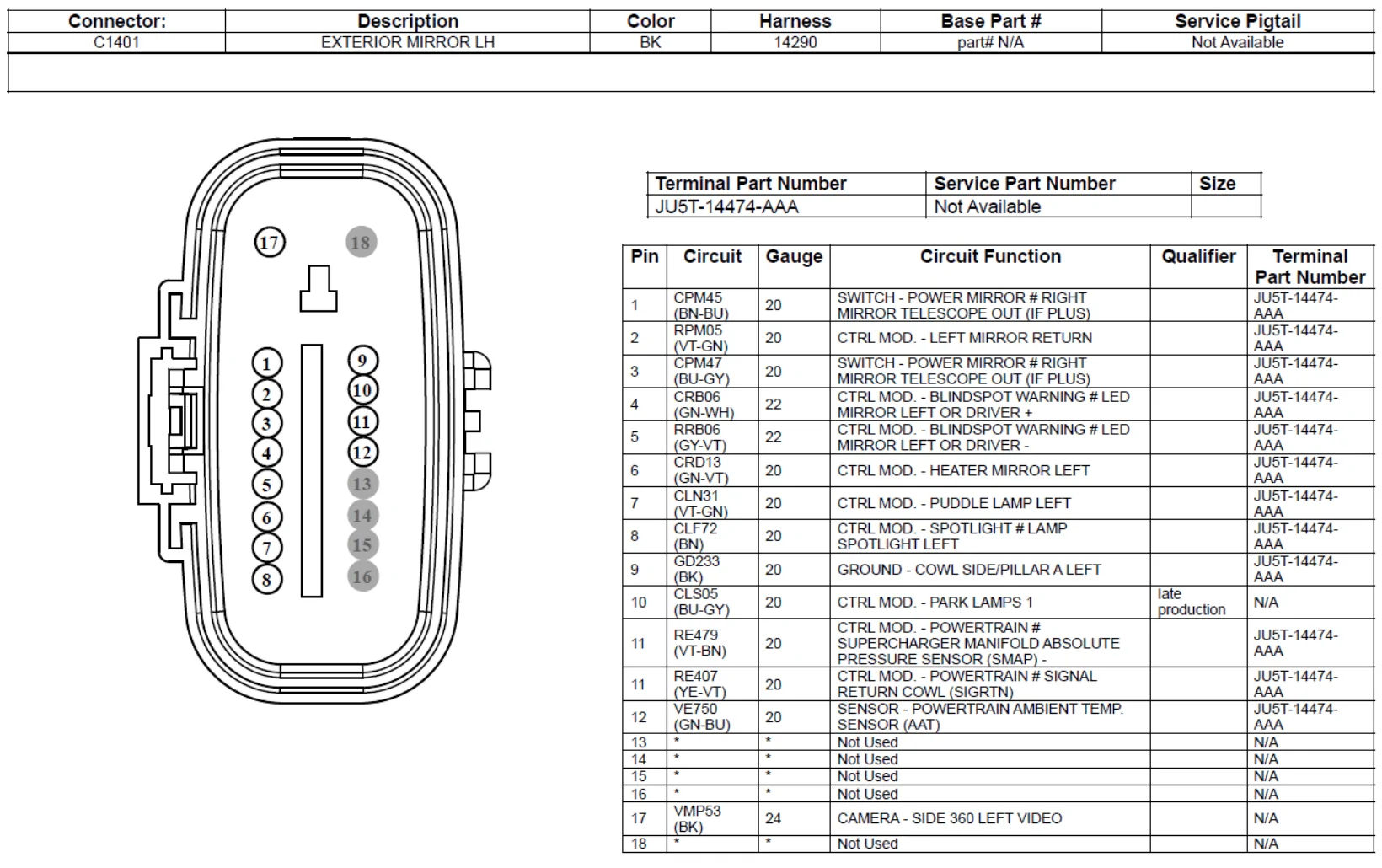

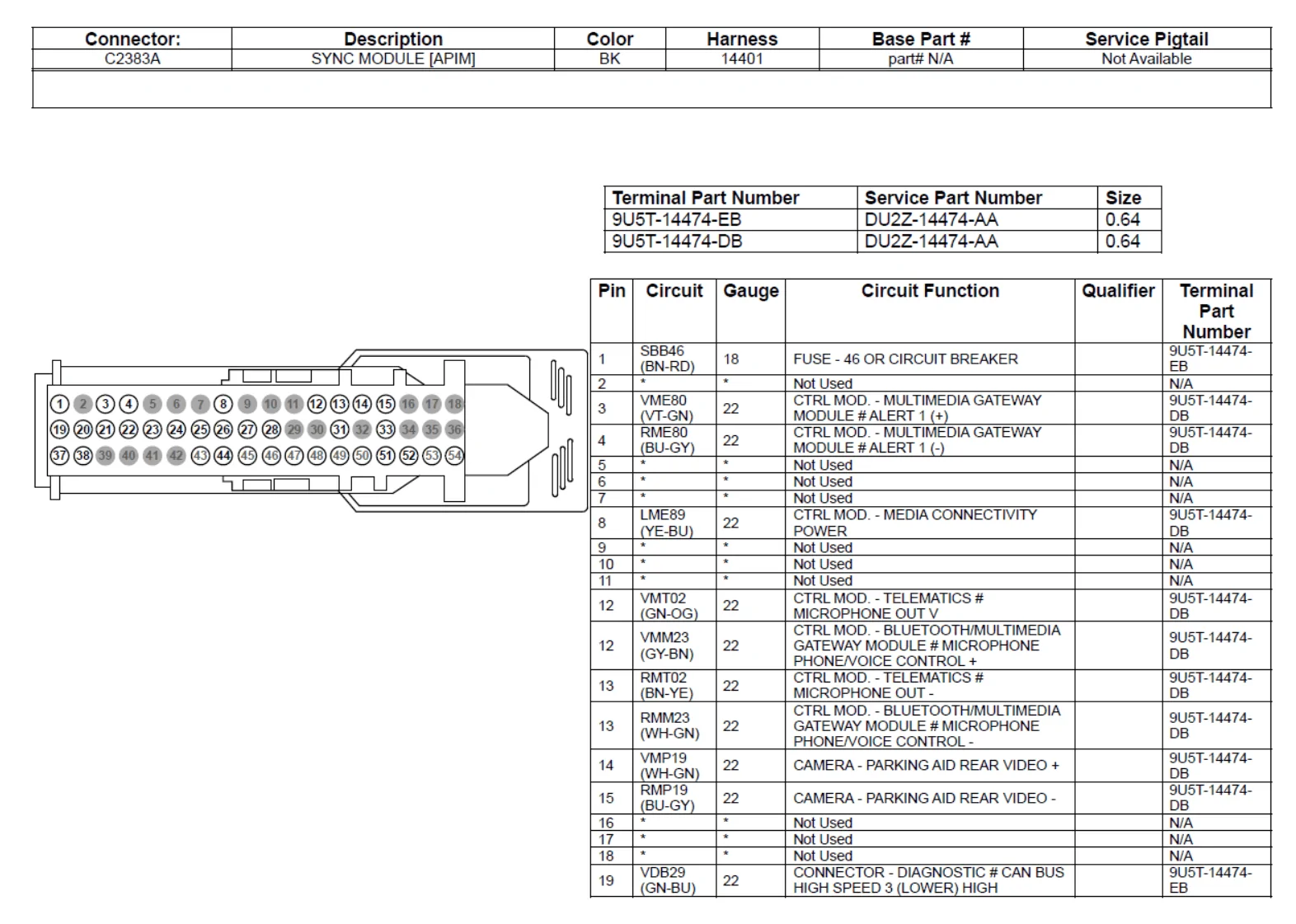

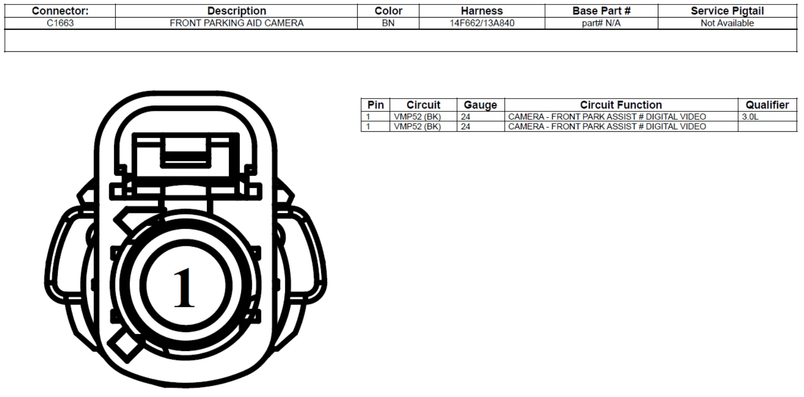

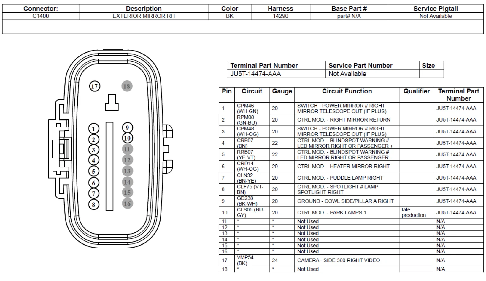

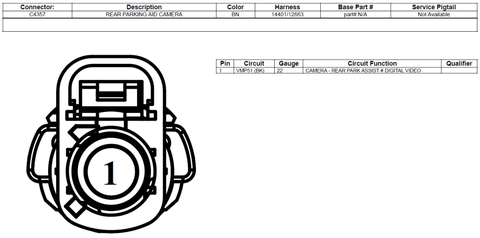

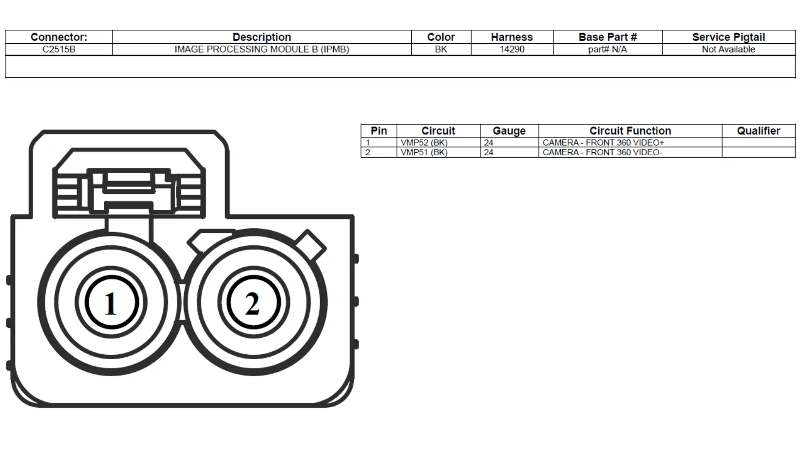

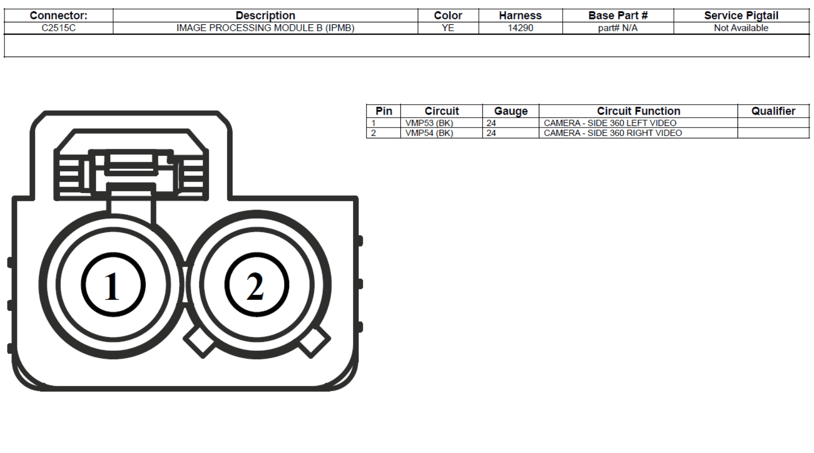

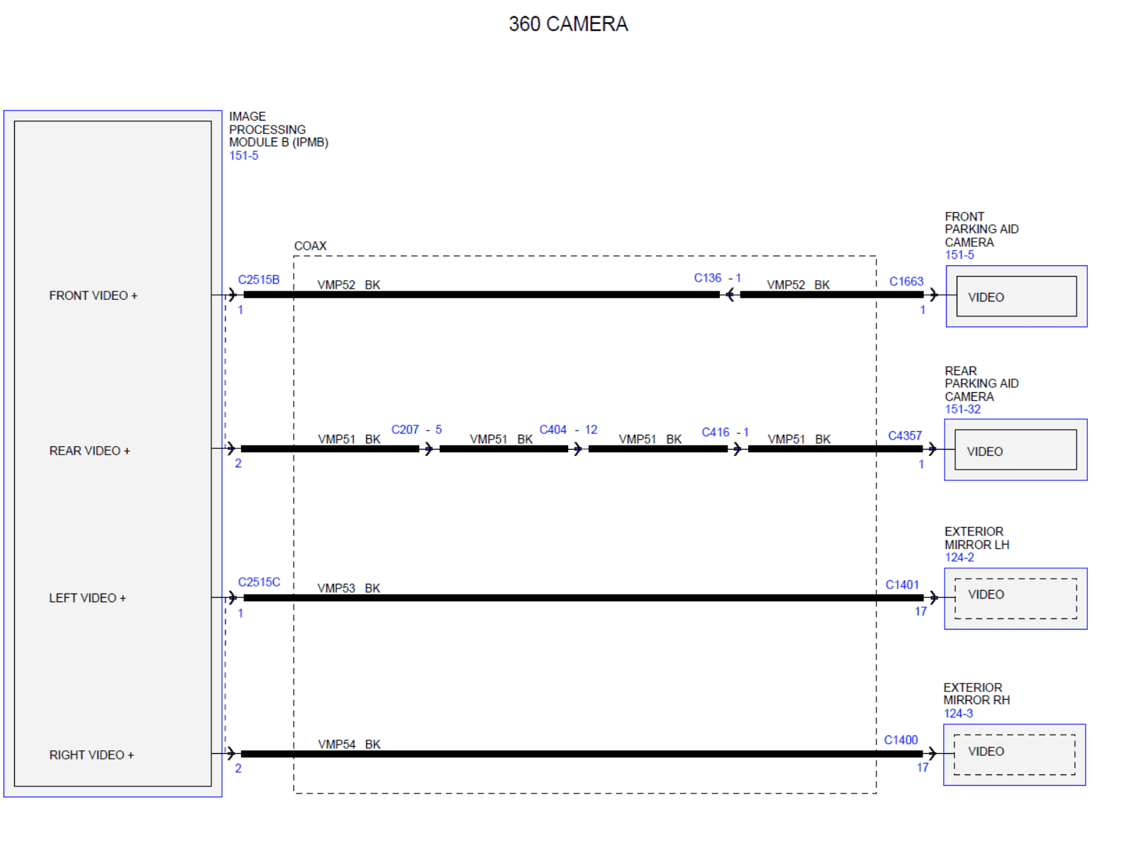

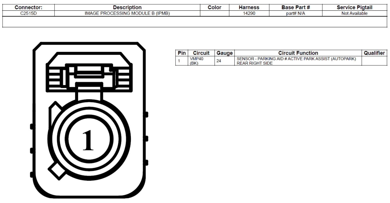

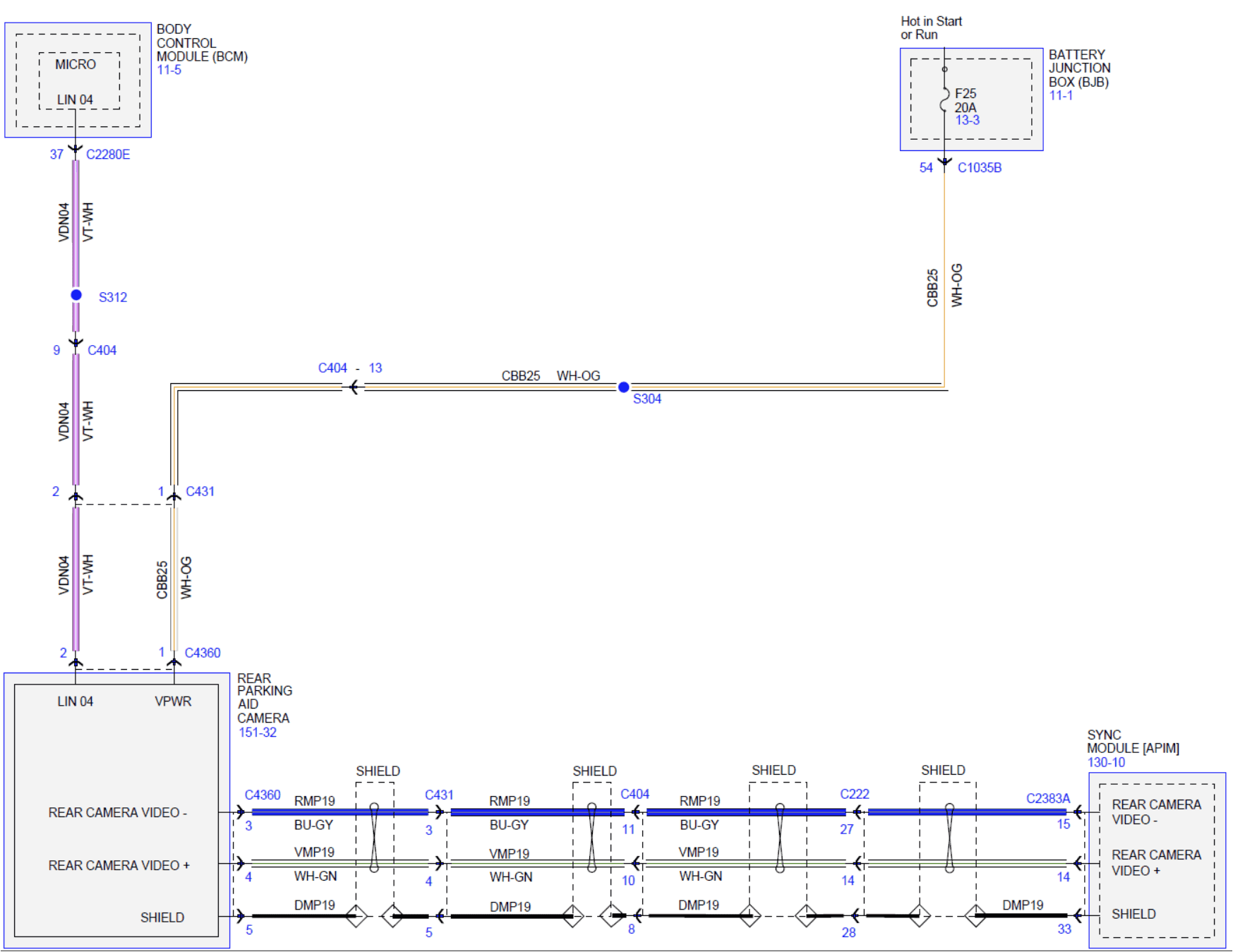

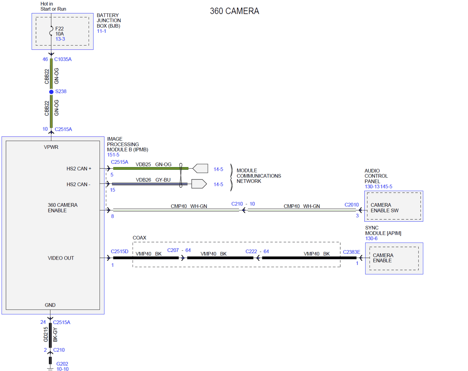

Hey guys I have searched and searched for an answer and have found nothing.
Does anyone have so insight on whether it's possible to split the video feed from the cameras?
Do the cameras send a constant feed to the head unit? I have the multi-camera setup if that makes a difference.
Can anyone tell me what the camera module is called? Possibly a diagram?
Where is the camera model located?
Thanks in advance for any help!!
Ducati1098
9,839
22,796
Midwest
Here is everything from the workshop manual. Should hopefully answer most of the questions you have.
IPMB is located above the passengers feet under the dash.
Ford Bronco Is it possible to split the factory camera feed? IMG_3499
Ford Bronco Is it possible to split the factory camera feed? IMG_3500
You sir, are amazing. Thank you so much!!
