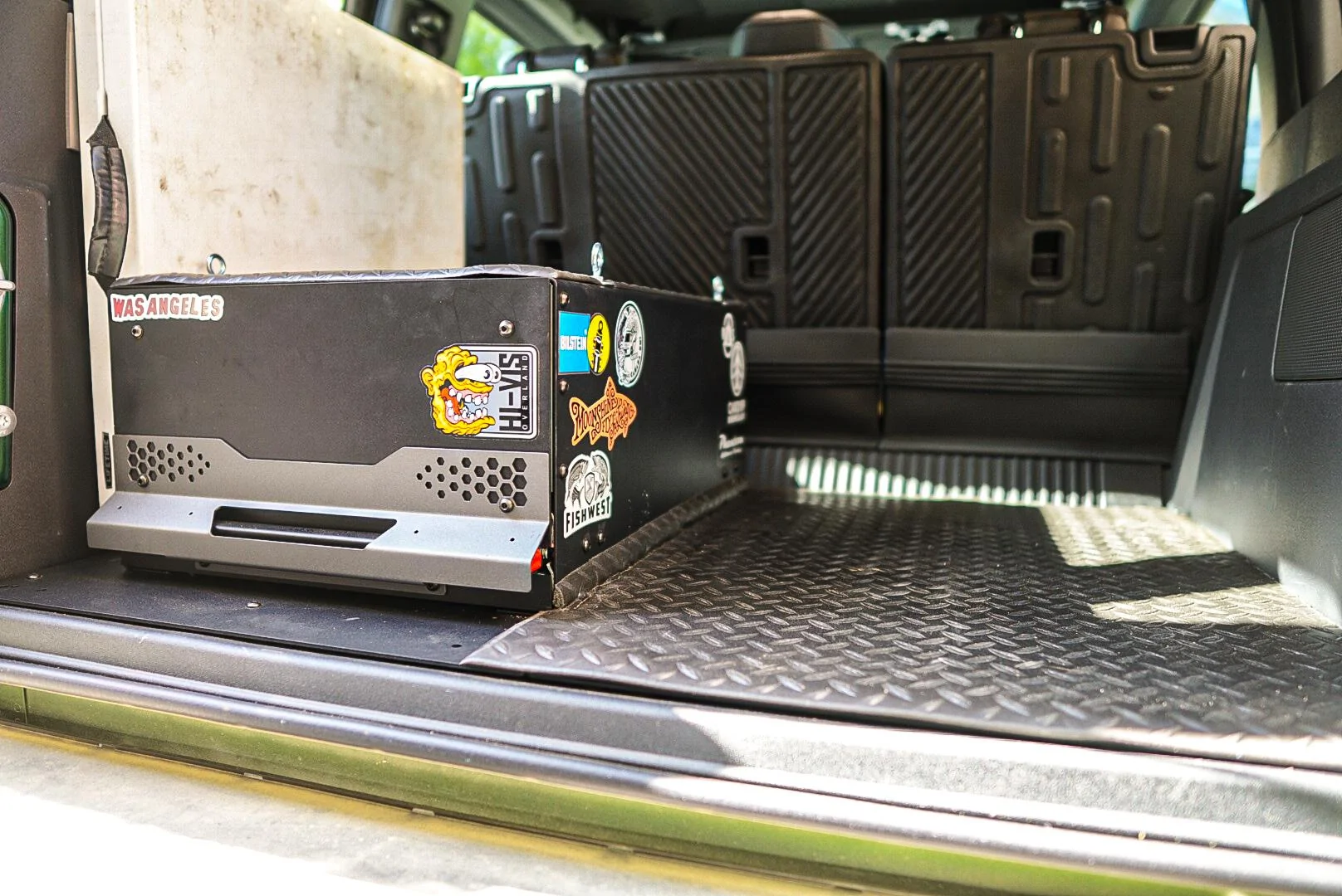

First up we have the JCR modular cargo setup. I'm a big fan of JCR and their products. Got to know some of the guys there pretty well over the course of building out the Cherokee and really like a lot of the stuff they are putting out for the bronco. Drawer/fridge slide setup was something I always wanted in the Cherokee but never wanted to put in the effort lol
So one of the first modifications, aside from Mabett interior piece that pretty much everyone has, was this cargo system. Install was a breeze and I can have the drawer/fridge slide out or in 10 mins or so. This was ideal for me just because of how much I like to change things around depending on what I'm doing.
Ford Bronco Just another Badlands DSC08395
Currently this has been my daily setup. 10" drawer to carry miscellaneous things, right now just camp chairs, kinetic rope, and a tire deflator. I like having this drawer in so I can store loose items in there that I might want out of sight. While its not lockable, if the tailgate can't be opened the drawer can't either.
I grabbed some foam diamond mat from Home Depot and cut it to size to give a soft floor for the dogs and so that there wouldn't be as much clanking around of anything back there

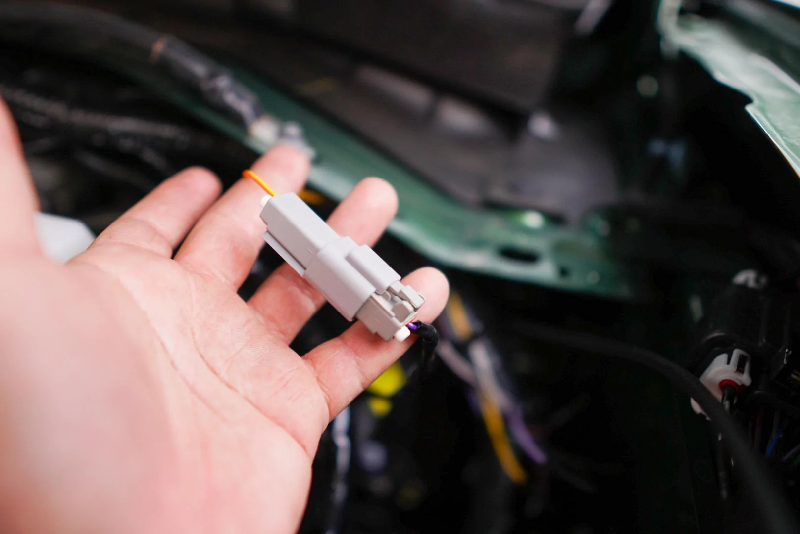

Have the jcr engine bay bracket showing up soon. Looks to be a super simple install. I did the wiring for it yesterday. Battery leads all crimped and soldered, trigger wire hooked to aux 6 via a deutsch connector. I'll post pictures of the entire install when the bracket comes in 🤙🏽

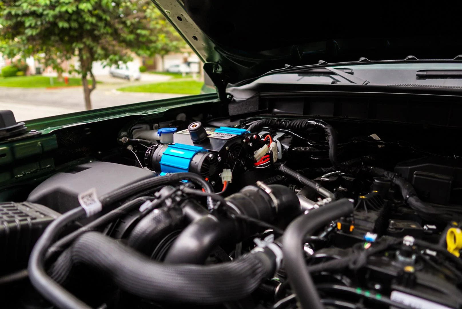

Compressor installed.
Bracket took about 30mins to bolt in. Really simple, very happy with it.
Chopped mostly everything from the switch harness to clean it up a bit and make it easier to tuck away. 2 pin Deutsch connector attached to the purple trigger wire from the ARB harness and connected to Aux switch 6.

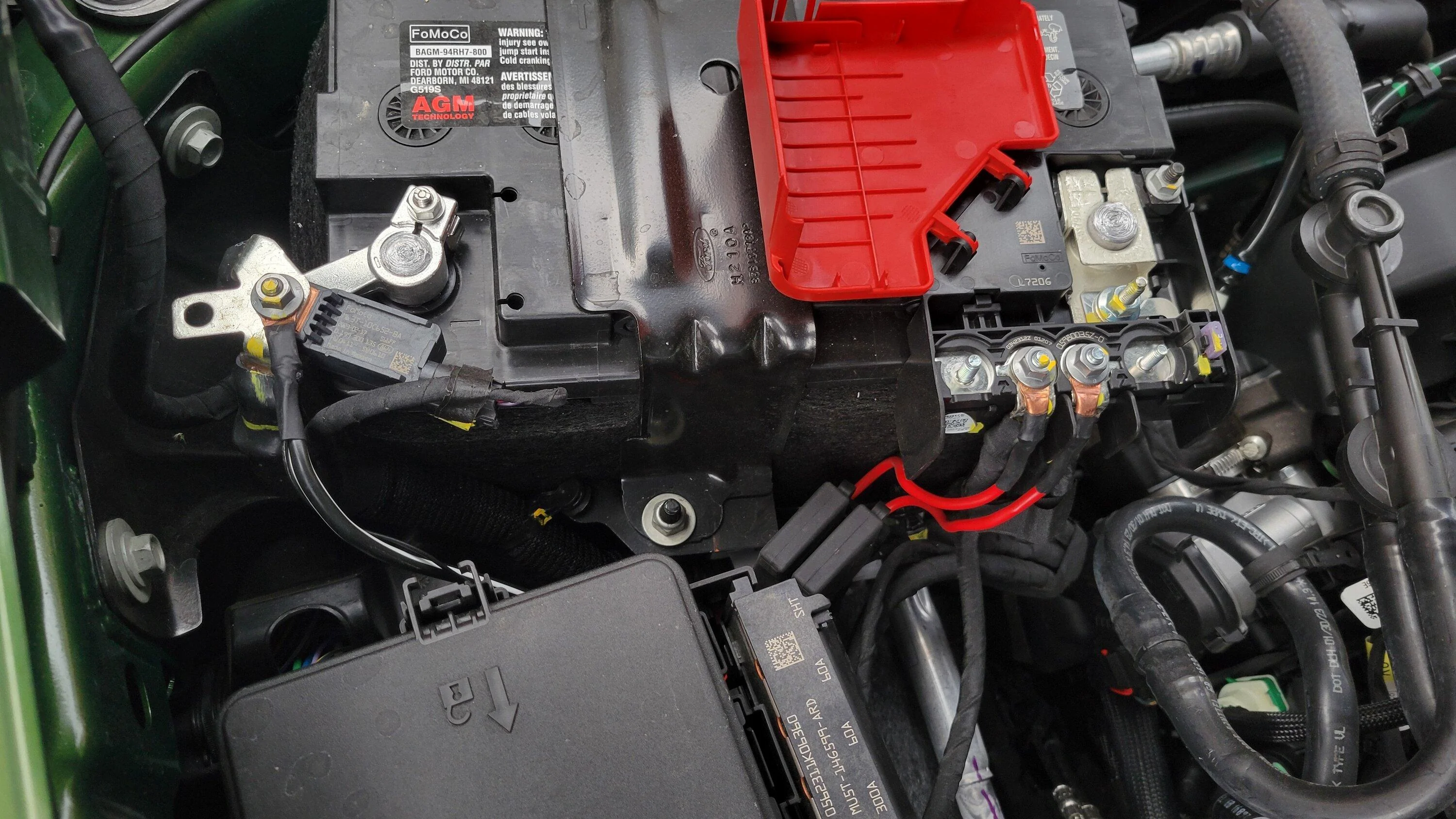

Main harness power and ground has eyelets soldered on and piggie backed off existing bolts from the positive and negative

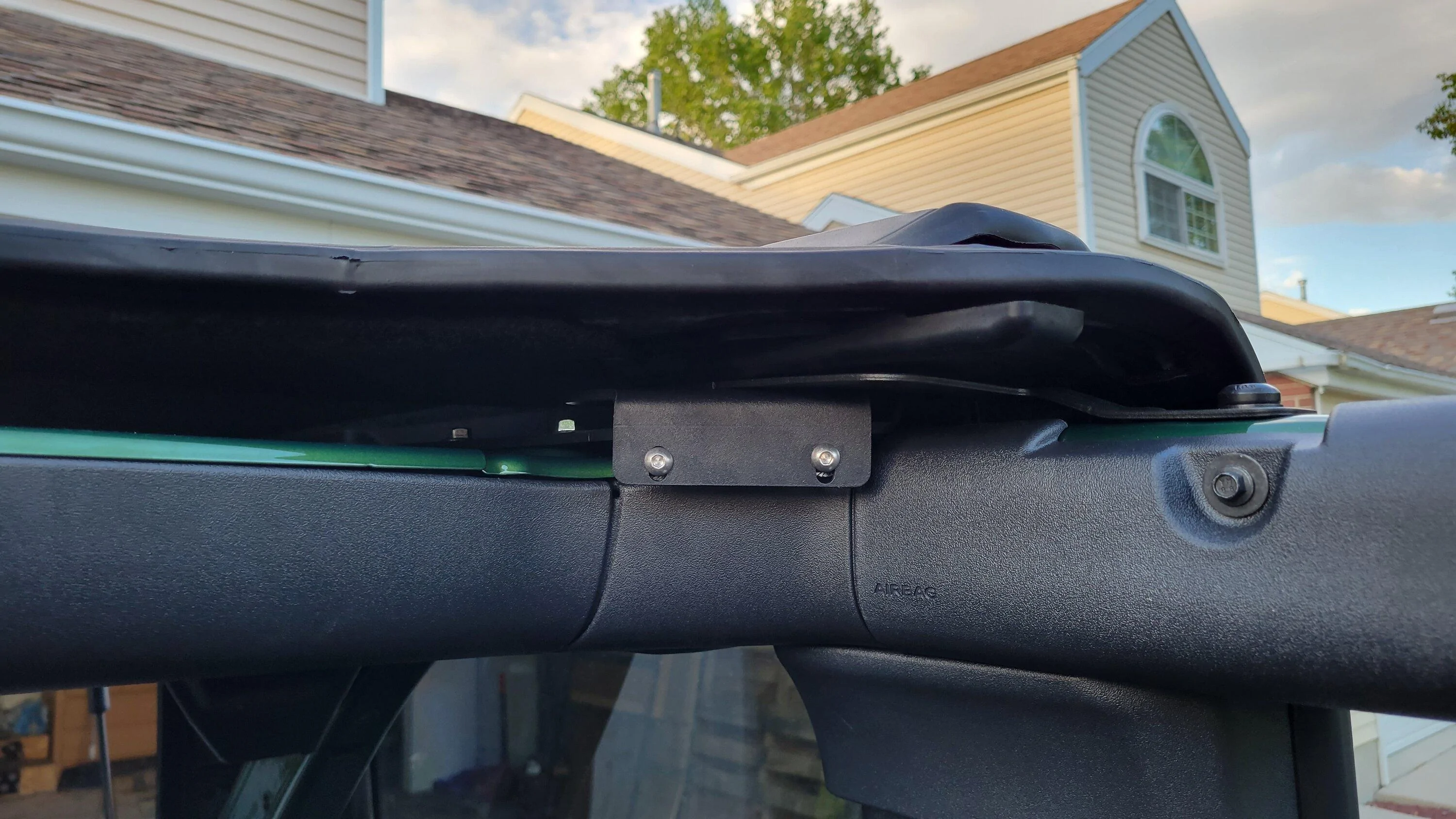

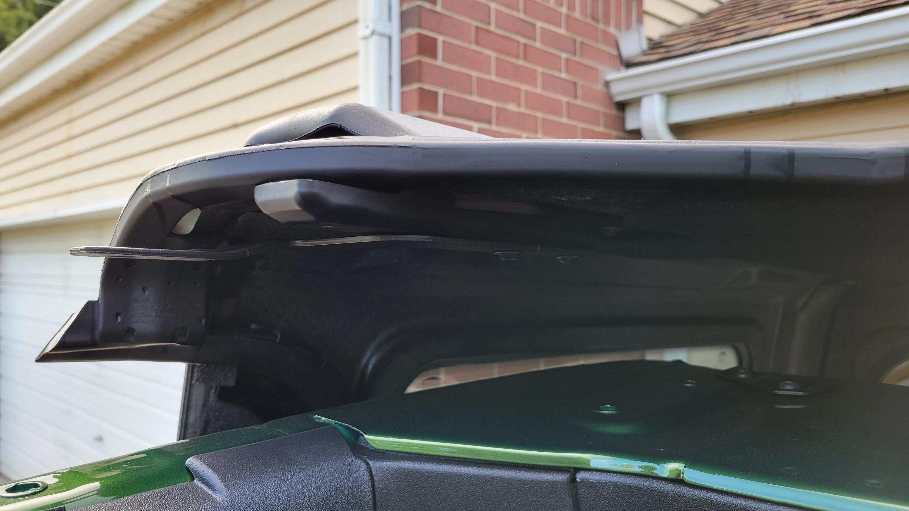

Got the JCR roof rack reinforcement installed and the fridge and slide for an short upcoming trip.
Before and after on the roof brackets
Ford Bronco Just another Badlands 20230605_191252
Ford Bronco Just another Badlands 20230605_194802

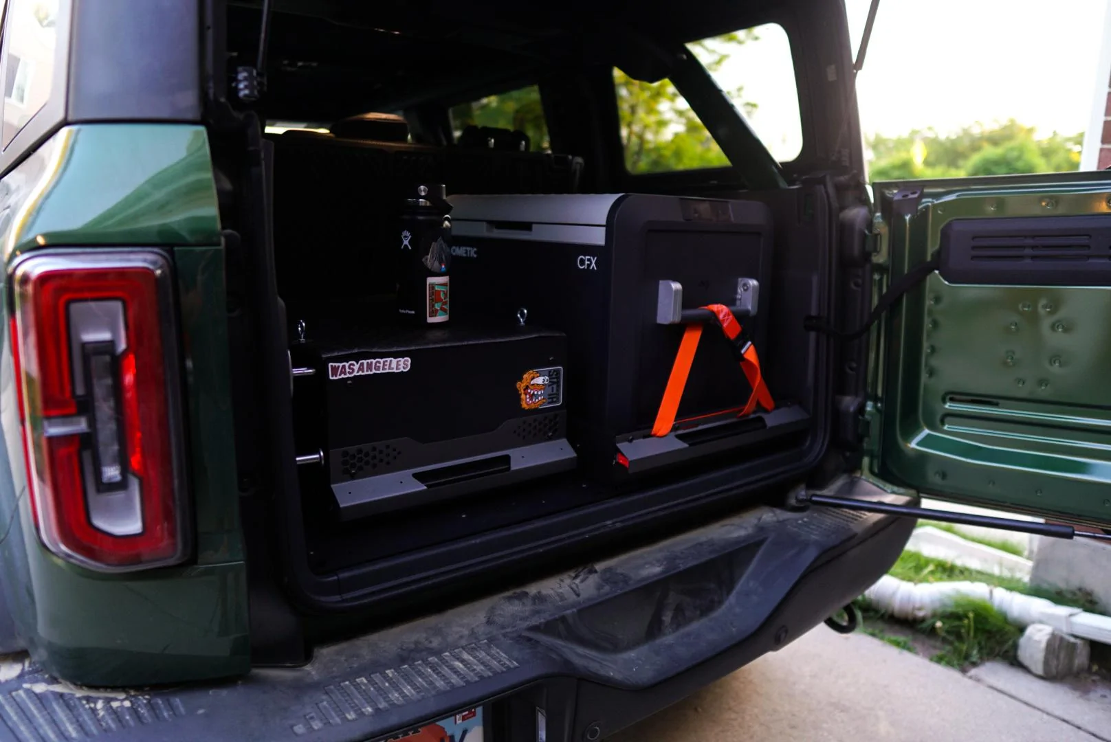

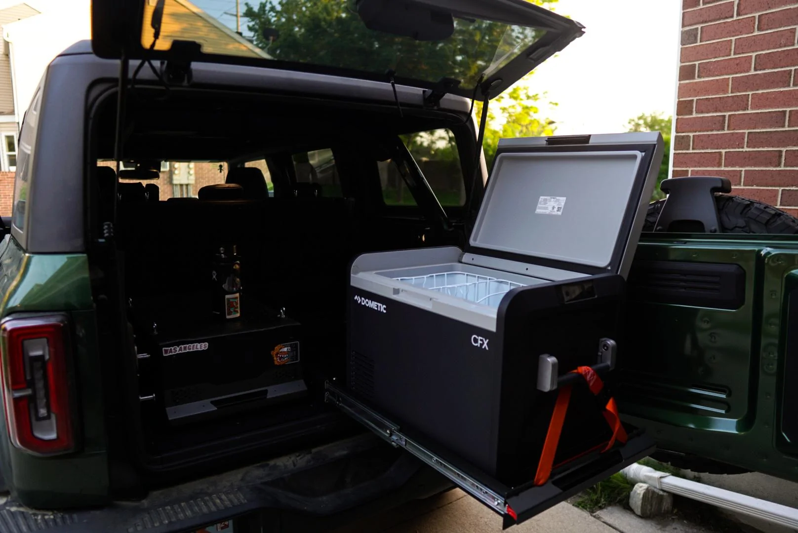

And the fridge, CFX355IM
Ford Bronco Just another Badlands DSC08407
Ford Bronco Just another Badlands DSC08408

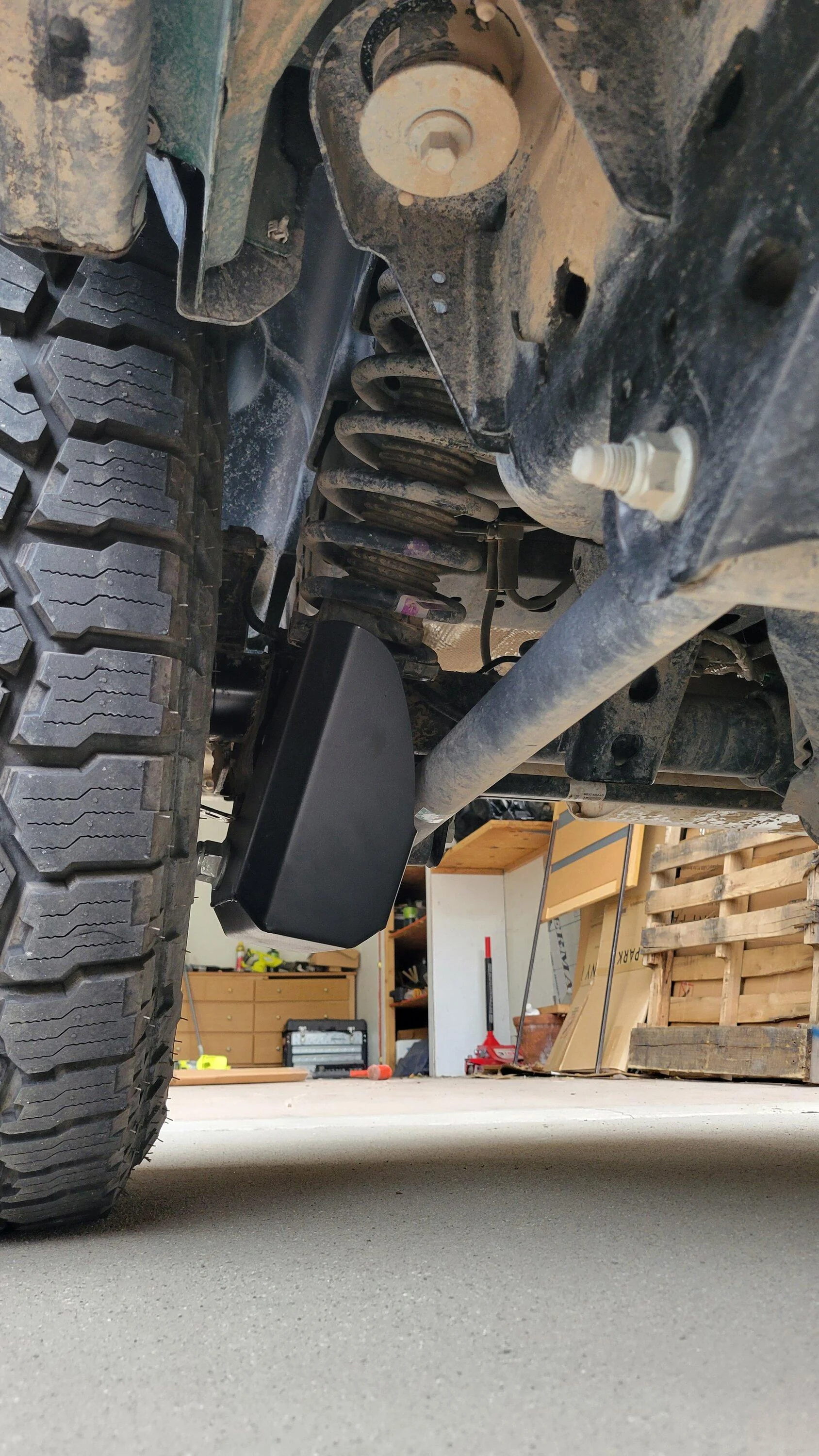

Quick JCR shock skid install. That main bolt torque was a bear 🥵 had to borrow a tq wrench from work lol

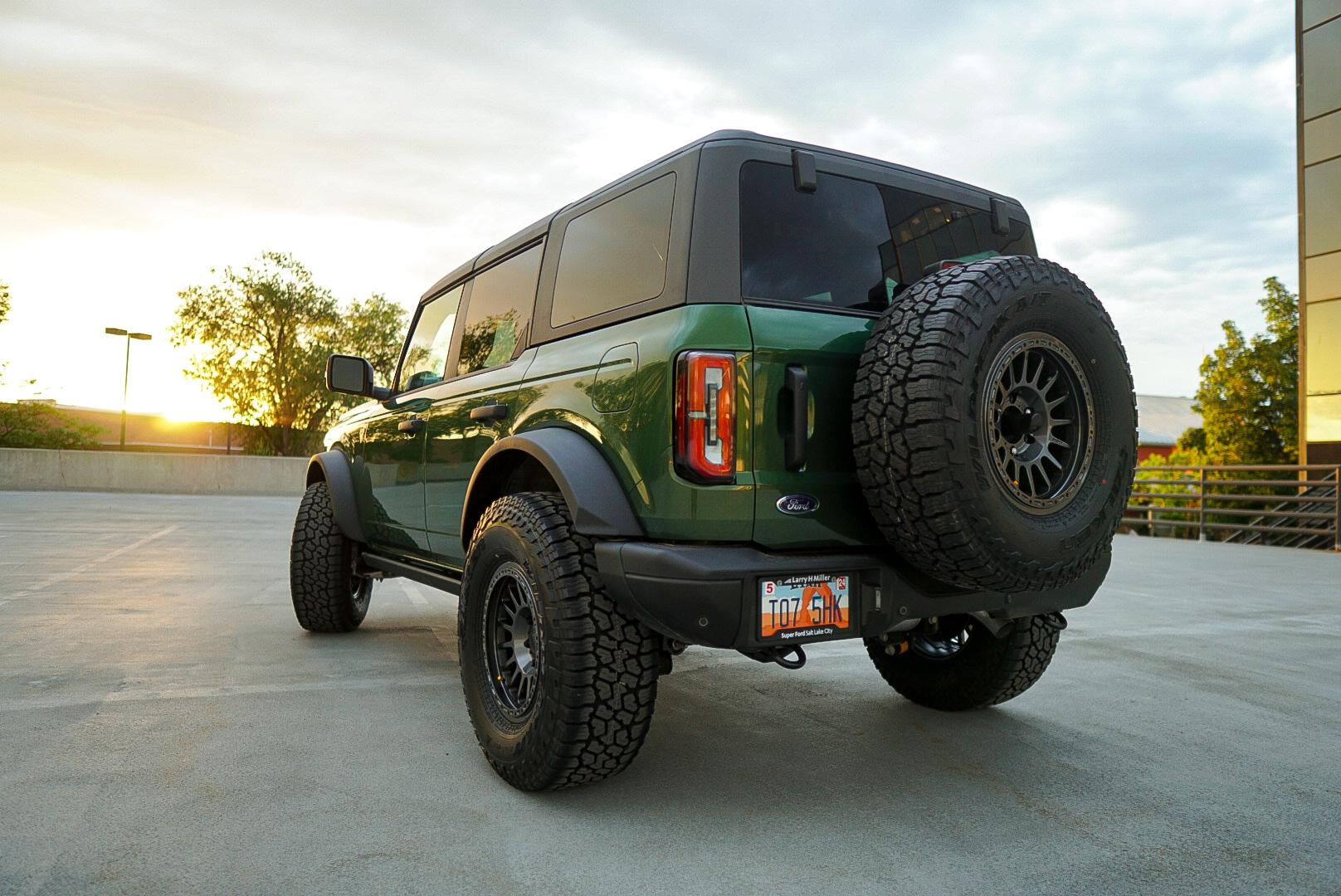

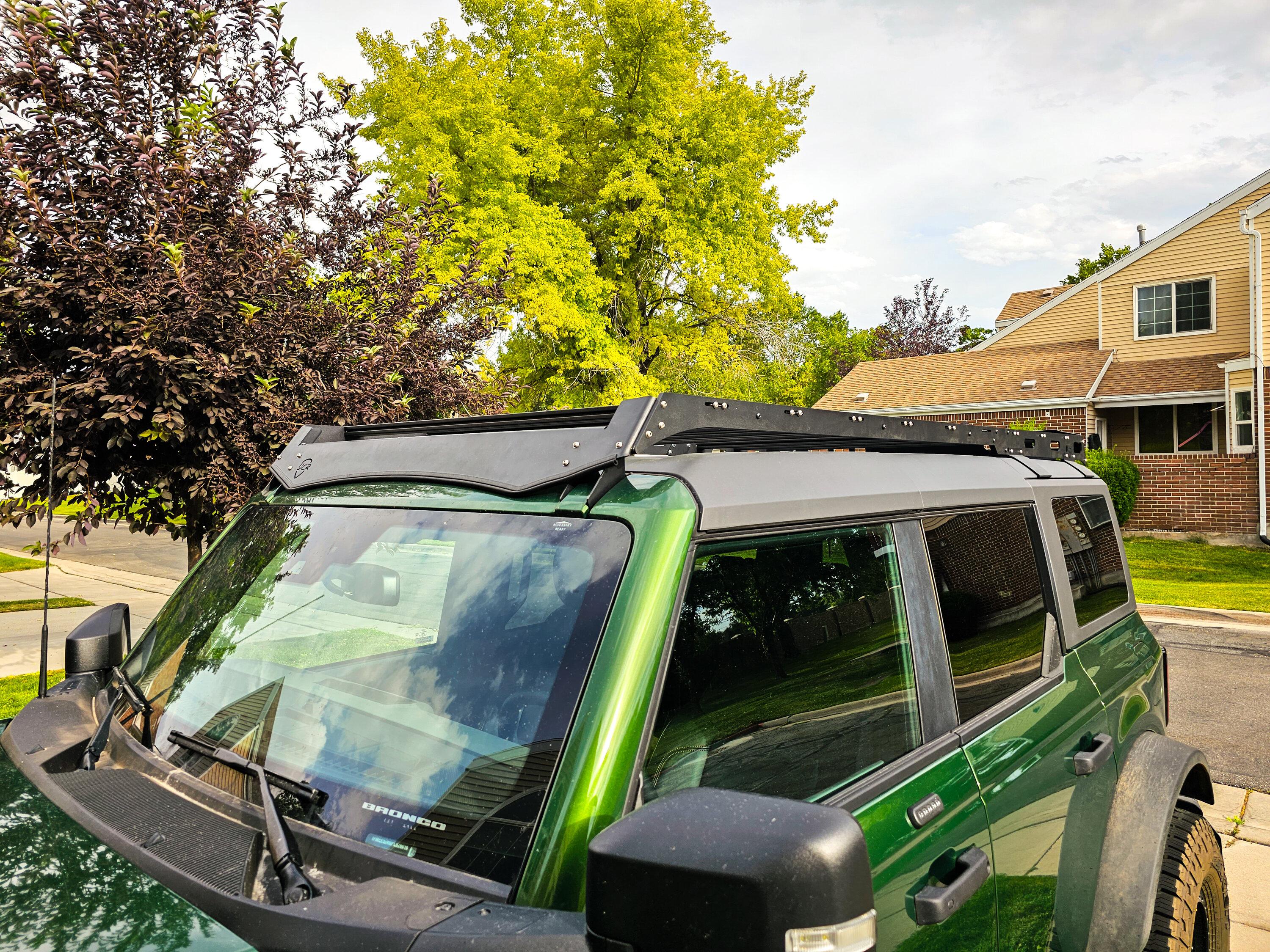

Couple things installed over the last few weeks.
Rokblokz XL flaps
JCR Offroad roof rack
Was on the fence with rockblok xls. Yours came out great. You went black with green logo? I'll do the same but with blue logo. Are you running a lift?
I went with black and black logos cause i'm not a fan of the RB logo lol
No lift right now, planning on a minor 2in lift in the future though

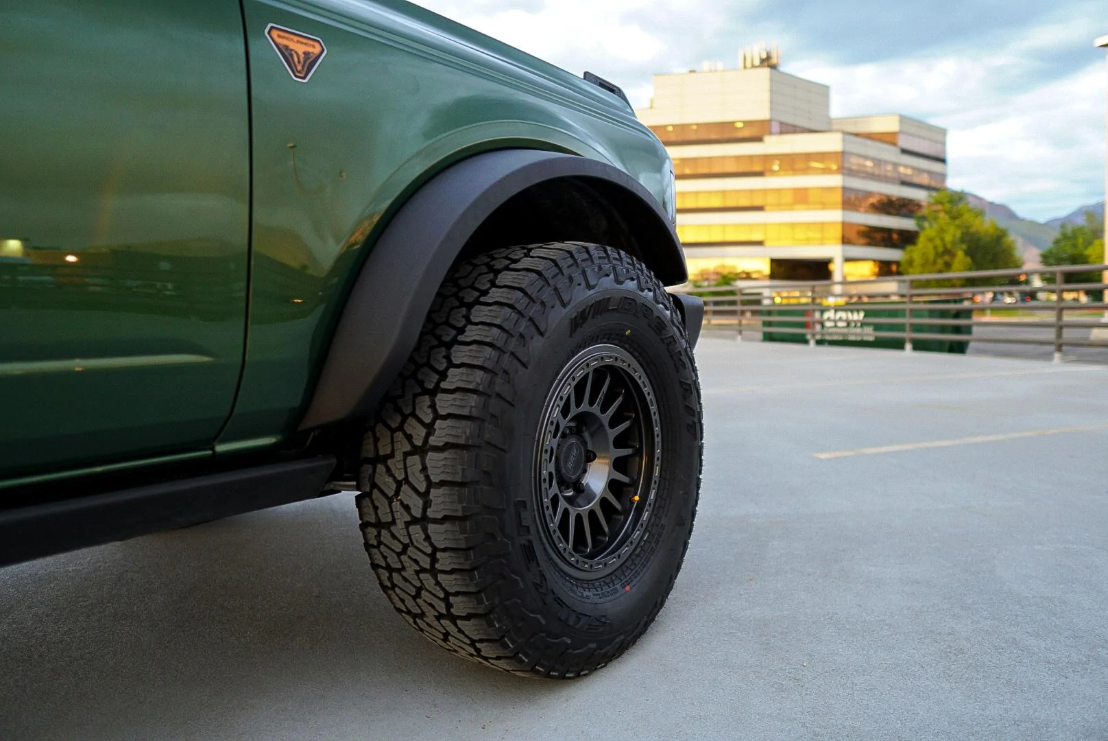

Wheels and tires fitted today, along with SAS flares
RRW RR6-H 17x8.5 et0
Falken Wildpeak AT3W 315/70r17
Which of their lugs did you purchase? I cant determine the difference of the two they offer. Also, how do you like these still? Any issues airing down?
