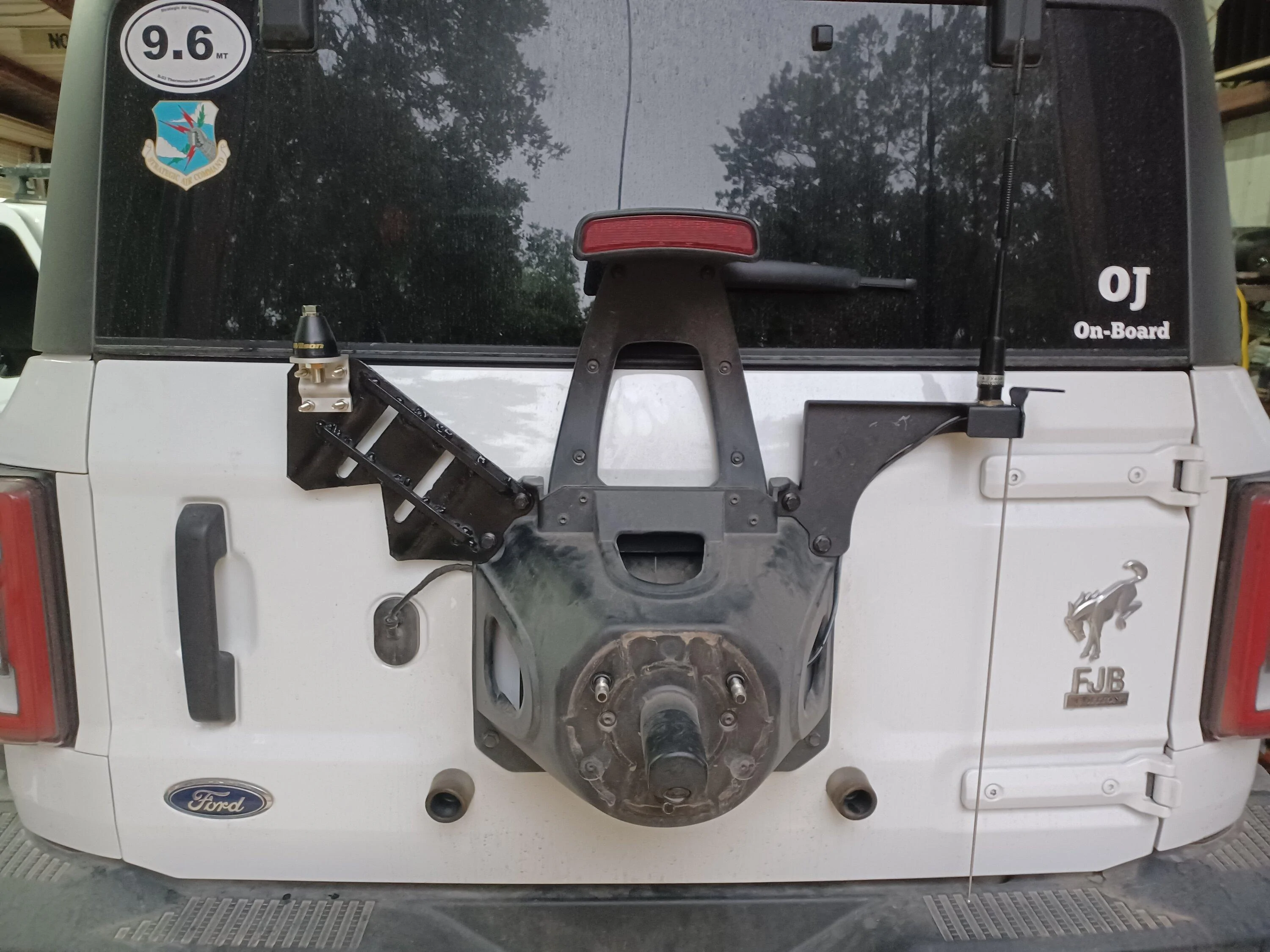

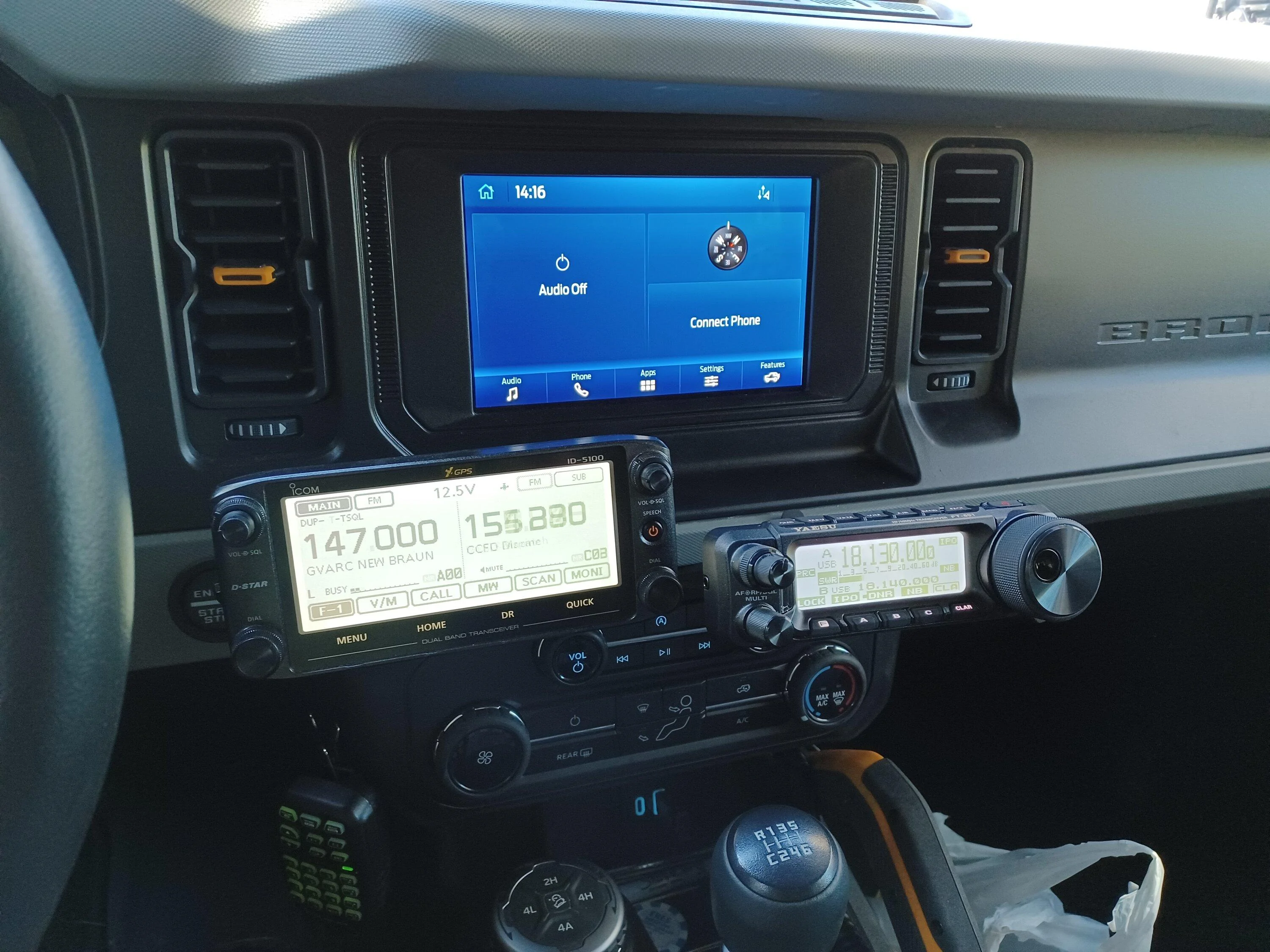

So I've had the Bronco for just about a year. I've installed 2 different VHF/UHF radios in it, taking apart the interior three times to install radio faceplate/main body separation and microphone cables. Ford's interior fasteners are actually reusable nowadays vs my 2010 Ranger!!!
In November of 23 I decided to get back into HF mobile operating...NOT high powered, only 100 watts. I ordered a nice, simple Bronco, this thing has about 40 computers in it, and I'm not prepared to fry one with half a kilowatt and pay for it!

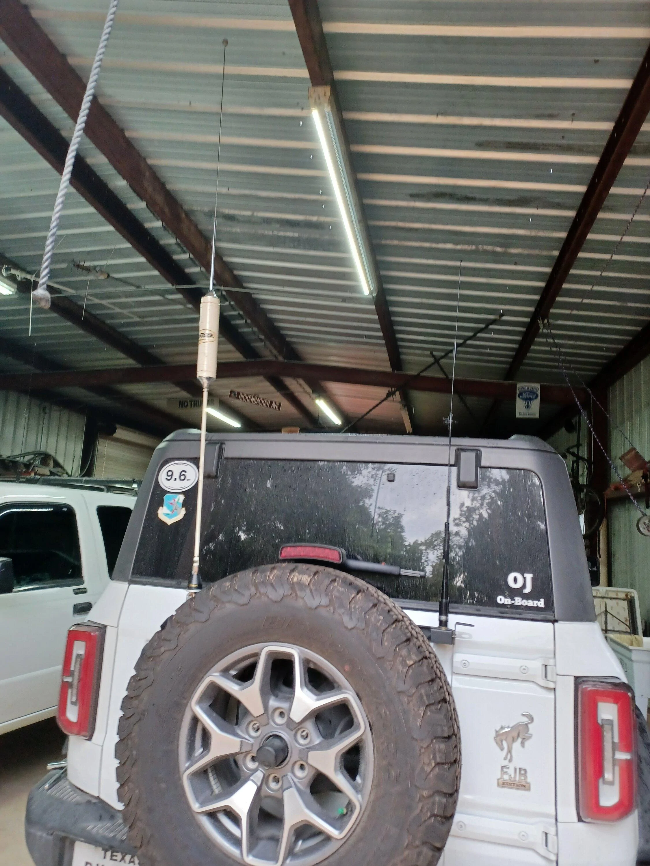

I bought a Yaesu FT-891, built my own additional antenna mount, and cannibalized my Hustler mobile HF antenna bits from the F-250. That 30 year old stuff still works!!!
So I had to tear apart the interior again to run (yet) another mic cable.
The day after Thanksgiving I made a 5282 mile contact with CE7VP in Quellon, Chile.
Ford Bronco Low-Q Bronco 20231120_141643
Ford Bronco Low-Q Bronco bronco_HF_install_3
Ugliest antenna mount I EVER did build, out of a boat winch bracket, but my plasma cutter is broke, so I had to improvise/overcome/adapt.
It's STRONG tho...
Ford Bronco Low-Q Bronco bronco_HF_install_1
75 meter Hustler load subtracts about 6 MPG.
Just kidding, I haven't tested it yet.

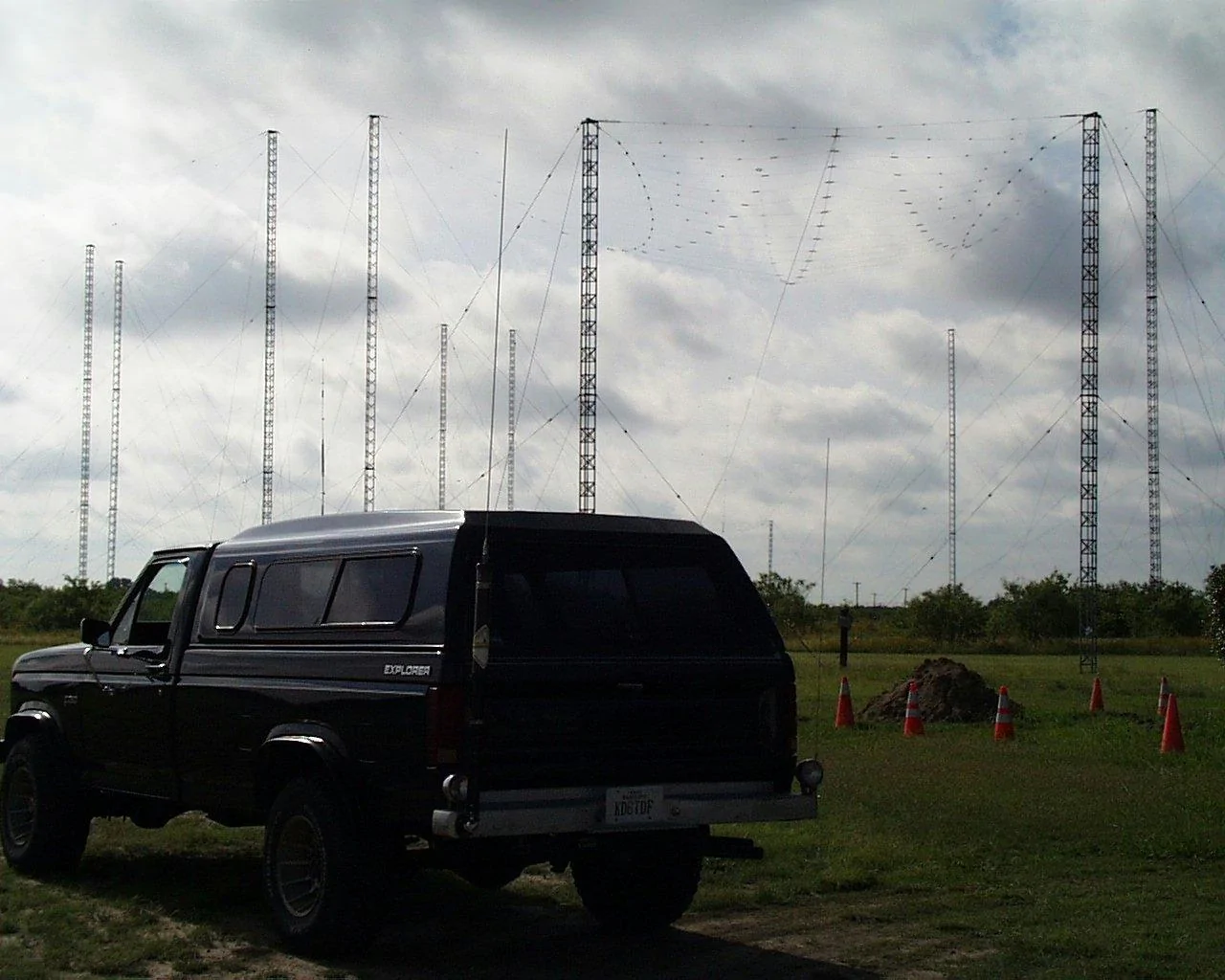

The farm in the background of Old Blue, my 85 F-250, was part of the USAF Giant Talk(?) LPDAs that were at various bases...since been dismantled. Damn shame.
Funny thing, I haven't grounded doodly on my HF setup in the bronco. I can't find my roll of grounding strap. I did put a few ferrite beads in various strategic locations, seems to help, a bit.
Yesterday I talked on 40m from South Central Texas to a guy near Soper OK. I was in the Low-Q Bronco, and he was in a Road Grader...new first for me!
