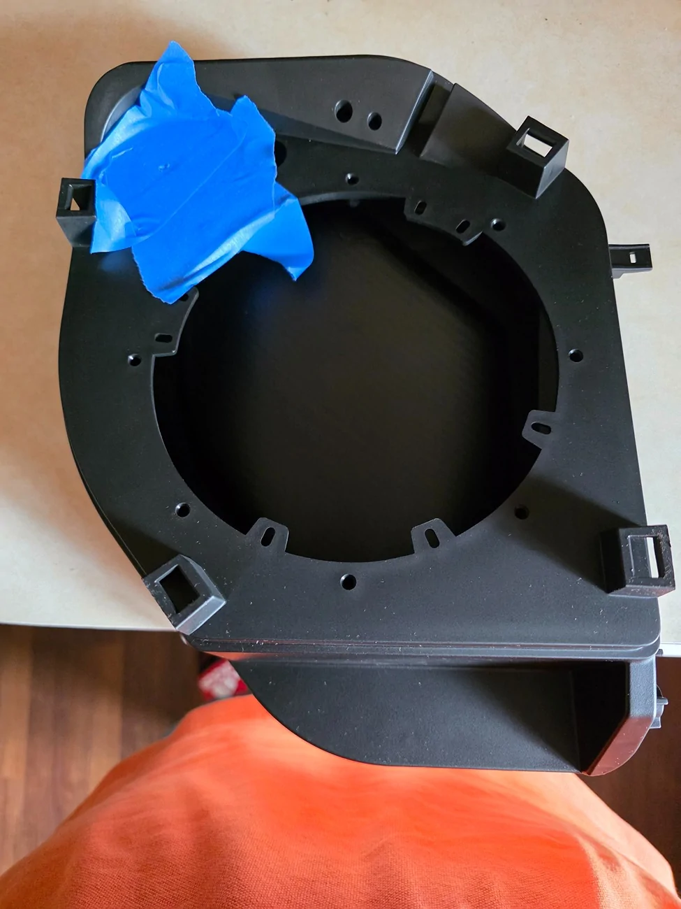

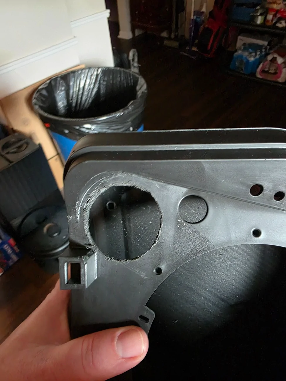

1. Prep the pod for drilling the hole for the tweeter. This is a 1 3/4 tweeter. I would not go any bigger than this or the tweeter would not fit.
Ford Bronco Metra Speaker POD install 20250731_174007
2. Drill baby Drill...
Ford Bronco Metra Speaker POD install 20250731_175316

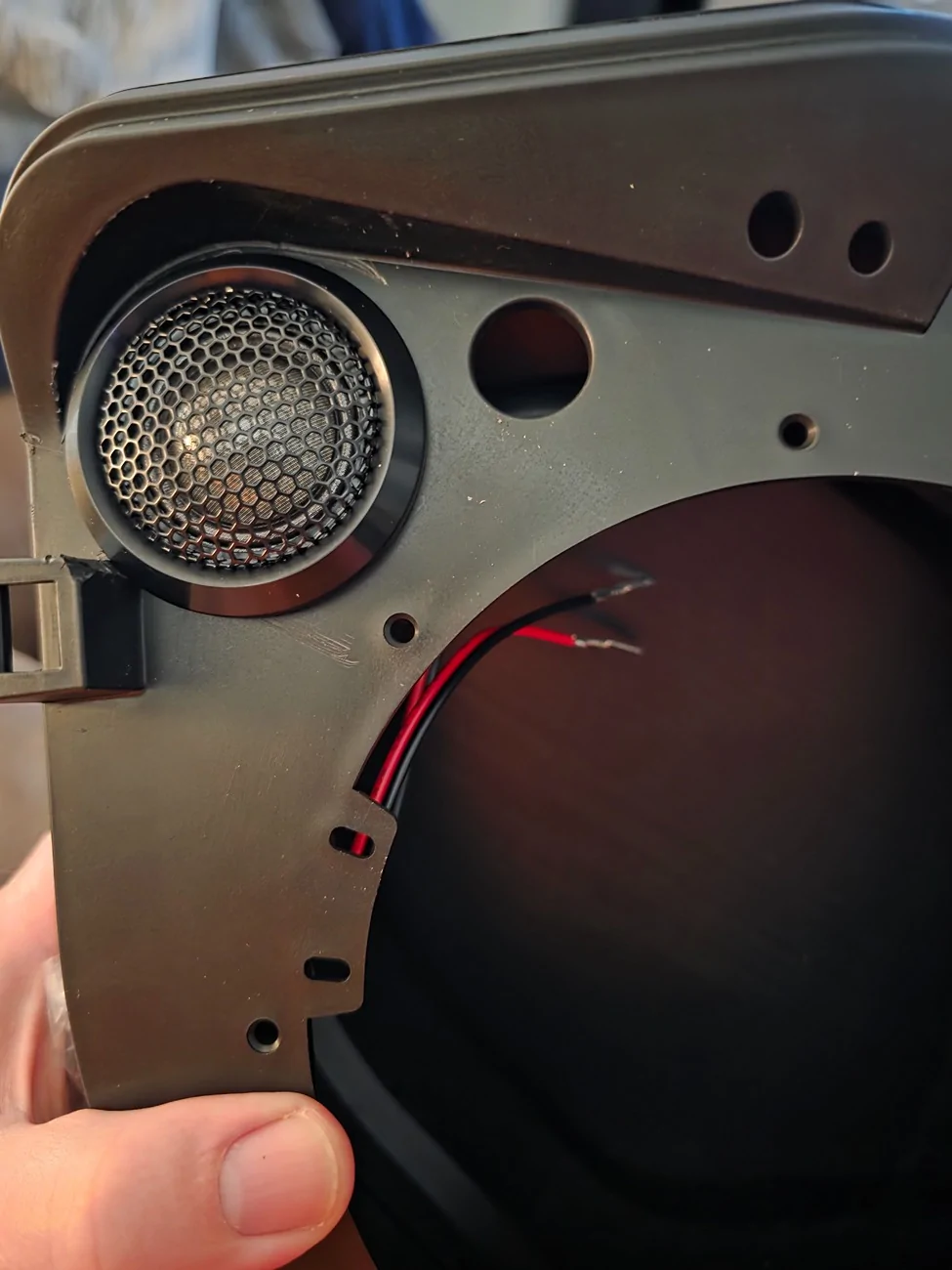

3. Test fit the tweeter.
Ford Bronco Metra Speaker POD install 20250731_175543

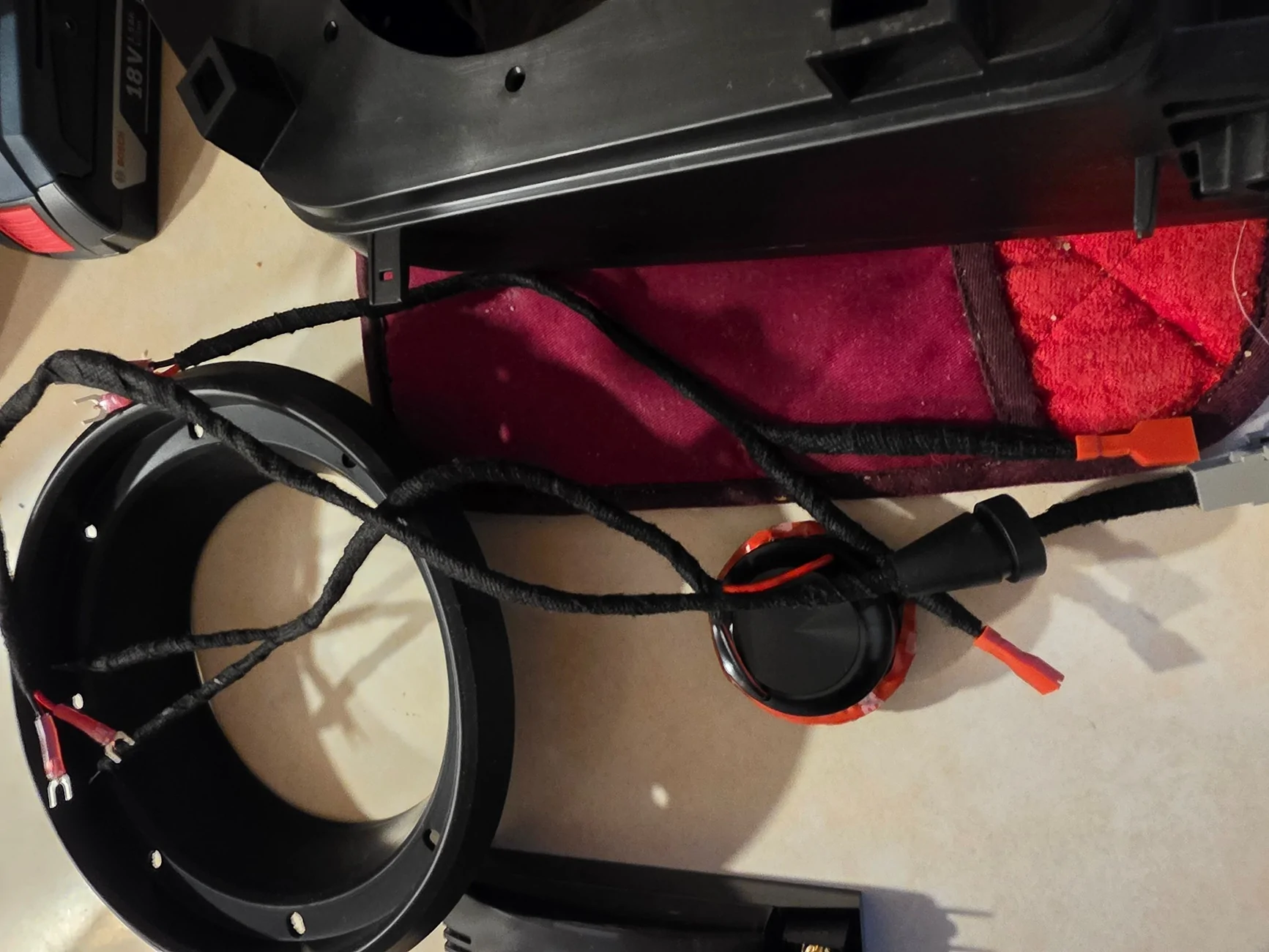

4. Prep the cables with tesa tape. And put some mounting foam tape on the tweeter.
Ford Bronco Metra Speaker POD install 20250802_204824

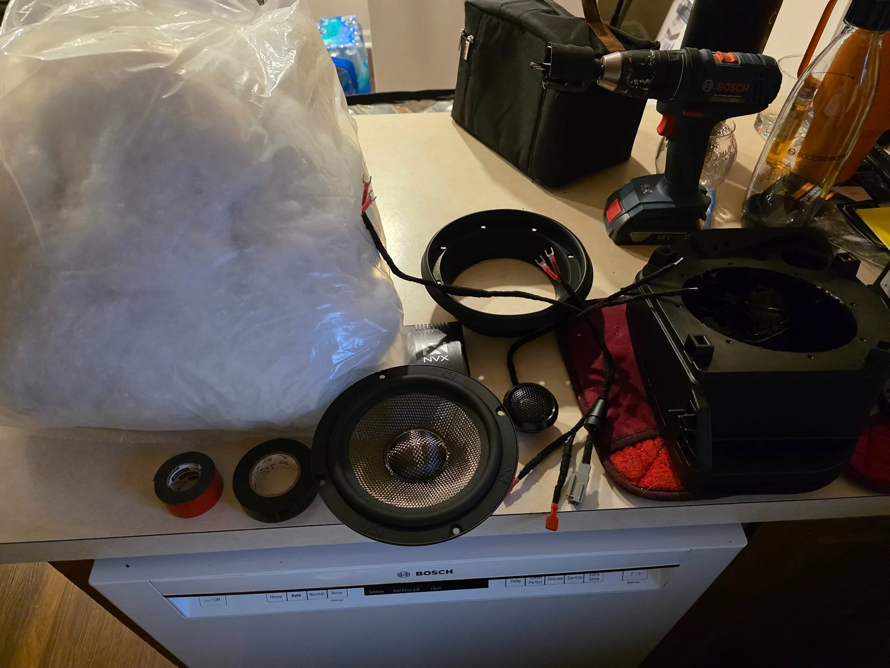

5. Gather your parts for the install.
Ford Bronco Metra Speaker POD install 20250802_204807

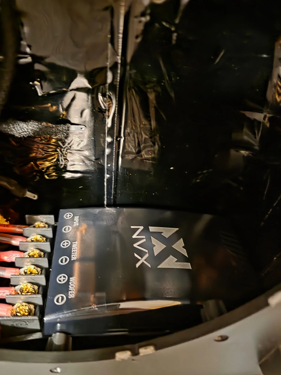

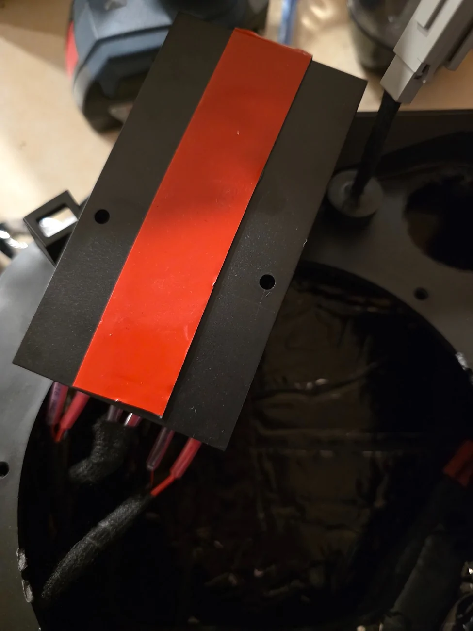

6. Install the Crossover and the tweeter.
Ford Bronco Metra Speaker POD install 20250802_205552 1
Ford Bronco Metra Speaker POD install 20250802_212307

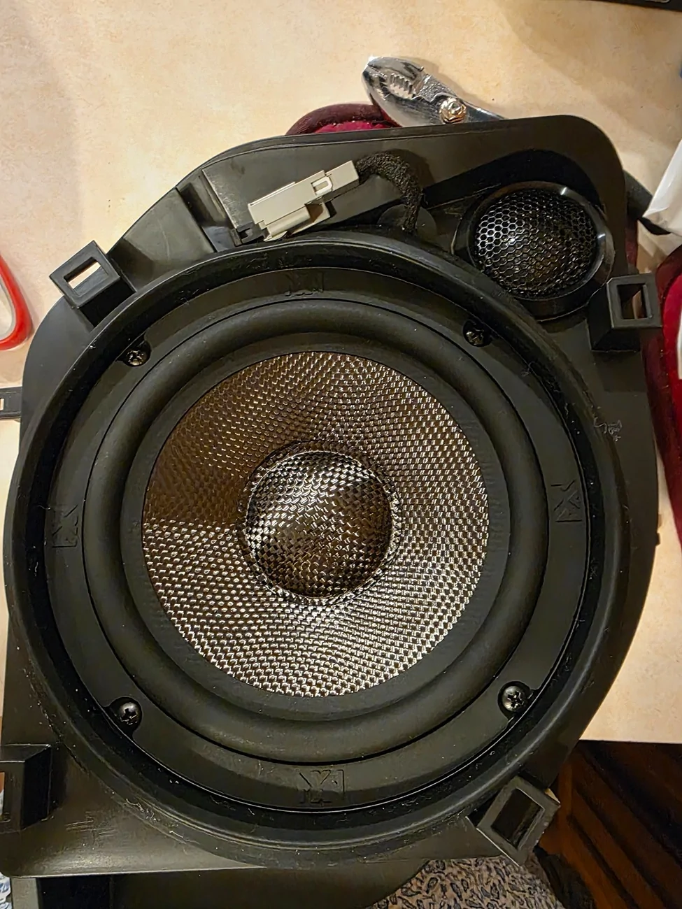

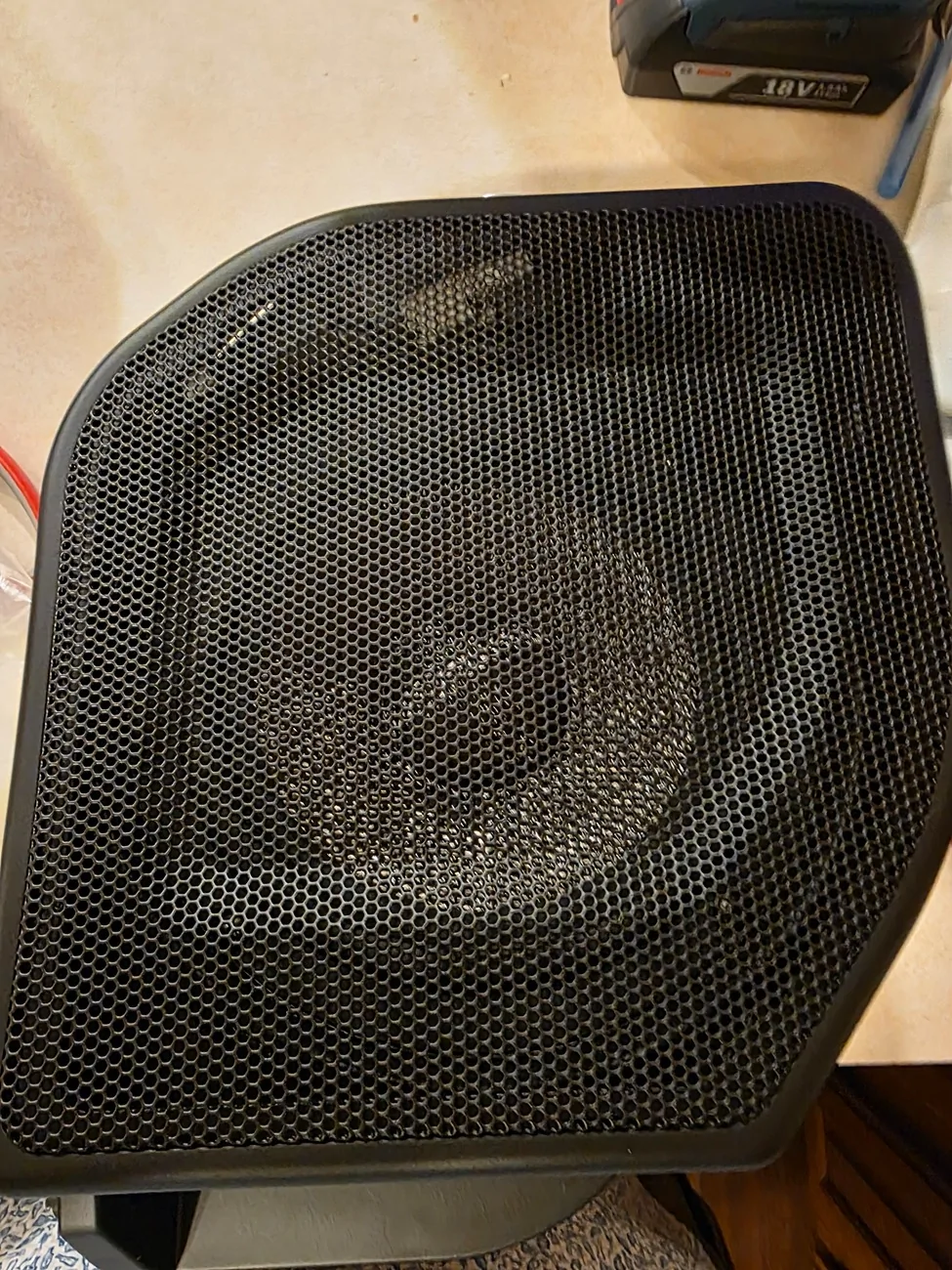

8. All assembled.
Ford Bronco Metra Speaker POD install 20250802_211007

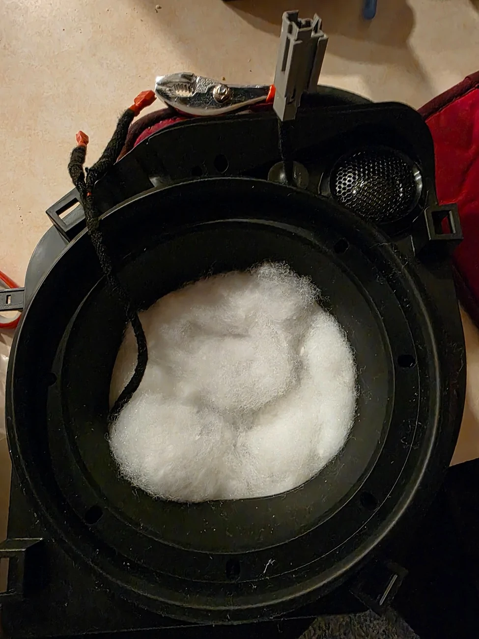

9. Finished product.
Ford Bronco Metra Speaker POD install 20250802_211200

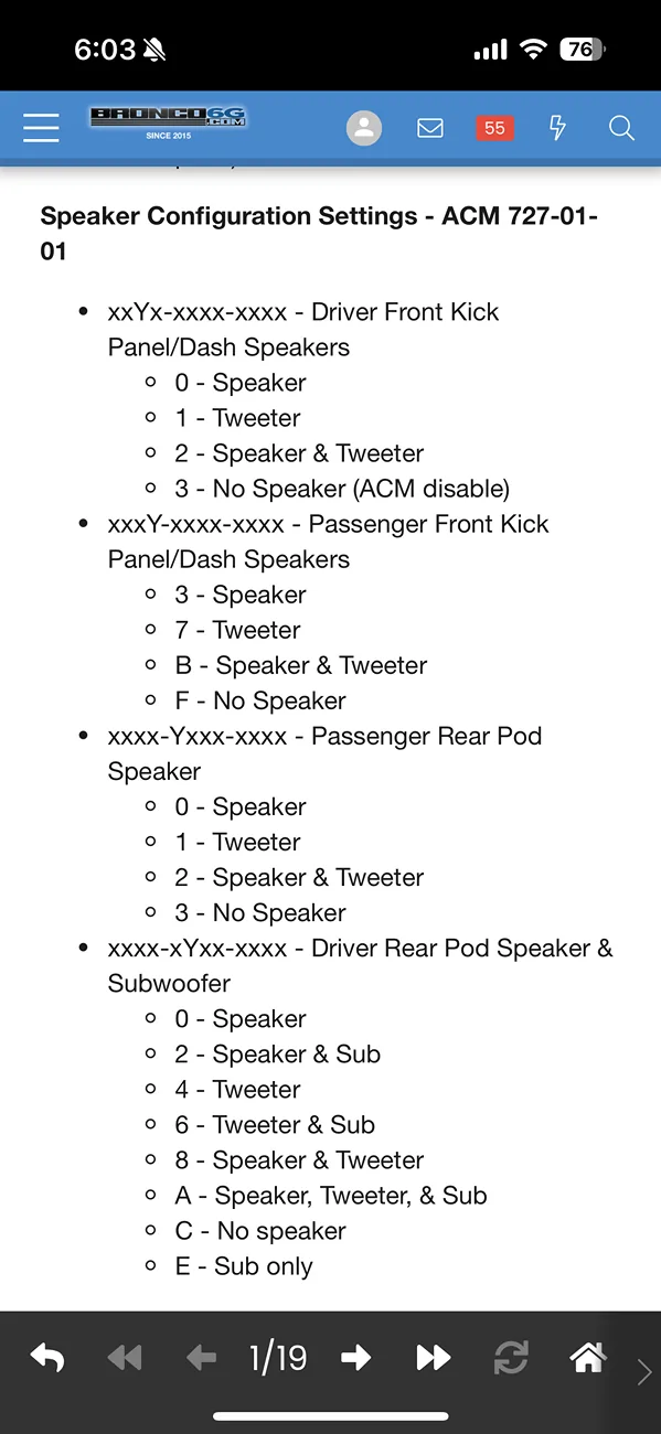

I made the Forscan changes and it definitely increases the sound out of these speakers.

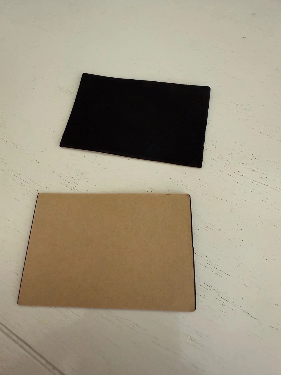

Any idea what these two adhesive rubber pads (3” x 2”) are for? There is no mention of them in the instructions. To be honest they may have come with my kicker speakers, i just had them in the box and assumed they were from the pods.
Do you think unbolting the top and lifting it with some blocks would suffice? I don't have an extra set of hands to help me remove the top entirely.
Thanks!

That looks like sound deadening to me. I did not get that with my pods. And yes, if you take all of the bolts out and just prop the top up a bit, you can get the bolts for the pods. That is exactly what I did. I did not pull the top all the way off. Just tilted it up enough to get to the bolts.
What forscan changes did you make? I’m planning to swap to 6.5’s in the back so will likely need to make some adjustments as well
Warsteiner
Jul 30, 2025
Ohio
2016 Chevrolet Camaro Convertible, 2025 Ford Bronco Big Bend
I set both rear speakers to Speaker + Tweater and Speaker + Tweater + Subwoofer. I am also debating on changing the setting to turn off the factory DSP settings.
So you changed to 2 on the passenger rear pod and A on the driver rear pod and sub?

Correct.
