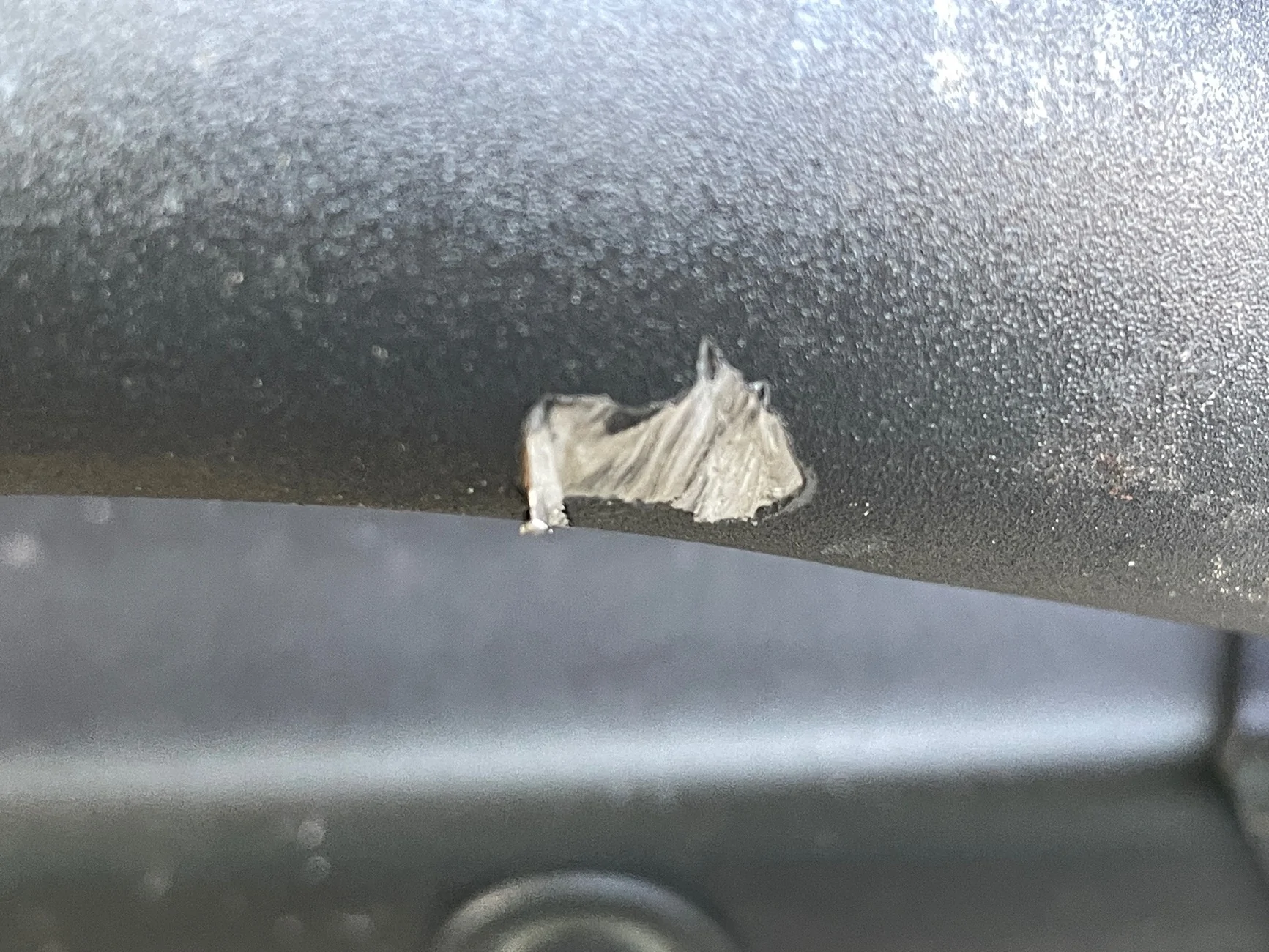

I tried Rustoleum Truck Bed Coating and the texture looks and feels extremely similar. The spray color is very slightly darker (I sprayed on a piece of glossy cardstock paper) but maybe with dirt, weather, and sun exposure the color will look more identical.
Compared to mod bumper:
Compared to plastic fender:

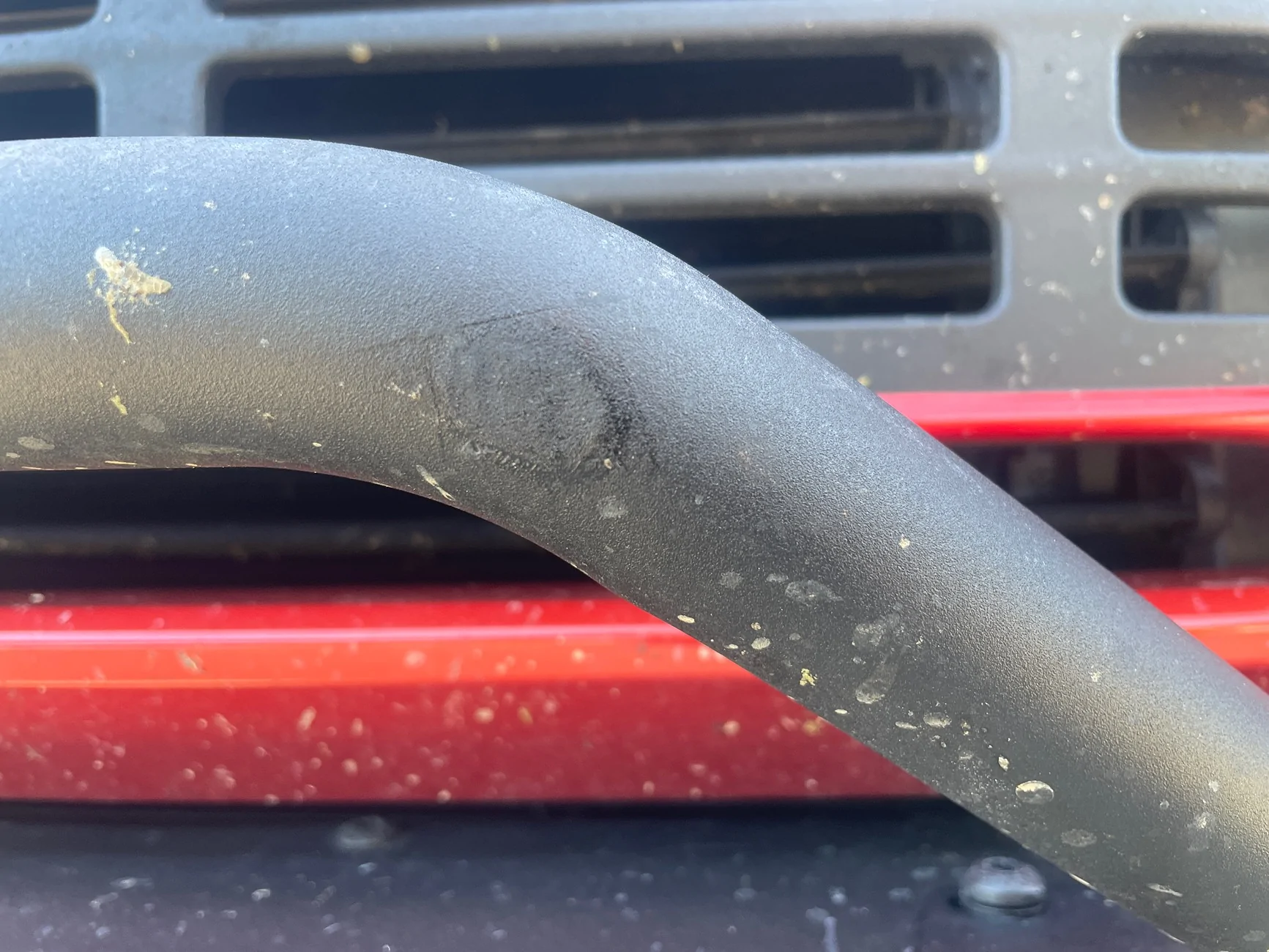

I had to make a repair of a small blemish on my DV8 mini bull bar, not the modular bumper, after a semi truck drifted backwards into me:
Unfortunately I was not paying attention until he was about to hit me. But fortunately, his trailer crash bar mostly hit my front tow hook and just put a quarter-size scar into the bull bar:

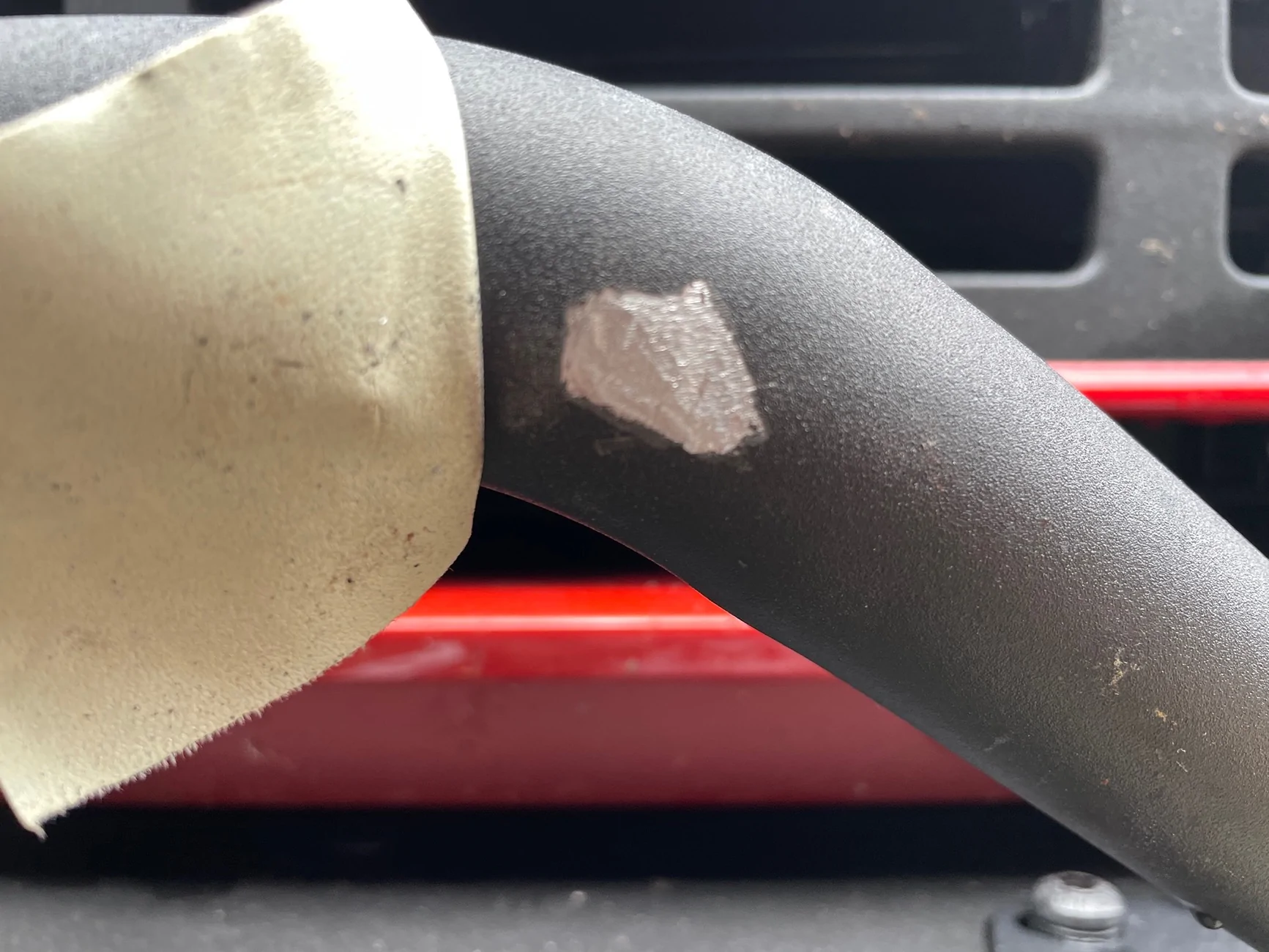

I just ground down the scab and the deep grooves with a Dremel tool:
Then directly sprayed the exposed metal with the Rustoleum Truck Bed Coating thru a hole in a piece of cardboard. I didn’t try to make it perfect with any filler to restore the shape, tho I could have used a little black primer or more paint on the spot to help blend the color contrast better. You can see the color and texture comparison in this video:
This is how it looks 5 months later:
Ah wow that's really close. I'm gonna give this stuff a try then.
