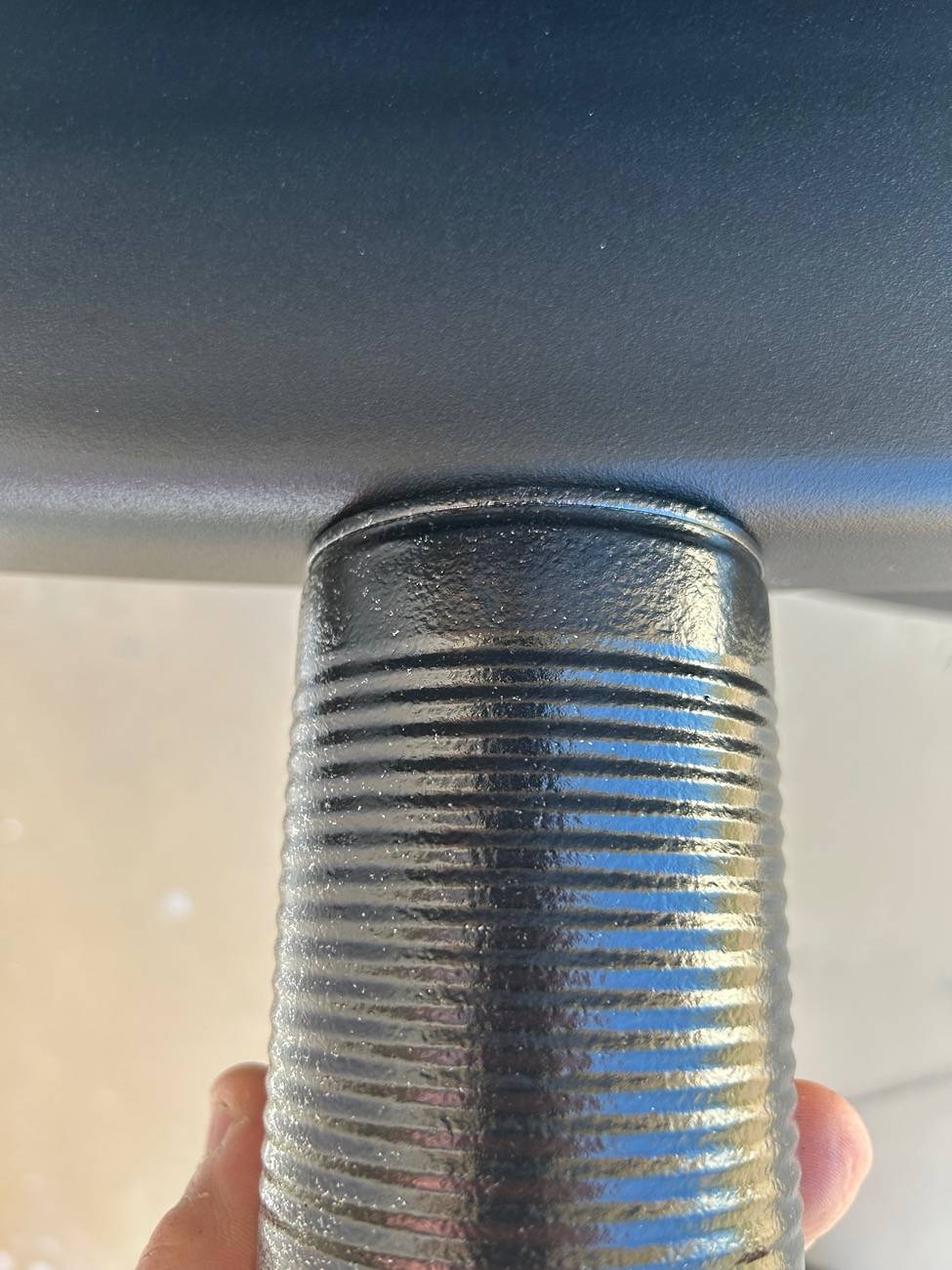

Just painted some Raptor samples on cardboard and a metal can. Results when fully cured.

Am I seeing pinholes in the coating? I may have to ask a chemist what could cause this?
Perhaps the chemical formula uses an evaporative material to obtain the texture, and this evaporation leaves pinholes in the coating. My experience tells me that a protective coating on steel should be fully encapsulating.
Could also be from surface preparation. I'd hate to have to remove the coating after application, can't imagine that would be an easy task.

I just sprayed it quickly before sun set heavily so I could get a pic for color purposes.

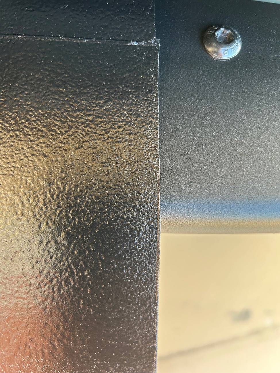

Did a respray. The Raptor doesn’t match. Still glossy and too black. Texture is to coarse even with multiple light coats. It would be fine if entire bumper was sprayed.

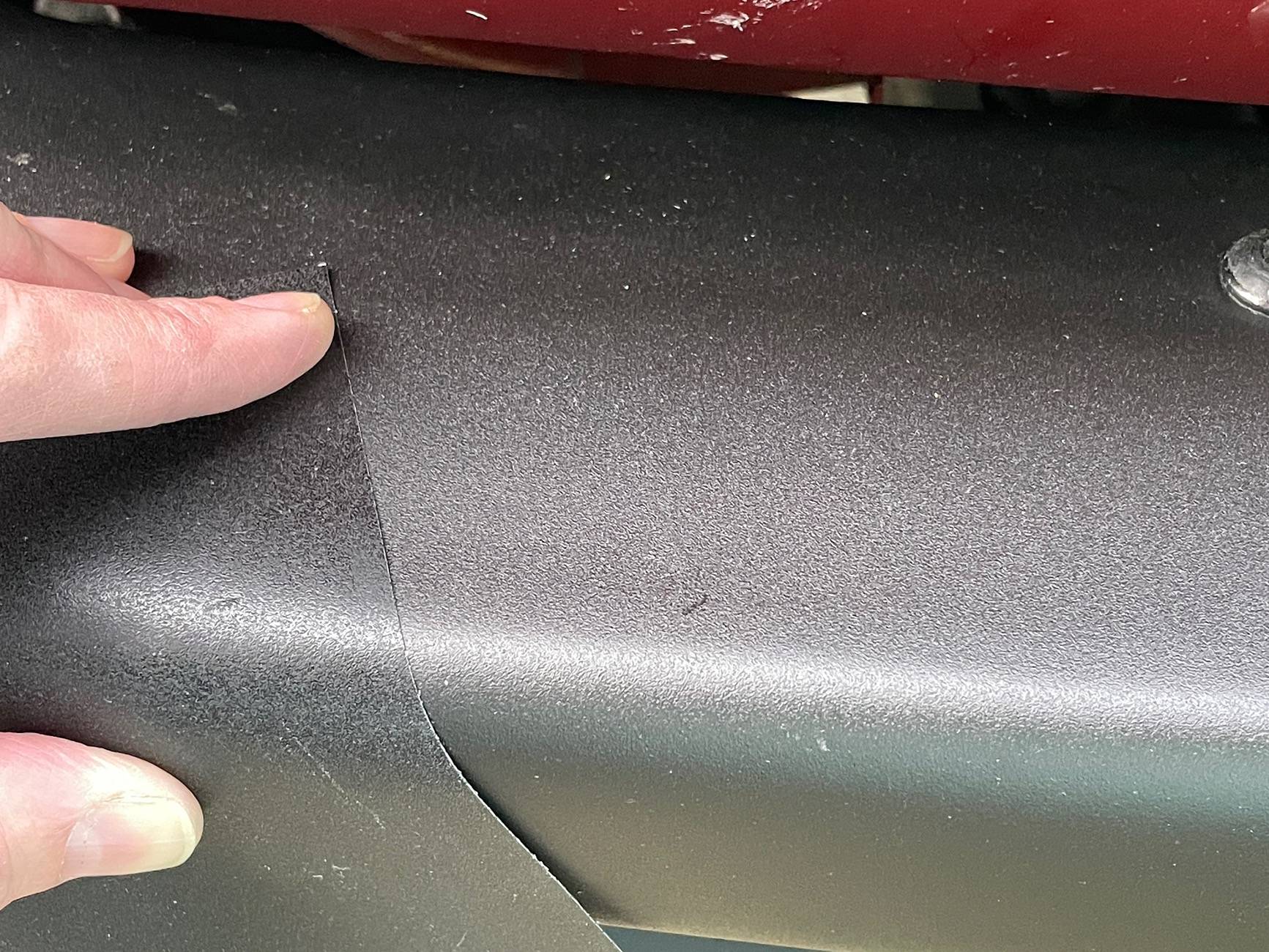

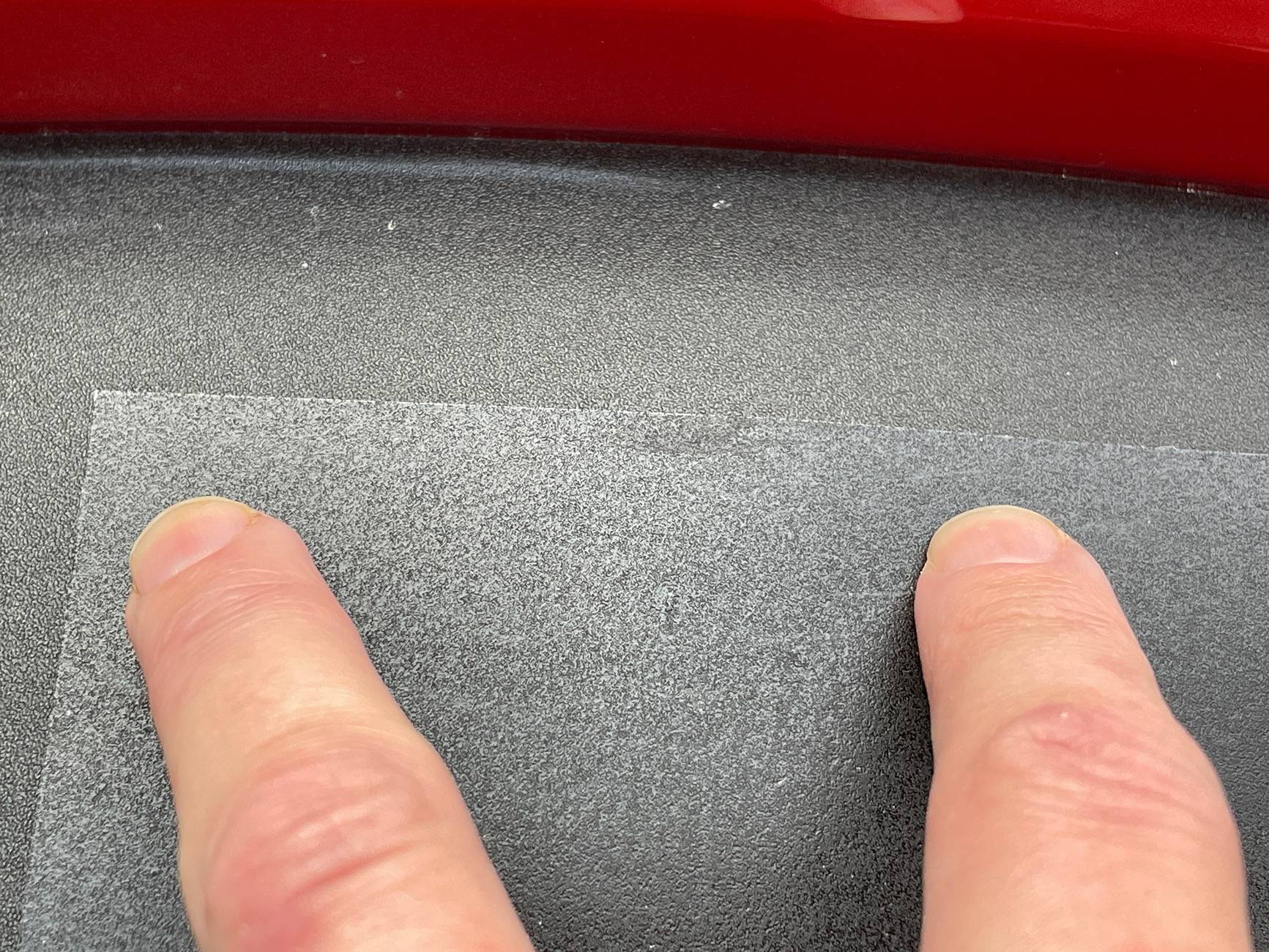

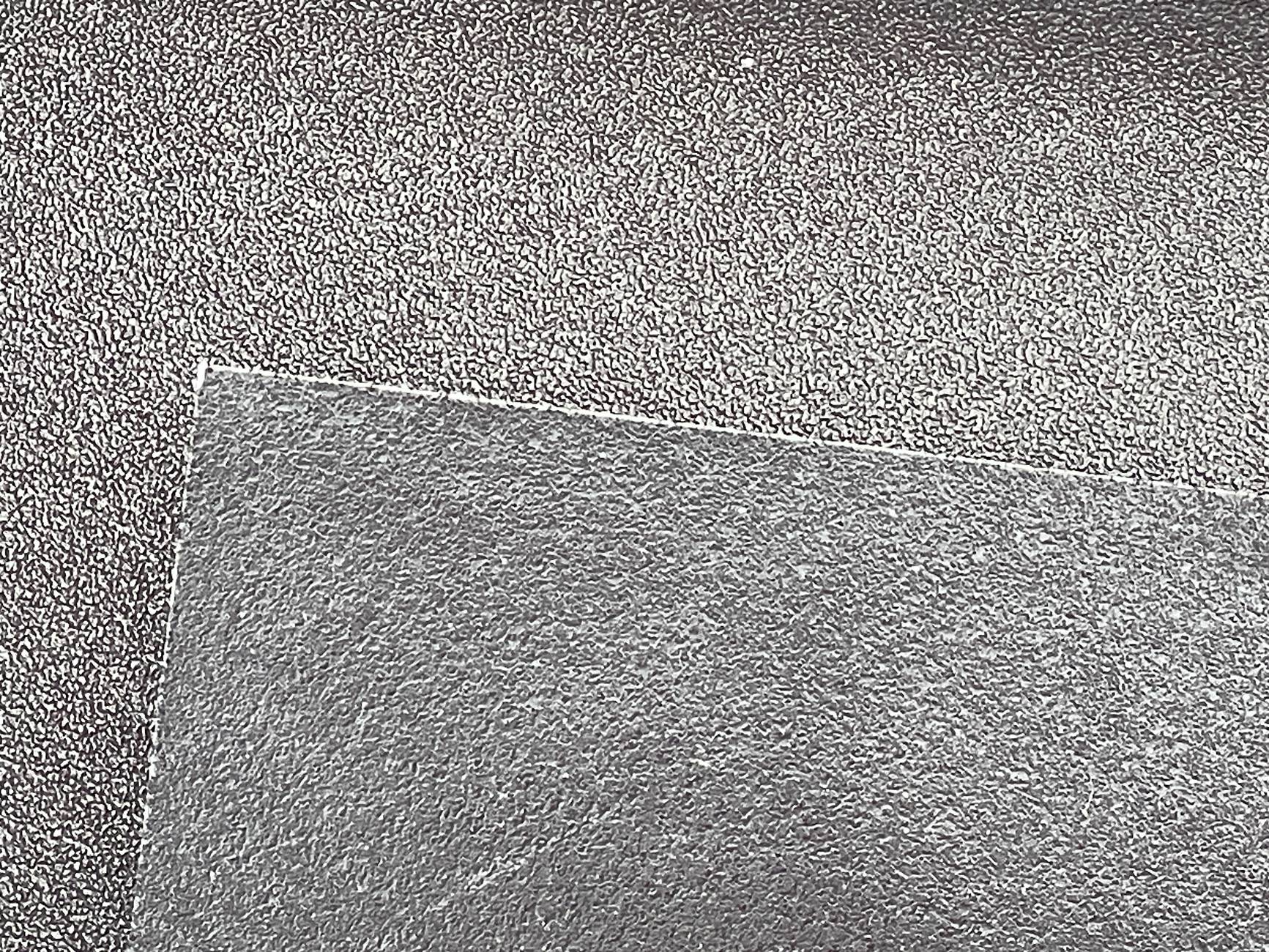

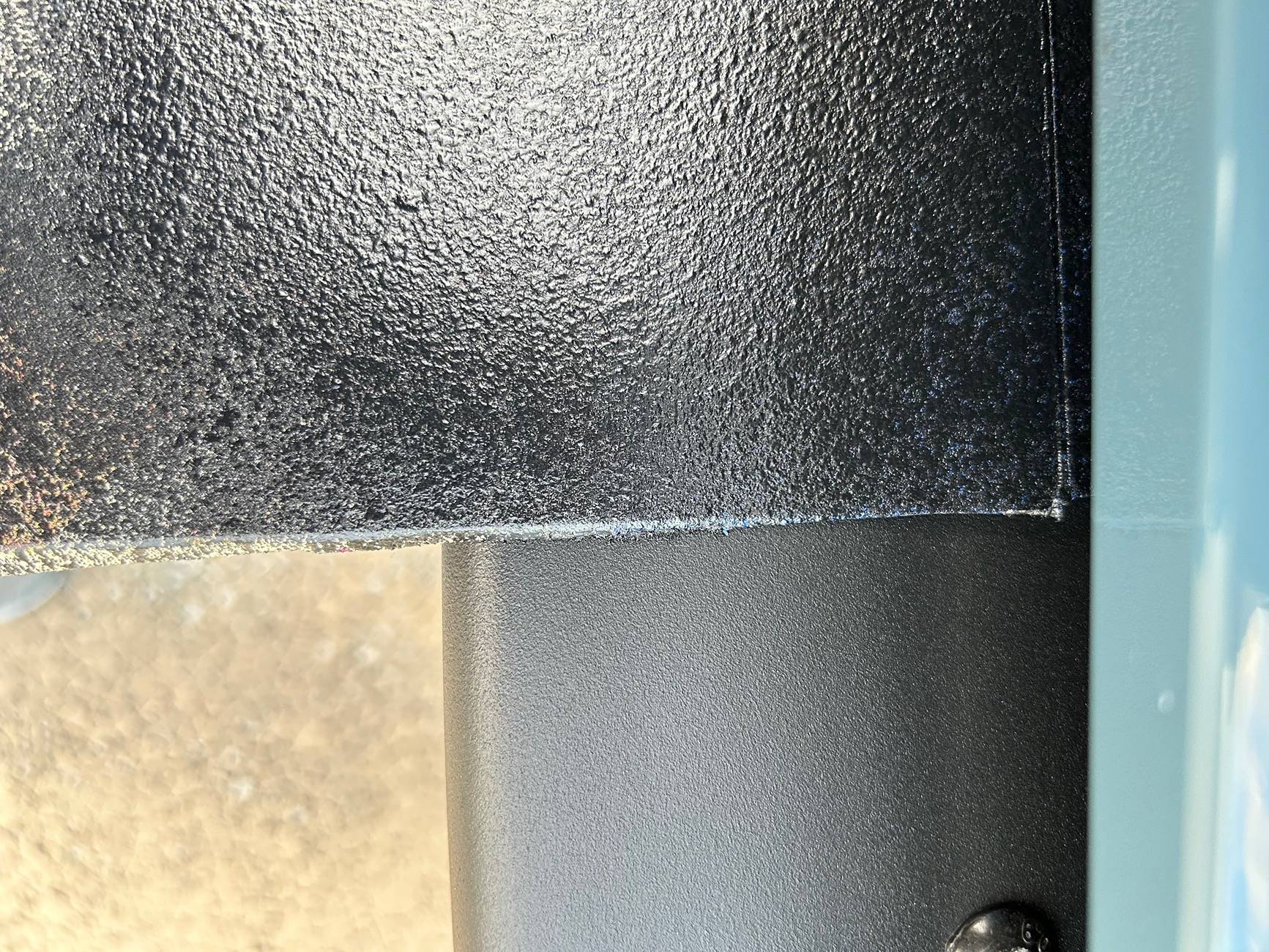

I tried Rustoleum Truck Bed Coating and the texture looks and feels extremely similar. The spray color is very slightly darker (I sprayed on a piece of glossy cardstock paper) but maybe with dirt, weather, and sun exposure the color will look more identical.
Ford Bronco Modular bumper paint match IMG_6664
Compared to mod bumper:
Ford Bronco Modular bumper paint match IMG_6658
Ford Bronco Modular bumper paint match IMG_6659

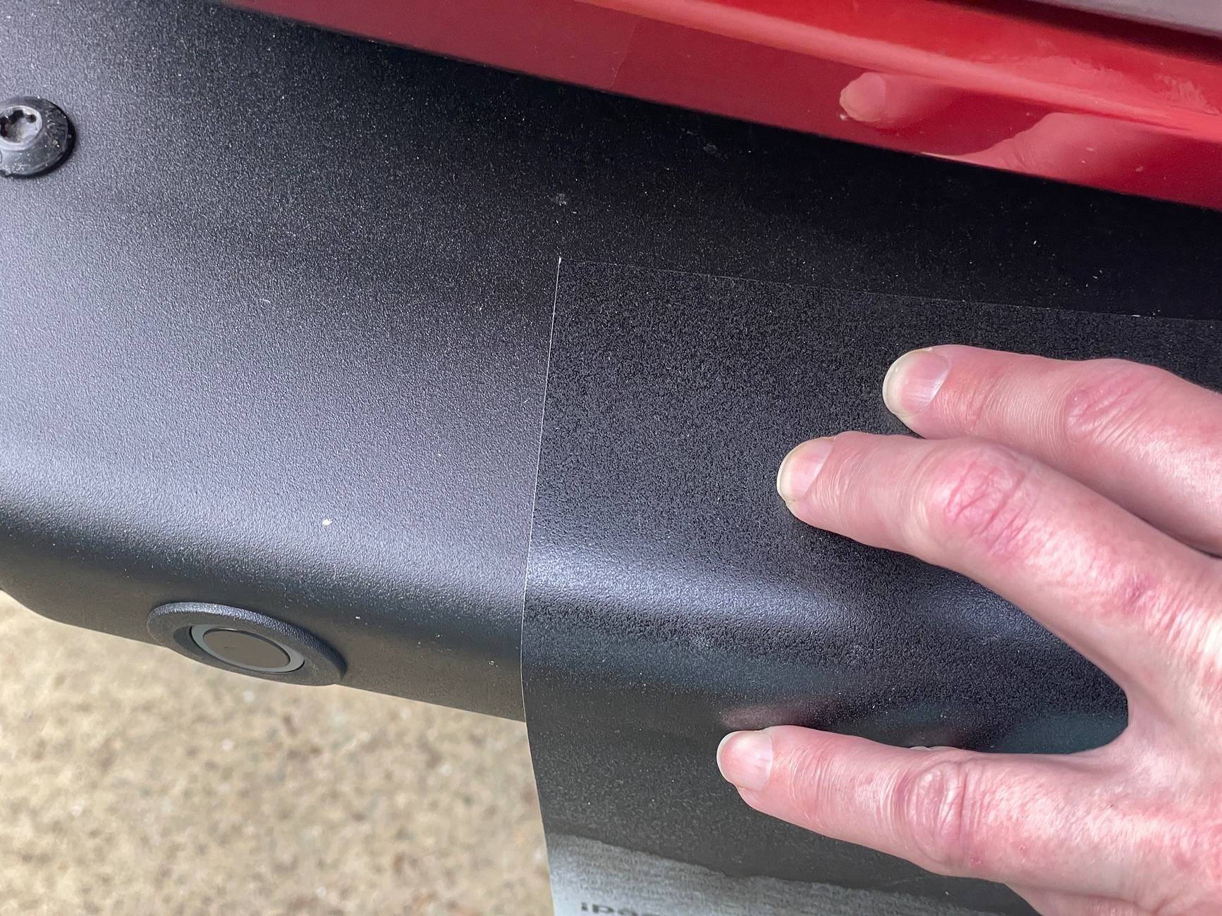

Compared to plastic fender:
Ford Bronco Modular bumper paint match IMG_6660
Ford Bronco Modular bumper paint match IMG_6661
